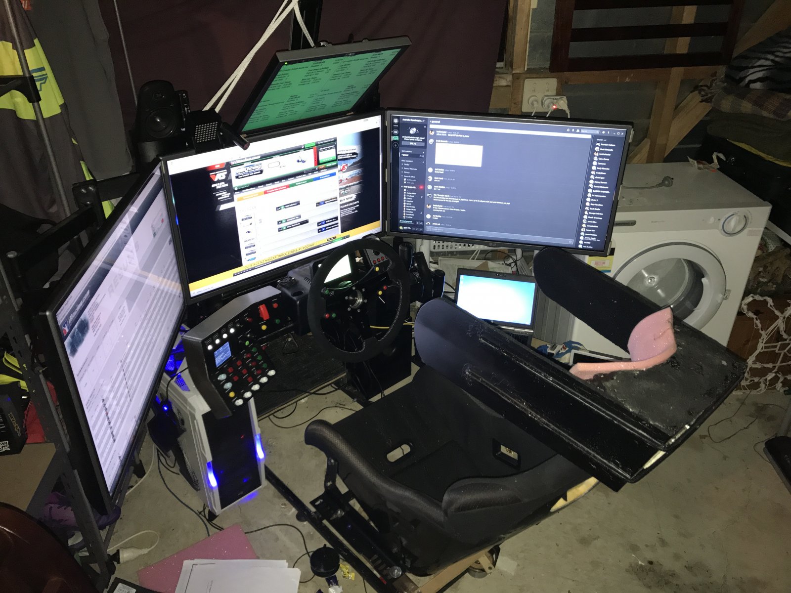

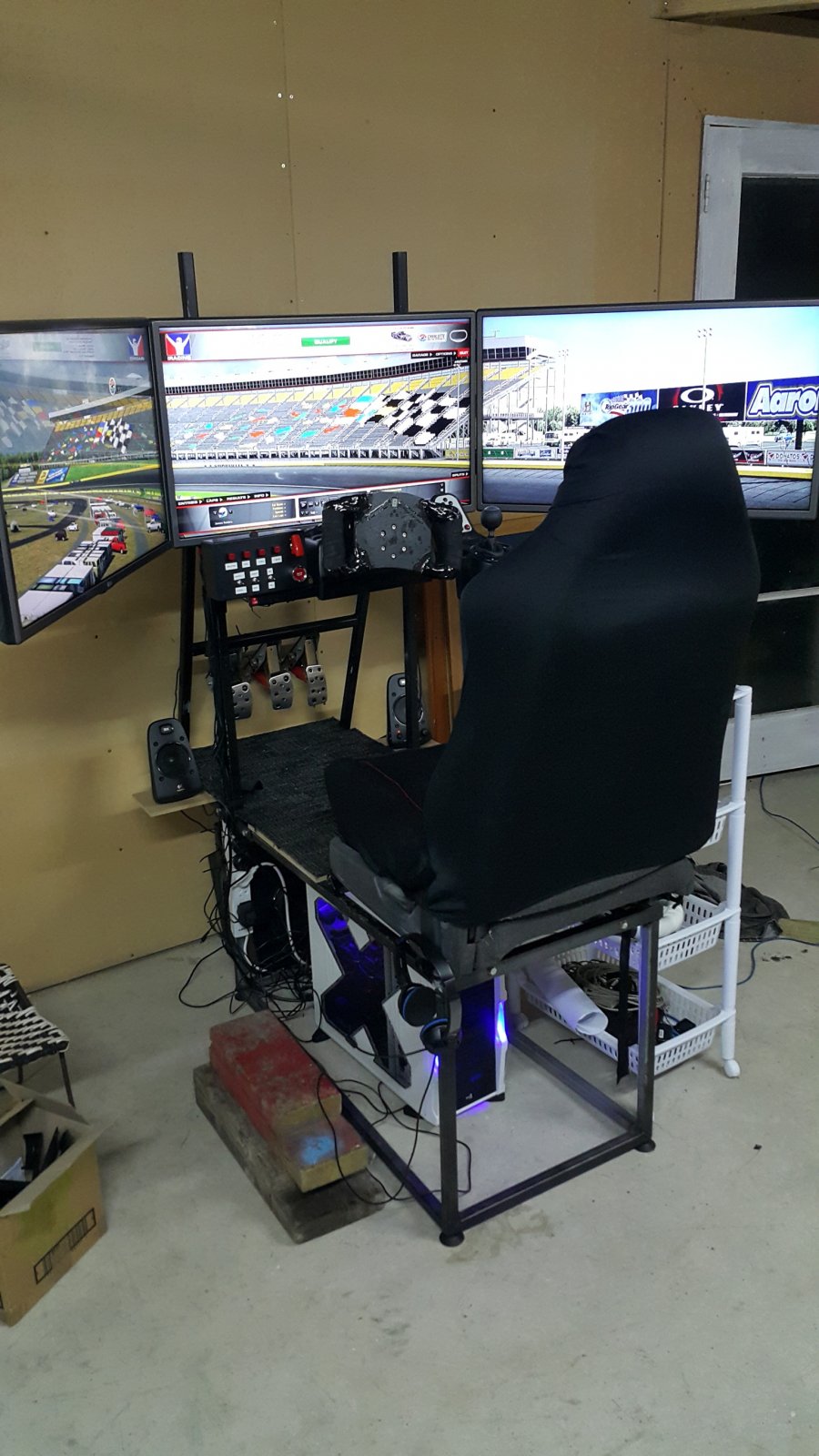

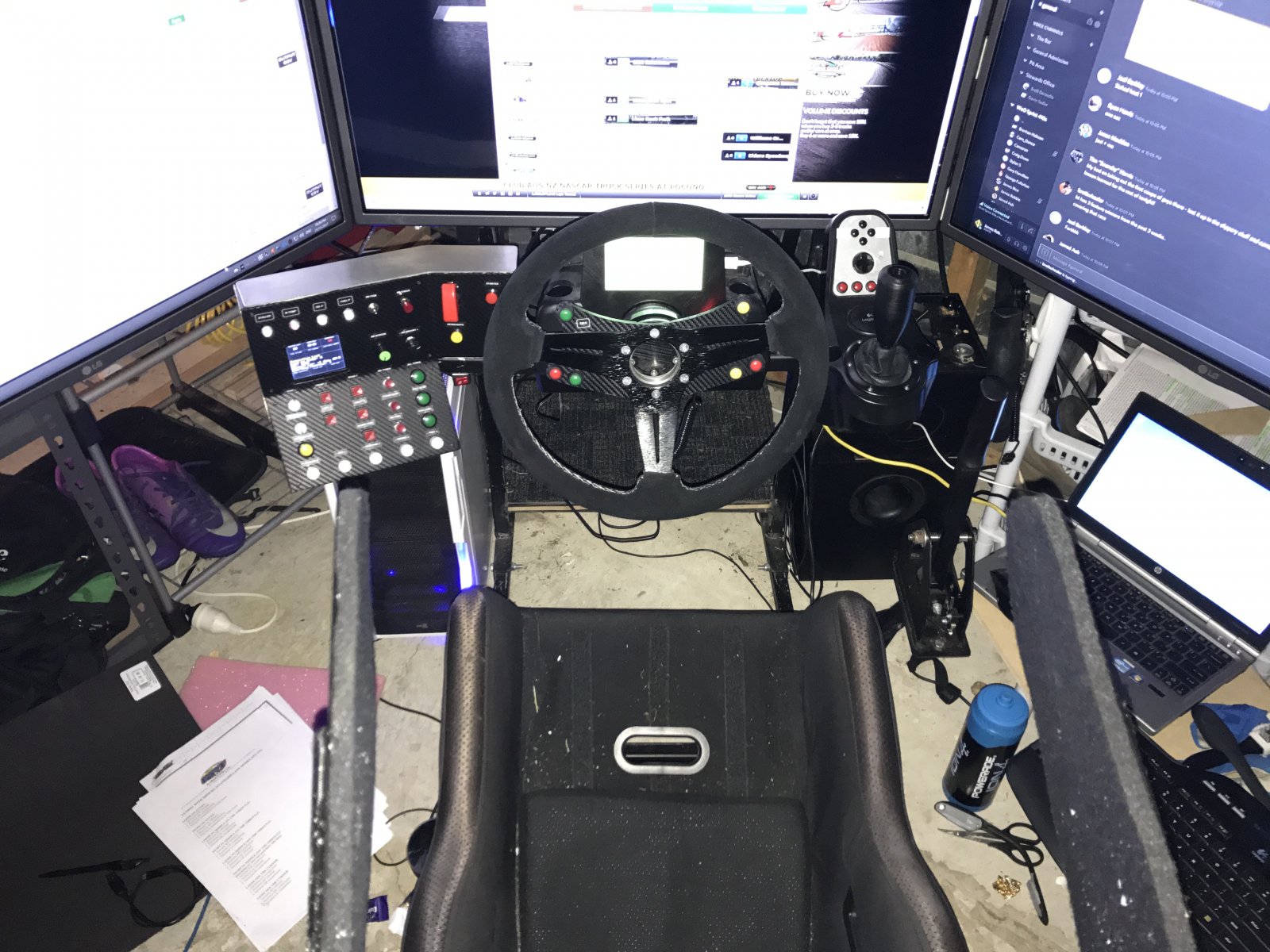

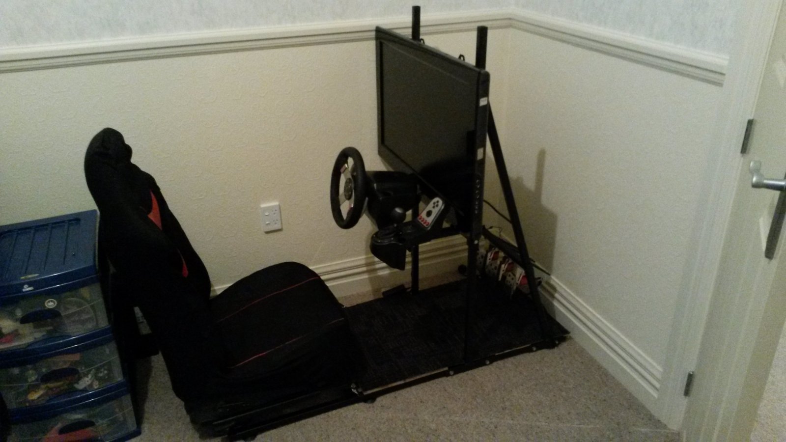

    Here are some progress shots of how my sim rig has morphed to where I am now. Even though, there are only "3 versions" in the pictures, there has been lots of work between the main versions as I have transitioned. And as I have got a bigger rig, I have had to migrate to my shed/man cave instead of having the warmth of being in a house while gaming. The core of my rig is 25 x 25 boxed steel and breaks down into 4 main parts - TV upright, seat, base, pedal box. As you can see, a lot of DIY stuff.
    "Version 3" in the image is my starting point for motion will be so I am looking forward to it.
  9. Nick Moxley
    17,054Coins
    +2,504 / 30 / -2
    Interesting looking seat bolsters you got there. :thumbs:thumbs
  10. James Robbie
    James Robbie Active Member
    May 23, 2017
    111
    IT Specialist
    New Zealand
    538Coins
    +64 / 2 / -0
    Yes, thats the joys of DIY... ;) Seat is a fixed back full race bucket set but I wanted to add some immersion as well as block out my surroundings and edge of the monitors. Head bolsters is a bit of folded stainless steel with 2 x 8mm rod for strength and to take out flex. This is bolted through the head of the seat and then I have used expanding foam between the head bolster and back of seat to create one piece for strength and support. Carved/shaped the foam and threw some cheap black spray can paint at it. Does the job and cost me $30NZD :thumbs

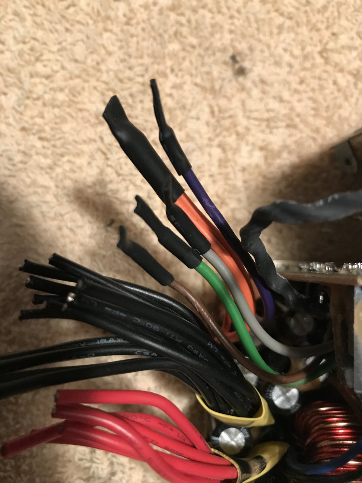

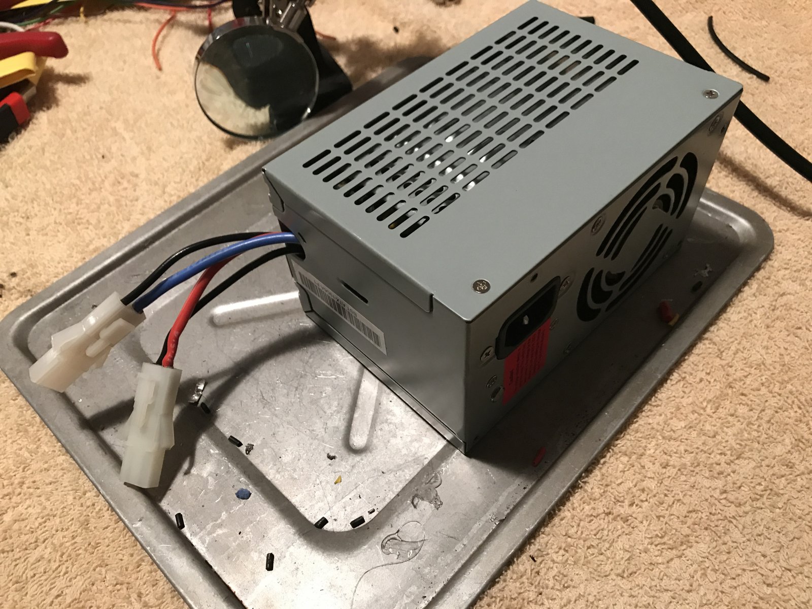

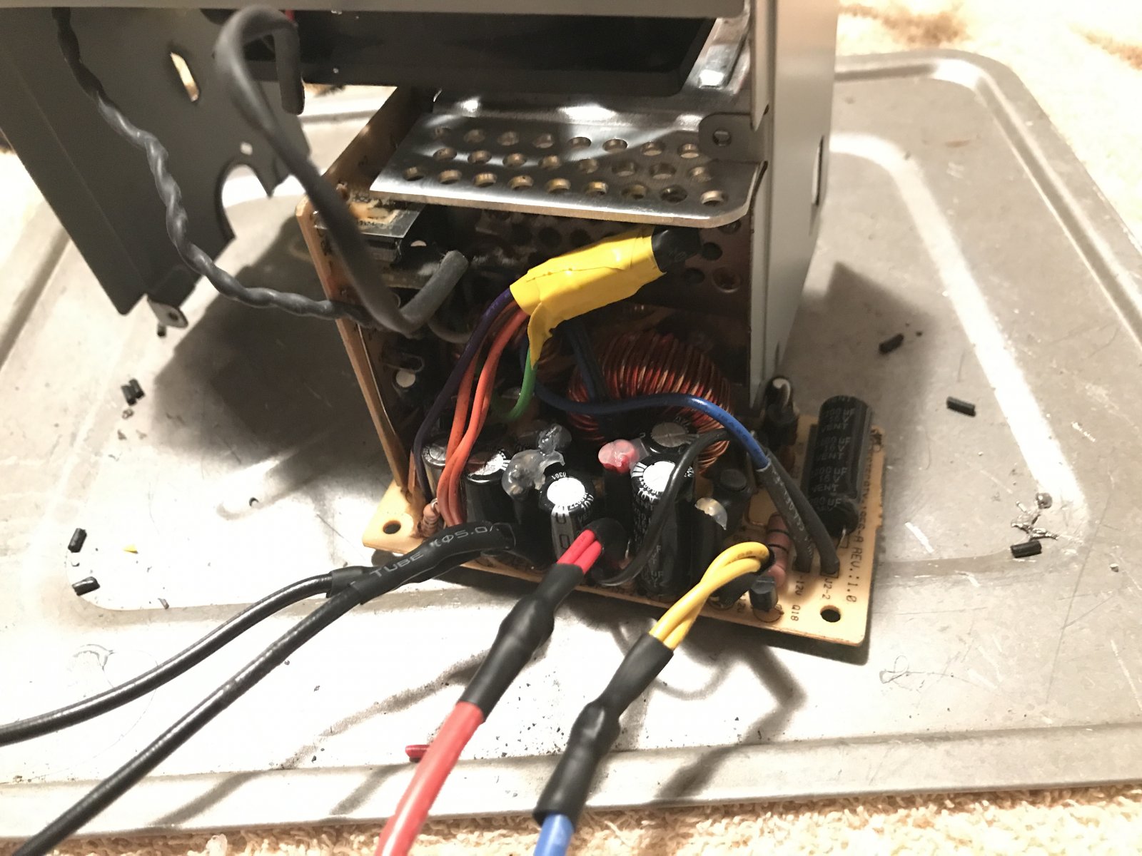

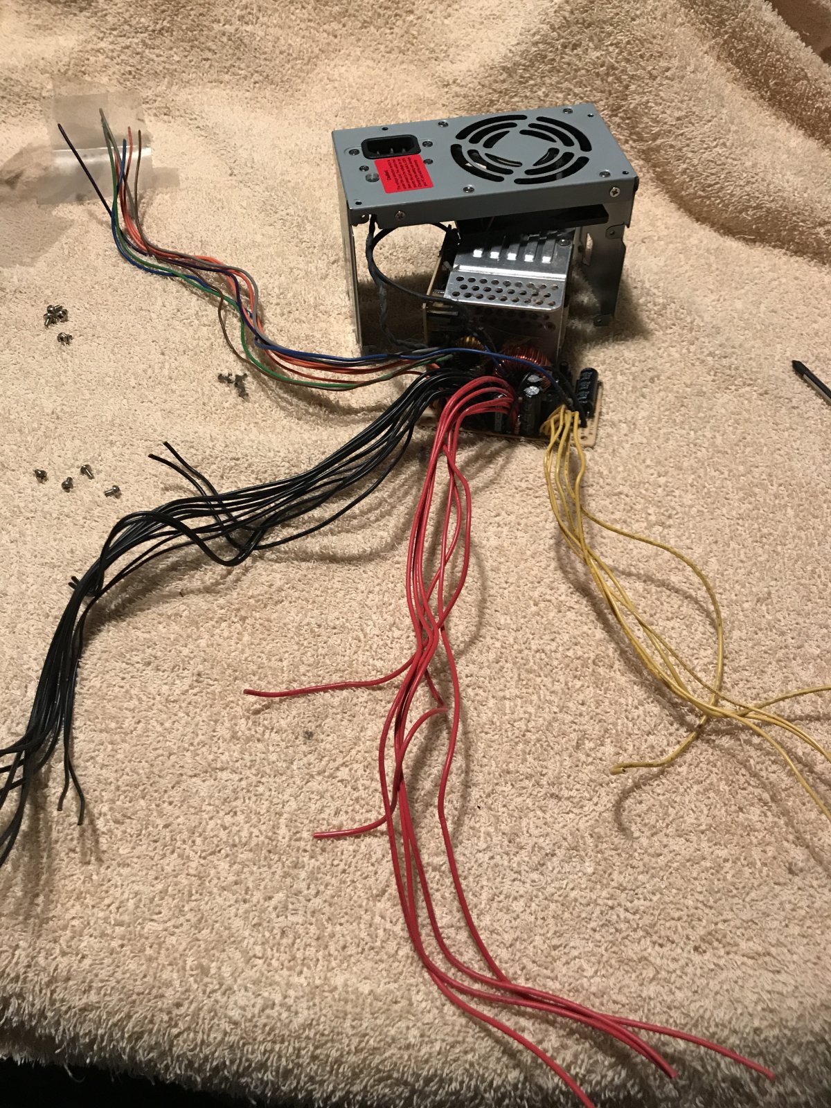

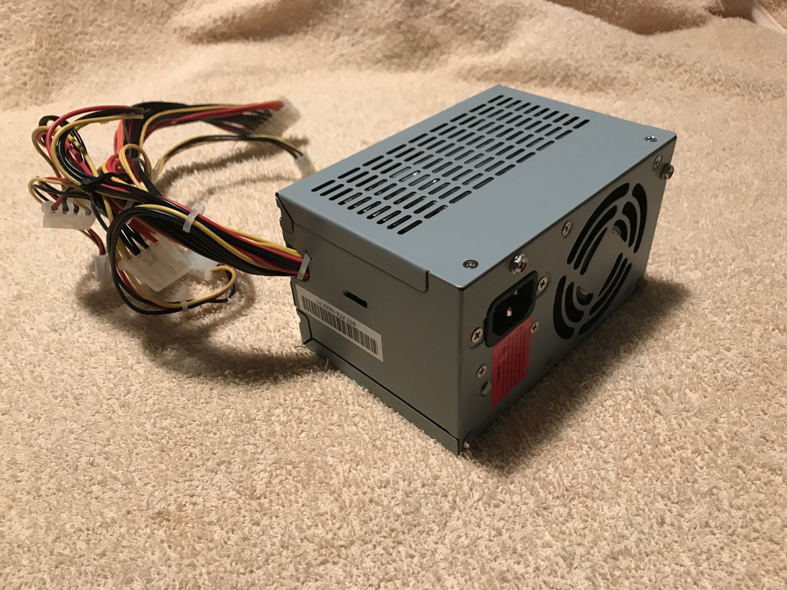

    Currently I am trying to fill the time and get as many things sorted out and ready before the electronics arrive. So, last night, I built myself a power supply for the motors. This is a 200W PSU out of an PC I had lying around at work and so manipulated it what I need. I have given myself a 12v and 5v plugs and will use a self made Y splitter for the two motors. 5V was a just incase option for fans or the Arduino etc. Pictures show what I started with and what I ended with.
  14. Nick Moxley
    17,054Coins
    +2,504 / 30 / -2
    I can safely assume thats for the Model and not the real build ?
  15. James Robbie
    May 23, 2017
    111
    IT Specialist
    New Zealand
    538Coins
    +64 / 2 / -0
    And now I feel completely and utterly inadequate... :confused: :blush Guess I have underestimated this. I'm guessing the wattage should be fine but is it the amperage that is the issue? Would that particular PSU not power one motor?

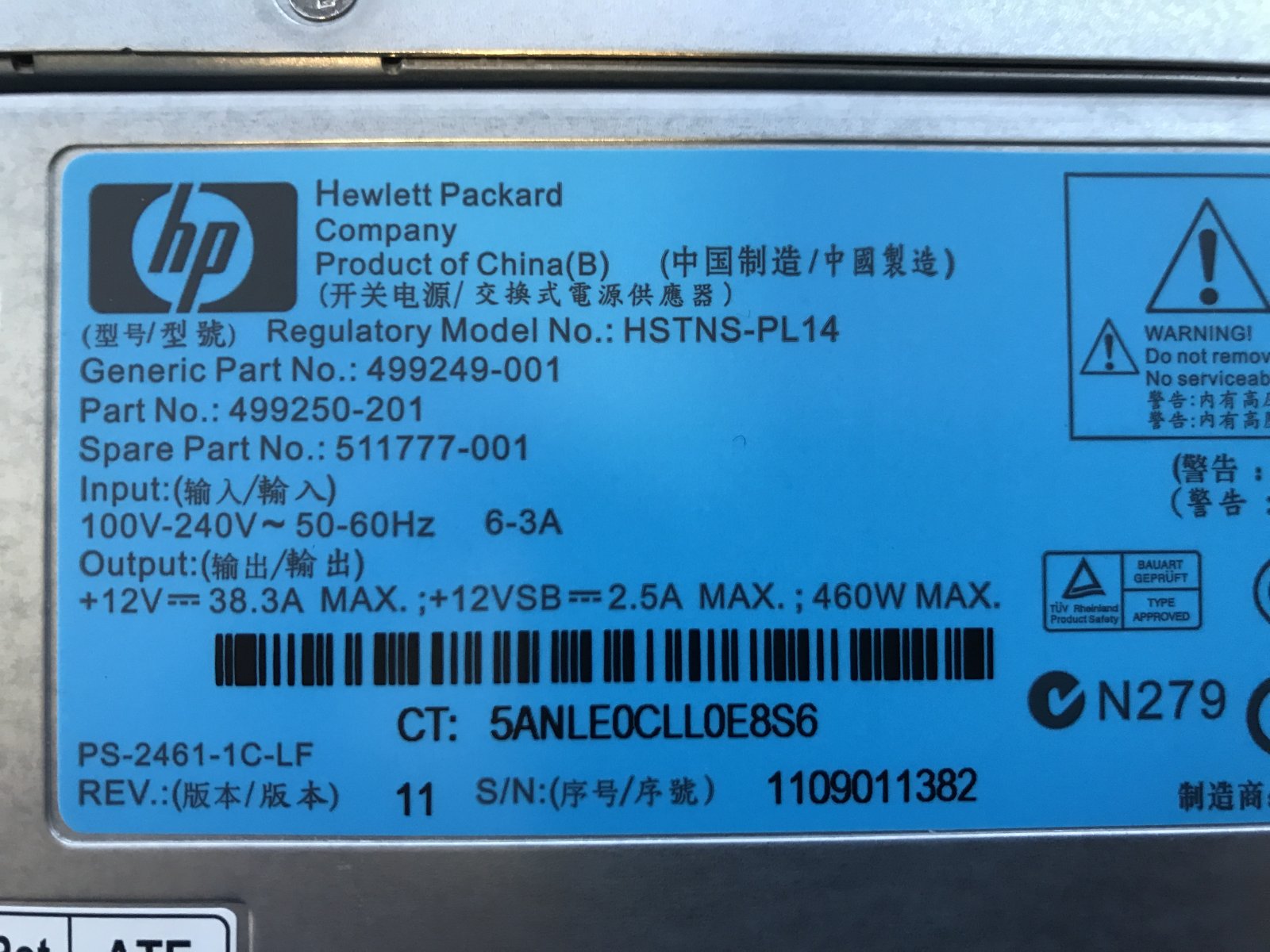

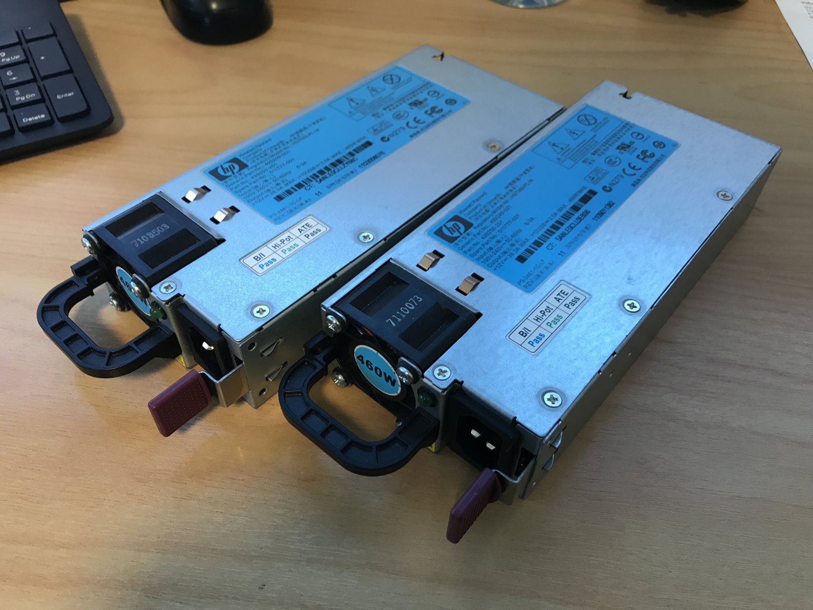

    :nerd Ok, more knowledge is rarely a bad thing and finding this out has saved me pain at build time. I have dug through our "deceased" room at work and found these server PSUs, even though they are the recommended 600W+ but I am hoping these should do the job?!
  18. Nick Moxley
    17,054Coins
    +2,504 / 30 / -2
    Much better, now to find the Pin out so you can Ground the "turn on" pin so the 12v Rail becomes live. Most Hot Swap units require some more work to get them up and running.
