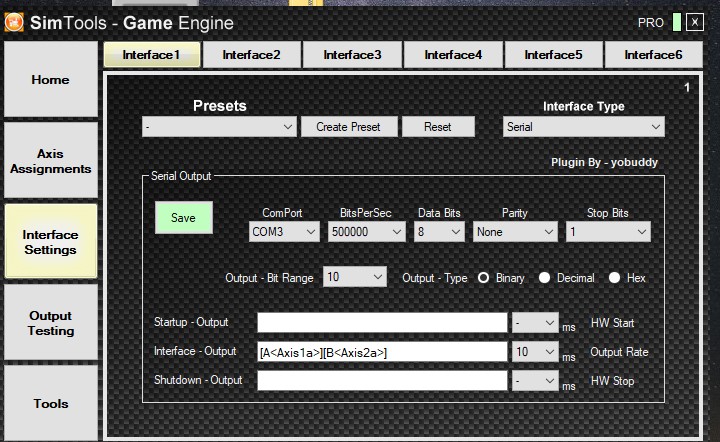

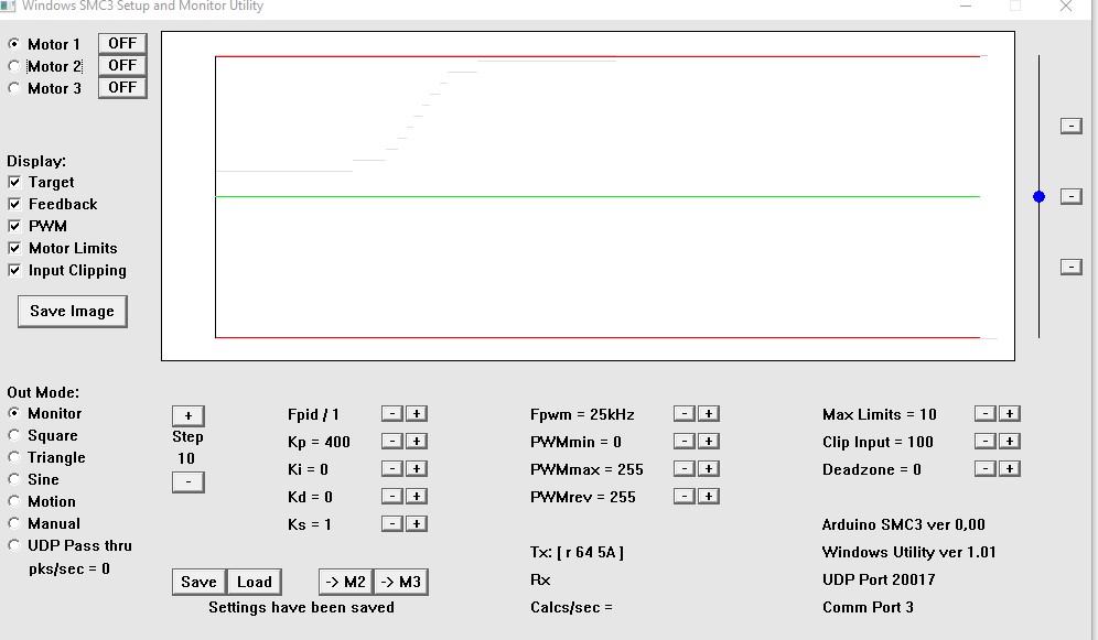

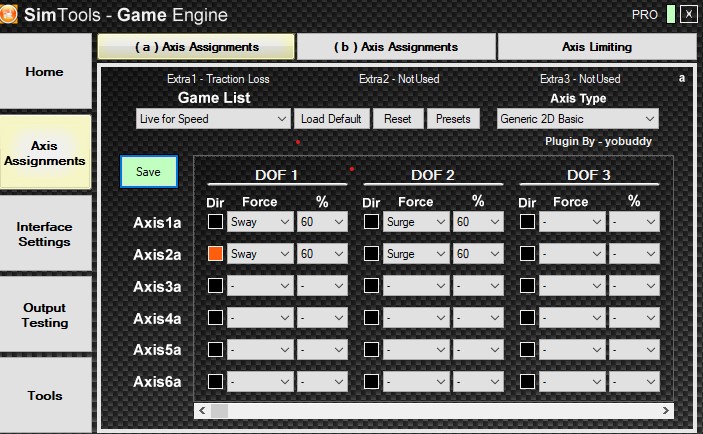

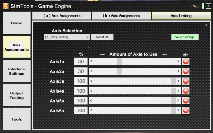

    Hi, i have a problem :( I use Arduino uno and two Ibt-2 h bridges
    A while ago I got my simulator to work perfectly, but I had problems with my computer and had to update some parts. A few days ago I assembled my new computer, installed windows, and again downloaded Simtools, the SMC3 software and the respective arduino code. With all that ready, I set the parameters and opened a game but the movement was erratic. I disconnected the levers that connect with the seat and tested the movement only of the motors, finding that the motors do not make the braking movement, only acceleration, this happens when having the axis limiter at 30%, this is how I had configured it previously And it worked perfect, these days I have been doing tests but the only way in which I get the braking movement to occur is by raising the axis limit to 100%. I will leave some pictures of my configuration, I would appreciate if someone can help me with that.

    I haven't use sismtools yet, but maybe its a problem with the IBT_2, i used them but also the rsults where erratic, and i deside to mobe to sabertooth, before of that is used MMotorshield, but again the quality was verry poor. Whish you luck..
  5. SeatTime
    2,573
    What version of Simtools are you using? - if 2.4.1 then it had issues with the serial link when released, so I had to roll back to 2.4. I although do not know if this was later fixed.
    21,723
    152,051Coins
    +11,063 / 56 / -2
    Your SMC3 Max and Clip settings are not what I would expect.
    There are some reasons to reduce Axis Limiting for the likes of SCNs, to prevent damage, but not really for wordrive DC motors.
    There have been some slider related issues reported for the latest version of SimTools, following a recent Windows update: https://www.xsimulator.net/communit...04-from-1909-intensity-slider-problems.14795/

    Yep, Windows 10 2004 patch + simtools 2.4.1 does this. The serial component was broken in 2.4.1 with the introduction of 32 bit support. Roll back to 2.4.0 and it will be fine.

    Hi Noorbeast, thanks again for the fast reponse, the Max and Clip settings are low just in that screenshot, i have higher values in the normal configuration, sorry for post this image.
    Thanks for the info of the version of Simtools i check that tonight.

    Good news, the problem was resolved by installing Simtools v.2.4, thank you so much guys, in the nexts days i will post the photos of my project.
    Thanks again!!!!

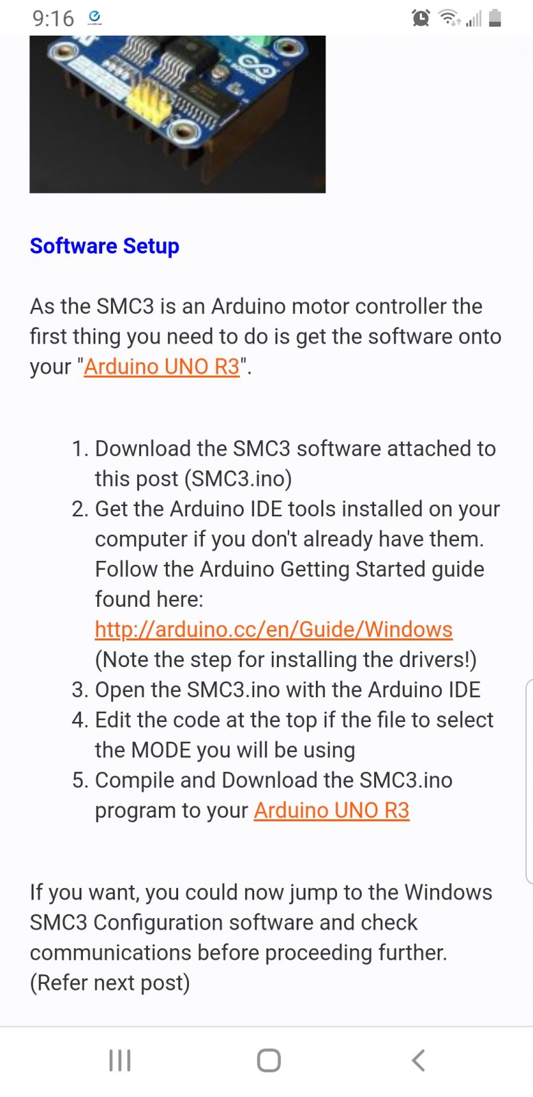

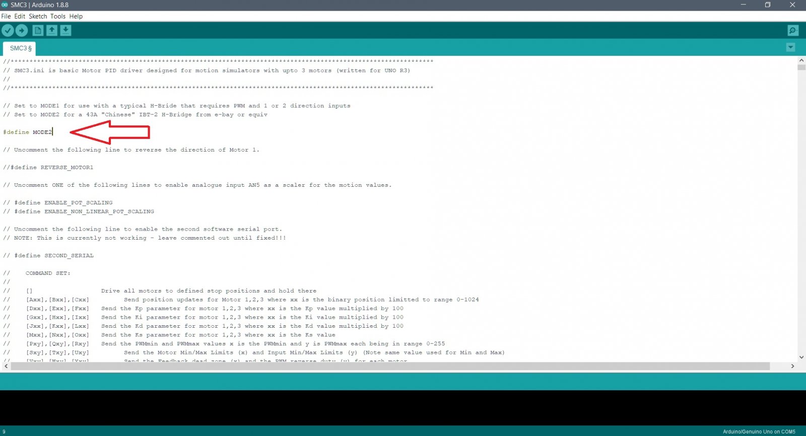

    Hi guys, can you please direct me on how to select MODE2 on smc3 arduino code? It says to edit the code at the top but I'm not sure what I'm editing? Please help. Screenshot_20200922-211608_Chrome.jpg
  13. noorbeast
    21,723
    152,051Coins
    +11,063 / 56 / -2
    Set Mode2 in the code like this:
    21,723
    152,051Coins
    +11,063 / 56 / -2
    If SMC3 works as expected and SimTools does not the please start your own thread and post pictures of all of your settings.

    Thank you so much! I was scratching my head and thought it'd be more complicated. Lol
