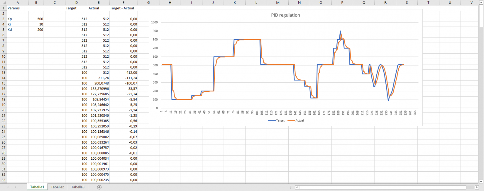

    Hi DIY'er,
    I wrote a small Excel programm to get an idea how to set the Kp, Ki and Kd values in SCM3Utils.
    You can just play around with the values and see how the actual curve is following the target curve.
    Not sure if someone else already did that (I don`t read the whole thread), but I find it useful, so I upload it here.

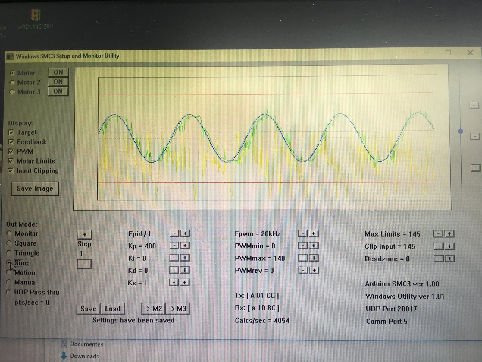

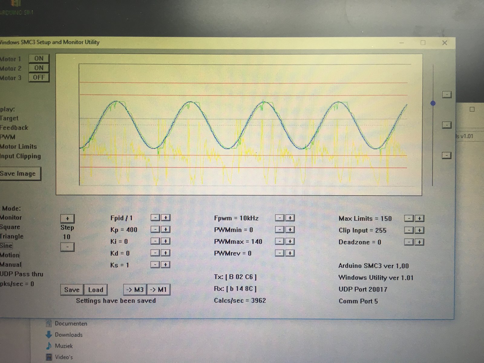

    played a bit with smc3 today. with the test motors 12v. I only had to use max limits 145. if I set it to 255. then it goes outside the values and goes off. is that OK ?
  10. titomaky
    titomaky Member Gold Contributor
    Aug 4, 2008
    76
    181Coins
    +23 / 1 / -0
    Motion platform
    Yes, that is correct
  11. Joeri
    Joeri Member
    Feb 18, 2019
    61
    car body repair shop
    The Netherlands
    106Coins
    +23 / 0 / -0
    I'm starting to understand. I now have clip input again at 255. And max limits at 150. Now the motor does not switch off when it reaches the clip input line.
