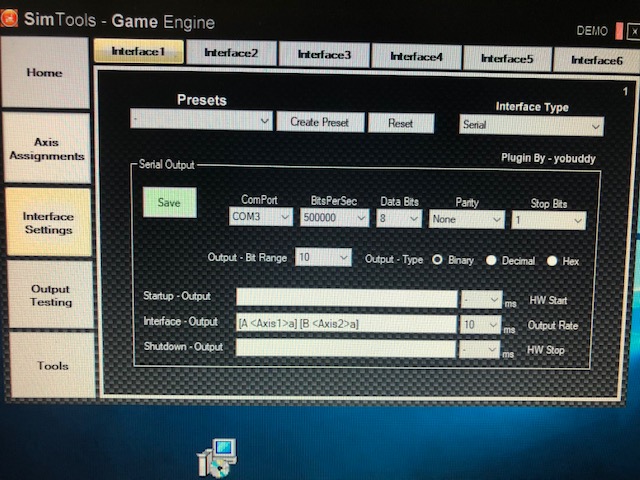

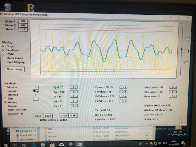

  5. kareltje
    kareltje New Member
    Oct 12, 2018
    132Coins
    Hallo
    ik heb een probleem met SMC3Utility alles werkt perfect alle motoren doen het goed, maar in simtools en ik test op as1 als motor1 beweegt en stopt en hij doet niets meer dan ga ik terug na SMC3Utility alles werkt weer perfect ga opnieuw na simtools weer dezelfde motor gaat snel naar 1 kant op -96 en stopt met niets meer doen wat het probleem kan zijn
    gr cart
    21,736
    152,189Coins
    +11,064 / 56 / -2
    I have taken the liberty of doing the Google Translation for you.
    Google Translate:
    Hello
    I have a problem with SMC3Utility everything works perfectly all engines do well, but in simtools and I test on as1 when motor1 moves and stops and he does nothing more then I go back after SMC3Utility everything works perfectly again go again after simtools again the same engine quickly goes to one side on -96 and stops doing nothing more what the problem can be
    gr cart
    To assist troubleshooting can you please post pictures of all of your settings.

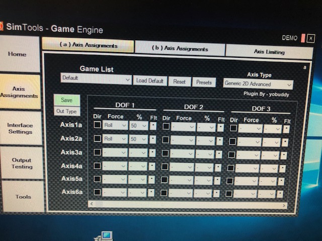

  10. kareltje
    kareltje New Member
    Oct 12, 2018
    132Coins
    Hey
    I've tried with these settings [A <Axis1a>] [B <Axis2a>] but he still does not do anything to get what I can do now help me
    gr cart

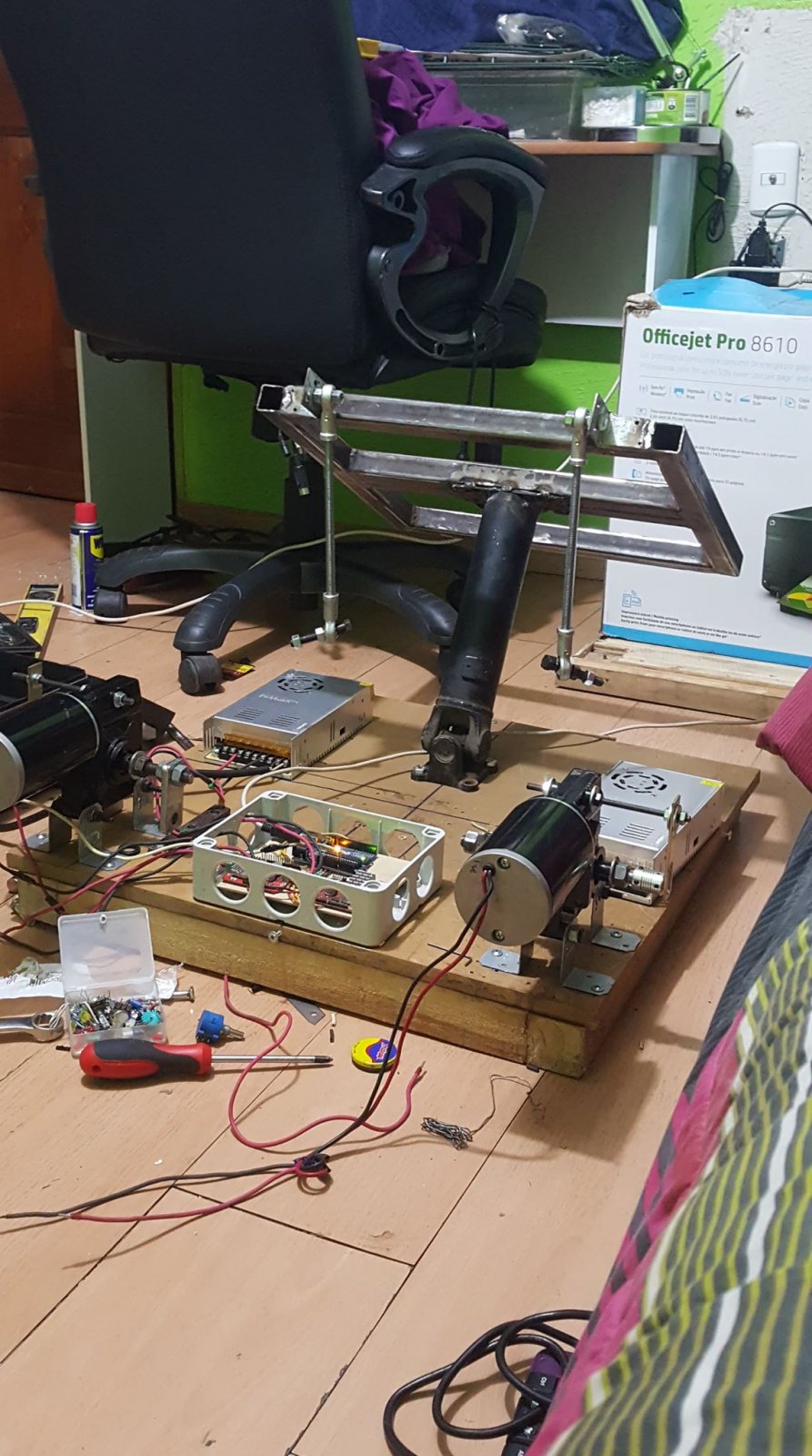

  13. MuñozChile2dof
    MuñozChile2dof 2 DOF SIMULATOR ARDUINO AND IBT-2
    Mar 18, 2016
    36
    Hydraulic technician
    CHILE
    54Coins
    +13 / 0 / -0
    hi everyone
    this is my setup i test everything and works ok but without weight, and that's the problem. Whit weight the motors turns and not keep in position. Someone have the same problem ? I change parameters in smc3 utilities but i don't have good results.
    this have solution? or i have to change the design of my sim? thanks guys have a nice week
    21,736
    152,189Coins
    +11,064 / 56 / -2
    There is a significant design flaw with your rig, the universal joint needs to bolt to the seat, not the base, as the way you have it puts enormous strain on the motors: https://www.xsimulator.net/community/faq/universal-joint-placement.108/
  15. kareltje
    kareltje New Member
    Oct 12, 2018
    132Coins
    Hey
    i have done this setting [A <Axis1a>] [B <Axis2a>] but the motor 1 and motor 2 move but stops and then they do not move anymore than I start smc on they move again during startup smc who can me help out
    gr carel
  16. MuñozChile2dof
    Mar 18, 2016
    36
    CHILE
    54Coins
    +13 / 0 / -0
    thanks @noorbeast
    I really had not thought about that affecting, I will try to make the changes as soon as possible and upload the progress of my project :thumbs

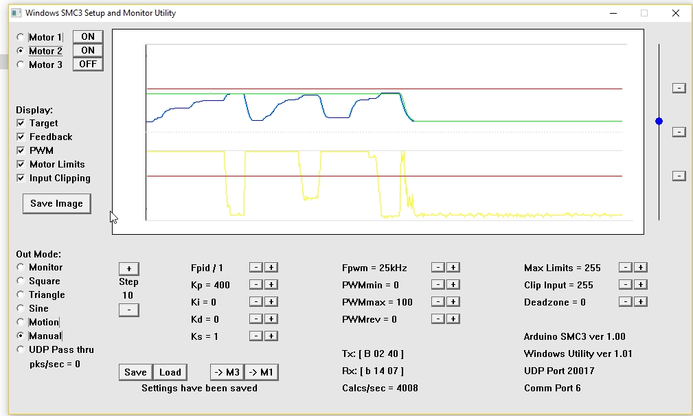

  20. CBC_North
    CBC_North Member
    Jun 29, 2018
    40
    Computer Engineer
    Ottawa, Canada
    333Coins
    +34 / 0 / -0
    Posting this here as well as my build thread since those who watch this thread likely aren't subscribed to my build :)
    Trying to perform the PID tuning tonight using SMC3 setup utility, I'm finding some weird behavior. Sometimes the motors get "stuck" in one position. More details:
    • I'm running the monstermotos as a half-bridge (one board per motor) as per the instructions in first page of this thread.
    • When it works, it works flawlessly (95% of the time)
    • The potentiometer feedback is spot on. Any time the motor moves the feedback graph (green) moves.
    • When it stops responding it's usually when I'm just switching to that motor and the target position is a ways away from the feedback position or I've left the motor in one position for a while and manually step the target position a fair ways away from the feedback.
    • The utility indicates it's outputting the max PWM and I've confirmed this at the arduino PWM pin as well as the monstermoto contacts using a multimeter.
    • The direction output from the arduino seems to be correct (one direction is +5v and the other is zero. These pins swap if I jump the target location over the feedback location but don't go near it)
    • The output voltage from the monstermoto at this time is zero.
    • The heatsink on the driver does not get warm to the touch at this time.
    • To get out of this "stuck" position, if I go to the utility and pull the target postion to the feedback position then away it will eventually start working again.
    • Can see this in the posted graph where I pull the target position (blue) towards then away from the actual position (green) multiple times. The first two times don't fix the problem but the third time does and the motor begins following the target position again. It will work again until I leave the motor idle for a while.
    • This is happening with both of my motors.
    Is this a quirk with manual mode in the utility? Maybe with the monstermoto boards? Any help would be appreciated.
