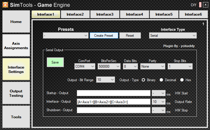

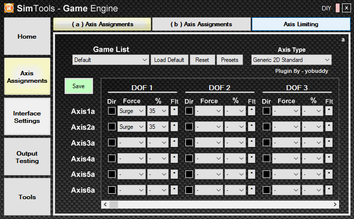

    Hoping someone might be able to help me understand my SMC3 Simtools setup.
    • I have SMC3 on my arduino running on COM4. I can open the serial plotter in the Arduino IDE and can send commands to move the motors manually and read back their positions, so that seems to work OK.
    • I have SMC3Utils connecting OK to the arduino, and I can move both of my motors OK using SMC3Utils - both responding fine to all of the Sine wave, Motion, Manual etc movements.
    • I can't for the life of me get Simtools to make the motors move though.
    In Simtools, I went to the Axis assignments, selected a generic 2D standard axis type (on both Axis Assignments tabs), and selected Default from the game list. I then set Axis1a and Axis2a to Surge at 35% and hit save.
    I then went to the interface settings, chose serial, COM 4, 500000bits/s data rate, 8 data bits, No parity, 1 stop bit, 10bit binary output range, and set the interface output to [A<Axis1>][B<Axis2>][C<Axis3>] 10ms, and hit save
    Now, whenever I go to Output testing, I can't get the motors to move at all. I made sure to close all other apps to nothing else was trying to access the serial link. I've played around with the settings a bit, but nothing works, and the above Interface settings seem to be the correct settings from what I've read on this forum.
    Have I missed something? I'm really out of ideas at the moment, so any help would be appreciated.
    Nathan
    22,048
    153,884Coins
    +11,154 / 57 / -2
    @ntbutler for SimTools 2 your Interface - Output settings need to be like this: [A<Axis1a>][B<Axis2a>][C<Axis3a>]

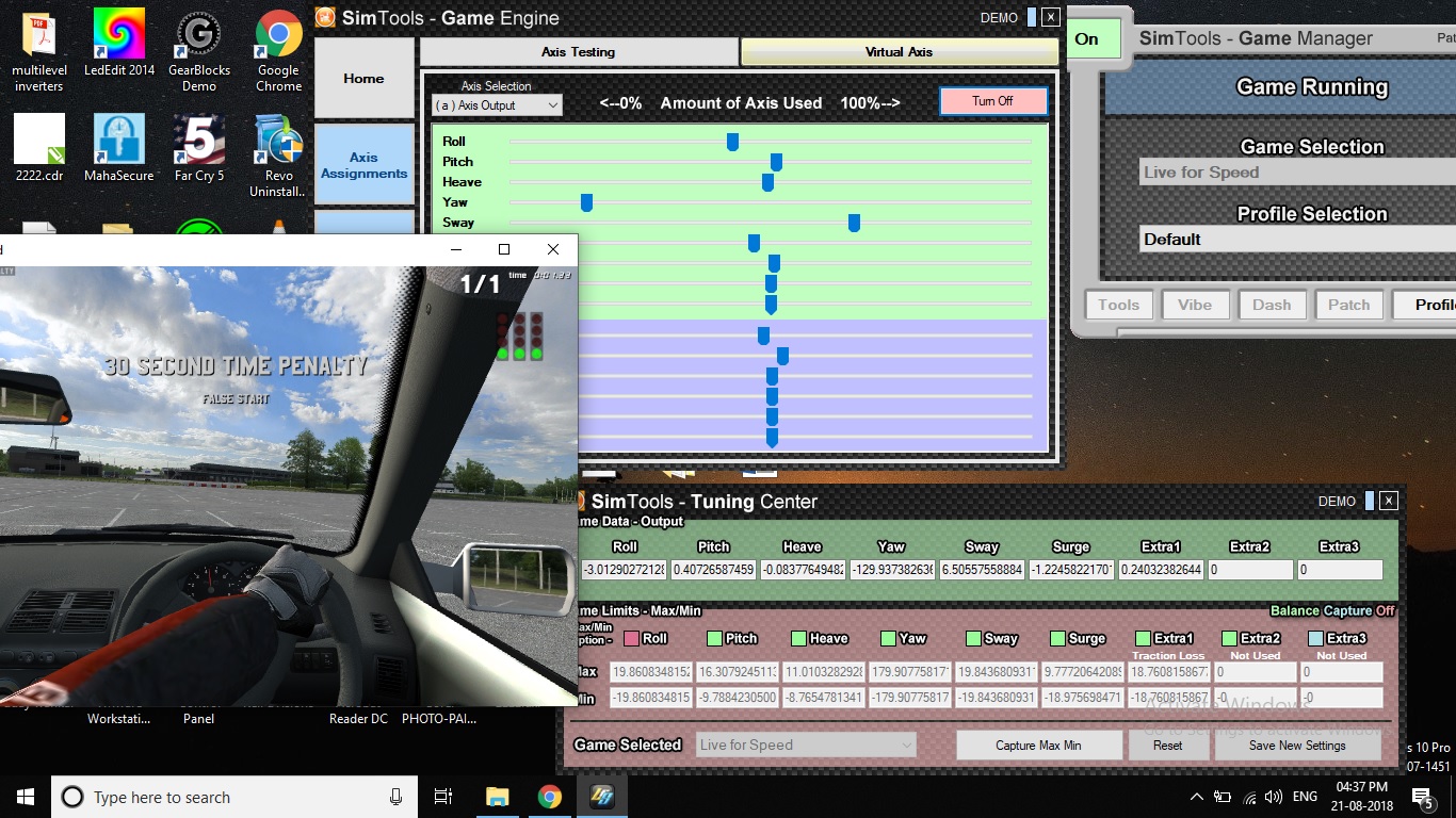

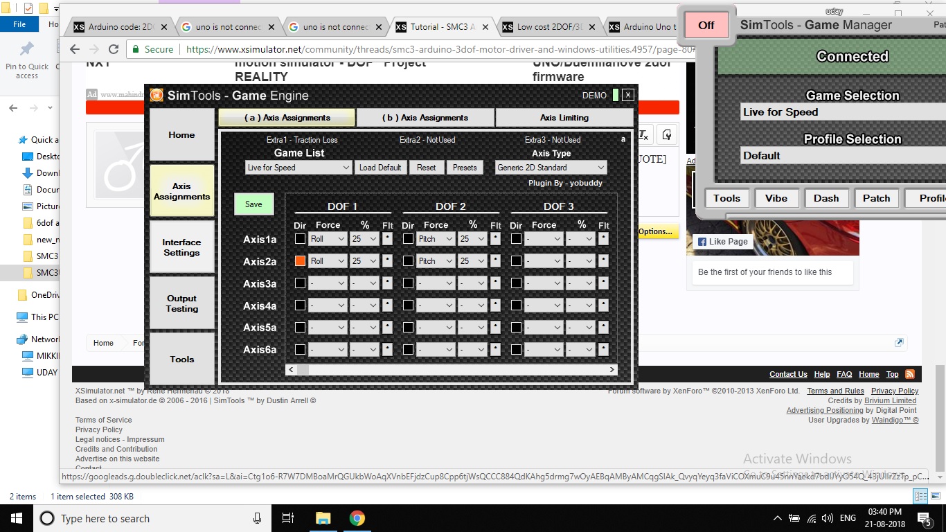

    here are screenshot of settings.
    22,048
    153,884Coins
    +11,154 / 57 / -2
    First up is output testing working correctly?
    Was LFS run for a few laps before patching?
    Are you running anti virus software?
    If yes to the above temporarily disable the anti virus software. Game Manager is switched off, please turn it on and post a picture of the Tuning Center while LFS is running.

    The Tuning Center values show that SimTools is capturing data, but your Tuning Center values seem to be all over the place and are too high. Follow the steps here to refine your motion profile, doing one axis at a time, and in particular doing a Tuning Center capture of values and then refine them: https://www.xsimulator.net/community/faq/steps-to-create-a-motion-profile.228/
    My comment about LFS is that it has to be run in first person mode before patching to generate some required files, other wise it does not work. Once it has been run a few laps LFS can be patched.

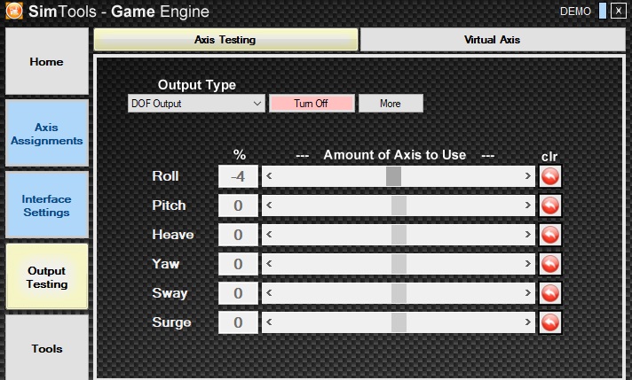

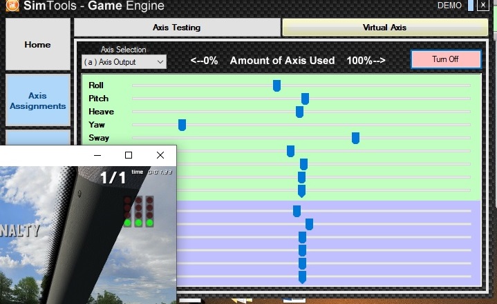

  14. uday wankar
    uday wankar New Member
    Jul 18, 2018
    10
    Student
    maharashtra , India
    115Coins
    meaning of saying that Output Testing works means virtual axes displaying movement according to game shown in screen shot named "working.jpg"
    not able to move motors as there no output to uno from simtool via com port.
    shown in screen shot named "not working.jpg"
