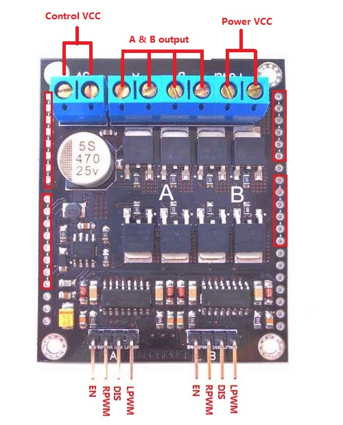

    Hello everyone
    I am building a 3 dof using mode2.
    I am using 3 IBT2 and 3 worm gears by PgSaw. (https://www.ebay.com/itm/GEAR-MOTOR...LL-FEED-150-160-rpm-25-1-ratio-/351066992384? hash = item51bd392f00)
    In the initial tests everything is working normally. Today when I complete the construction, one of my engines (board 2) began to turn only to one side.
    Turning right and left, it switches between slow and fast, but to the same side. With the other two engines I do not have this problem.
    I changed the order of the motors, and always what is on board 2 has this problem of turning only to one side. That is, the problem is not in the motor, but in the board.
    I've checked the wiring, but it's all correct.
    I tried to redo the settings in SMC3Utils but it remains the same.
    Is it possible that the board has been damaged?
    Any solution.

    Complementing.
    I unplugged all the wires and tested this board with the 3 motors and the problem persisted.
    Is there any way to reset the ibt memory?

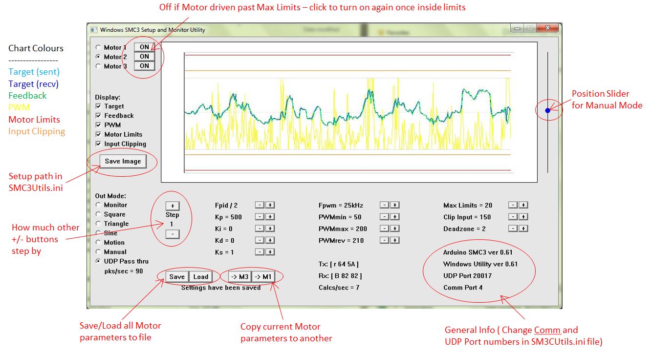

    Hi, i have one problem with smc3 and MM: everything is working fine with simtools (demo), output test and the smc3 setup utility. Motor is moving in right direction.
    But: whenever the hallsensor is going below a specific value (i guess it is 255) the motor stops, even if there is no limit or clipping set (currently no rod mounted to motor). in the opposite direction everything is fine, goes up to 1000 (as set in code) but not in the down direction. and whenever it stops, i have to loosen the hallsensor, turn it above 255, tighten it, set motor to „on“ in the smc3 tool, and give it another try......
    any idea, what could be the problem ?
    cheers, Arazok

    ok, problem solved.
    There were old limits set inside the eeprom, which I haven‘t seen.
    Forgot to press „save image“ inside the smc3 tool when adapting the values.
