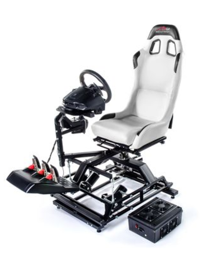

    Hello @RufusDufus, I recently bought a commercially available 3DOF motion simulator. upload_2017-10-27_10-8-28.png
    I will be using it for research and was wondering if there was a way to control the RPM of the motors using the SMC3.io arduino code. I tried adjusting the value of Ki hoping that would reduce the RPM but it makes the motion jerky. My intent is to use the output testing in simtools to adjust the Roll, Pitch and Yaw and I would like to know if there is a way to adjust the speed of the motors. I won't be using the simulator with a game at all.
    Appreciate any help on this from the members. I have read through the entire thread and couldn't find any information for this particular adjustment.

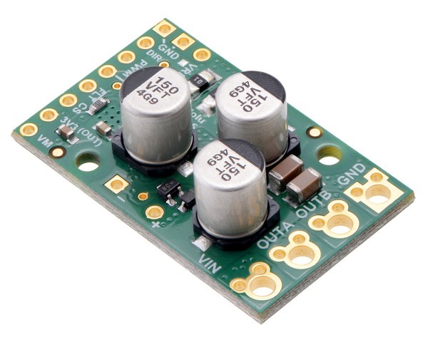

    Hi everyone,
    After roasting a couple of chinesse MM boards I have tried these H-bridges from POLOLU:
    https://www.pololu.com/product/2994
    They are able to handle 25Amps in continuous mode and 60 amps peaks no heat sink needed, I have play them quite hard this weekend and they are still alive. I will post more details on my building thread, but if some one is looking for MM alternatives using SMC3, this ones worked for me.
    MM are cheap and work good, but the delivery time and the faulty rates made me consider some other options. Pololu customer support is great and they recomended me these boards.
    As far as I notice seems that no one have tried them before, so here is my little aportation.
