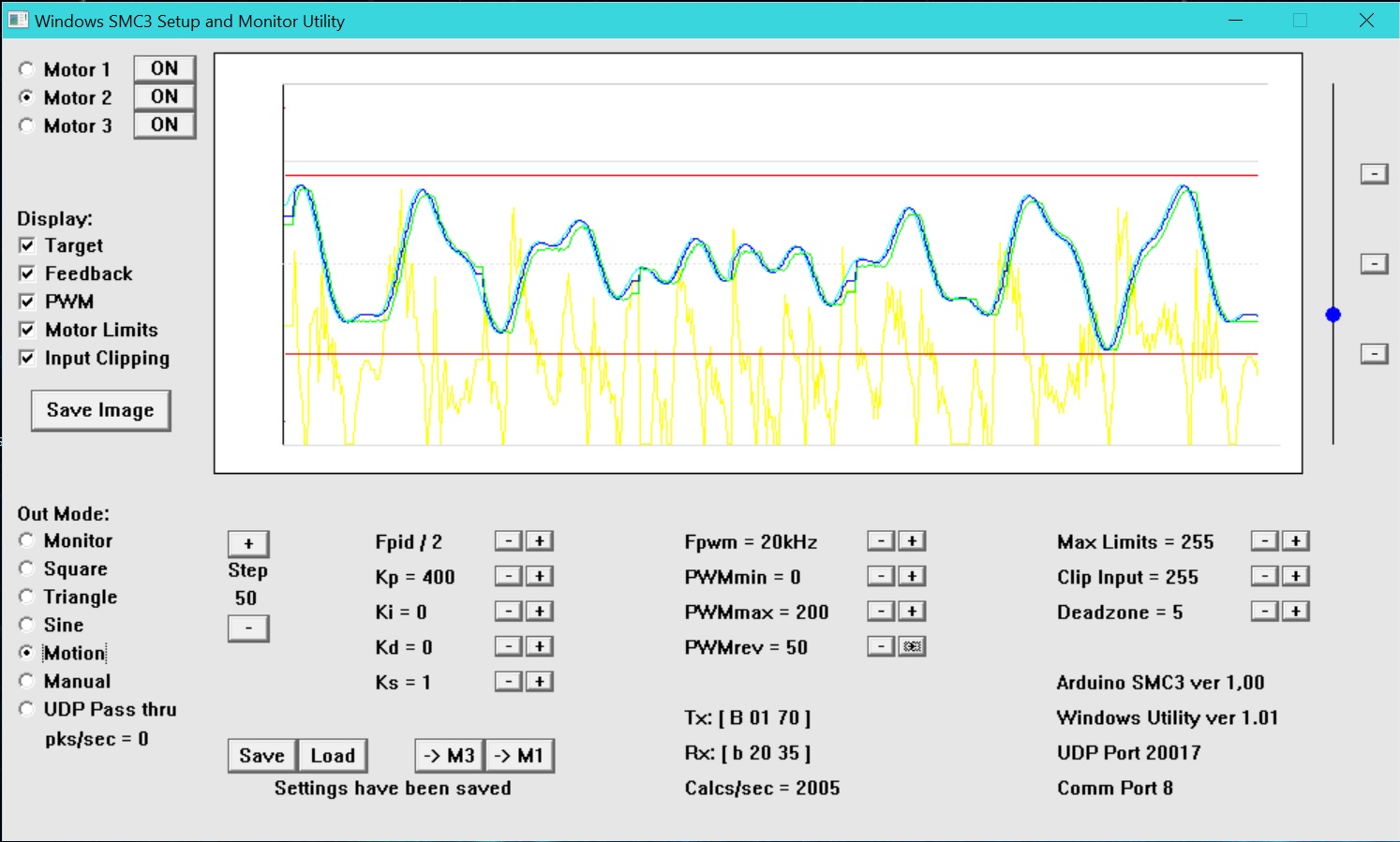

    Hi Pit, I'm using Arduino Uno R3, 2 Arduino IBT2, sensors Hall, 24V 400W 15A power supply and 2 wiper motors of 24V 70W (50rpm aprox). Where do you think is the problem? I'm using this system with Xsim some months and it works. Thank you.

    @franccac Have you tried with PWMmax at 200 or more? Underneath that I think you really can not handle it.

    Yes I've try it, but it goes crazy, if you search in youtube "SMC3 2DOF wiper motor problem" from franccac23 user (yes it's me jaja) you could see an example (I still can not put links sorry). This night I will look again.

    I just saw the video, high chances of being a problem in the potentiometer, I think it is not well fixed or this problem, because when the potentiometer keeps changing without any reading stopped, the engine does not stop because it moves according to the value Of the potentiometer. Try increasing the deadzone value in the SMC program.
    To see clearly in the video that when you hit the potentiometer varies and can not fix the value again by itself.

    I have modified to this parameters (image) and moves okay, but only if I put some weight on the seat.
    I think that the motors have some movement of the axle and the hall sensor detect this movement. I will try with LFS later, and if it works okay with me in the seat I will reforce the axle of the motors.
    Thanks both, I will come with the result.

    "Deadzone This creates a hysteresis zone for the motor feedback If you need values greater than 1, you probably have too much “slack” in your mechanical setup."
    I think you have to review the support of the motor and the sensors, deadzone 5 is enough, you will lose a lot of precision.
    If you compare your old graphic with the current one you will notice how much noise you have in the green graphic potentiometer, ideally it will be noise-free with 0 or 1 deadzone.

    I have tried growing deadzone, I put it to the maxim (20) and I do not see any diference, the motors moves out the axle to hall sensor... Is an internal problem of the motors. Also have some noise in the motors in standby, I will look this when solve first problem.

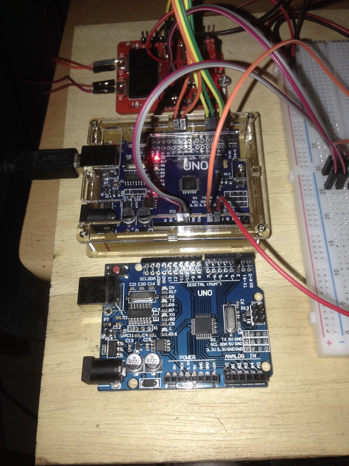

    It's can use with Chinese Uno SMD board? My 1 boad can use SMC3 but Motor and pot not working.

    My 2dof simulator works with a chinese arduino with SMC3 and goes great
    This is the link I used

    My old chinese board can run but new not run.
