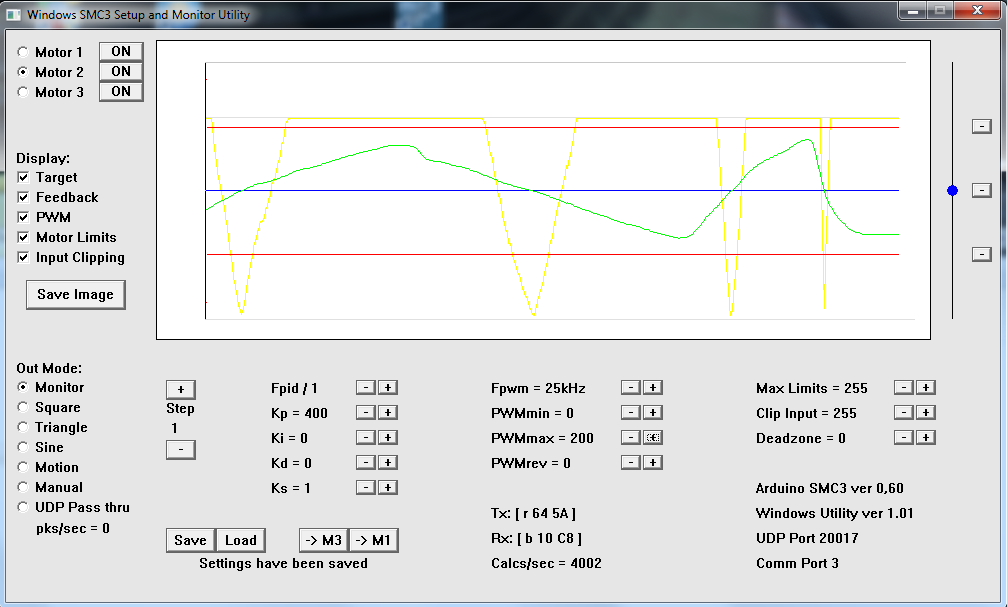

    Please post pictures of all your settings.

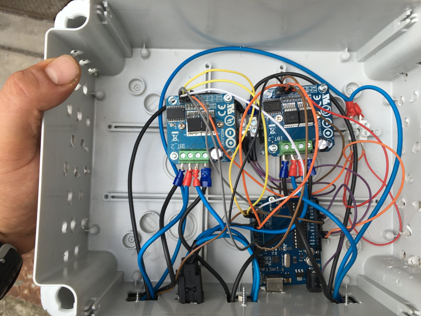

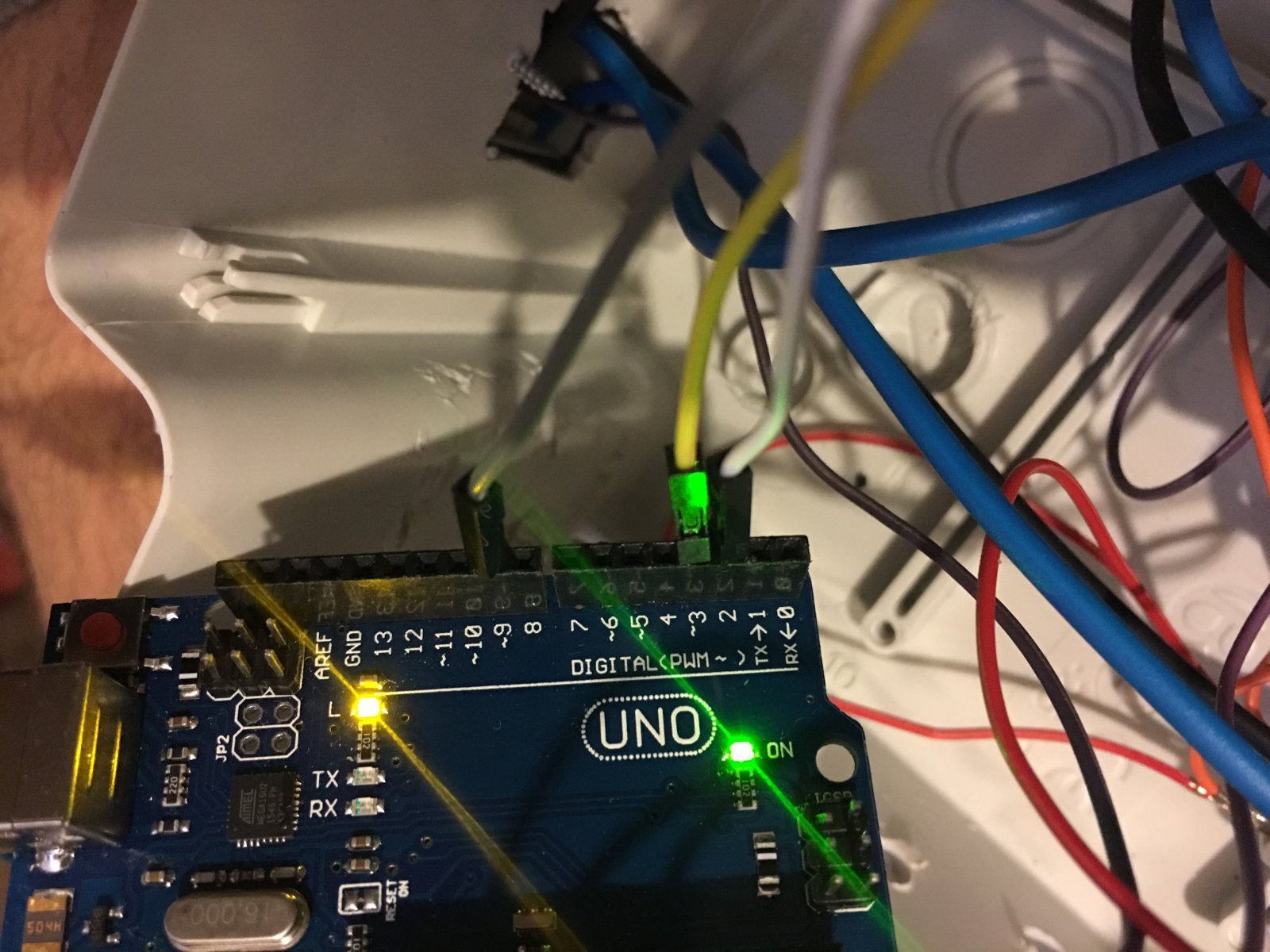

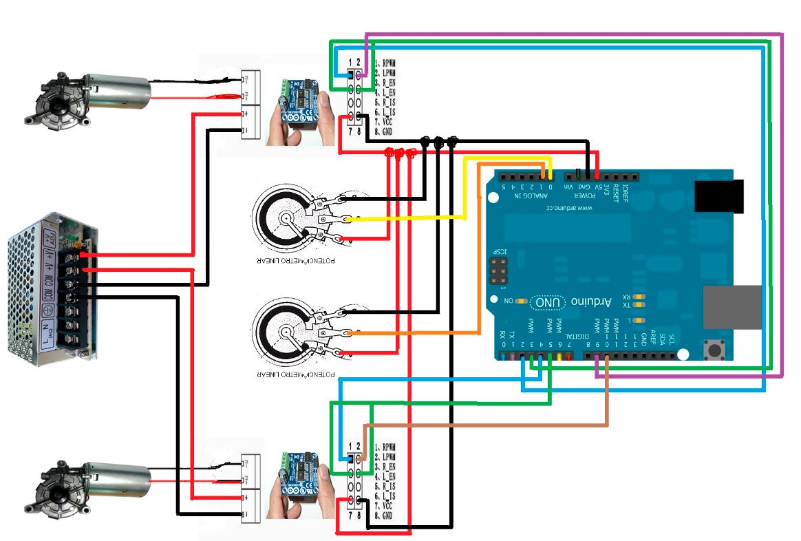

    hello guys, I just finished assembling the IBT - 2 tabs 43A , I did some testing with voltmeter and 12v voltage to the cards but comes at a time when the motors turn the potentiometer is not working and exit the card marks 0v why? when I loaded the code I put defineMODE2

    ui, hardly to understand...better you upload a video, screenshots and/or photos?

    This is the photo of the links
  12. Pit
    3,012
    30,482Coins
    +3,097 / 31 / -0
    ..which does not help. I mean you should upload photos from your wiring, your setup, and not the manual etc lol

    photo is far enough away if you are unable to understand tonight I try to do them again

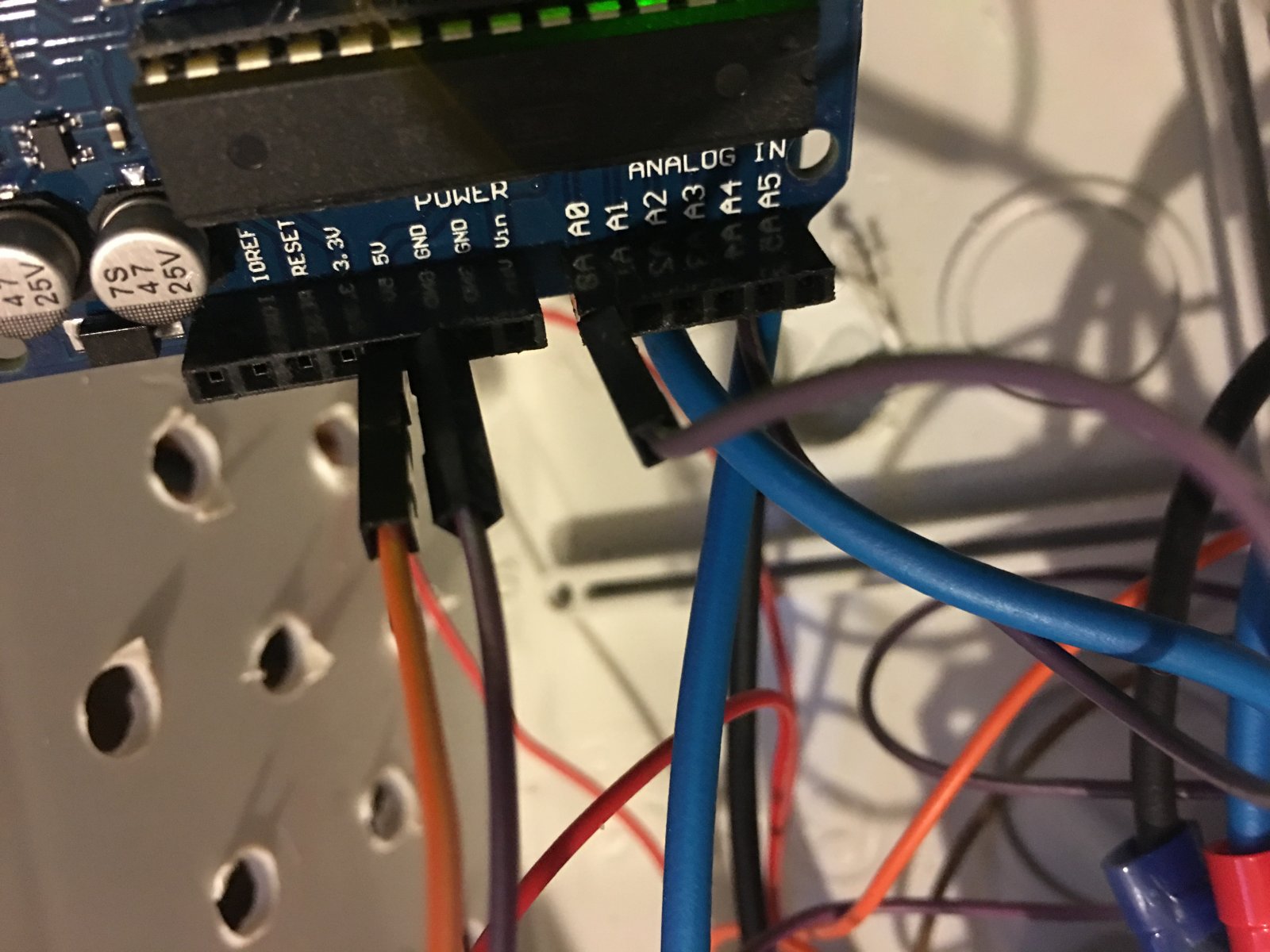

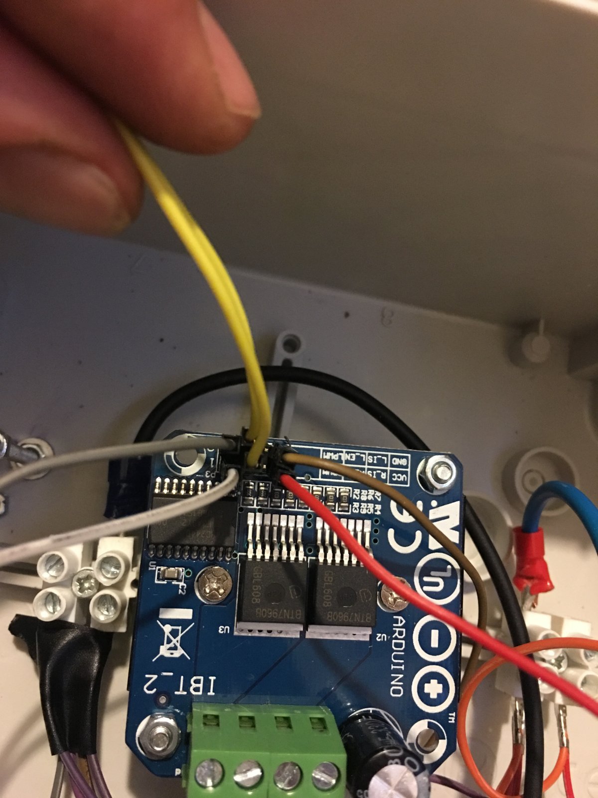

    Tonight I tried to connect one motor but equal , to the board arrive 12v and 5v to the potentiometers , but when I turn the potentiometer the motors are at a standstill , I am attaching photos of a single motor connection image.jpeg image.jpeg image.jpeg

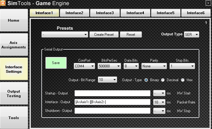

    the photos are fine ? These are the settings simtool

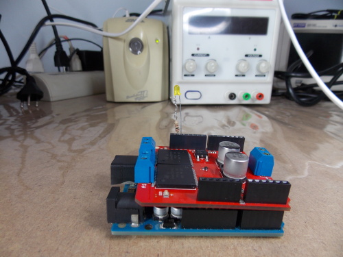

    These two videos are hoping that can be of help , with monstermoto use the mat code while racing with the BTS SMC3.ino code.as you see with the BTS you do not move anything because ? I hope for your help
    BTS:
    MONSTERMOTO:

    When you say mat code do you mean RacingMat's software? Have you had the SMC3 code working with MotoMonsters?
    I'm afraid the information you are providing is very incomplete, disjoint and confusing.
