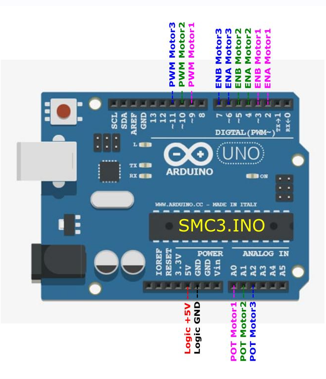

  3. shankar sarkar
    shankar sarkar New Member
    Jul 4, 2022
    14
    INDIA
    69Coins

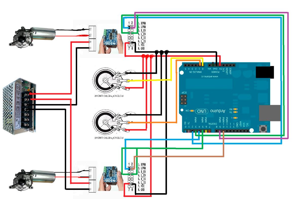

    3DOF, DC motor, Arduino, Motion platform, 4DOF
    what i mean is - the diagram which i got from the diagram from the documentation of smc3 shows only two motors and 2 IBT-2 i was wondering about the third motor.. PWM will be the next one i.e. Pin 11 but the other two ?
  4. shankar sarkar
    Jul 4, 2022
    14
    INDIA
    69Coins
    this is what i have
  5. Joe Cortexian
    Sep 8, 2021
    270
    1,622Coins
    +75 / 1 / -0
    Literally the first page of this post.

    The other pins are 6 and 7 on the arduino board when i am not mistaken.
  7. shankar sarkar
    Jul 4, 2022
    14
    INDIA
    69Coins
    I'M SO SORRY...no really i mean it... i straight went to the diagram never gave a look at the one you have shown...Thanks buddy.

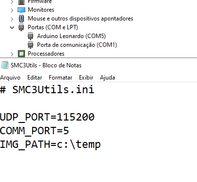

  18. Talesgc
    Talesgc New Member
    Jul 15, 2025
    38Coins
    Motion platform
    Not working here too: upload_2025-7-31_21-57-27.png
  19. noorbeast
    22,185
    154,750Coins
    +11,196 / 57 / -2
    SMC3 is written for the Arduino Uno R3.
