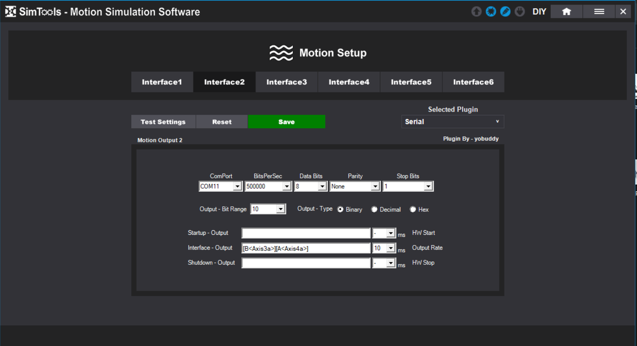

    Hello all, maybe someone can help me please? I am in the process of building 6DOF flight simulator and have already set up a lot using 2 x Arduino Uno R3 and SimTools latest version. I managed to connect 3 motors to each Arduino and can control the first 3 motors by e.g. Microsoft Flight Simulator 2024. The other 3 motors i want connect on the 2nd arduino. My questions are:
    1) Can i connect both Arduino's via a small separate usb-hub and
    2) How do i adress them in SimTools (I can only select one com port at a time).
    Appreciate your help and advices very much! Kind regards, Piet

    #1 Yes, use USB hub
    # Go to Interface Setup, and set the 2nd arduino board in the Interface2.

    Hello "prophet", following your advises i have connect the first arduino on com3 and the second arduino on com 4 now (both via a small hub). Arduino 1 on interface 1 and arduino 2 on interface 2.
    How do i assign the 6 axis in SimTools? Thanks for advice!

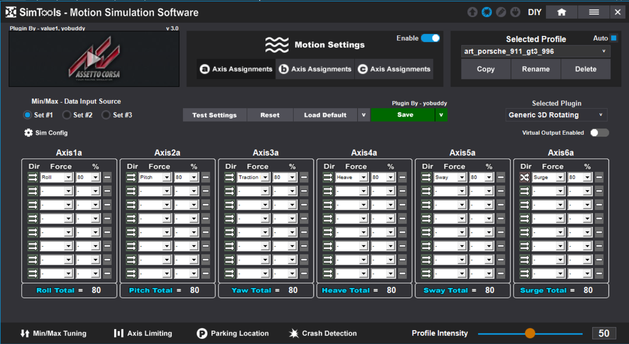

    I am new on SimTools 3. I read the manual and this is what I got from the reading
    The rest still default, as I am still learning... :D

    Normally, unless there is a specific axis dedicated to a single/sole axis, allocations will be split vertically among the range of available axis.

    I was actually confused when I read the manual, here is the screenshot of page 95.
    I am expecting tipical axis and dof assignment just like you said, at least that what I read a lot on the Simtools V2.
    So for the V3 should I do the 'split vertically' like on the V2?
  16. noorbeast
    21,555
    150,950Coins
    +11,025 / 56 / -2
    That dedicates 20% 0f the available range to be dedicated to a particular axis, but each motor has to serve multiple such axis, each a further allocation from the available range.

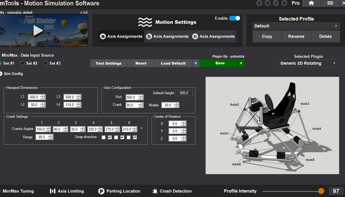

    +31 / 0 / -0
    Noorbest,
    My build is 6 DOF stewart with Rotating arm.
    So I am on 'Generic 3D Rotating' plugin.
    Here is my Simtools v3, and it is a live and make motion that makes sense. But I am curious of your comment above. Now I wonder if my axis assignment is not optimal.
    How should I set my Axis assignment? would you mind shedding some light for me please? I hope you can show me an example of the axis assignment I can try and then adjust, more like learning by doing.
  18. noorbeast
    21,555
    150,950Coins
    +11,025 / 56 / -2
    What I mean is if you take, for example Axis 1A, and consider what it needs to serve, in what axis allocations can be allocated to it, is not dedicated, but instead contributes to a range of designated partial axis allocations, for example, as a partial list, it needs to serve concurrently roll, pitch, surge, sway and heave.

    I suppose you mean Axis 1a and 6a should be assigned for Pitch, Surge, Roll, and Heave.
    But then I'm confused with the "Roll total" on the bottom of the Axis 1a and "Surge total" on the Axis 6a.
  20. noorbeast
    21,555
    150,950Coins
    +11,025 / 56 / -2
    The 'total' % is, as I understand it, a partial percentage of what particular and partial axis assignment can be allocated to that particular motor/actuator.
