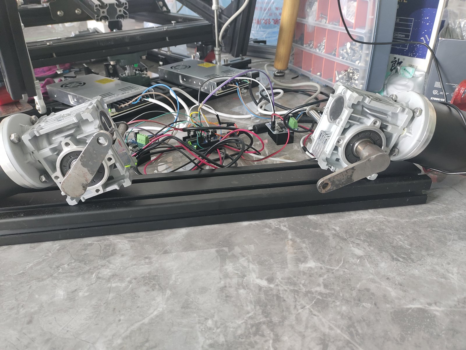

    Hello, I had a strange problem when I was making it. My smc3 until and simtools initial positions are not the same. My build uses two motors that extend about 30 degrees out in the starting position. The picture is of my smc3 until the initial position, then when I open simtools, both motors will automatically deflect about 30 degrees, and there will be this mutation every time when running through 0 and 1 of the axis.
    Due to forum rules I can't send pictures, so I can only describe my problem in as much detail as possible.
    In the smc3until program, both of my motors run normally and smoothly, but when the axis of simtools passes through 0 and 1, there will always be a sudden change, automatically rotating through a range of 30 degrees.
    I can't send pictures due to forum rules, so I'll just try to describe my problem in as much detail as possible.
    In the smc3until program, both of my motors ran normally and smoothly, but there was always a sudden change when the axis of simtools passed 0 and 1, automatically turning the range of 30 degrees.

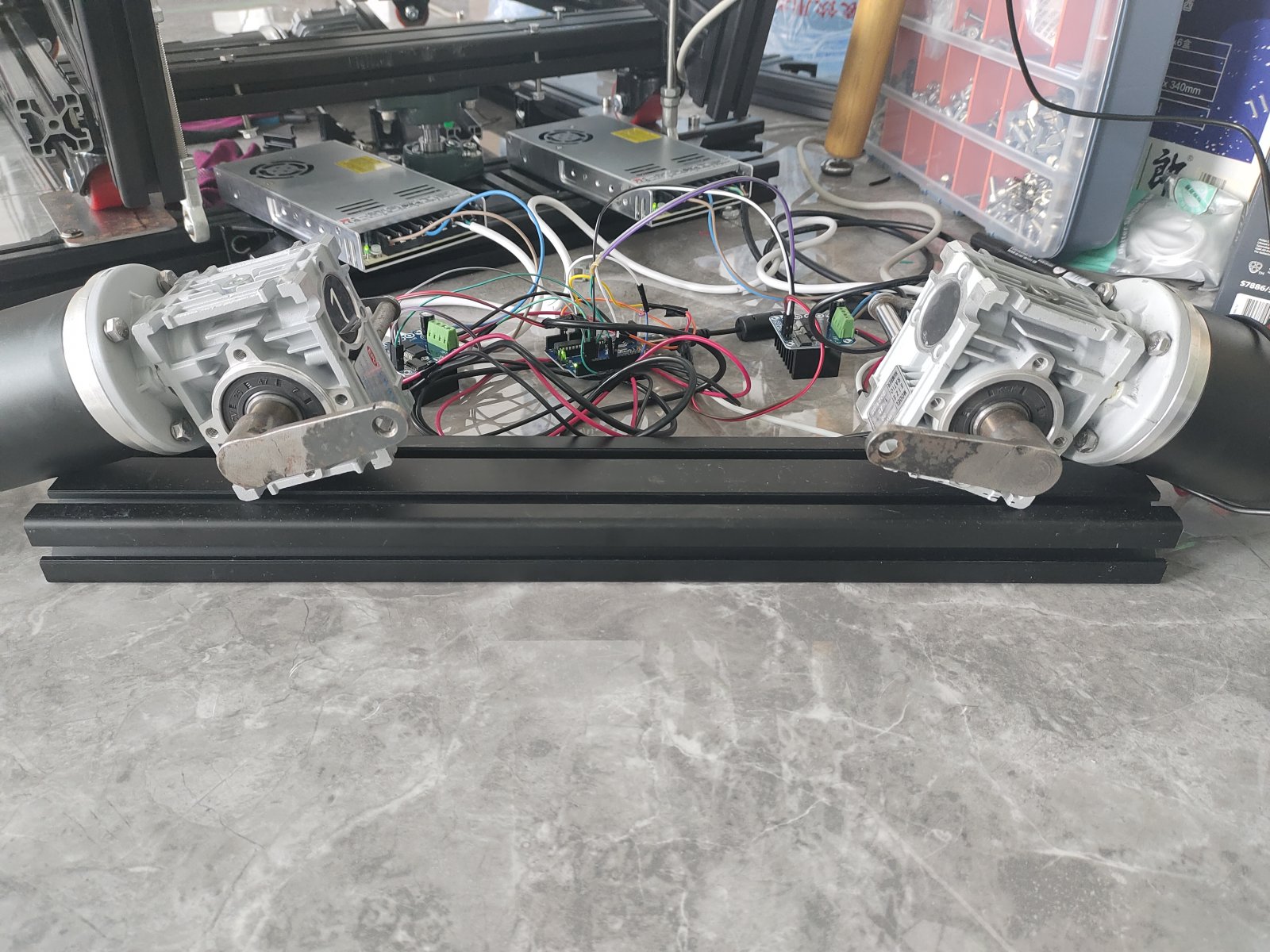

    Oh, it looks like I can send pictures, the first is my smc3until initial position and the second is my simtools initial position.

    Hello, my problem has been solved today. I have done two things, one is to update the simtools software and plug the interface tightly. After that, the initial position of simtools and smc3until is the same. Because I did both things at the same time and then tested them, I don't know what the problem is, but it has been solved.:grin

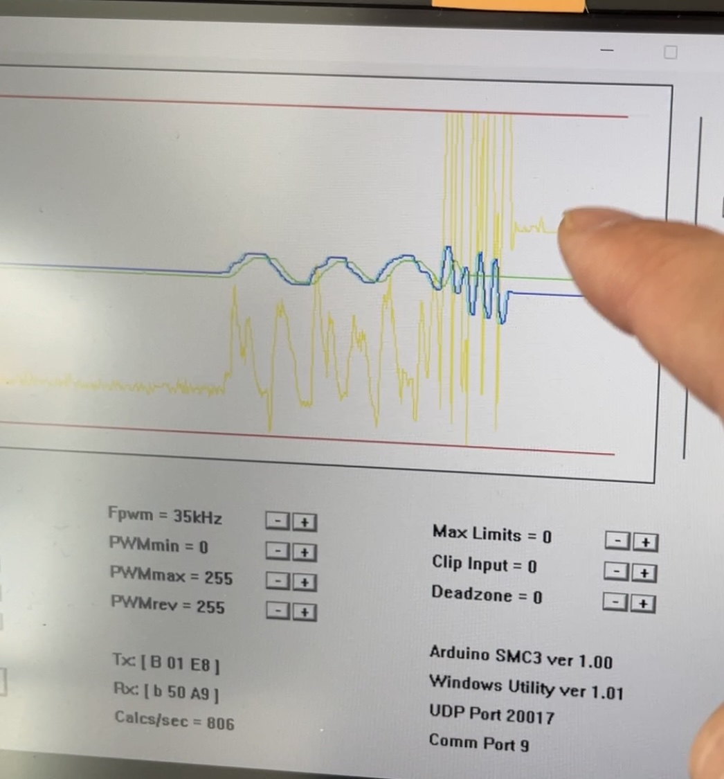

    Question: Why did the motor stop moving after I slide the dial (on the right side) very quickly?
    The motor is back to normal (able to rotate again) right after the power cycle on the 24v power supply.
    I use IBT-2 motor driver.
    10K pot connected directly to the motor shaft (where the arm is attached).
    I tried all the settings on the Utility, and it didn't seem to solve this issue.
    https://tinyurl.com/hx47725v

    I tried the 2nd board and act exactly the same. Perhaps both are bad?
    Do you notice the Yellow line (PWM) clipped on the top? I never see those on other people picture. I wonder if this is the problem.
    Seems like when I slide the motion and manage not to get too fast, and the Yellow PWM line is not clipped, the motor moves just fine.

    A clipping yellow line means the PWM value is at 255, so maximum output power.
    For further diagnostic, I suggest you try to try the following
    1. Measure the voltage of the PSU after the motor stopped moving. Maybe the PSU can't supply the power needed for PWM 255 and turns off.
    2a. Reduce maxPWM in SMC3tools. Try Values like 100 or 200. The maximum power of the motors will be reduced, so this way you can confirm that the issue only arises if the demanded power is too high. Even with reduced power, the motors might still be powerful enough for a satisfying experience.
    2b. If you are running a 24V system, reduce the voltage of your PSU. I think I read multiple times that cheap IBT2 don't like voltages above 18...20 V.
    I just noticed your screenshots show that you didn't just move the slider quickly (in one direction), but you moved it _back and forth_ quickly. This might mean that your problems are caused by regenerative currents. If that's the case, the PSU should turn off when the motor stops moving.

    Never set the Fpwm higher than 20kHz, you will burn IBT2 momentarily, take care of the supply from the fan to the IBT2 heatsink.
    Lower the voltage to about 18-19V,
    Alternatively, do what I did and replace the IBT2 with this controller
    https://www.xsimulator.net/community/threads/reasonably-priced-100a-motor-controllers.17638/
    I have been using it for a few months and it performs very well, powered by 24V.

    Hi Sebastian...you are correct point #1! When I got the motor stopped turning, the PSU went down from the normal 24V to 3.58V.
    Thanks for helping me narrow down the issue to debug this continually. I might need bigger PSU.
    I am using MeanWell SE-600-24. Link. Output, 24V, 25 Amp, 600W.
    My motor is 24V 350W 3000RPM. Link. -> nominal run current is 14.6A
