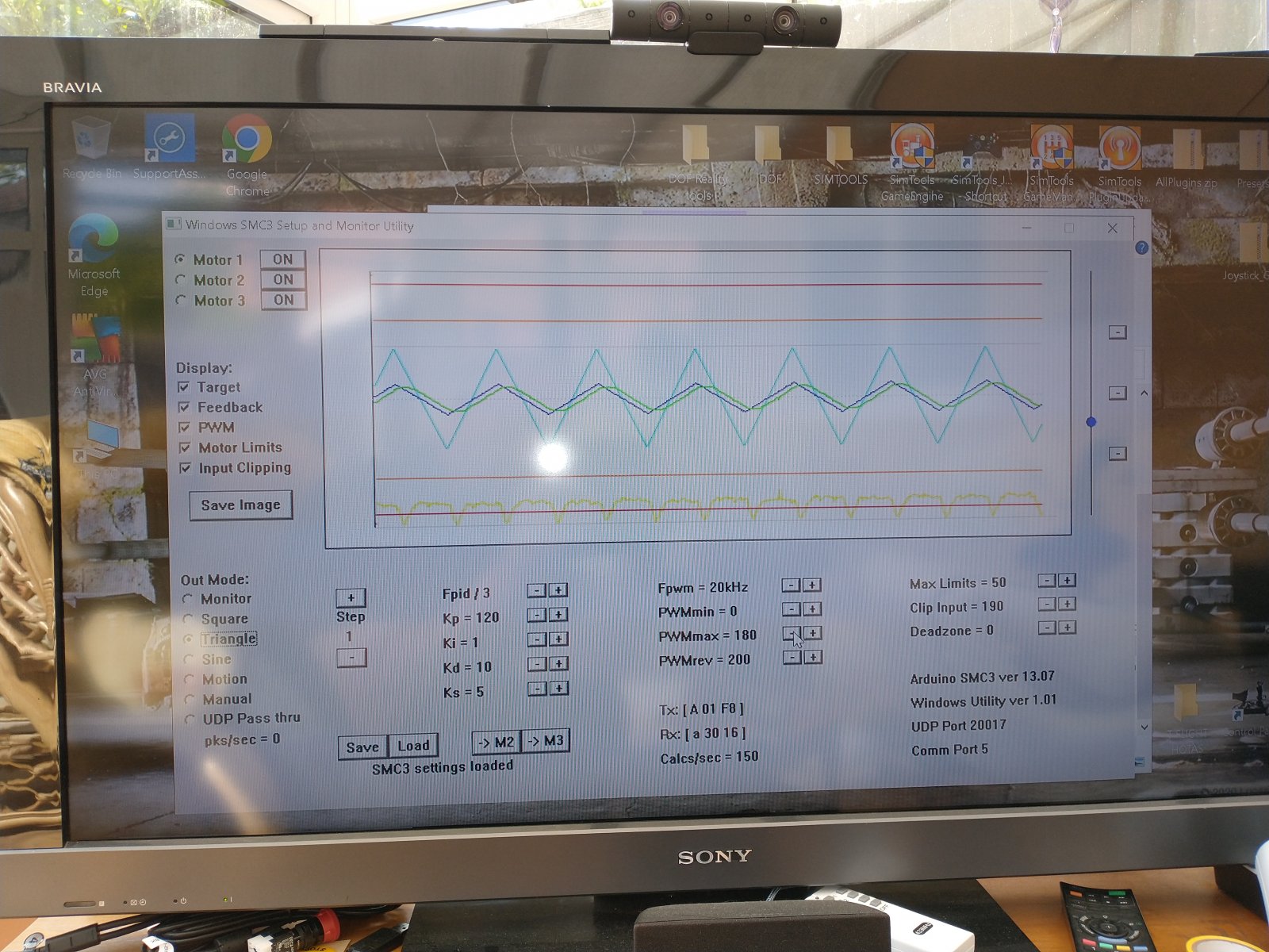

    3DOF, DC motor, Arduino, 6DOF
    This is what I have. It does not mean it is the best setup, but it seemed to work.
    Pierre.
    21,735
    152,183Coins
    +11,063 / 56 / -2
    I doubt PWMmax and PWMrev values need to be that high, but the rest seem to be pretty sensible.
    My guess would be try PWMmax and PWMrev at 120-150 and run Sine to see how well it tracks.

  7. ampcode
    ampcode New Member
    May 13, 2023
    17Coins
    Can someone explain me difference between Target sent and Target recv plot? light and dark blue?
    And why for some those are equal and for some, like me, they are not?

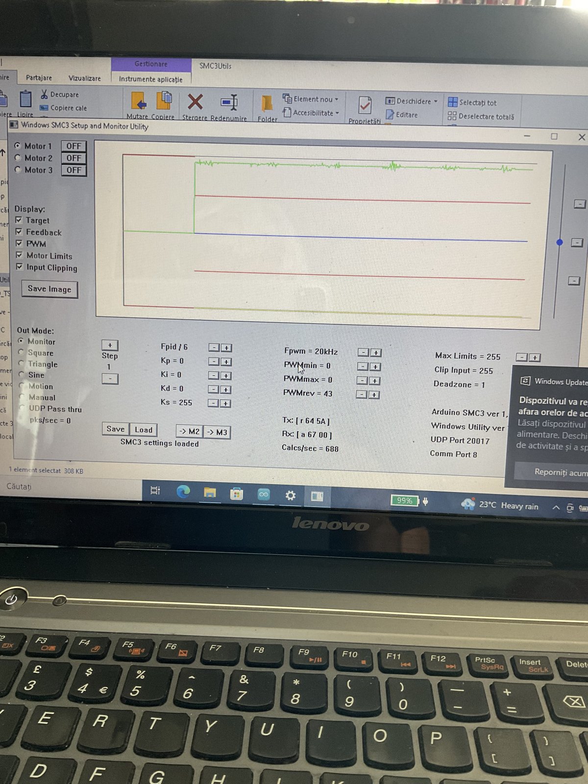

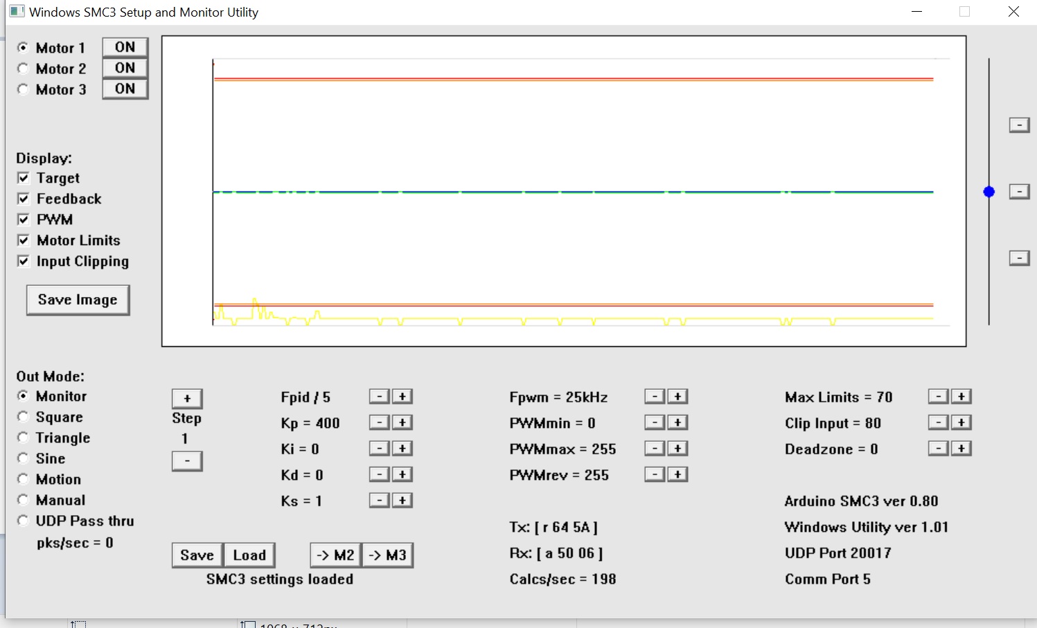

    Hi, I am working on a 2DOF and Built the control part with unoR3 and IBT-2
    when trying to use SMC3 utility to find the right parameters I met the following problem: after the utility establishes connection with the Arduino board I cannot turn on any of the motors, all appear turn in off and cannot be on again!
    Any suggestion?

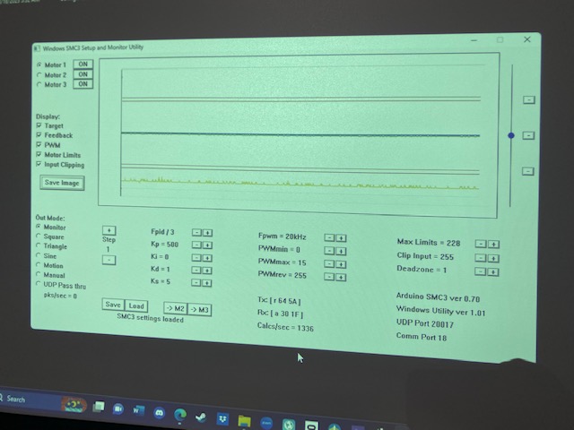

  14. Pierre Lalancette
    Dec 11, 2016
    1,006
    Tech Artist
    Quebec, Canada
    8,044Coins
    +944 / 6 / -0
    Are your potentiometer at the middle? If not, they trigger the safety stop.

  16. Bagslo
    Bagslo New Member
    Jan 31, 2023
    - 20Coins
    My potentiometer îs the green line

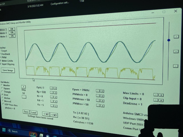

  17. Pierre Lalancette
    Dec 11, 2016
    1,006
    Tech Artist
    Quebec, Canada
    8,044Coins
    +944 / 6 / -0
    It should be in the center as your actuator is in the center and follow along. In this video, my actuator is a bit up and so is the green line.
  18. ChuckyP
    ChuckyP Active Member
    Sep 21, 2020
    122
    Chicago, IL
    748Coins
    +64 / 0 / -0
    It does appear as Pierre mentioned that the potentiometer is not centered and is outside the safe limits which will cause the motors to shutdown. With your motor arms centered you need to turn the potentiometer until the green line matches the blue line. Make sure you followed the instructions for setup and limit the power going into the motors until you verify the wiring is correct, or the motors can run away on you.
