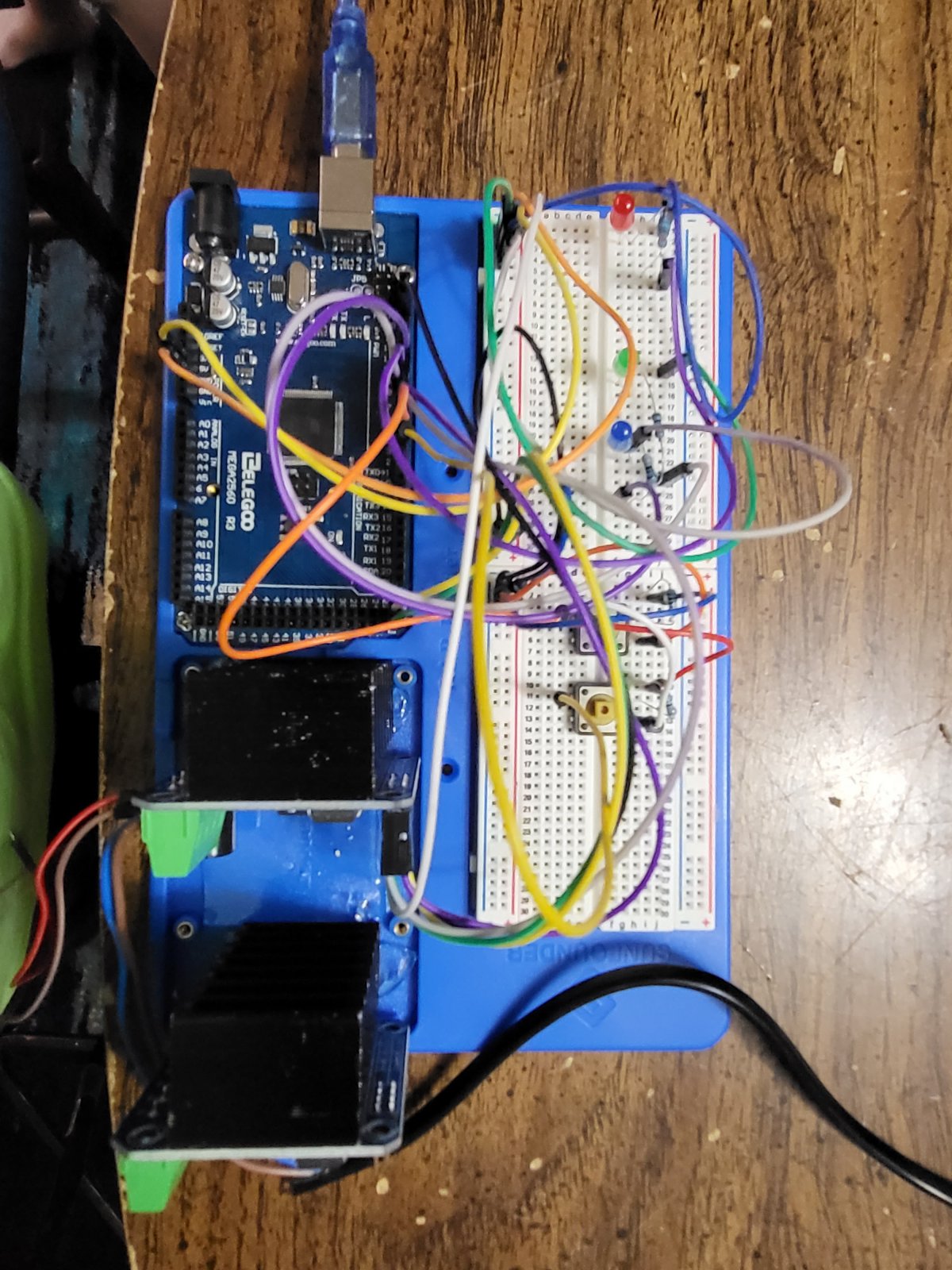

    hello guys i new to all the forum stuff so please be patient with me!!
    I follow dmax on YouTube and built my rig because of his videos. Now the only thing i did different was put my motors up front, and my motors are mirror image motors! So trying to figure out which ways need to be up and down is being a challenge but ill figure that out later as the 2 front motors work perfectly. my issue is with the 3rd motor for traction loss everything seems to be wired correctly and the motor only moves one way!!! the green line confirmed follows the blue so the pot and the motor seem to be wired correctly as it doesn't lose control all the way to one side or anything!! i know i had reflashed the arduino before when getting the front motors working correctly and forgot to set it to mode2 for the ibt controllers and they would only move one way like the 3rd motor is doing now!! any ideas???
    21,666
    151,650Coins
    +11,045 / 56 / -2
    So to be clear, if you are using ibt controllers the SMC3 code needs to be edited for Mode 2.

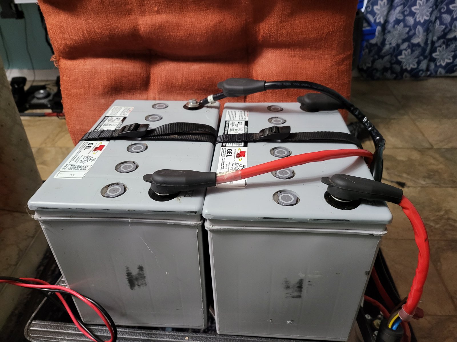

    Battery Bank

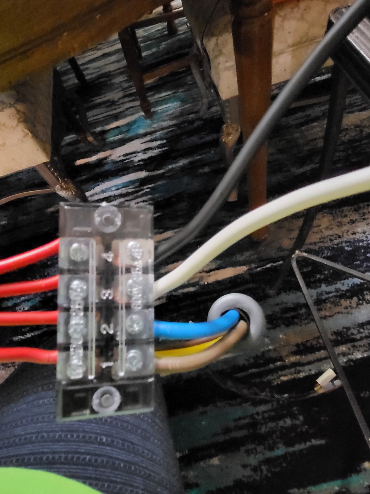

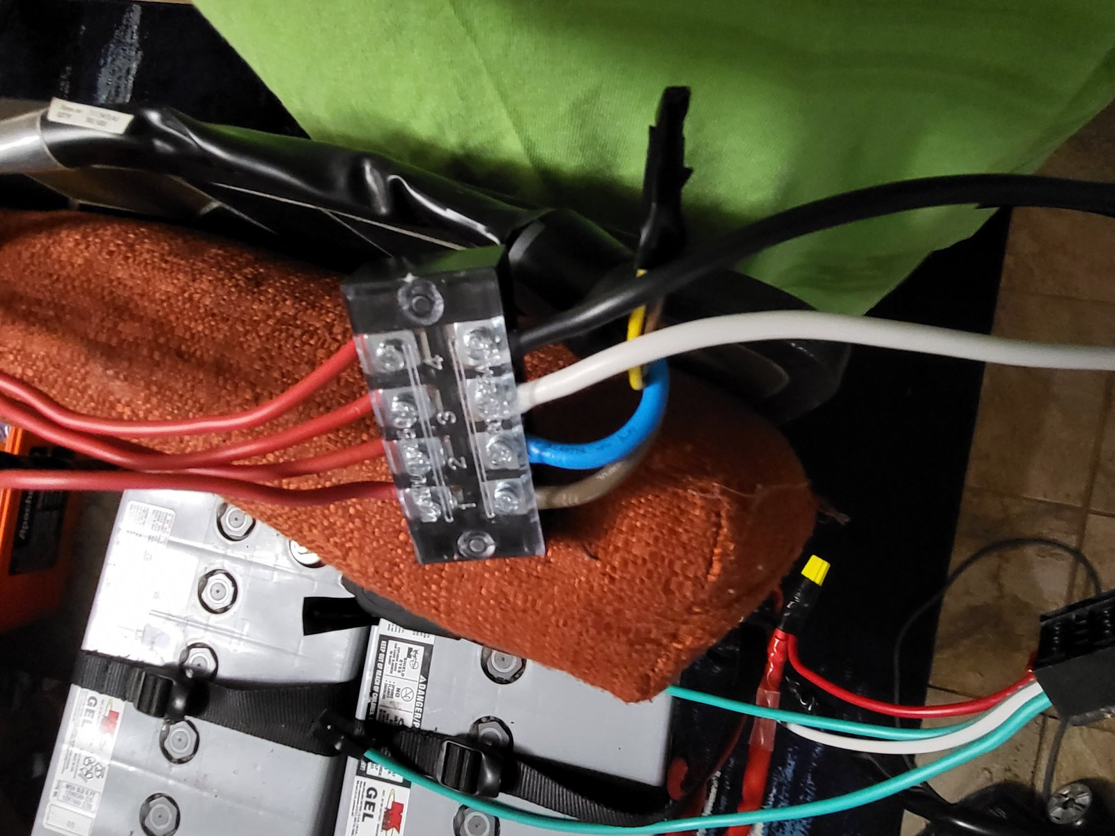

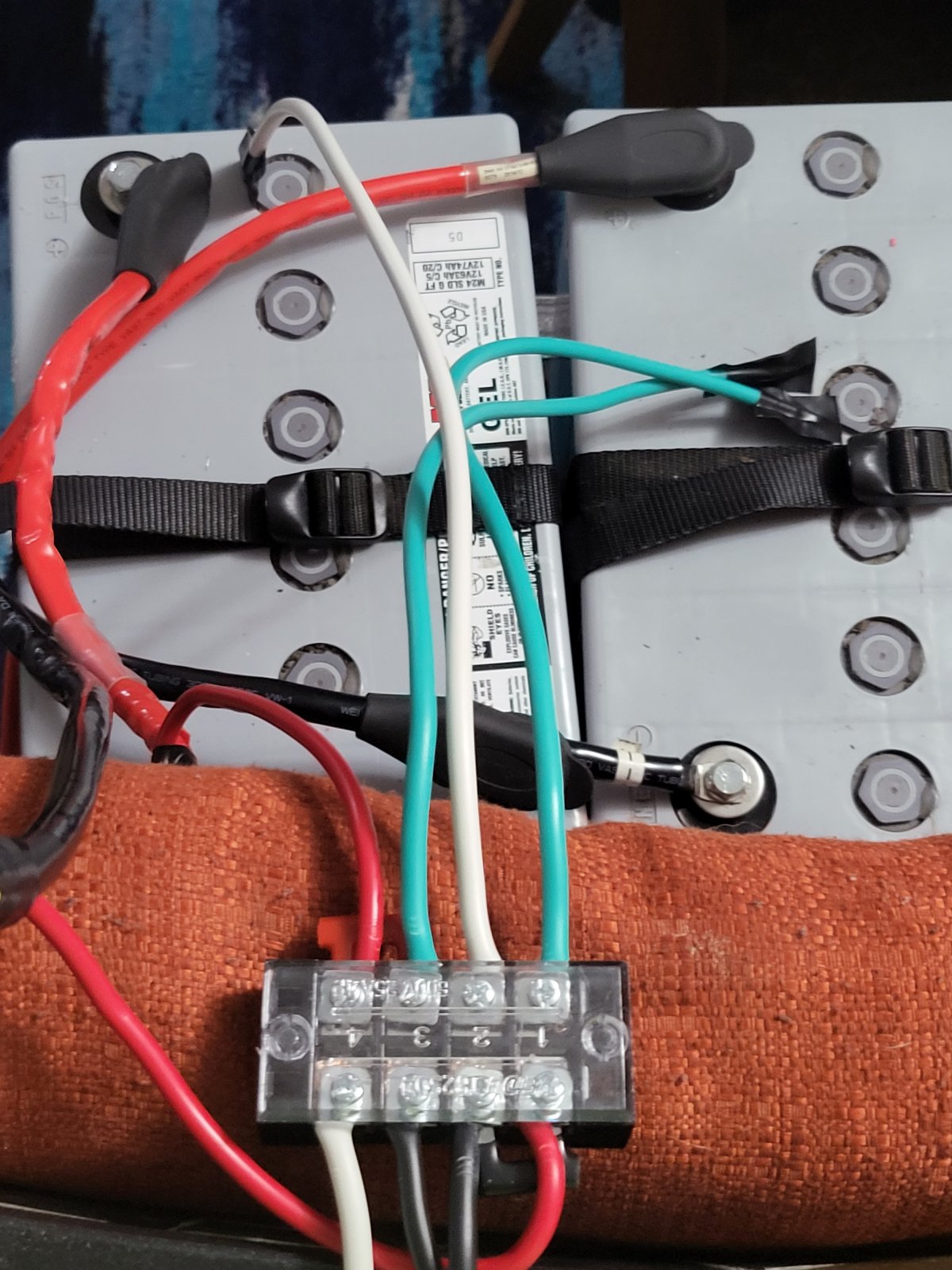

    20220107_183448.jpg 20220107_183607.jpg 20220107_202834.jpg 20220107_183448.jpg
    Wiring harness hookup

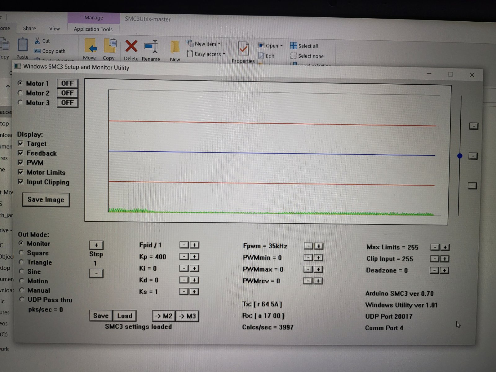

    I need some help, I am having great difficulty in getting windows Smc to power my motors. I have tested the controllers and motors and am using the coding from the 3.dof page. What is happening is the feedback green line goes directly to the bottom. I am using the POT from digikey but just can't get the green line to get off the bottom. Any help would be greatly appreciated. Have a good night.
  17. noorbeast
    21,666
    151,650Coins
    +11,045 / 56 / -2
    Is the pot centered when the motors/lever are in their rest position?
    When they are, make sure the motors are not powered, disconnect the pot, rotate it by hand until the line is in the middle of the SMC3 graph, then reconnect it.

    I wish I knew what I was doing wrong. I moved the POT around several times and still cant get the feeedback line off the bottom. Does anyone have any other advice or suggestions.

    This is what it keeps doing, any suggestions would really be awesome.
