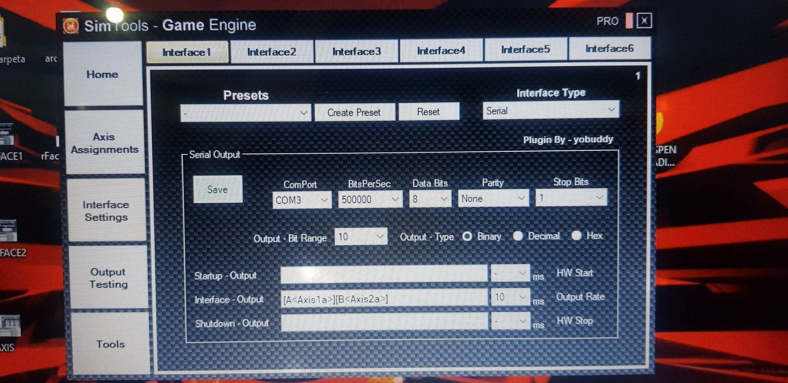

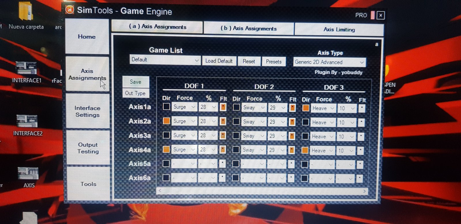

    2DOF, DC motor, SimforceGT
    hello friend in the smc3 they work well with the preset movements if there is everything works well you can go to the configuration of the game engine of simtools. Now I am going to upload a configuration for you to copy and test.
    In the second photo it puts the configurations in axis1 and axis2 because axis3 and axis4 would be for the third and fourth motor and if surge and sway do not give you movements, try pitch and roll. 20210905_203932.jpg 20210905_204002.jpg

    Thank you so much @moaale. That's really kind of you to post these settings so fast!
    I have replicated them exactly, and also tried pitch and roll, but unfortunately there is no change. It feels like there is something missing between Simtools and the Arduino. They are just not communicating.
    When I start SMC3Utils v1.01.exe, there is often a small movement in the motors, and then while it is running there is a very quiet rumble coming from the motors. But there is nothing once I close SMC3Utils v1.01.exe.
    Am I correct that if I turn on Output Testing=>Axis Testing and then move the sliders, my motors should move in response?
    Thanks again!

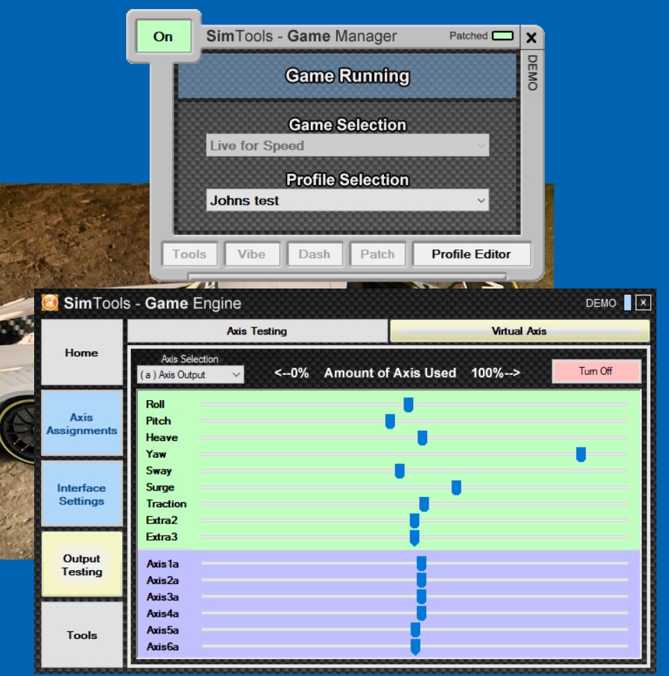

    Hi @noorbeast
    I think Output Testing, or even Output in general, is where my issues lies (but happy to be corrected though), and maybe my expectations are incorrect. Output Testing currently does nothing at all, with regards to my motors. If I turn on Output Testing=>Axis Testing On, and then move the sliders, should my motors should move in response?
    I certainly see all the movement from LFS in Simtools Virtual Axis dashboard (see screenshot) when running LFS, so does that indicate that the game is correctly communicating with Simtools and the issue lies elsewhere, from Simtools to the Arduino?
    Thank you very much noorbeast
      File size:
      140 KB
      Views:
      370
    22,185
    154,750Coins
    +11,196 / 57 / -2
    Do you have a Default profile configured in Axis Assignments, as that is what Output Testing uses?
