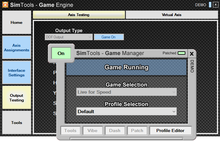

    SimTools 1.3 is obsolete and not maintained, nor are plugins.
    In your settings Parity should be set to None:
  2. mhchong
    mhchong EK99
    Feb 28, 2021
    17
    freelancer
    malaysia
    - 120Coins
    Yeah!! Now it works. Thank you so much.

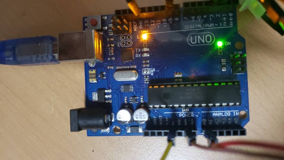

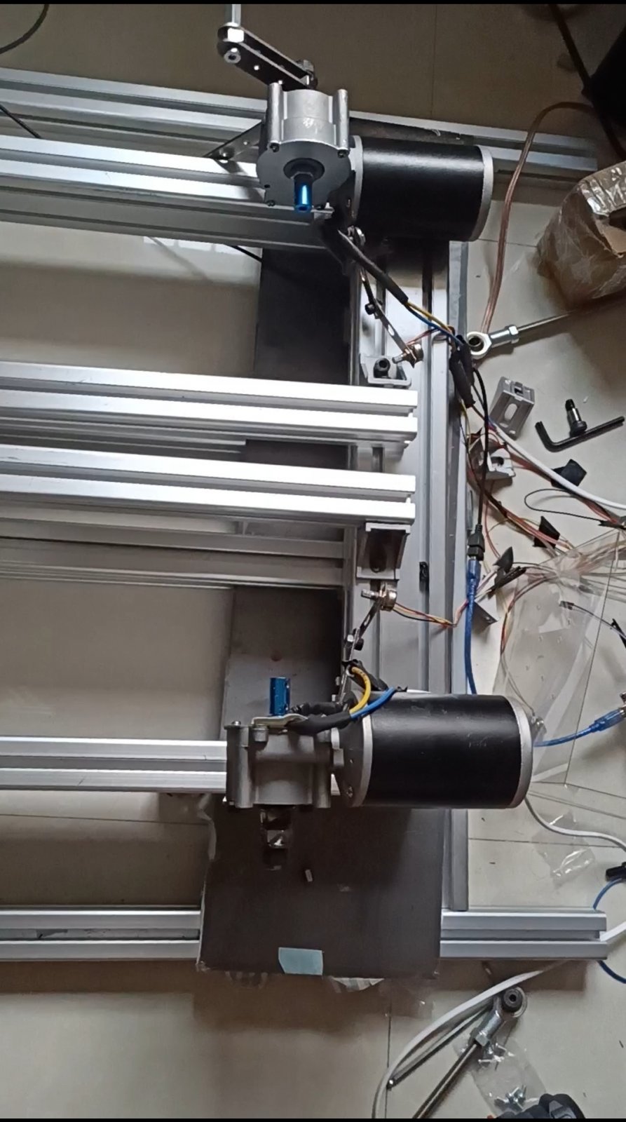

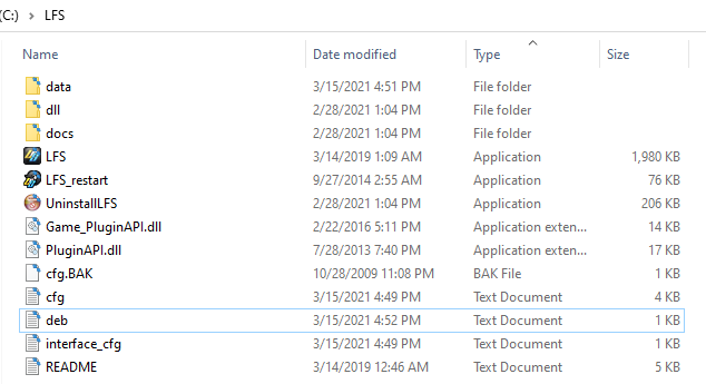

    Another issue was when running LFS, The motor was not moving, Arduino light Rx ON, Tx OFF.
    Game_PluginAPI.dll was pasted to LFS folder

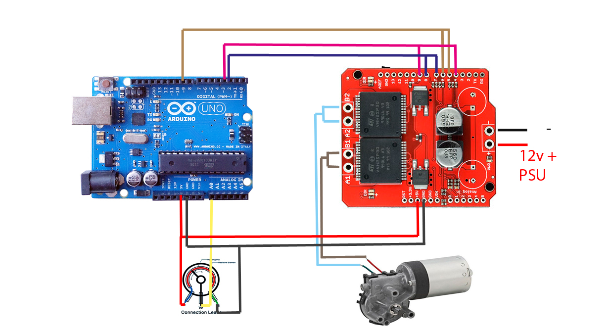

    I am totally confused.... and need some help!
    I have previously tried setting this up on a test bench and it was working fine. I have now wired it the same way on the sim rig but it seems that when i power on the motor power supply, this causes the ardruino to shut down, so i am suspecting a short or something. I have tried multiple arduinos (x3) and also tried another 3 mms and the same thing is happening. I can confrim that the motor PSU is outputting 12v and polarities are fine.
    The VERY strange this is that i am getting 12v out of the MM 5v and gnd outputs!! however this seems comon for all my MMs, so i am assuming that its something from my end. I dont think i should be getting 12V right?
    Wiring exactly as below:
  7. Ian Pace
    Ian Pace Member
    Dec 17, 2017
    72
    Gharghur - Malta
    39Coins
    +28 / 0 / -0
    Figured this out and it was super ridiculous! My son was playing with my multimeter and decided to swap the test prods and due to that I reversed polarity!!

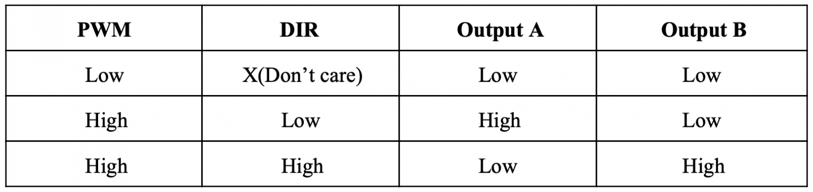

    I'd like to use the Cytron MDD10A with SMC3, but I can't for the life of me figure out how I might be able to wire it to work with SMC3. The MDD10A is a dual motor driver, and has one Enable/Direction pin and one PWM pin per channel. I've attached the truth table, any guidance would be much appreciated!
    22,086
    154,124Coins
    +11,170 / 57 / -2
    @Blame73 has used the MD30c, so would likely be the best person to advise, though you could check the similarity and differences between the Cytron MDD10A and MD30C: https://www.xsimulator.net/community/threads/blame73s-2dof-seat-mover.6029/page-22#post-198335

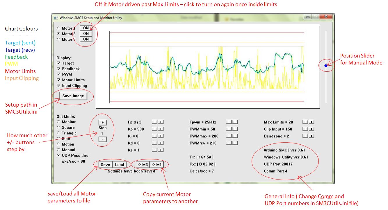

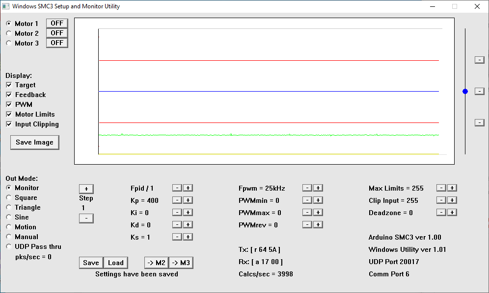

    It seems I may have had more than one issue, as my pot/feedback when my actuators are lowered stays above 0 (I've attached a screenshot of the window including feedback line). I can't enable any Motors when this happens, and the range of my pot is ~54-954 (it's mounted to the actuator shaft). Are there any ways to adjust an offset of the pot?

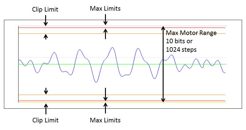

    its a grate job but it has a big limitation in the clip input parameter, for example if i use a hall sensor pot with 0-360 deg movement , it is impossible to limit the movement of the shaft in the range of +/-45deg because the max value of the clip input is 255 and the shaft movement will pass the this angle range with an undesire movement. so why dont you extende max clip input to 512, pls

    Just wanted to add this for whoever could benefit-
    Center offset can be adjusted by changing the lines with analogRead for each feedback pin, like this:
    Feedback1 = analogRead(FeedbackPin1) + CenterOffset1;
    CenterOffset(1/2/3) are declared at the top of SMC3, but never used.
    If you change it to this line and give the Offset a negative value, that motor will go up initially. If you give Offset a positive value, that motor will be lower initially.

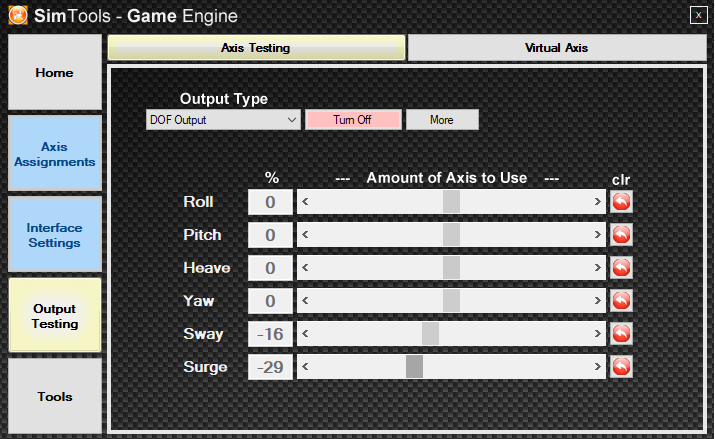

    Help me please. I have not found an answer to my question on this forum. Therefore, I describe my problem. I had SimTools_v1. 3 and firmware from racingmat and everything worked fine. When I reinstalled and installed SimTools_2. 5.1 firmware SMC 3 v1. 0 and SMC3Utils v1. 01. In SMC3Utils, all engines work fine. At the moment I have only two engines, I will soon put on the third engine (the engines strictly repeat the movements behind the blue dot). But when I turn simtools into output test mode, one motor loses center and lowers slightly, and the other motor rises up even if the sliders are in the center. (Potentiometer loses center !!! ???) What is the reason and how to fix it?
  16. yura999
    yura999 New Member
    Aug 6, 2017
    27
    327Coins
    and then in the game it is saved (the chair is crooked).

    I still managed to solve my problem:)! As it turned out, the problem is changing the language of programs that do not support Unicode. I had a Russian (Russia) I changed to English (USA) and the simulator seat leveled out, the potentiometers moved to the middle position. But I noticed that after these changes, Simhab could not write the sketch to the Arduino uno r3. I also couldn't install Microsoft NET Framework 4.8. For some reason, the program doesn't load! I had to change the Unicode language again to the old settings and immediately everything was loaded and the firmware in Arduino and the Microsoft NET Framework 4.8 program. What is now every time to change the language in Unicode??? Maybe there is some other option?:sos
  19. noorbeast
    22,086
    154,124Coins
    +11,170 / 57 / -2
    The language setting is a known issue: https://www.xsimulator.net/community/faq/simtools-language-setting-bug-change-to-english-local.233/
    But it also seems to be related to particular computers and as far as I know @yobuddy has not been able to pin down why. As language seems to also be affecting other programs that may give further insights.

    I believe this is due to the game plugin API passing the incoming data as a string rather than an object.
    Then when the data is cast back from a string. it causes the problem I believe.
    SimTools v3 should completely eliminate this problem, as the game API now directly imports game data.
    (and we are not passing it from one app to another, game manager to game engine)
    And just so everyone one know, v3 will be a free upgrade when it arrives.
