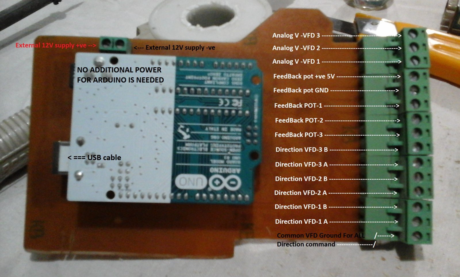

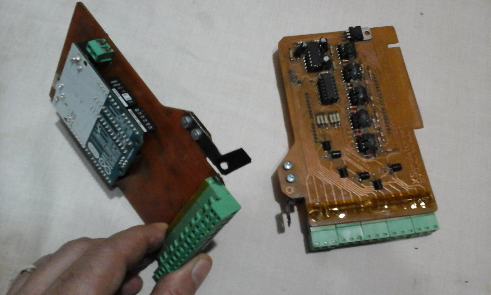

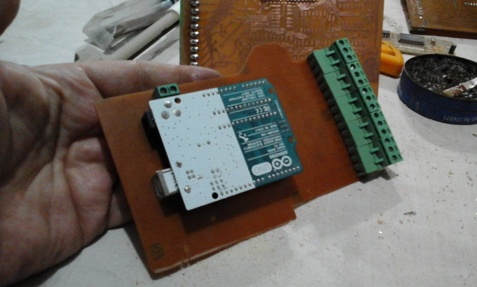

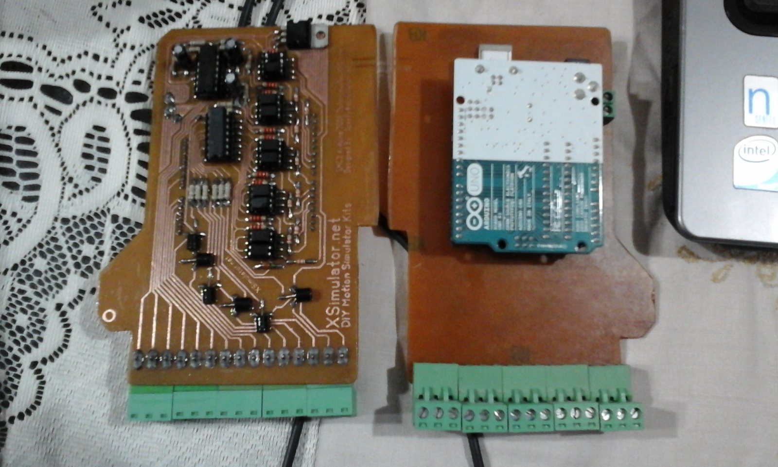

    For interfacing Arduino with VFD's running 3-Phase AC motors ...
    Using the SMC3 Arduino 3DOF motor driver Arduino code "In the default Mode 1" .

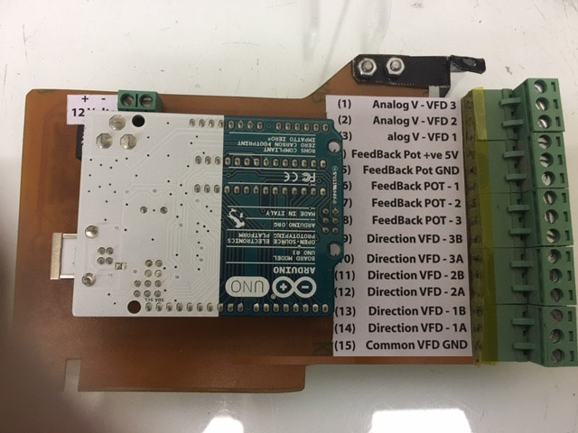

    Opto-Coupler PCB will be like a Dummy PCI card shaped for easy mounting inside a computer ...

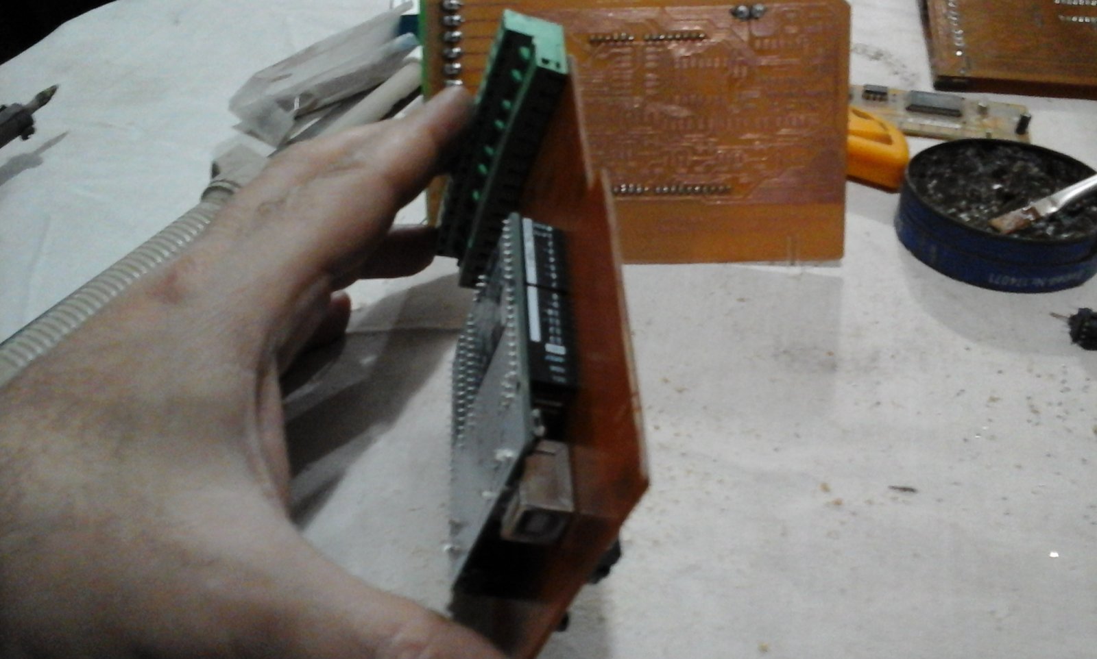

    All 3 VFDs [analog voltage / direction] and the 3 POT Feedback wirings will be in the PC back side with normal easy to use green terminal connectors ...
    Arduino board will be mounted to the PCI shield as a second layer with just the USB cable connected internally to it ...
    No additional power socket as it will be fully powered separately via this USB ...
    Use an external 12V power supply for the shield power connection not more than 1A is recommended to eliminate EMI motors noise ...
    Using the the same computer power supply is still an option for less than 2Hp motors and VFDs cases .

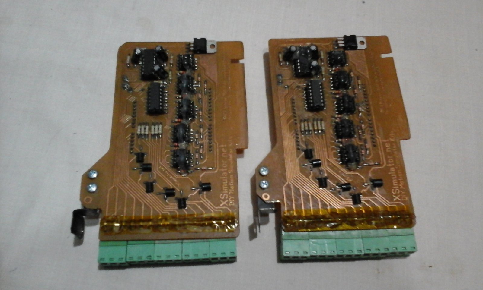

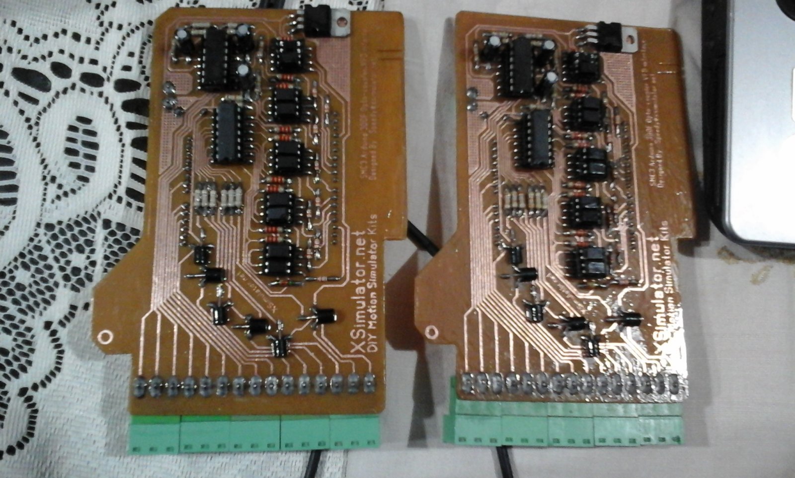

    For 6DOF get yourself two of these and you're ready to go ...

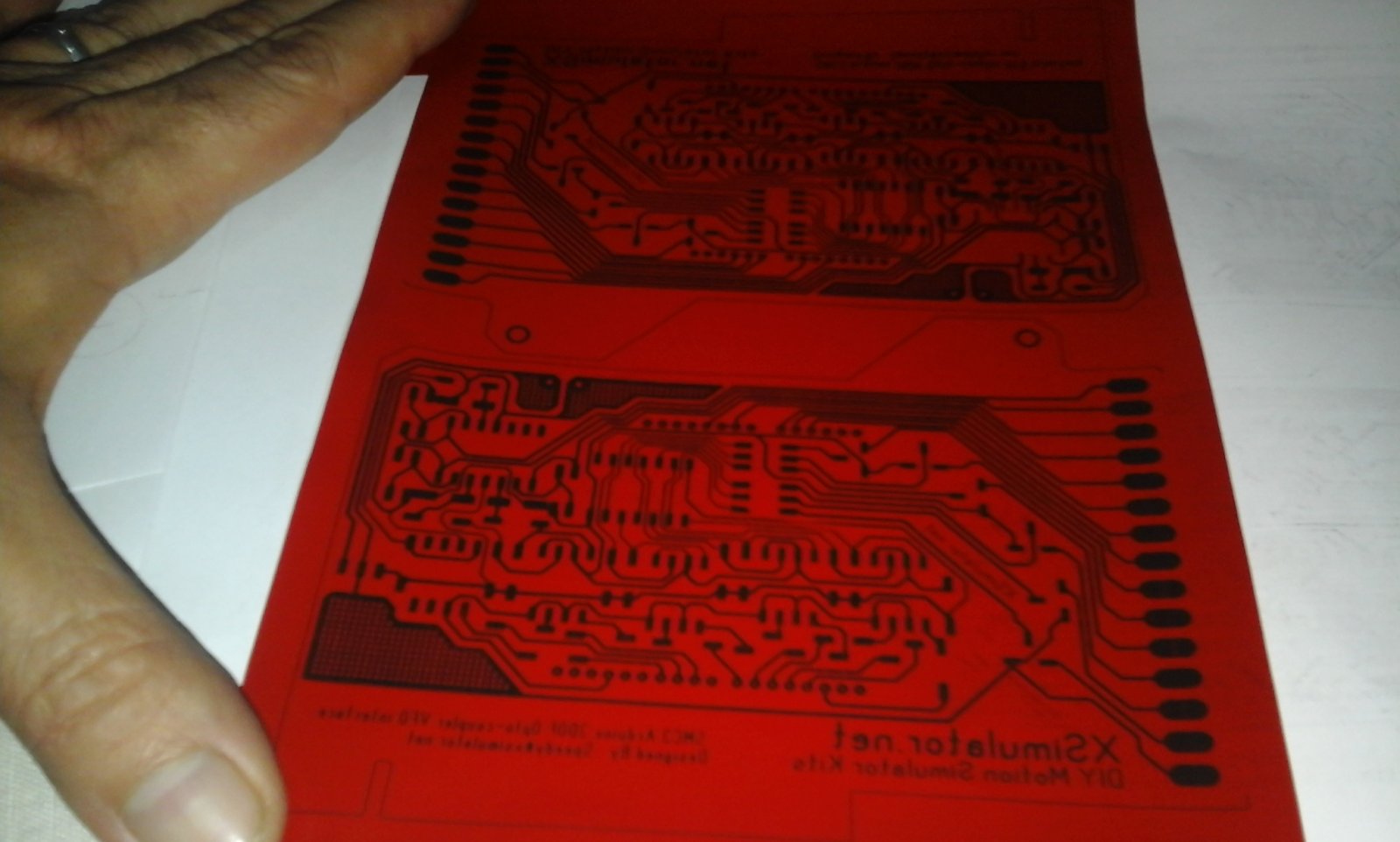

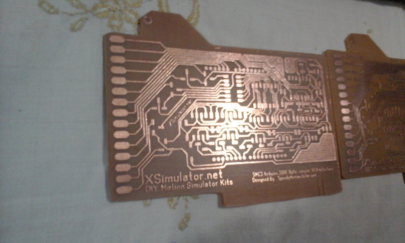

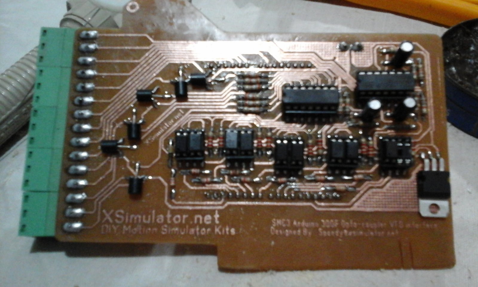

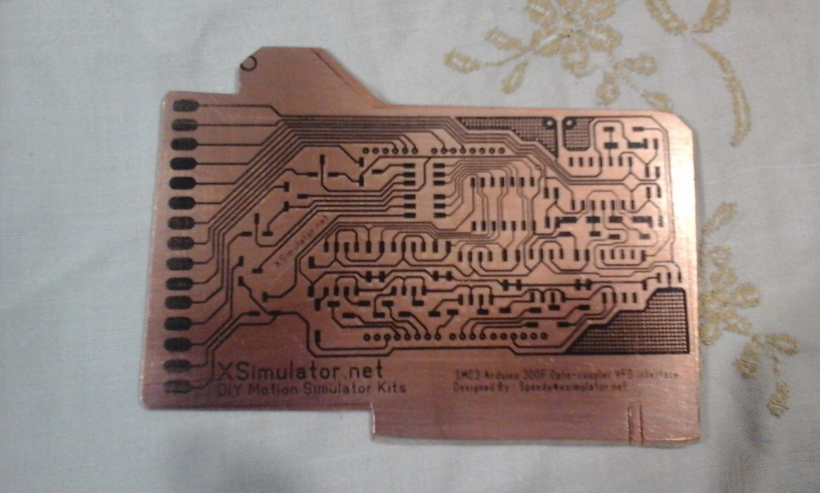

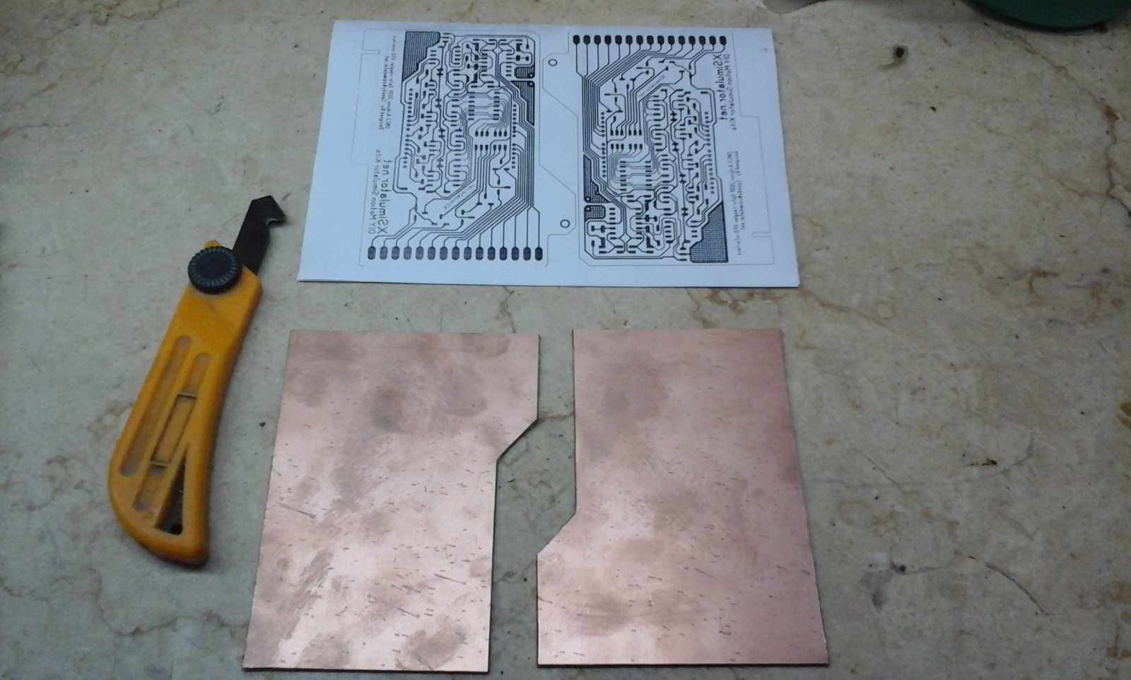

    The making :

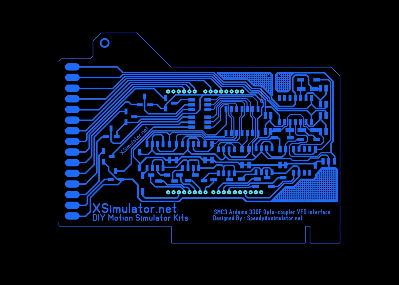

    The components side of the opto-coupler will be a regular through hole components but with a surface mounted pads to spare drillings .
    The 1:1 printable DIY file for toner transfer PCB process ...
    Aduino_SMC3_ArduinoShield.pdf

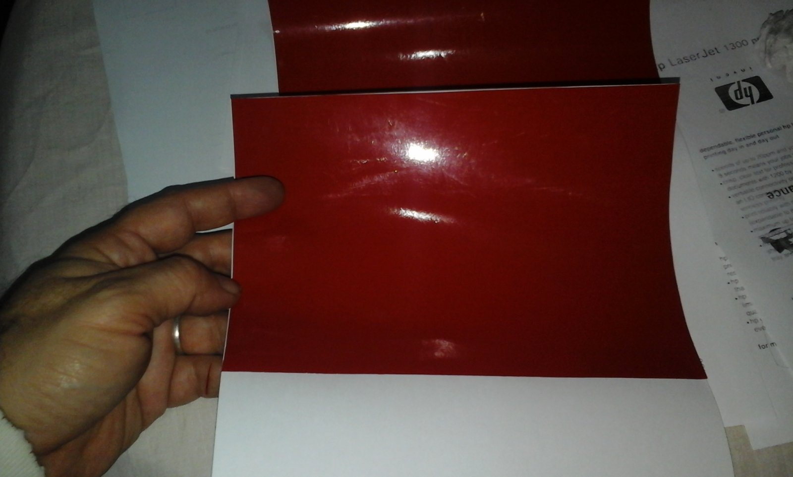

    A great idea by my big friend @cthiggin to do a label sticker for it :thumbs
    Labels for New OPT-PCB - PC - 032717.pdf
    A toner transfer with a 3M vinyl sticker will do a perfect job for you ...

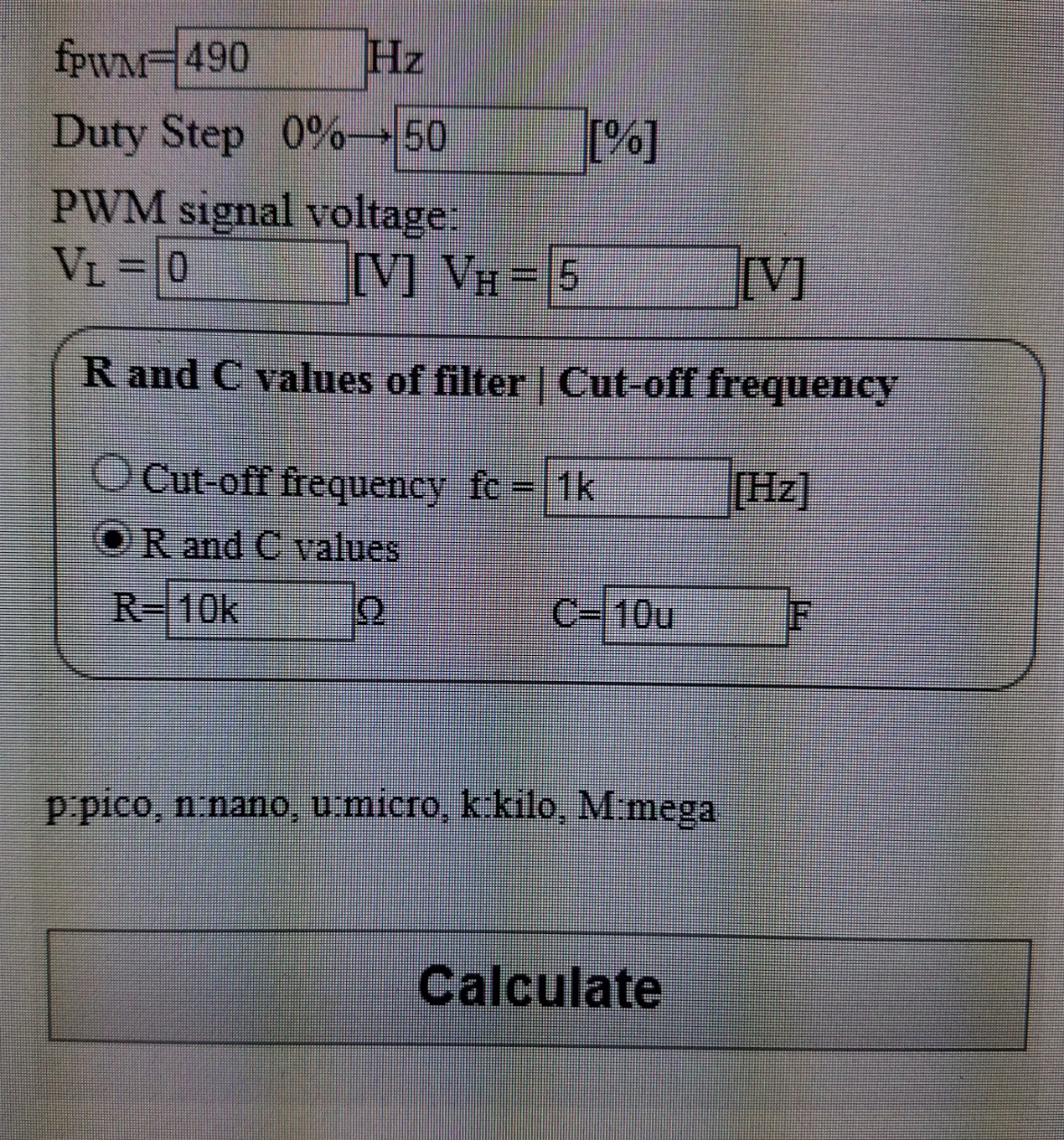

    What is the values you used for the RC filter? Perhaps I can calculate the response mathematically
    R=resistor (found it on the layout is 10Kohm)
    C=capacitor ?
    And perhaps the frequency of the PWM signal to do some spectrum analysis. Is it the standard 490hz of arduino?

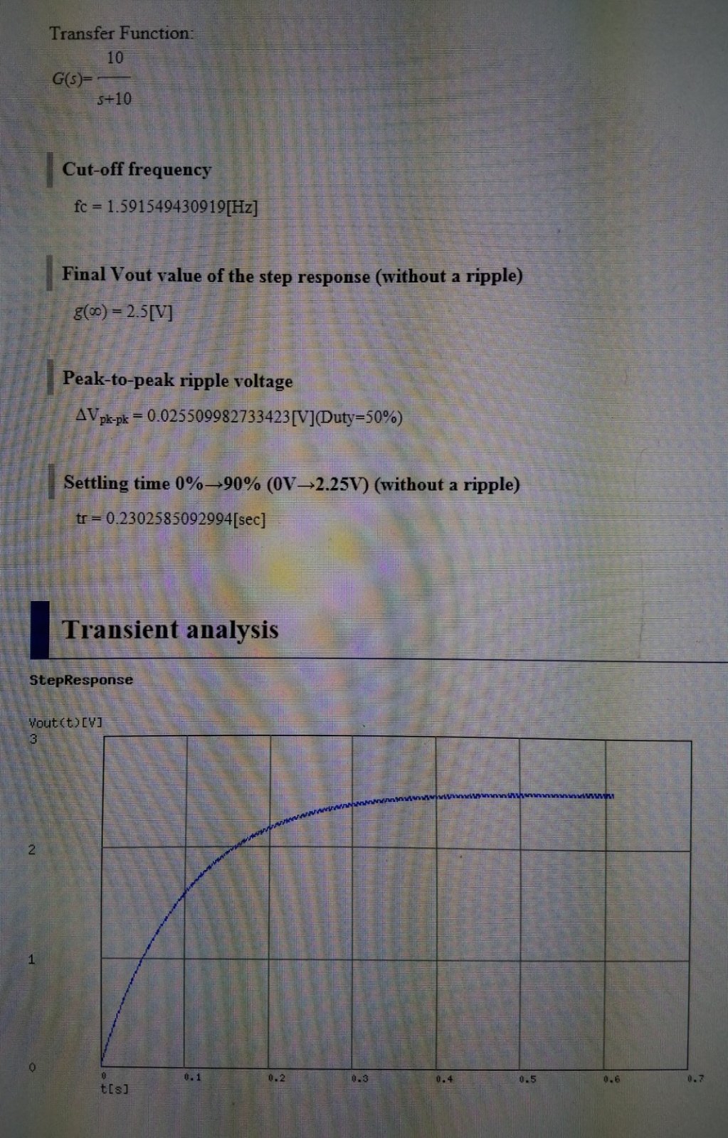

    Ok, using 490hz pwm and C value 10uF:
    With above values the response delay is 0.23 sec or 4.3hz period.
    You use that for setting the speed of the motor in not wrong right? I guess it's good enough for vfd inverters if you set their ramp settings to 0.5sec.
    Mike

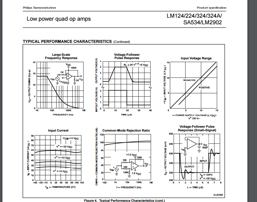

  11. SeatTime
    2,573
    28,320Coins

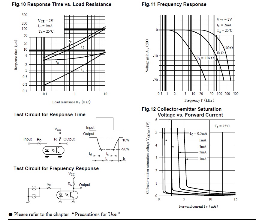

    I know - lets look at the relevant specs of the actual OP Amp...- see below. A lot less then 0.23 Seconds :).

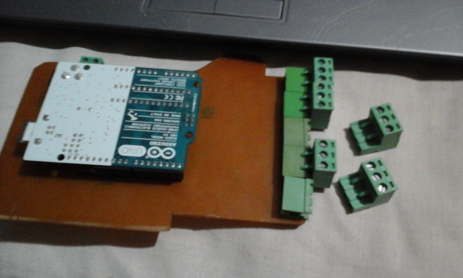

    Another photos for the opto-coupler with a black mounting brackets to the PC back .

    here is the response time of the PC817 opto-isolator

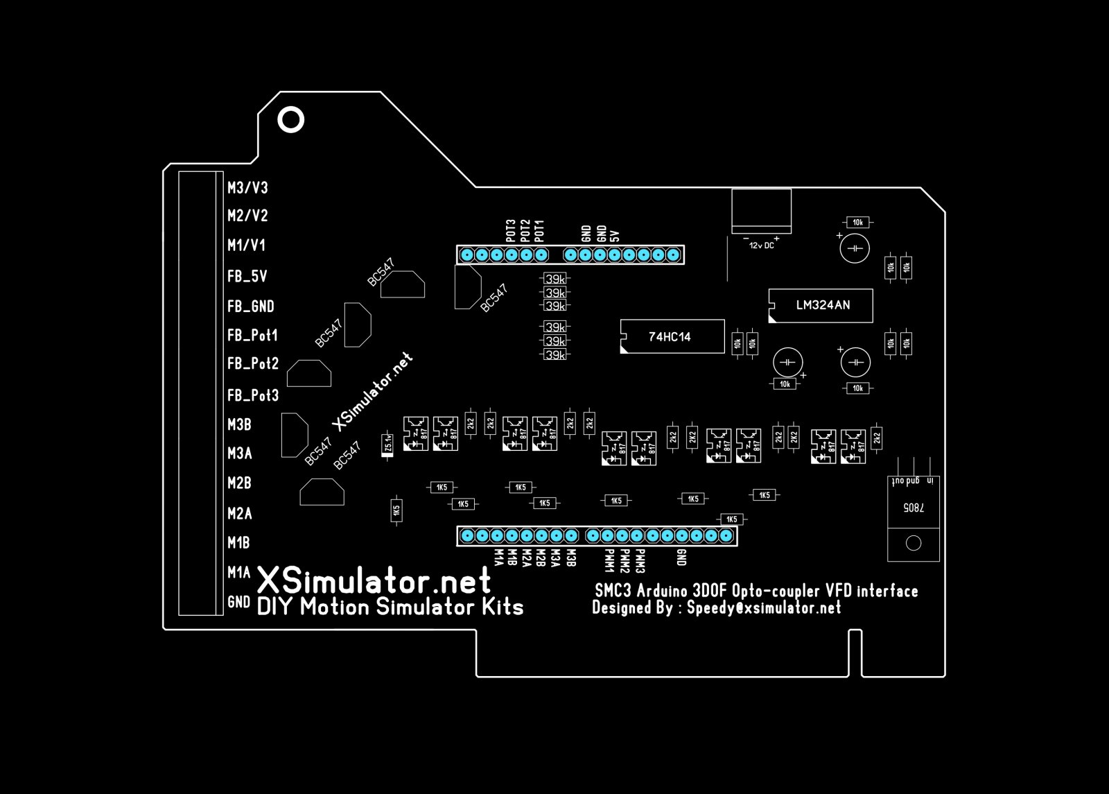

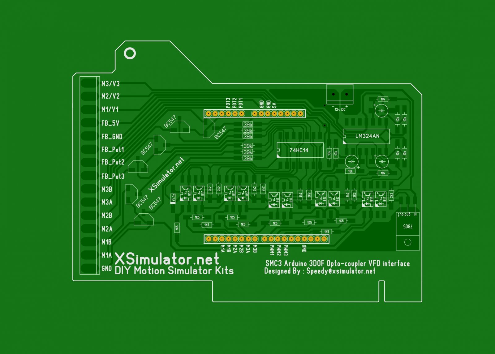

  14. judges
    judges New Member
    Feb 17, 2017
    16
    309Coins
    +21 / 0 / -0
    Hey speedy, great project, but I think the cap values are missing in your pcb layout. Also it would be great if you could post schematics (certainly can be deduced from the board layout, but easier if you have'em...)
    Thanks,
    Heiko
  15. speedy
    speedy Well-Known Member
    Feb 1, 2012
    1,193
    Alexandria , Egypt
    7,941Coins
    +1,287 / 10 / -0
    Hello Heiko ... thanks for pinning that out, they are 1uF/16v ...
    Sorry buddy I don't have total schematics for it atm ... as this is the 6th edition of the board right now ... many circuits are added lately and schematics are not updated .

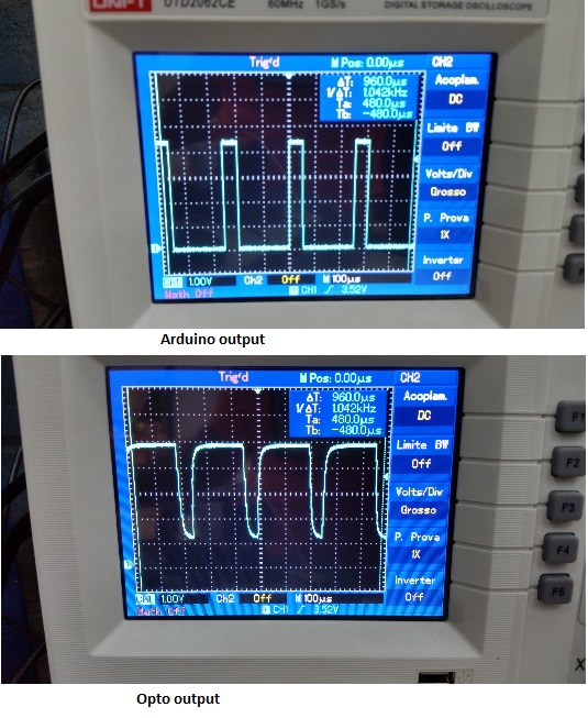

    A great idea by my big friend @cthiggin as he did a label sticker for it :thumbs
  20. maurilio
    maurilio New Member Gold Contributor
    May 28, 2010
    15
    - 52Coins
    3DOF, AC motor
    I build one of your pcb for vfd's.
    By now, I'm testing and starting to build 3 huge actuators with ballscrews and 2hp motors.
    I'm going to share pictures asap.
    During test, I see that output is going to max(10 volts) when the feedback pots is on the target.
    Maybe the PWM is inverted ?
    Is possible the Hi must be Low and Low must be Hi ?
