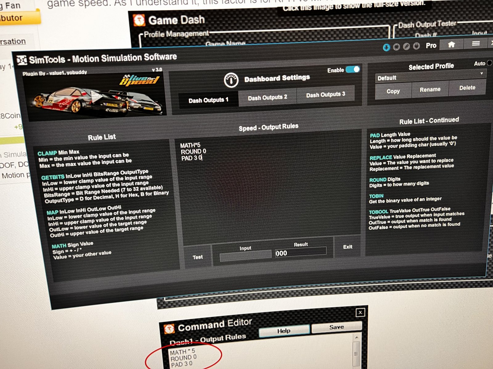

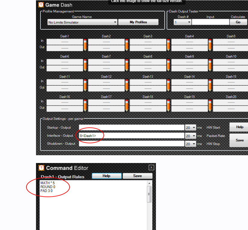

    Guys these are my settings and it still don’t work. Something else I noticed is the speed on the car is not the same and simtool v3 dashboard
  4. Richard Ortengren
    Richard Ortengren Florida Racing Fan Gold Contributor
    May 14, 2022
    49
    Builder
    Florida
    283Coins
    +17 / 0 / -0
    Stanley, I think you need to use these outputs, circled in red. It shown at the very beginning of the post. If the speed doesn't match your game once you input these commands and interface output then you need to adjust the Math factor to match your speed in the game (MATH * 1 or MATH * 5 will adjust the output to match your game speed. As I understand it, this factor is for KPH vs MPH

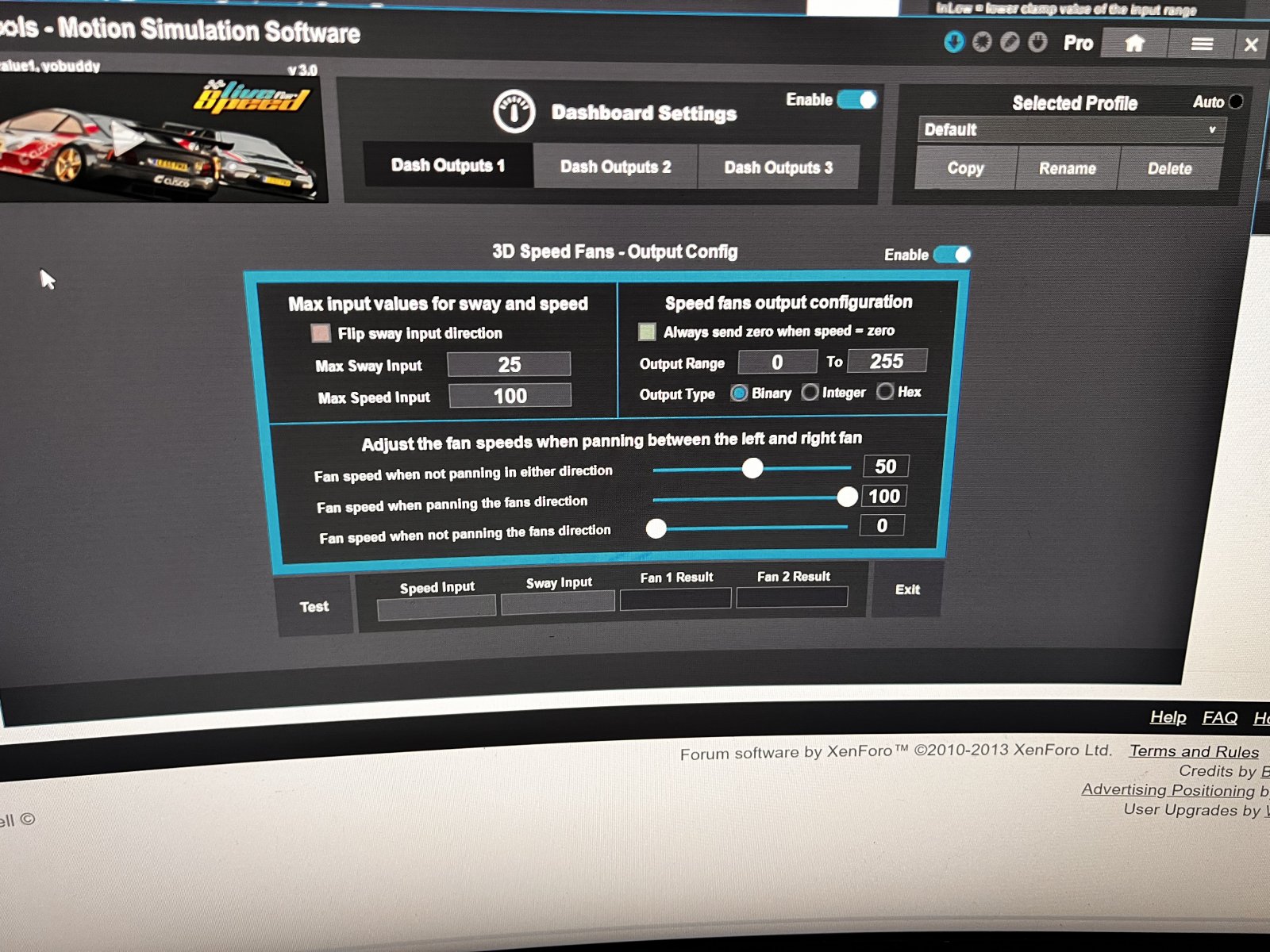

  5. stanley johnson
    stanley johnson Active Member
    Sep 14, 2022
    117
    Diesel tech
    Nashville
    82Coins
    +40 / 0 / -0
    @Richard Ortengren should there be a SAVE button for this screen, if I leave this screen it goes back to a blank screen, I lose eveything i typed in F3D5F3DF-D52D-45C1-840B-17882503F8F6.jpeg
  6. Richard Ortengren
    May 14, 2022
    49
    Builder
    Florida
    283Coins
    +17 / 0 / -0
    As Yobuddy told me, you have to click the exit button at the bottom and it will save. Not sure that it matters or not, but I put a space on either side of the * in that first Math line.

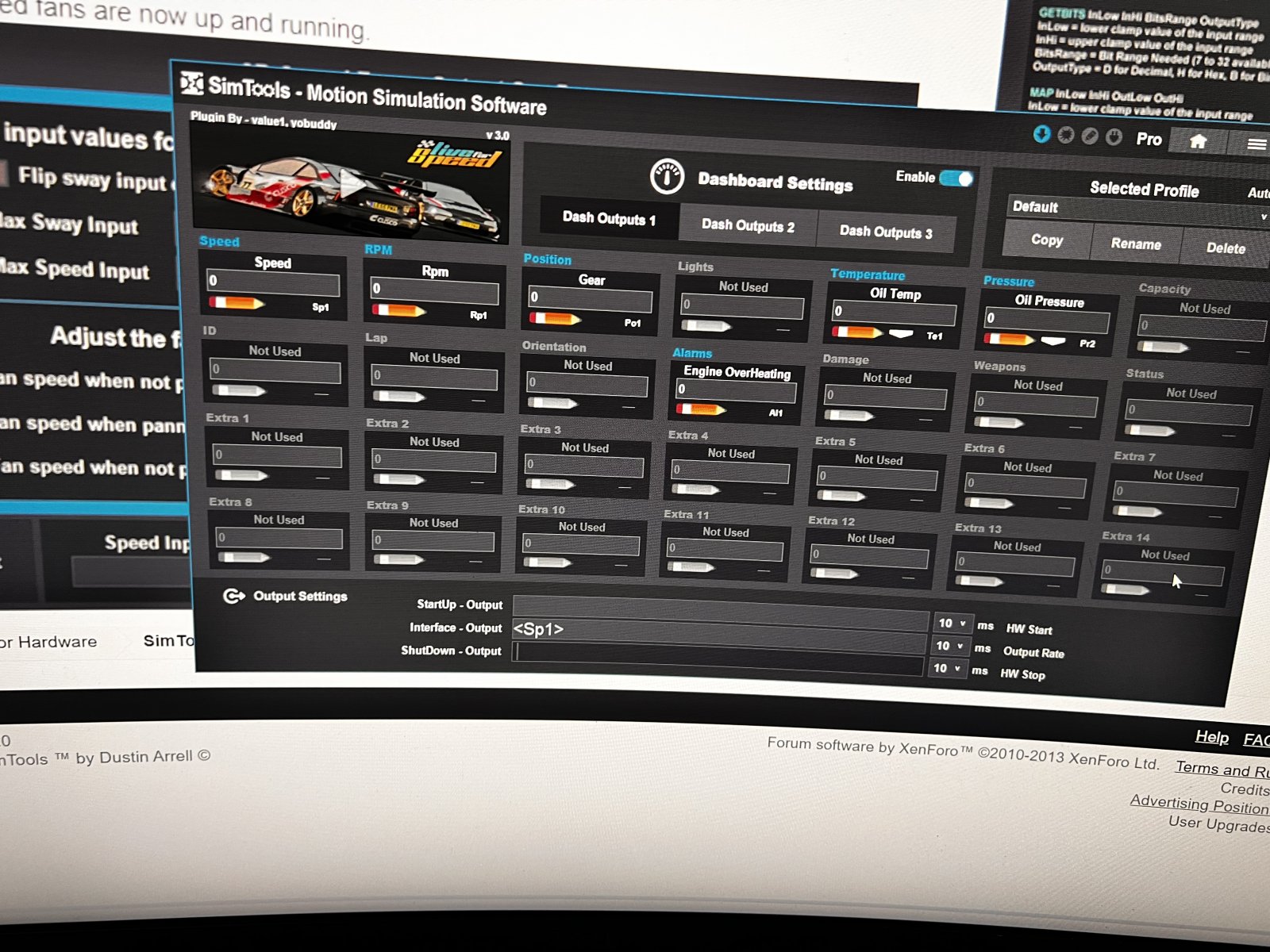

  17. Mu-KwangKim
    Mar 14, 2012
    124
    South, Korea
    - 689Coins
    +33 / 0 / -0
    Hi.
    I have confirmed that this code works in SimTools 3.0.
    Interface - output is 'S<Sp1>'. not 'S<Dash1>' :)
    Interface - output is 'L<Sf1>R<Sf2>'
    3D Speed Fans - Output Config Output Type is 'Interger'
    If this is set, the left/right fan also works separately.
    ok. so...
    But the fan doesn't stop when it's on pause.
    Can you check it?
  18. Mu-KwangKim
    Mar 14, 2012
    124
    South, Korea
    - 689Coins
    +33 / 0 / -0
    ok... I don't know the cause,
    Interface - output is 'S<Sp1>L<Sf1>R<Sf2>'
    This will stop the fan. on game pause.
    With only S<Sp1>, the 3D fan can't be used, but it stops well.
    But...
    Both ways will keep the fan running. to on SimTools pause.
