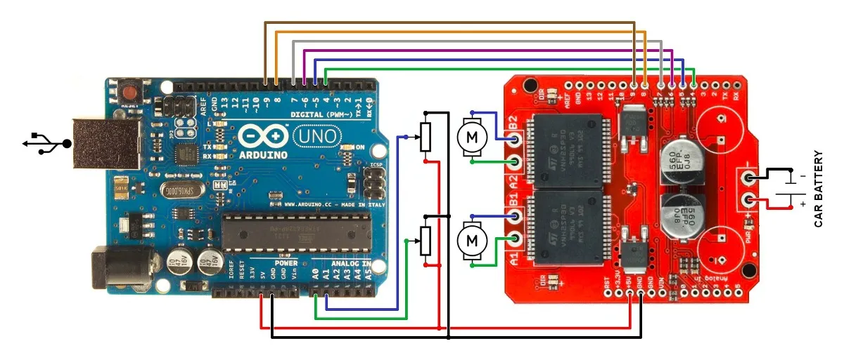

    I received the inductors but i'm totally in the dark how to make my fans quieter.
    I know how/where to put them in the electrical circuit of the seaflows, but can some one please help me out with the arduino code needed to run them at higher PWM settings. I have a 80mm fan and heatsinks on the MM.
    1. Do i need to change anything on the arduino/MM connection / pin settings?
    2. Can some one post the code needed for running higher PWM settings with simtools?

    You put them between the MM and the Fans on the power cables.
    The code for different PWM is in a post on last page I think

    No pin changes or anything, as @SilentChill said, just put the inductors between the MM and the fans, and then use the code I posted in on the last post of the last page, just replace everything above "void loop()"

    Thanks Richard, but i seem run into a problem since it won't upload to my arduino.
    I have used this code posted by you on page 4:
    Replaced everything above "void loop" and the final code looks like this:
    It won't upload with these errors:
    I probably doing something wrong, but i have no idea what???

    Yeah, I forgot that the SimTools code was defining some stuff up in the top
    You need to just replace the bits that control the PWM frequencies but leave in the rest of the stuff that SimTools needs. It is sort of the bit in the middle of the code that I posted. I am on my iPad so it is a bit hard to explain. I'll see if I can get something going tomorrow.
    I don't have the pro version of SimTools so I won't be able to test it but I can give you the code to try.

    YOLO. here goes nothing, I am not a programmer but at least it compiles.
    I left in all the pwmmodes so 0=980Hz 1=4KHz 2=8KHz 3=31KHz
    I have left it set on 8KHz, make sure you are using inductors and a heatsink. Use that your own risk, Do a small test first and check your temperatures, if you run it at 8KHz with no inductors then you have about 30 seconds before it overheats.
    8KHz works fine on the wind simulators I sell, I have sold quite a few with 8KHz and the suppressors and they run at around 25-35 degrees C. Mostly I sell to the iRacing community so I usually ship with the iRacing code set at 8KHz
    I haven't tested it because I don't have SimTools Pro yet.

    Hey guys. I have fully tested the 8KHz code and it works fine with my wind simulators.
    If you are going to use 8KHz on your own DIY wind simulators then MAKE SURE you are using inductors OR ELSE THEY WILL OVERHEAT
    Seaflo 4" blowers is what I use.
