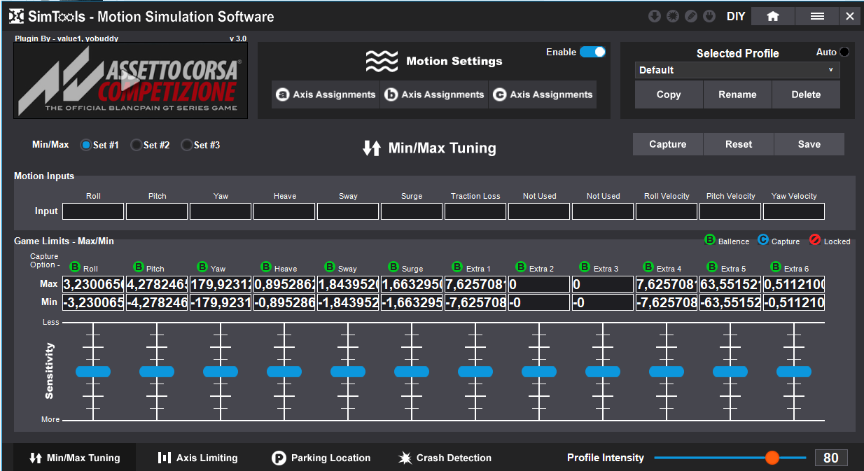

    What setting in Simtools (or SMC, maybe) to be able to feel when hitting wall?
  17. noorbeast
    22,115
    154,316Coins
    +11,179 / 57 / -2
    SMC3 is just used to help do your hardware configuration.
    The rest is all about refining your motion profile, hitting a wall is pretty simple, as it is basically going to trigger most axis towards the max of whatever is set, but the motion profile should really be crafted around first setting up each axis independently, then enabling them all and refining from there: https://www.xsimulator.net/community/faq/steps-to-create-a-motion-profile.228/
  18. deeph46
    deeph46 Member
    Mar 17, 2023
    117
    641Coins
    +16 / 0 / -0
    2DOF, 3DOF
    But could I double the effect just for hitting wall? When I crash the wall, my rig just steady still. Before hitting wall, on gravel it moves great and accurate.
  19. yobuddy
    51,647Coins
    +5,204 / 19 / -0
    Do you have crash detection on maybe?
    What does your max/min setting for surge and sway look like?
  20. deeph46
    deeph46 Member
    Mar 17, 2023
    117
    641Coins
    +16 / 0 / -0
    2DOF, 3DOF
    This is what Min/Max I got. Crash detection is Disabled.
