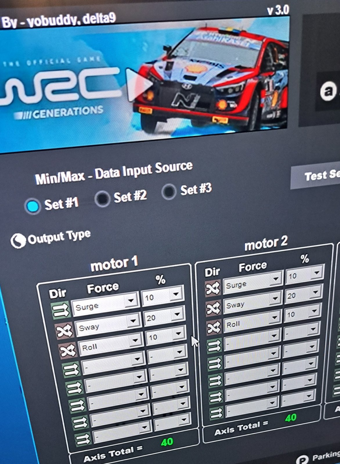

    Tested WRC Generations and found out same conflict between Sway and Roll being on same direction of travel. Tested separately working ok , but when applied together rig goes crazy from side to side.

    The direction of a DOF output is 100% configurable in the axis assignments.
    Simply click the Direction (Dir) button to flip the output buddy.

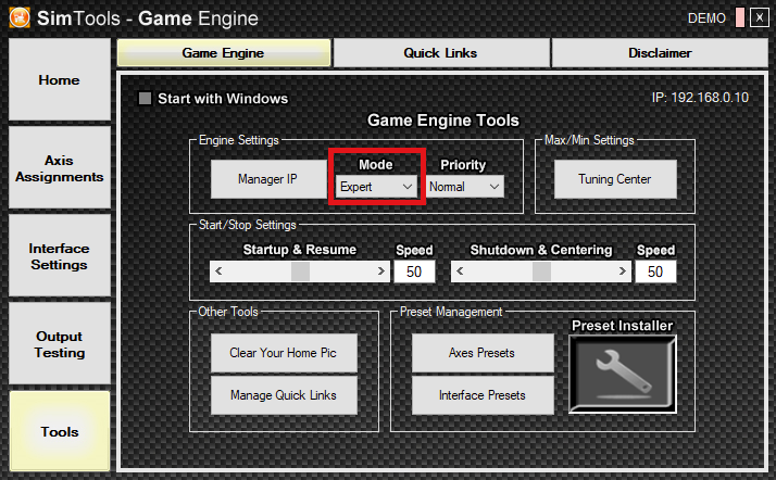

    You have to goto options and set the mode to expert.
    Take care!

    I know that. The problem is ,only way to tilt on the correct side in game is if you put those on same direction of travel. (See pic) If you drive slowly works but when bigger forces are applied rig starts to go from side to side. I had same problem with Dirt Rally but that was fixed few days ago. In test mode everything works , but in game is a conflict between sway and roll. I hope I explained it right. In the picture roll should be opposite to sway. But if I put it like that in game the rig goes to opposite direction than it should. If the problem is not clear I will make a more detailed video

    It makes no difference weather we flip the output in the plugin itself thou, or the first step in the axis plugin, Ultimately its the same output.
