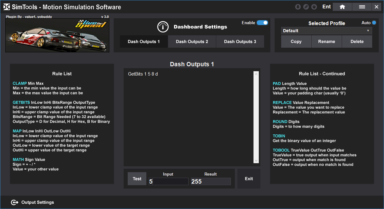

    Just pushed an update!
    All Virtual and Addon plugins are now included in the setup plugin
    Dash Rule Tester now included

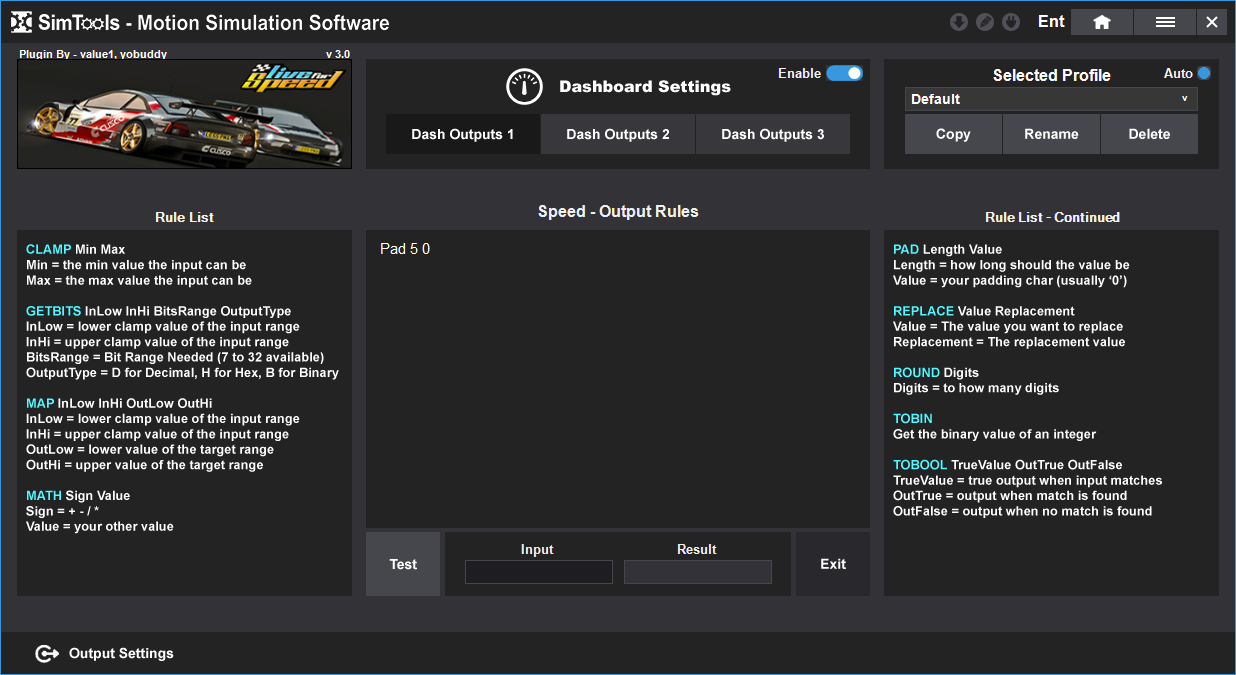

    New Rule GetBits!
    Dash Rules page revamp.
    Take Speed for example, we can now clamp, translate to bit range, and return the output we want with a single rule
    Speed input = 100
    GetBits 0 100 8 d (this means clamp between 0 to 100, get the value in 8 bit range, and return a decimal.)
    The output would be 255.
    Simple Right?
    Take care!

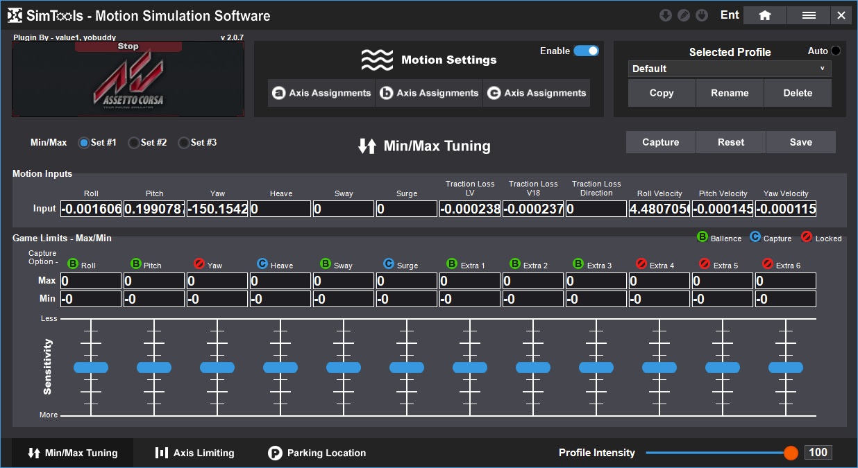

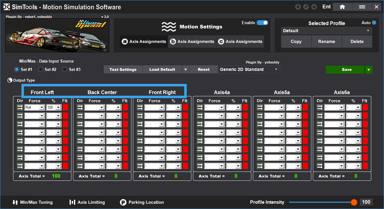

    Something new in v3 that would be hard to know about if I didn't tell you is: Axis Naming.
    And then the names are used everywhere in the app that makes sense.
    You can even assign axis with these new names in the interface section if wanted, <Front Right> as an example.
    Anyway, chat soon!

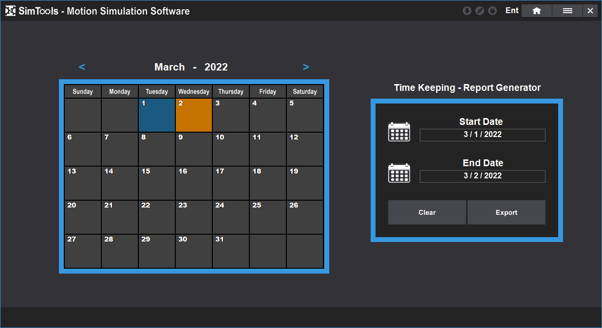

    If I could get a few of you to test out the timekeeping feature, I would appreciate it!
    You simply turn it on, and it will record the amount of time you play each game.
    It will only count time when the game is running, not paused, and at least one interface is being used for motion (sim is running).
    After a session or two, you can spit out a report for the day, and it should add up total play time for each game.
    In the example pic above, I would be generating a report for 2 days.
    Big thanks to all the testers! :thumbs

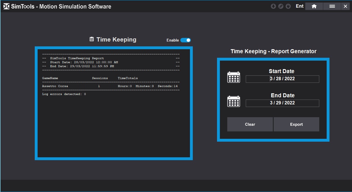

    Motion platform
    Just enabled time keeping went for a race came back report was there and exported fine:thumbs
    will test on more sims and report back :popcorn
    22,032
    153,788Coins
    +11,150 / 57 / -2
    Time Keeper works fine for me:

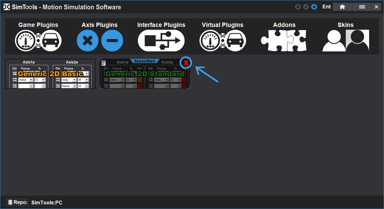

    New Game Plugins Uploaded!
    I was asked why some plugins can not be removed from the repo?
    The answer is because the plugin is being used in your setup.
    If you un-assign the plugin from your setup, you will be able to remove the plugin as usual.
    Take care!

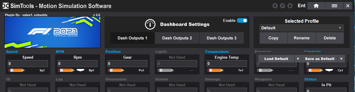

    Interface bug:
    - Open the dash settings for a game
    - Click the Output settings lower left
    - Click the pen icon for one property (speed for exemple)
    - Click the Outoput settings again
    - The header will be missing and some overlap will occur on the right side of screen:
    - Clicking output settings again will correct the layout:

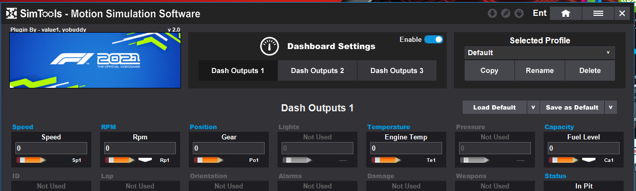

  14. llluis
