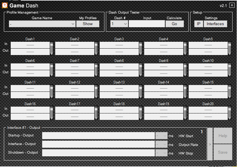

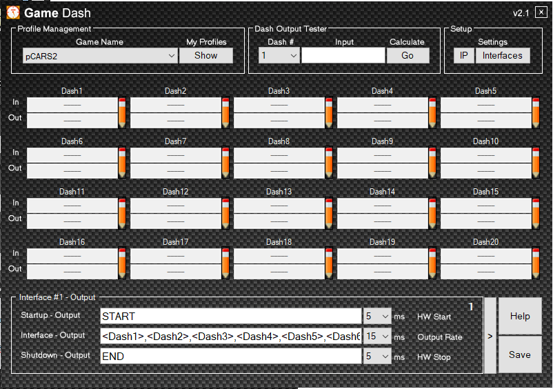

    Here it is...

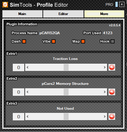

    I've also repatched the game with 2.0.5.4 and it doesn't make a difference.. PCars 1 is working fine btw...
    Interestingly, I watched Game Dash when I started PCars2 and it did detect it for about a second before dropping out back to :
    I really appreciate any help people have on this...

    Please try closing game dash, and then re-launching it after the game is started and your on the track.
    Let me know buddy!

    Progress - brilliant suggestion! When I do that it works properly - the question now is how do I get this to work so I don't have to restart Game Dash after starting PCars2?

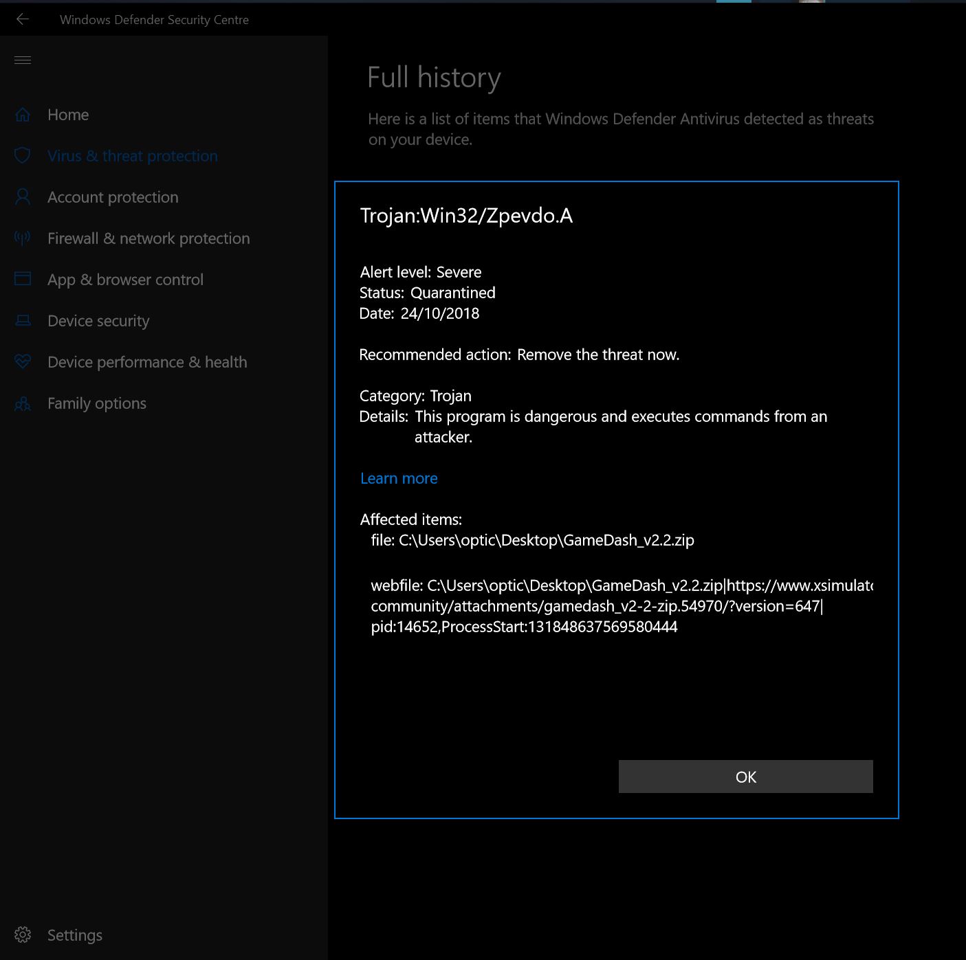

    Yikes, getting a Trojan when I tried to download this on Windows defender antivirus! Is it important to update this if I'm on Simtools 2.3?
  14. yobuddy
    51,759Coins
    +5,206 / 19 / -0
    It's just a false positive buddy.

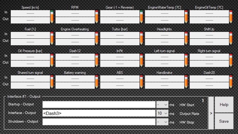

    Guys I need a little help with a game dash project. I’ve read what I can find on the subject but haven’t been able to solve my issue.
    I want to get the current gear from American Truck Simulator into Arduino for a force feedback crash box project I’m working on. I have the virtual interface setup and working. I’m getting values from -3 to 18 for the gear (which is correct). I’m struggling with how to pass that data and how it is received with Serial.read in Arduino. Should I be expecting an array, an integer, a byte! I’m clueless. I have a function written to manipulate the date once it’s received but I’m not able to find out how to send it in a readable form. Should I be converting it from the numeric values from within Game Dash using the output box?
    I can’t seem to find a well laid out set of instructions for game dash. Any help appreciated.

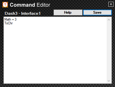

    You will want to use the "ToChr" command on the current gear.
    But with a chr, you can't have negative numbers.
    So you will also need a + 3 (and then subtract -3 in the ard once its received.)
    So click the little pencil next to the gear entry for the game and add these commands.
    This output, once set to a variable in the ard, will be equal to the value you sent to the ard + 3.
    Now all you need to do is send the correct Interface - Output "<Dash3> in the example below" for the current gear for the game to your ard.
    Once the ard gets the value, subtract 3 from the value and you should be good to go.
