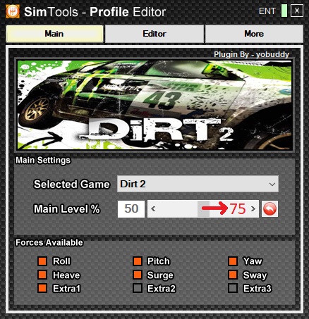

    Here is what you need to know:
    GameDash v2.2 & GameVibe Beta4 both require SimTools v2.3 and above.
    If you are running an older version of SimTools, when you update SimTools, also update GameDash and GameVibe.

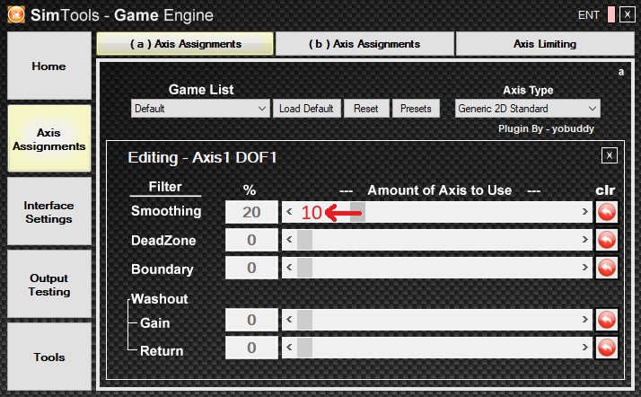

    Smoothing weight has been doubled mainly for our high flying friends.
    To get the exact same profiles as you had before, simply adjust your profiles as follows.
    Axis Assignment Smoothing: (Example: if at 20%, slide down to 10%)
    For Main Level % in Game Manger: (Example: if at 50%, slide up to 75%)
    That's all that is needed for SimTools v2.3

    The Main Level % applies smoothing to All of the data coming from the game. (its how it adjusts the strength if you will)
    When this value is at 100 %, it uses no smoothing at all, and you are riding the direct data supplied from the game.
    As you lower the Main Level % value you are applying smoothing to all inputs from the game plugin.
    You should not need to, other than simply adjusting the profiles as i have show above.
