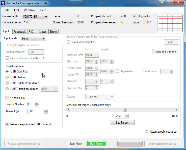

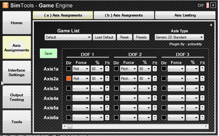

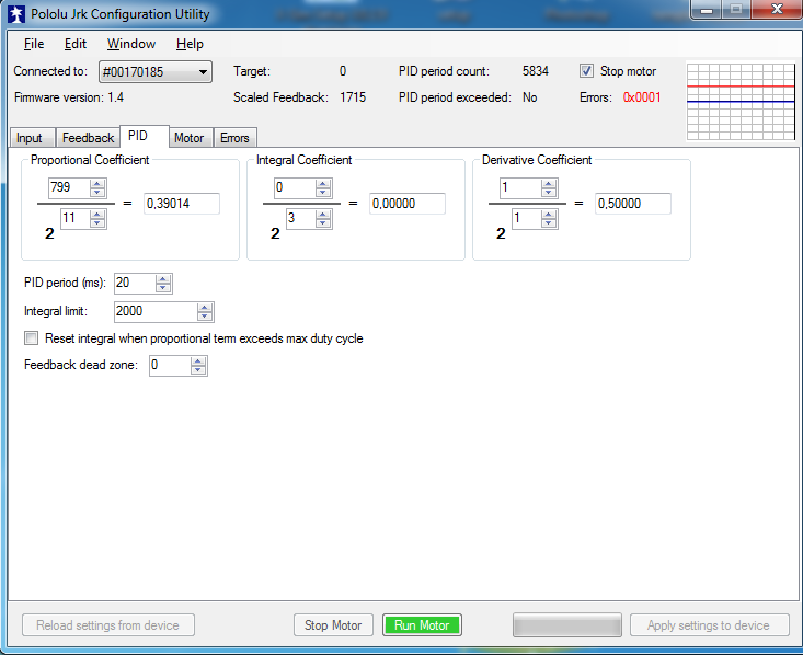

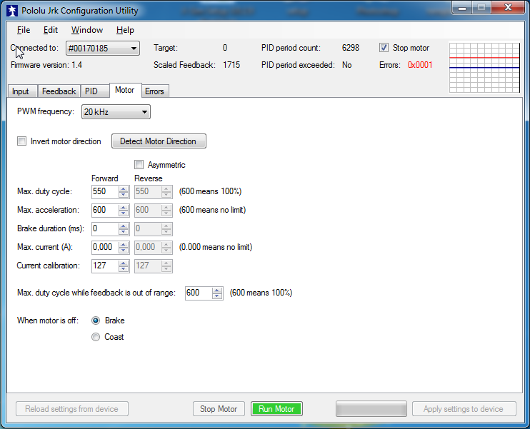

    I am building my own sim right with 2DOF. Currently i am trying to get sim tools (i bought the DIY license) to pass data to the jrk controller. Googled a lot and read a lot of post and documents (tutorials/instructions) on xsimulator website but still no luck.
    For some reason i cannot get the motor to move. When trying with the slider in the pololu jrk interface (set target) i do get the motor to move.
    When trying to test output in the game engine i tried in the pololu jrk configuration tool with motor running and motor stopped, both didnt seem to matter anything.
    I have tried with all firewalls off, anti virus software disabled but still no luck. Anyone has an idea that might help me?
    Kind regards Michael

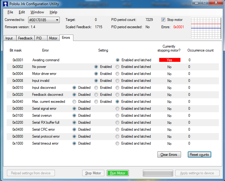

    You can't run SimTools 2 and the JRK app at the same time, it will cause a port conflict.
    The JRK app is reporting an error, please post a picture of the Error Tab so we know what it is.

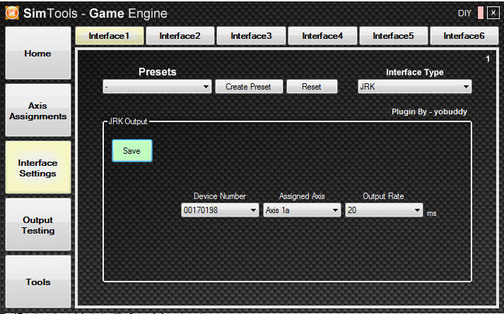

    In your Interface Settings try an Output Rate of 20ms.
    Do you have a Default profile configured in Interface Settings as that is what Output Testing uses.
    As an aside make sure you run a race in LFS in first person mode before patching for motion, as that generates to required files.

    Thanks for your reply @noorbeast. I was running jrk config utility and simtools at the same time indeed, will try after work without the jrk config utility. The error shown in the tab is the waiting for command error code i believe. Will post results when i have tested.

    @noorbeast It was indeed the 2 software applications together. I can now control via the output slider.
    The problem i face now is that i can only can control 1 pololu jrk. the other one doesnt respond. Lights are blinking both the same on both devices. Also when i change the boards from interface to another inface only the one is working.
    Not sure what to do now? Anyone has an idea??

    I only see interface 1 setup above.
    Have you setup interface 2 buddy?

    @yobuddy I just compared the 2 in the utility config. here is the 2nd jrk setup. they are identical as far as i can tell. maybe i missed something.

    Not sure about all the JRK app settings, but the simtools part looks right.
