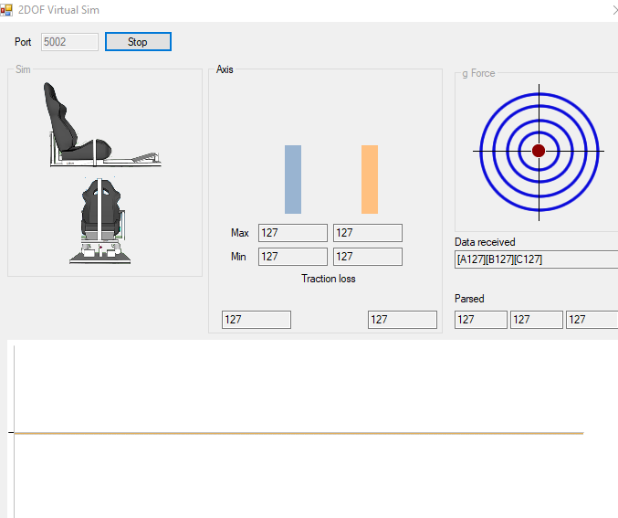

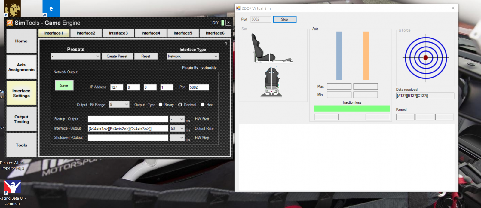

    I am quite new to this. I bought a Pro-Simu based DIY rig and will get it next week. In the meantime I try to understand the software. I thought this app would be excellent to try some things. However I can't seem to get it to work. I have done all the settings as in the picture. I have also assigned the axis and installed the iracing plugin and patched the software. The virtual axis' in the Game Engine works just fine. The app seems to get the appropriate input as well as I can see A,B,C in the data field. However neither the bars nor the seat are moving. Any idea what I could be doing wrong? Unbenannt.PNG
    22,202
    154,675Coins
    +11,209 / 57 / -2
    You seem to have accidentally added an additional ) just before the final closing ] in the Interface Settings, try deleting it and see if that makes any difference.
  10. Alexander Asner
    Alexander Asner New Member
    Jul 3, 2018
    22
    271Coins
    3DOF, SCN5, SCN6
    Well, what can I say? I am a dummy. That was the error. Everything works as expected now. All the axis move as they should which means I have understood the basics of the software. Can't wait to get my rig and see those actuators moving. Kind of a childhood dream coming true. Thanks so much, Noorbeast.

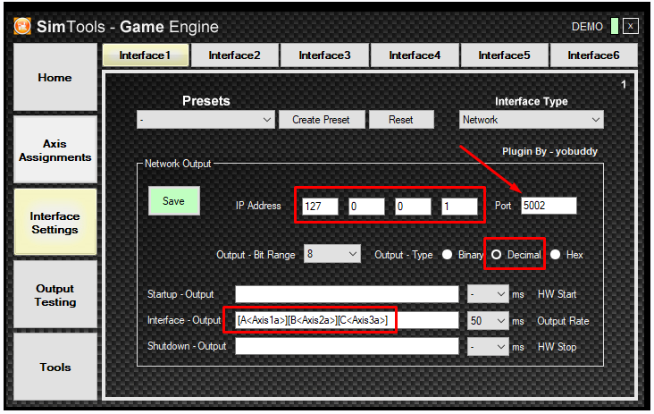

    I can't seem to get it to work either.. :(
    I will upload my axis and interface settings, my IPs and ports are the same across the board but it doesn't work. Not sure what the problem is.
    UPDATE: I managed to fix it by doing the following: unpatch the game, finish a race, exit the game and patch again. Now it works, thanks to yobuddy, saw this fix in another thread.
    https://www.xsimulator.net/community/threads/lfs-not-outputing-data.12592/
