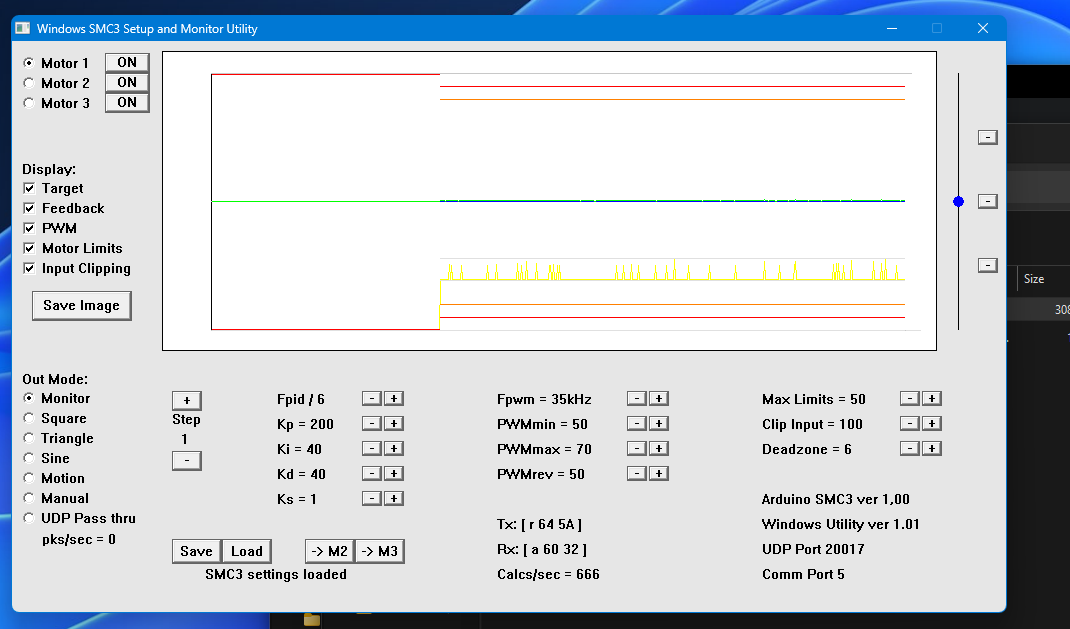

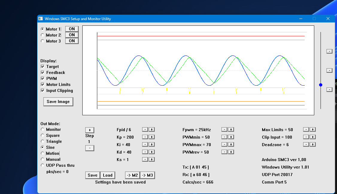

    ive build a little simulator and im using a arduino uno with SMC3.
    For software, i run simhub since ive used it for dashboard's before and i liked it.
    i've got it working but one motor keep going up and down / stuttering. ( The motor at the right side)
    i cant figure out what causes this. Do i need to configure the arduino with the monitor utility first?
    Thanks in advance!

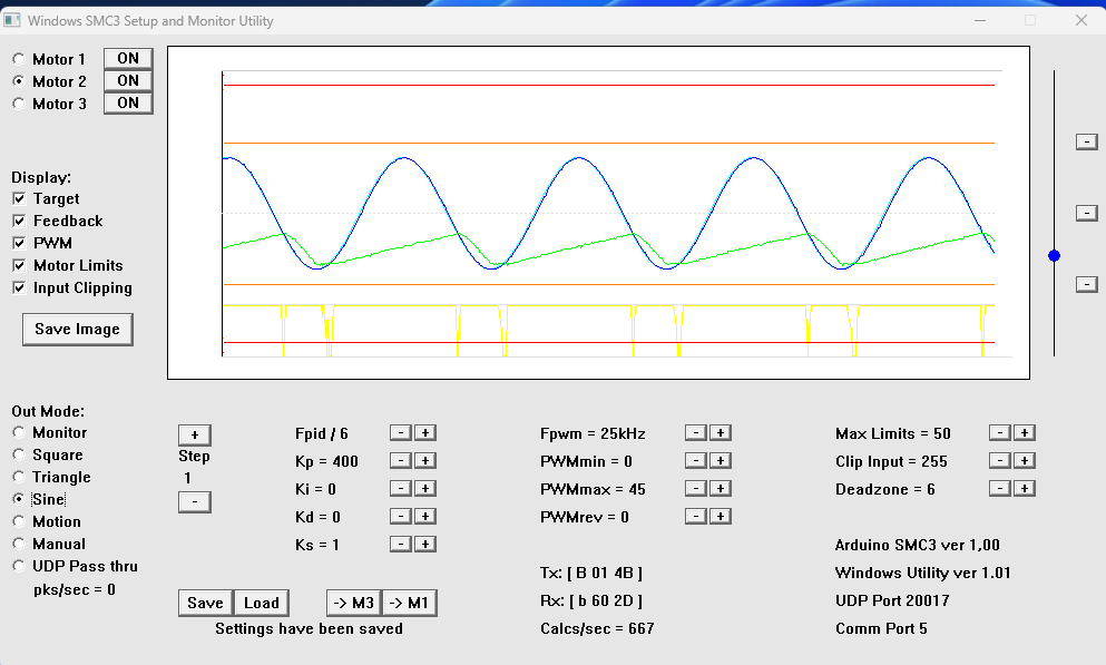

    SMC3 does need to be properly configured, please post pictures of all settings.

    im not sure what is wrong
    21,513
    150,698Coins
    +11,018 / 55 / -2
    How did you come to these particular settings?
    First change Fpwm to 25 then please please post a picture running the Sine test in OutMode.

    Okay changed that
    Well, i played around a bit. You can probably tell i have no clue :sos

    While written with another control board in mind here is a gentle introduction as somewhere to hang a basic understanding, which includes links to more accurate but dense information as well: https://www.xsimulator.net/community/faq/a-laymans-analogy-guide-to-pids-pid-tuning.219/

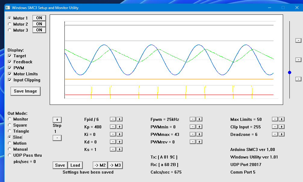

    May I suggest starting again and do the recommended SMC3 base setup, and please tell us at what PWMmax value you had movement during the base setup, then post the Sine Test once that is done:
    8. Set Kp to about 400
    10. Do the above for each motor
  7. Yeeet_warrior
    Yeeet_warrior New Member
    Oct 18, 2024
    14
    88Coins

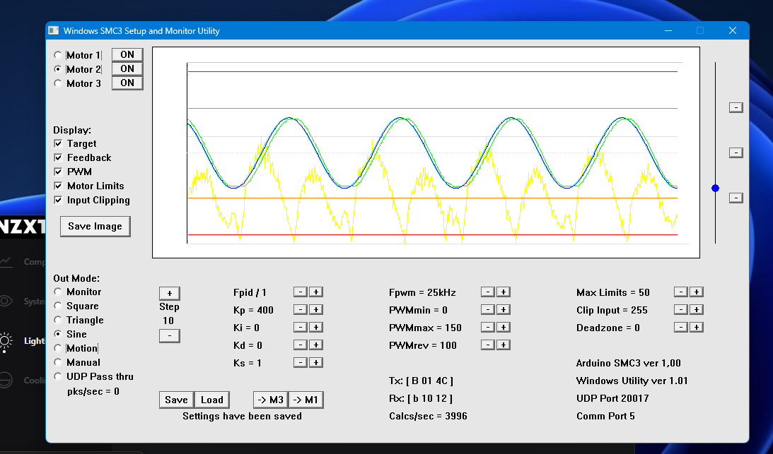

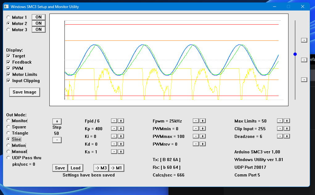

    left motor seems to start moving at around 43 PWMmax and 45 for the right motor
    Posted both motor sine tests Motor 1 is my left motor and motor 2 my right.

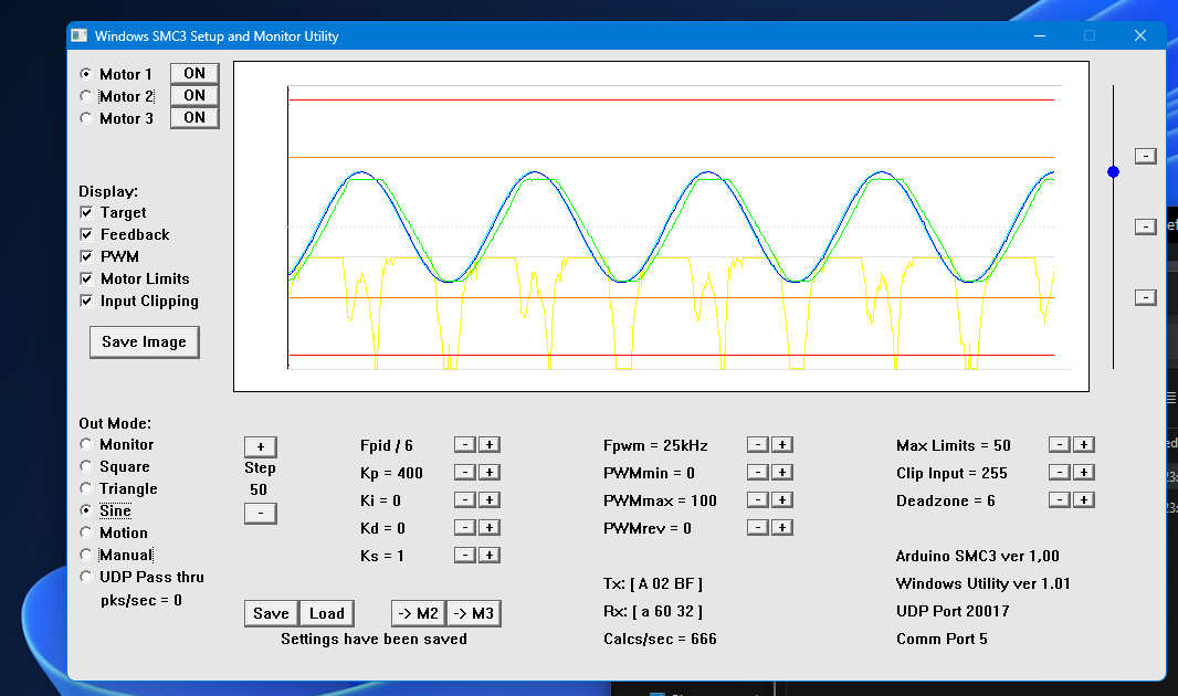

    Please bump PWMmax up to 100 and run Sine again.
  9. Yeeet_warrior
    Oct 18, 2024
    14
    88Coins
    Now the arms are slightly knocking / bottoming out on the bottom frame. not enough to give a error though.

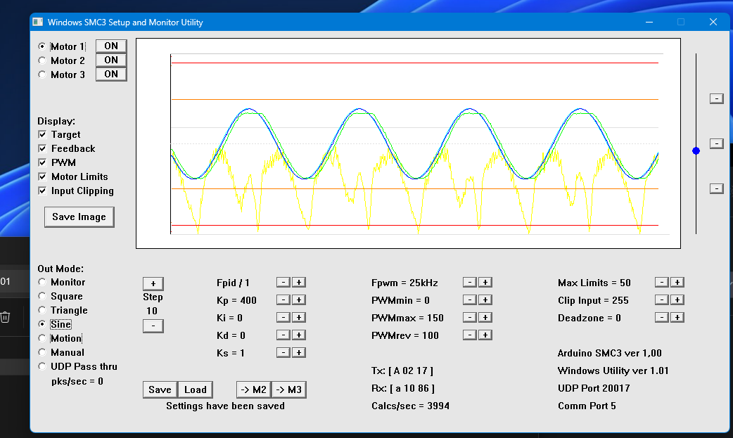

    Getting closer, but for now can you please keep things at a baseline, so Fpid to 1 and Deadzone to zero.
    Please bump PWMmax up to 150, add PWMrev at 100, then run Sine again.
  11. Yeeet_warrior
    Oct 18, 2024
    14
    88Coins
    Ooh it's waking up now. the left motor seems to have a " flat " spot at the upper curve

    Try PWMmax at 200, PWMrev at 150 and see what it looks like.
    It may be that you have to fiddle with each motor setting independently, if one behaves slightly differently.
  13. Yeeet_warrior
    Oct 18, 2024
    14
    88Coins
    i think the sim does well now, Thanks for the help Noorbeast!
    Only thing is that it knocks on the bottom frame, just a bit. i dont know how to limit the movement is the utility. Do i need a diffrent piece of software for that?
