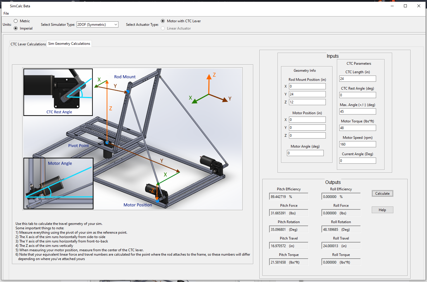

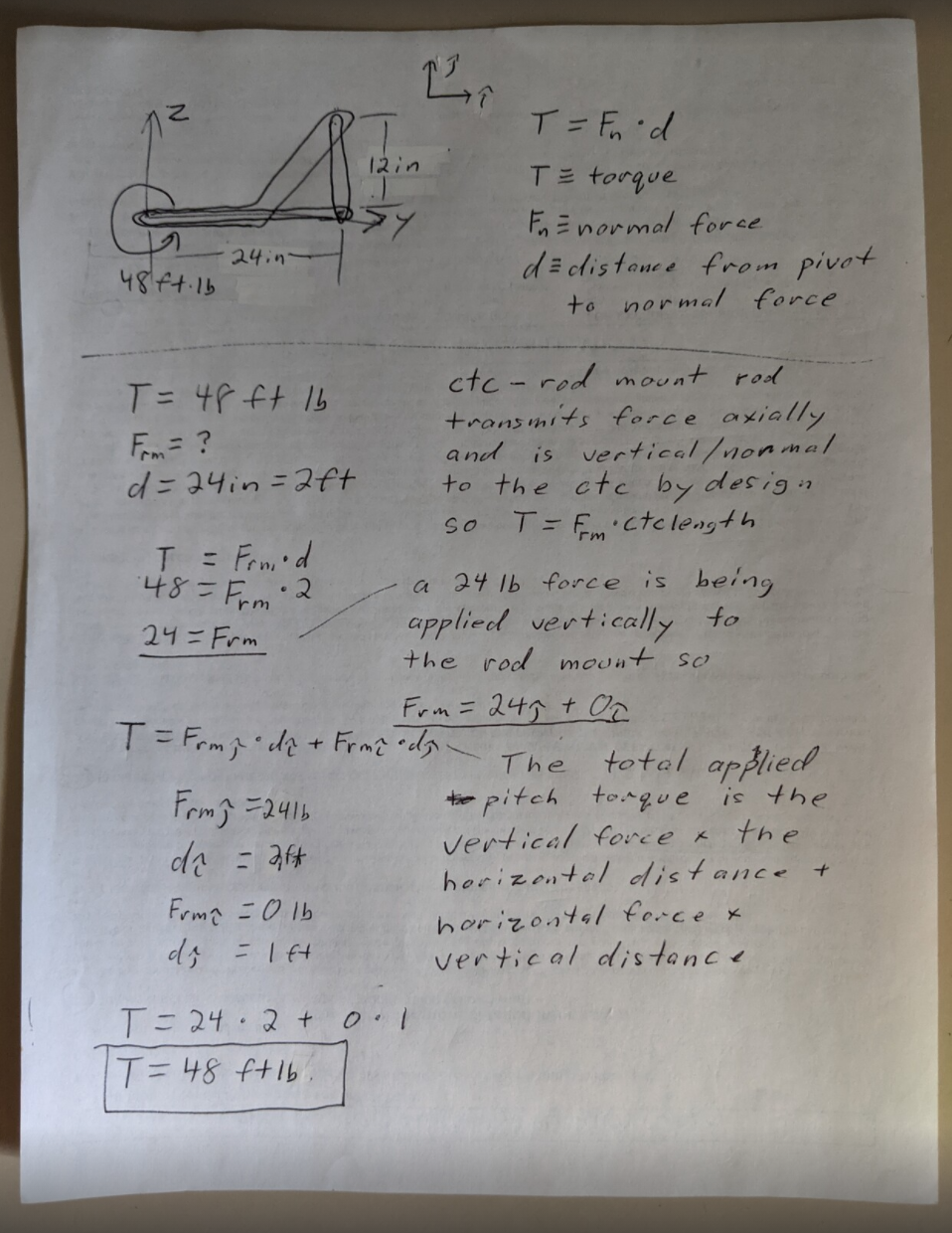

    Has anyone double checked results from SimCalc?
    I read some of the associated PDF and a few things raised an eyebrow so I plugged in some numbers for geometry for which I could solve by hand, which I then solved using a few different strategies. I also wrote a program to solve for any such geometry which uses a 3rd set of equations. All my strategies matched each other and differed from SimCalc so either I'm making a dumb/systematic mistake, or SimCalc is wrong.
    I'd love to either understand where I'm going wrong or find out if SimCalc has an error in it.
    In case it's not clear from my drawing, everything's aligned along the X axis, the Motor Position is at the Pivot Point and the ctc - rod mount rod runs vertically. And I know I'm using geometry that doesn't actually make sense for a motion rig but it made pitch torque easy to calculate by hand.

    Hmm, I reread it and while we employed different approaches, we make about the same assumptions. And while I've never used his matrix approach to transforming between frames while doing kinematics or dynamics (I've always used trig), his approach seams perfectly valid and I see no obvious reason why my above model system would break it. Past experience is simultaneously telling me that I haven't made a mistake (I used to be a Sr. mechanical engineer), and that being new to the community, I shouldn't assume that it's tool is wrong, which brings me back to my initial question. :)

    You've dragged me out of retirement! Haven't posted in ages! It's entirely possible that simcalc has errors, which is actually one of the reasons why I uploaded the math behind it. I'm an electrical engineer by vocation, so this is definitely not my area of expertise, I will go check my math, but defer to you if I can't find anything obvious. I was a little in over my head as a programmer at the time as well, so it's definitely possible there's just a coding error somewhere in there.
    Truth me told I've been pretty swamped with life/work the past couple of years (silicon valley engineering isn't as rosy as they paint it to be, eh?), so I really haven't had time to touch the sim or the program for a long time. If you're planning on making a tool of your own, I would recommend that @noorbeast supplant simcalc with your program, something tells me it'll be more well supported ;)
