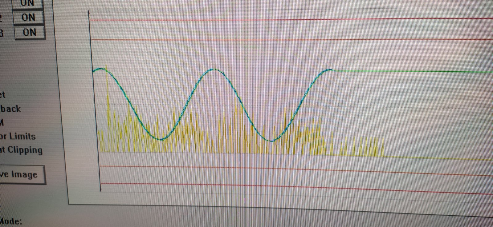

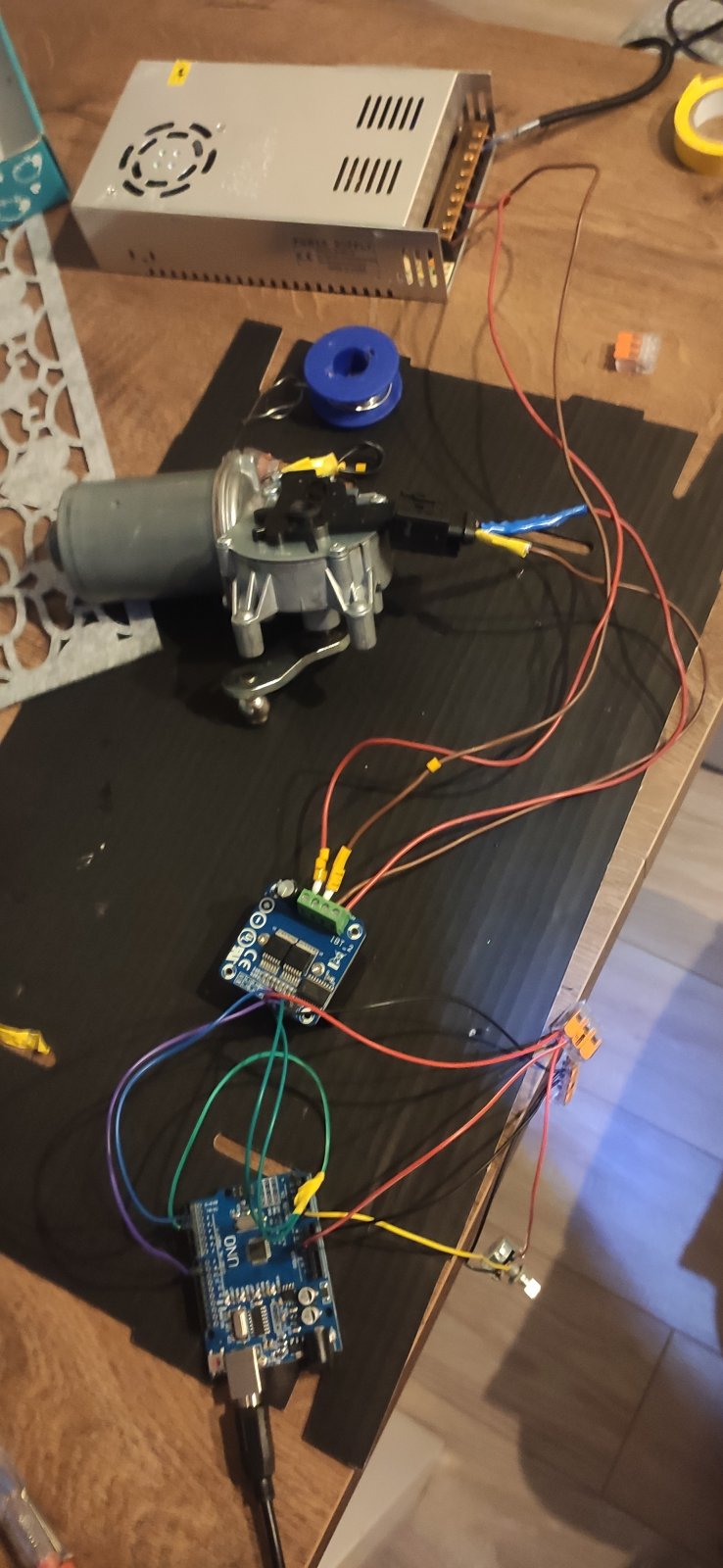

    Hi I have smc3 configuration done and ewerytjing going good I think but when I on sim tool and try to test dof axis or axis a motor start to shaking
    I use arduino uno r3 clone , H bridge BTS7960B 43A
    , DC 12V 30A 360W model: S-360-12, linear pot 10k ~180 degrees

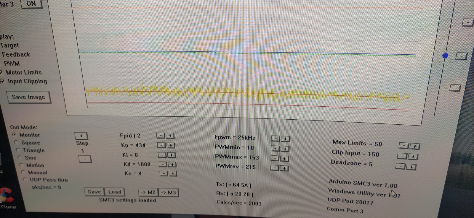

    My smc3 diagram

    Smc3 work engine works non linear i think but diagram is correct

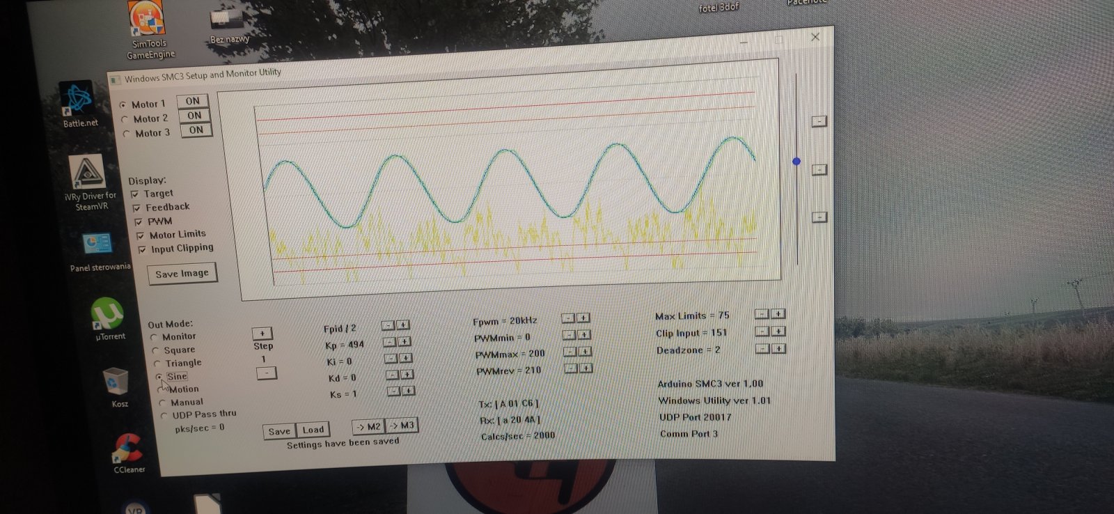

    SIM tools axis testing slowly put axis to the left or right. But when I do this quick it seem work correctly

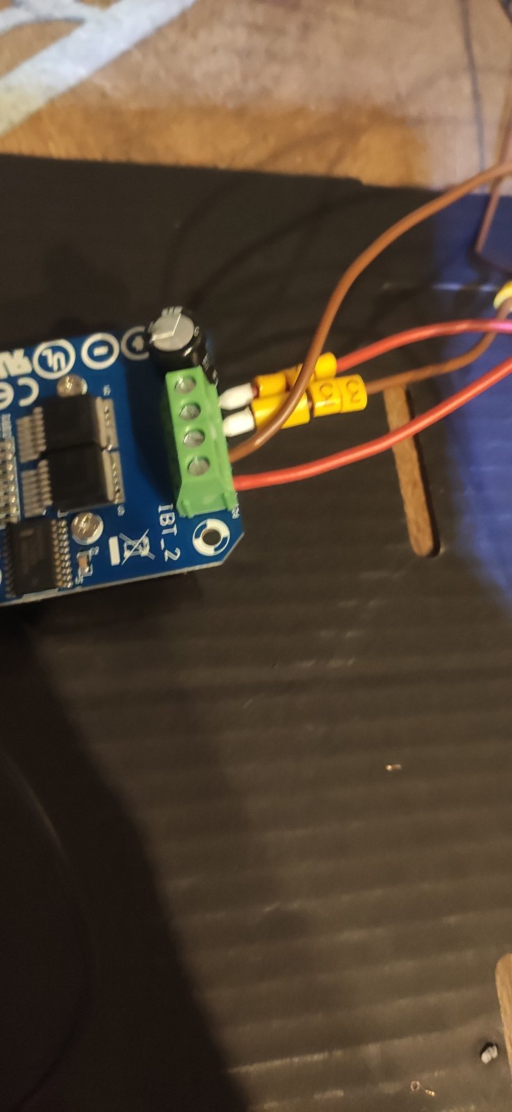

    I change pots and engine wires I check all wires 2 times. Motor connect to the power supply works correct, pots on smc3 works is it motor controller!

    Sounds like your PID settings needs tuned to me?

    I see kd is helping a little but I have max and sim tools is shaking still but less. Any suggestion with way to go? I understand a little pip and I have sytuation when I grab pot and turn around manually i feel like motor is fallow and try to " be in the point" where pot is. I feel the backward forces braking and its not shaking i feel it working smooth. But when I grab axis testing bar and moving its unstable so far

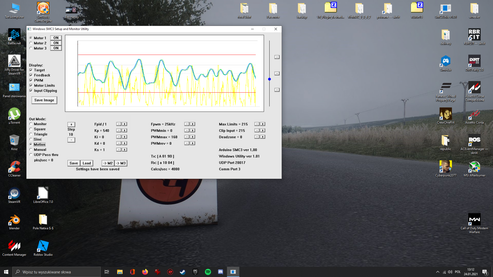

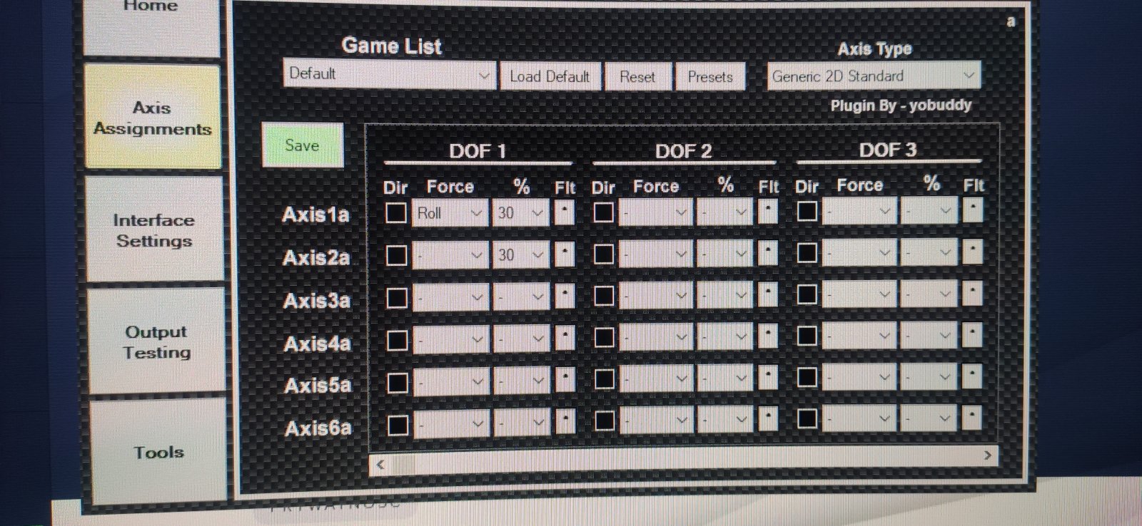

    Ok I'm so frustrating now and I do few days off but I have question but now I know Kp is the signal that try make sygnał right in time ki is the signal that bump the time to make correct signal but make oscillations and kd is the some kind of ki filter. I can't make ki more than 5 becouse of oscylations I don't know how much I can set any parametr but I know I have my signal stable in smc3 becouse when I turn pot manually o feel the forces that try to put motor in right position and this work i stability. All my troubles is when I turn in sim tools. I don't know why is so different and now I have some questions :
    1. How is this possible that smc3 is so different signal that sim tools. I have settings in smc3 that make some difference but I don't know what parameter change?
    2. Is the way I can check sygnal from sim tools in smc3 and how?
    3. I replace arduino, pots, wiper motors, motor controller and still the same. Is it possible that make all wires together make that error? this is silly still becouse in smc3 is working but I can't anything that is possible?
    4. For me important thing!!! In sim tools axis testing or dof testing ONLY LEFT SIDE SYGNAL IS BROKEN!! Why???
    5. Maybe I can filter that sygnal in sum tools how? And what it does?
    6. Is my arduino code is good?
    7.is there a chance that when I change pot to hall sensor and wiper motors to other 12 v serwo motor that things will be working?
    8. Does the regional settings or other settings in windows can repair my sim tools things?
    9. When I put testing axis fast to the left, motor is off and I can't turn on it, also i can't in smc3 becouse there is messege there is no USB device

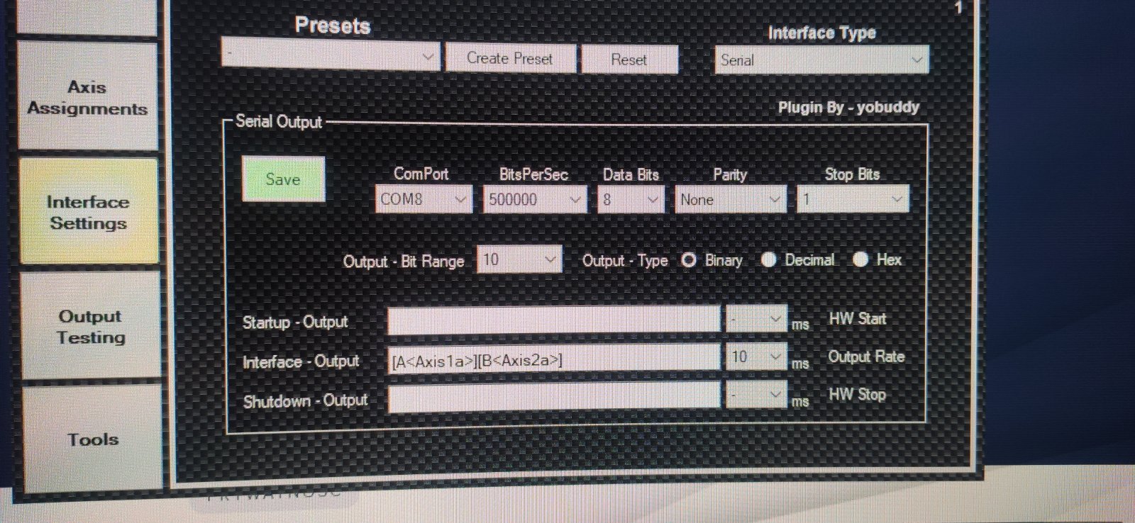

    OK I put my sim tools settings my code my smc3 pic. I do few days off but I don't quit i will do this. For me it's so frustrating becouse my serwo 2dof work instantly and I have clear pot

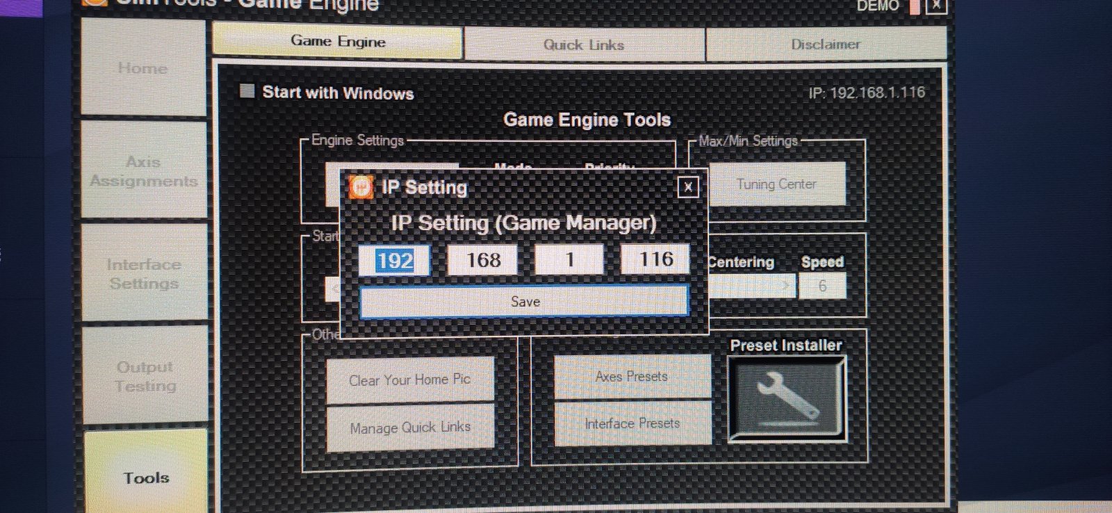

    I have IP address on the upper right side is this incorrect then?

    Is your computer set to English Local: https://www.xsimulator.net/community/faq/simtools-language-setting-bug-change-to-english-local.233/
    The default IP would normally be set to 127.0.0.1

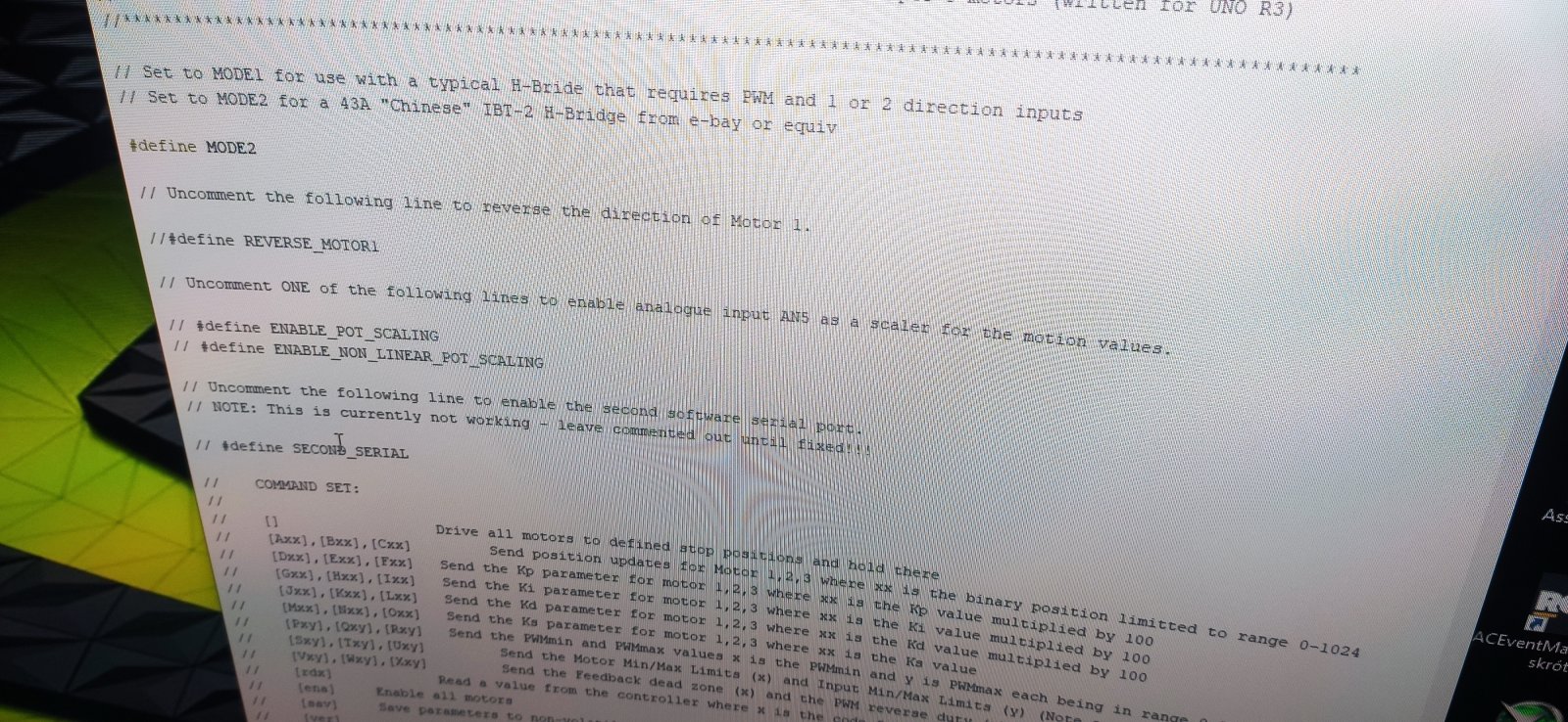

    Is my arduino code right also?
    No motor rewers or pot non linear?
