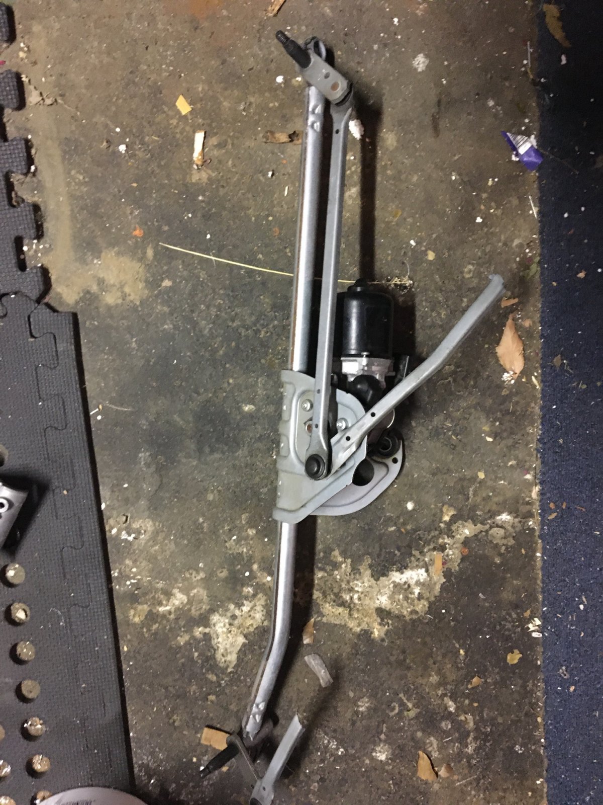

    So, have a collection of parts now that I can start putting together:
    I have a Subaru wiper motor and a BMW Wiper motor; plan is have one on each shoulder strap. Hopefully I can get another matching motor and have 2 the same, but in the meantime it'll do.
    BMW wiper assembly

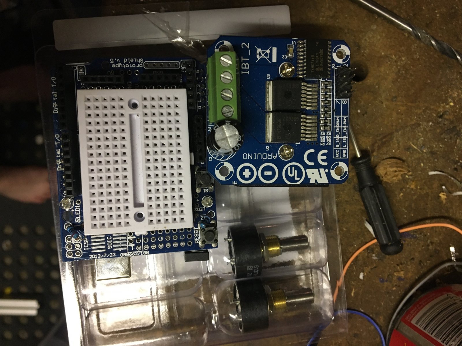

    I’ll be using Mode2 in SMC for the driver as I have a couple of IBT2s laying around. My new Hall effect pots arrived today and I’ll use a breadboard shield to test the motor controls etc

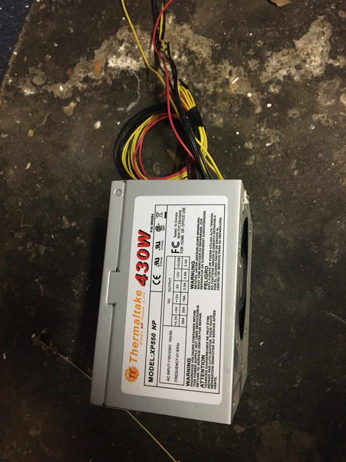

    And for power my initial plan is to use an old psu connected in parallel with a 800CCA car battery - the psu maintaining 12v with the battery able to supply the big amps if needed. Eventually I’ll change the psu to a proper battery charger/maintainer but I’m using what I have laying around for now.

    So today I wired up my Arduino, Driver, pot and motor. Now to test them in the coming days (awaiting my warranty replacement monitor) and design and print the pot mount and a mount for the Uno and driver.

    Down side is I tested the electronics today - as soon as I hooked up the motor power the Arduino started smoking! I have double checked the wiring and it seems to be correct so maybe the IBT is bad. But who knows. I'll look at it more another time as I HATE wiring!! Good news is the Arduino seems to still communicate with the PC so hopefully...... I didn't let all the smoke out :grin

    So, redid my wiring with some better quality Dupont leads instead of the soldered wiring I had (as my existing Dupont wires were crap - only 1 in about 8 had connectivity!)
    Found out that Arduinos don't like being powered by 12v as well as the USB, hence the smoke (I've only used Arduinos stand alone after being programmed so hence the dual connection) but it seems I can't have let it all out as it still works ;)
    Was getting worried for a bit as with the Kp @ 400 and PWMMax @ 255 there was still no movement. So I rechecked and rechecked and rechecked the wiring and continuity and was about to decide the IBT was dead. But bumped the Kp to 450 and it moved! Below is a short video celebrating my success - and yes, at the end my wife of 15 years does ask me how excited I am! :grin
