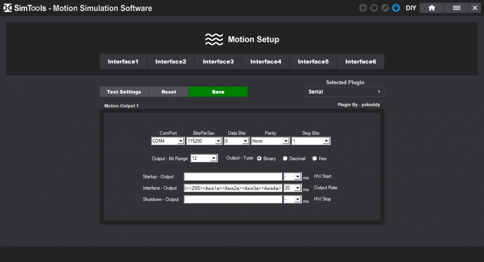

    Hi everyone, I'm trying to configure the interface for Arduino with Simtool v3, but I can't find the right syntax to describe the axes in the photos, it's how I set it but it doesn't work, when starting the test, moving the cursors doesn't work. nothing happens.
    I get my Arduino code from 4dof-controller-code-for-arduino-mega-for-aasd-15a-and-similar-driver

    Please see the SMC3 thread for configuration and other details, which should be: https://www.xsimulator.net/communit...3dof-motor-driver-and-windows-utilities.4957/
    Interface Type - Serial
    ComPort = the Arduino ComPort, you can find it in Windows Device Manager.
    BitsPerSec - 500000
    Data Bits - 8
    Parity - None
    Stop Bit -1
    Output Bit Range - 10
    Output Type - Binary
    Interface Output (3DOF example of format) - [A<Axis1a>][B<Axis2a>][C<Axis3a>]
    Please post SimTools v3 specific questions to the dedicated v3 Beta thread: https://www.xsimulator.net/community/threads/simtools-v3-public-beta.17329/

    Thank you for your help, but it didn't work. My Arduino MEGA2560 actually works well when connected to FlyPT, using the Interface Output of <255><255>. Theoretically, if the same Interface Output is used, simtools should also work well. Perhaps the issue is not with the interface output.

    If everything is corrected, as per requirements, perhaps the issue could be that the SMC3 code is specifically written for the Arduino Uno.

    I used a packet capturing software to intercept the data sent by FLYPT to an Arduino MEGA2560. The Interface Output is <255><255><Axis1a><Axis2a><Axis3a><Axis4a>. It sends out 10 hexadecimal data points: ff ff 01 ec 01 ec 00 f1 00 f1. This means, besides the initial two <255>, it also includes identifiers 00, 01, 02, 03 before each axis' data. Can simtools send this type of data?

    I've figured out the problem. The code I was using for the Arduino MEGA2560 required outputting hexadecimal data preceded by <255><255>, but SimTools seems unable to output <255><255>. So, I've switched to a different Arduino MEGA2560 code. Now, I only need to set the Interface Output as P4<Axis1a><Axis2a><Axis3a><Axis4a>!!
