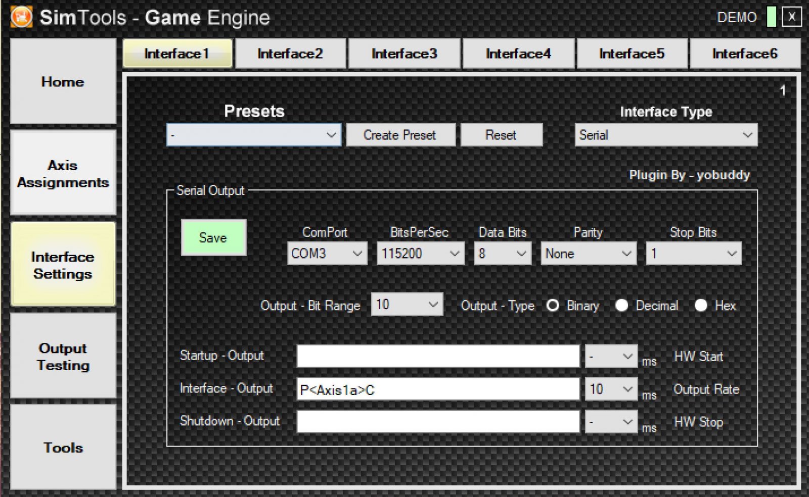

    I am trying to retrieve the data sent from Simtools to the Arduino with the simple following code :
    Code:
    Use this code to check what Simtools send to the Arduino

    I want to know the exact data sent from Simtools because I would like to use stepper motors to build a 2Dof sim rig.
    Here is the configuration :

    Set DOF 1 for Axis 1a to 100% (your only using 4% of the output)
    Your sending the value as a Chr (binary) to the Arduino.(a chr can be a value of 0 to 255)
    (for testing set it to 8 bit output)
    Then you need to convert it back into a value in the ard.
    int_output = atoi(char_input);
    Let me know how it goes.

    Please remove the "P" from the output line and try again buddy.
    Make it simple with just "<Axis1a>" for the output.
    Chat soon,

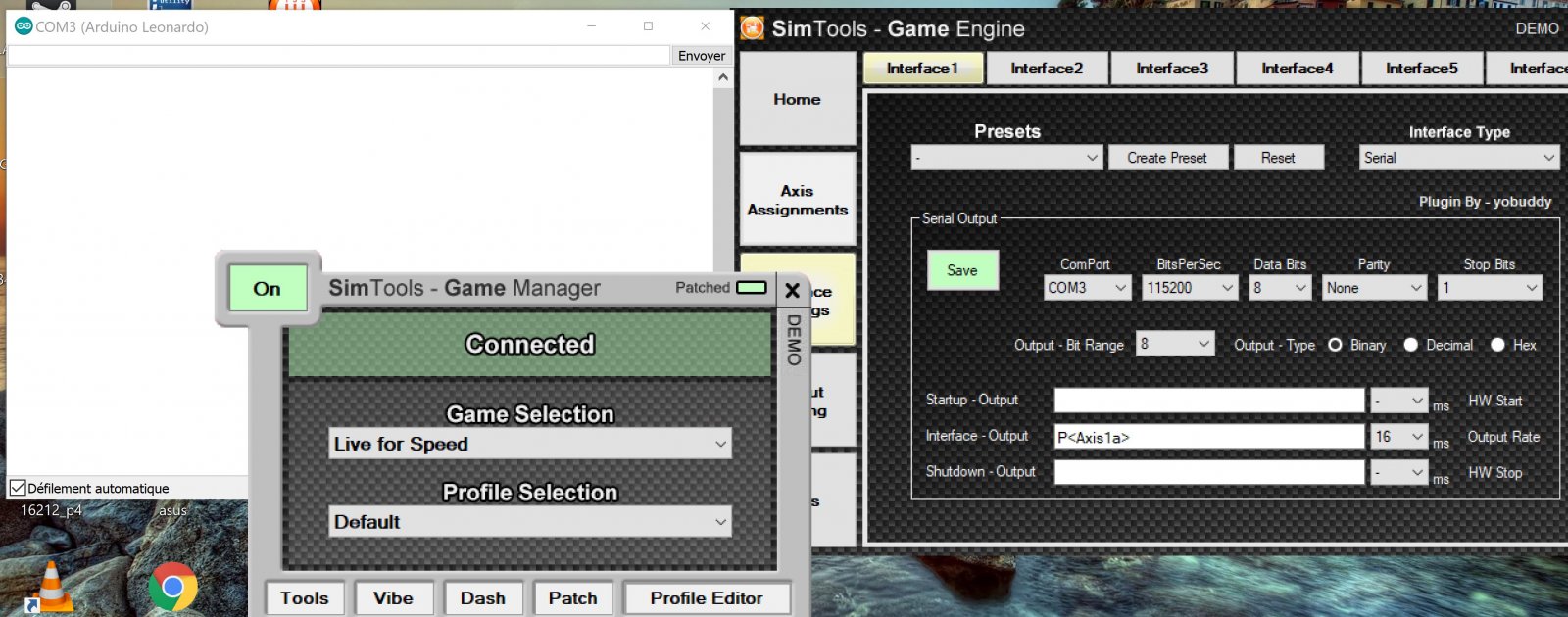

    I tried to remove the P, but it doesn't changed the problem.
    Now here is what I tried : if Serial.available()>0, light one led. And it works ! The Simtools send datas to arduino, the problem is that it probably doesn't managed to send it back to the computer...
    By the way, this seems to only work with the arduino nano, not with the Leonardo...

    In your last picture, the Arduino serial monitor is open.
    You have to close it.
    You can't use the COM port simultaneously in the Arduino serial monitor and SimTools.
    Might not be this, but it shows it open in your pictures and it must be closed.

    Yes good advice, I will try this code. I will have to wait for the Uno to arrive... I started to read the code, far more complex than what I am used to...
    That's what I feared... So how can you read the data sent ? Maybe I will try to put an lcd panel on the arduino :)

    Hi again ! I make a code that allows to display pitch data on a LCD. Now the problem is that numbers are quite strange.. It goes from 0 to 255 but in a strange way.
    0% is 0 or 253 (when the cursor comes back and forth to the same position),
    50% is 0 or 255
    100% is 255
    -100% is 0
    -50% is 255
    Then we fo from 0% to 50% by 2 or by 3 (it change everytime...), the same goes for -100% to -50% etc
    Here is the code. And then the settings. Axe limiting is 100%.

    If you want 0 to 255 output use 8 bit output not 10 as you have it set now which is outputting 0 to 1023.

    That makes sense, but when I use 8 bit range output, nothing appears on the LCD...

    With 8 bit output P is first, value is second, and C is third, so with 8 bit yes. But with 10bit output (and up thru 16 bit) P is first, value hi is second, value low is third, and C is forth. To get the 10 bit value you have to multiply value hi by 256 then add value low to that.
    (value hi * 256) + value low

    Thanks it works ! Here is the final code :
