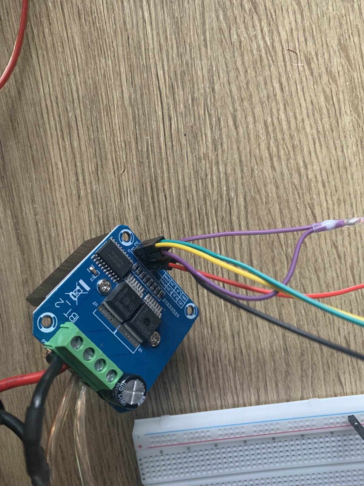

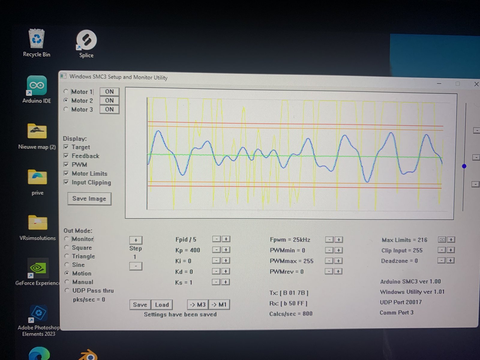

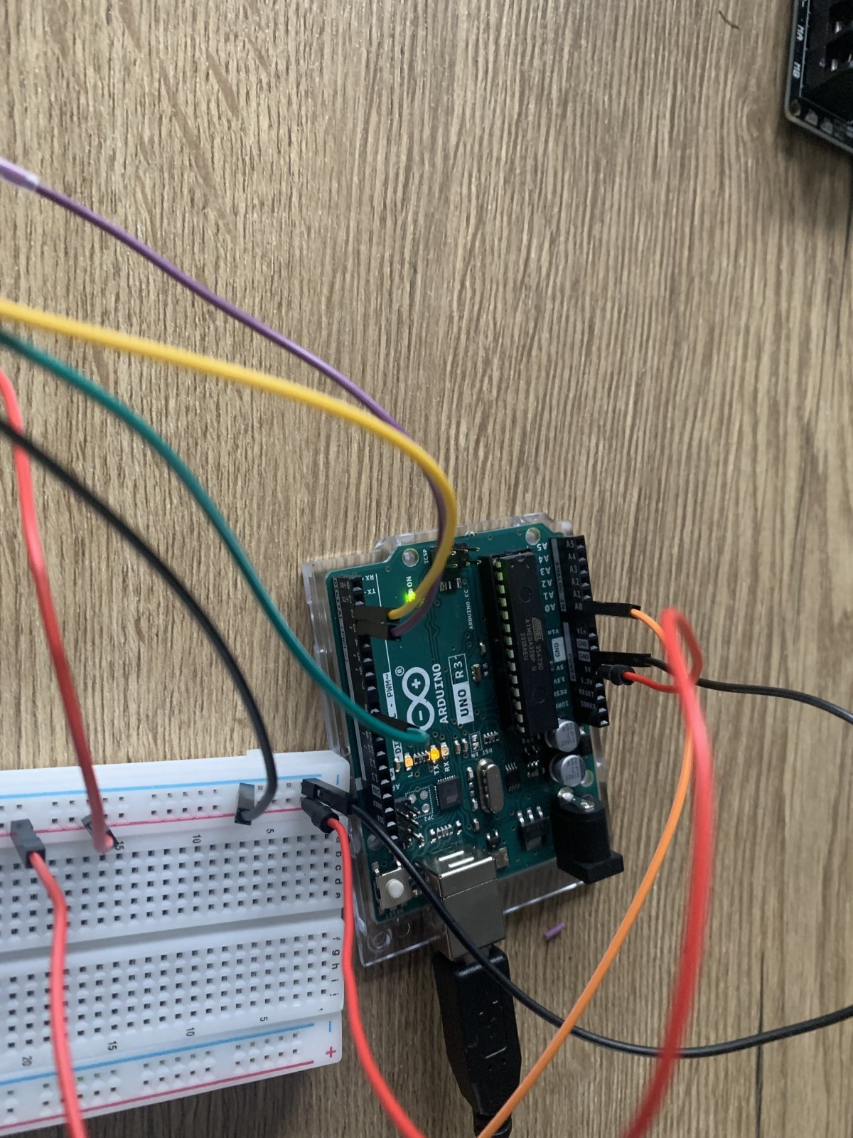

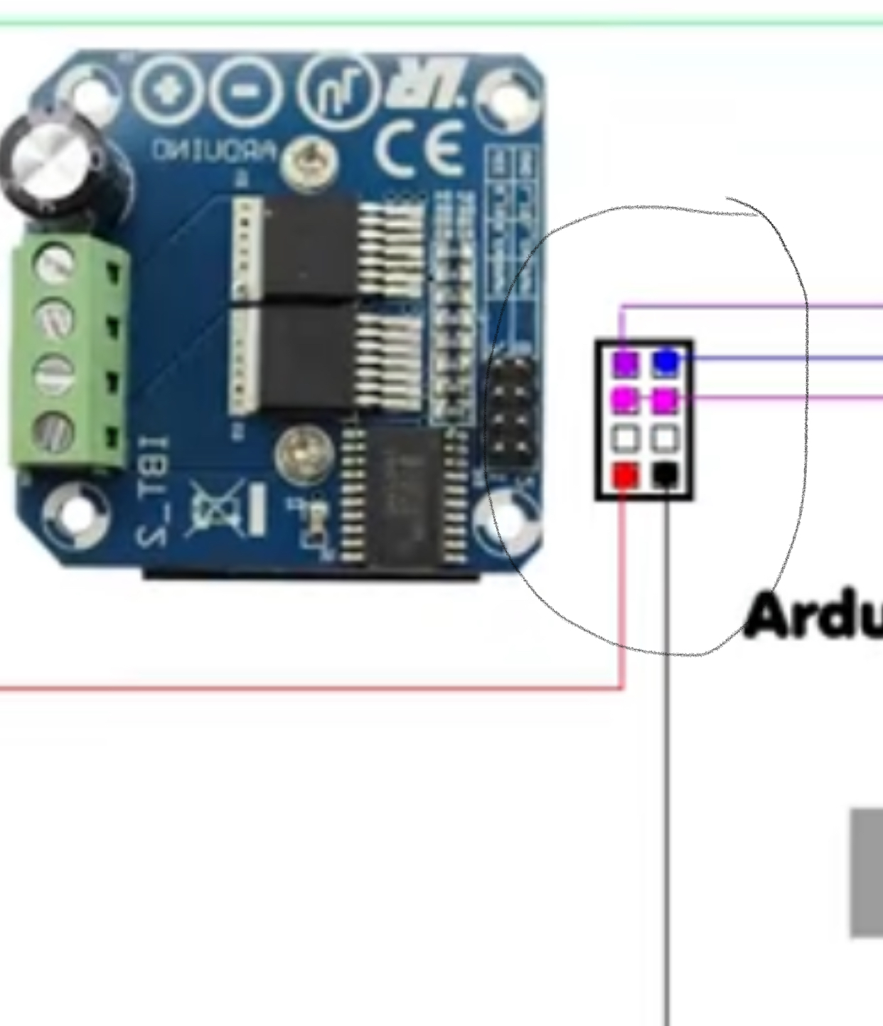

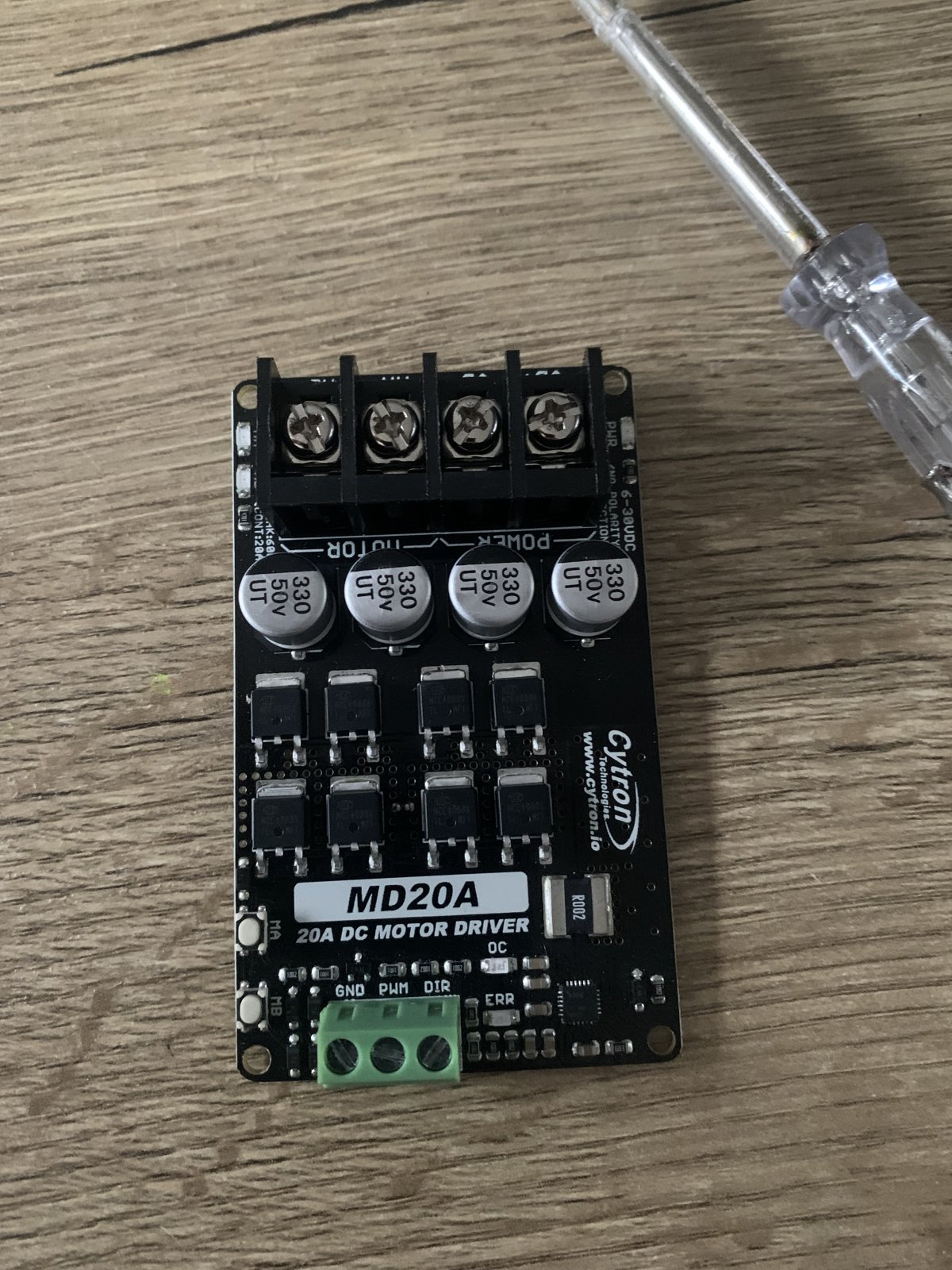

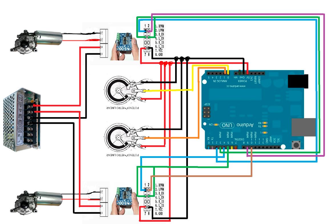

    I’m new to Al of this but I install everything on my arduino r3 for Smc3 version v1.0. And install the 2 ibt2 motor drivers to my arduino. I have set the mode to mode2. I have wire everything just like in the pic to my arduino and motor drivers. When I start scm3 the motor ar not moving at all when I turn the potmeter I only see the green line moving. What can it be do I need to change more in the code ?
    This is how I wired everything.

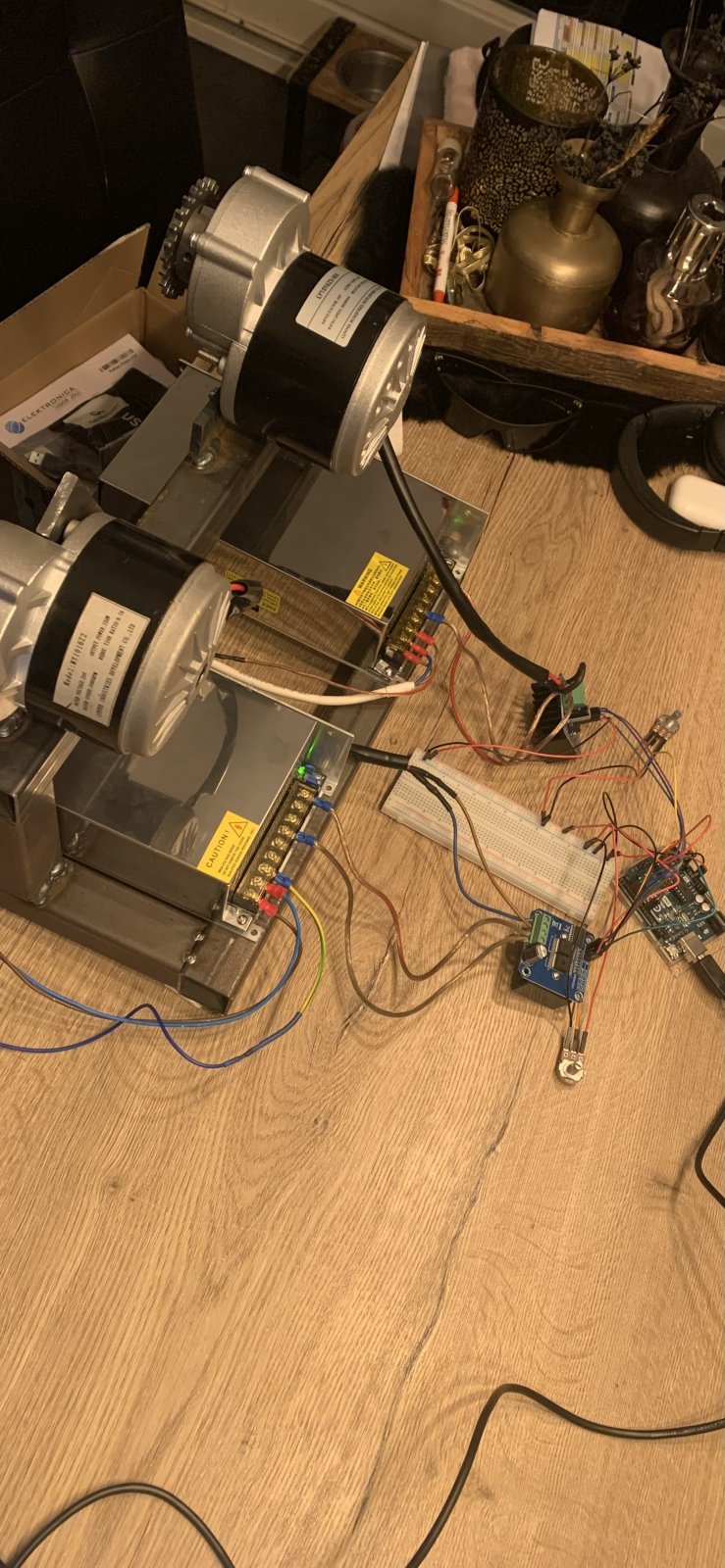

    Can somebody help me with this. Only thing that I have don what is not in this pic is I have 2 power supply’s instead of 1
    I have two motors dc 350w

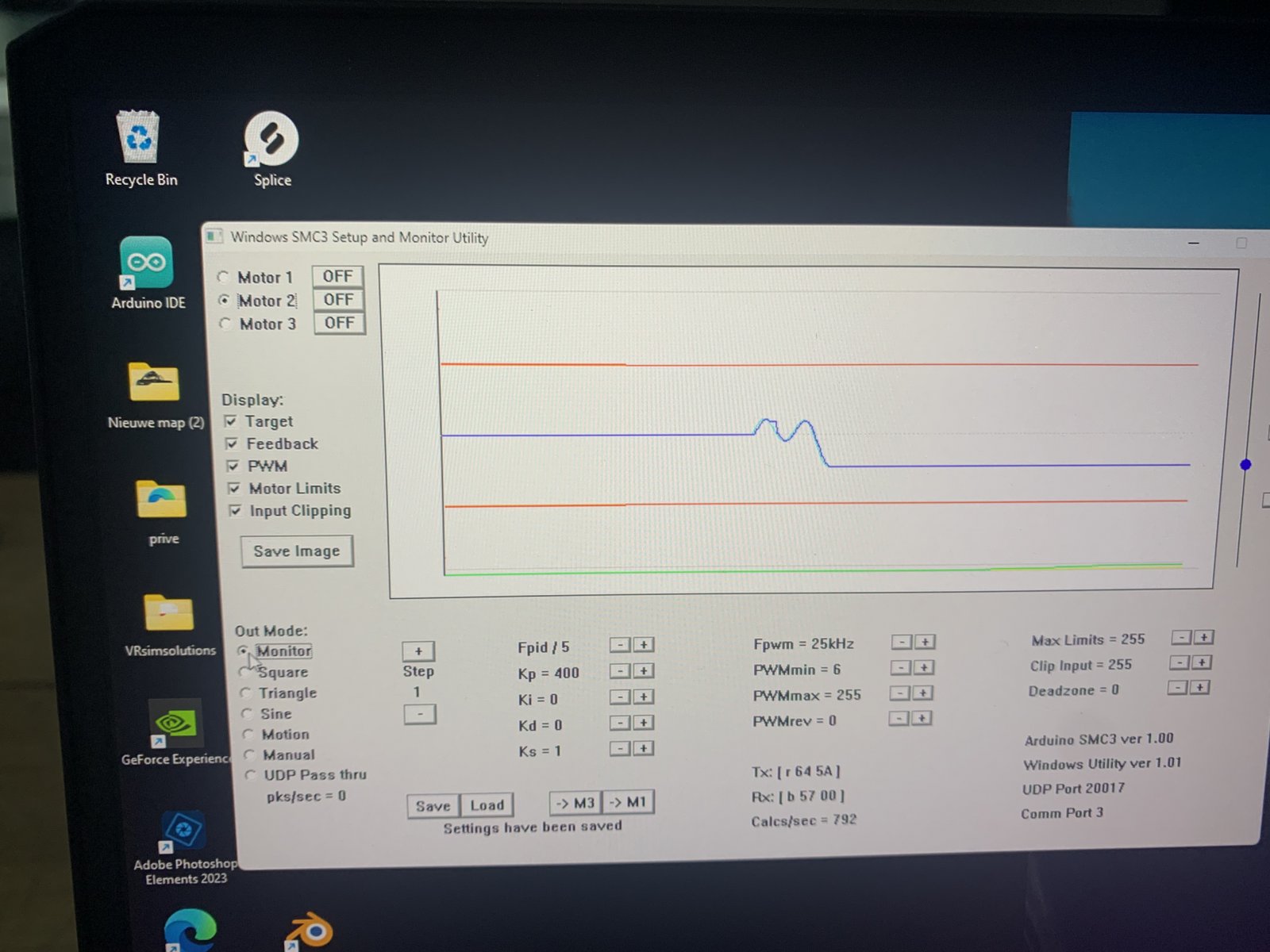

    Please post pictures of all of your SMC3 settings.

    I will when I am home.

    can it be that I’m only connected pin 4 to the arduino and not 3 and 4 as in the pic. That the motor is not working ?

    And this when I turn motion on

    I also have this motor driver from cytron can I also use this whit the same code ?

    Are the pots connected to the motors, as the pots provide positional feedback?
    Have you tested the output of the IBT2s with a multimeter?
    See the FAQs for @Blame73's modified SMC3 for Cytron: Modified SMC3 code for Cytron controllers by @Blame73: https://www.xsimulator.net/community/threads/blame73s-2dof-seat-mover.6029/page-22#post-198335
    And Cytron MD13S for SMC3 by @Robbie Teengs, with PDF by Hennie Crous: https://www.xsimulator.net/community/threads/wiring-arduino-and-cytron-13s.14506/#post-195493

    The ibt2 are dead but I have the md20a running now and it is working is simtools now I think I need some better pots because the one that I have are bad.
