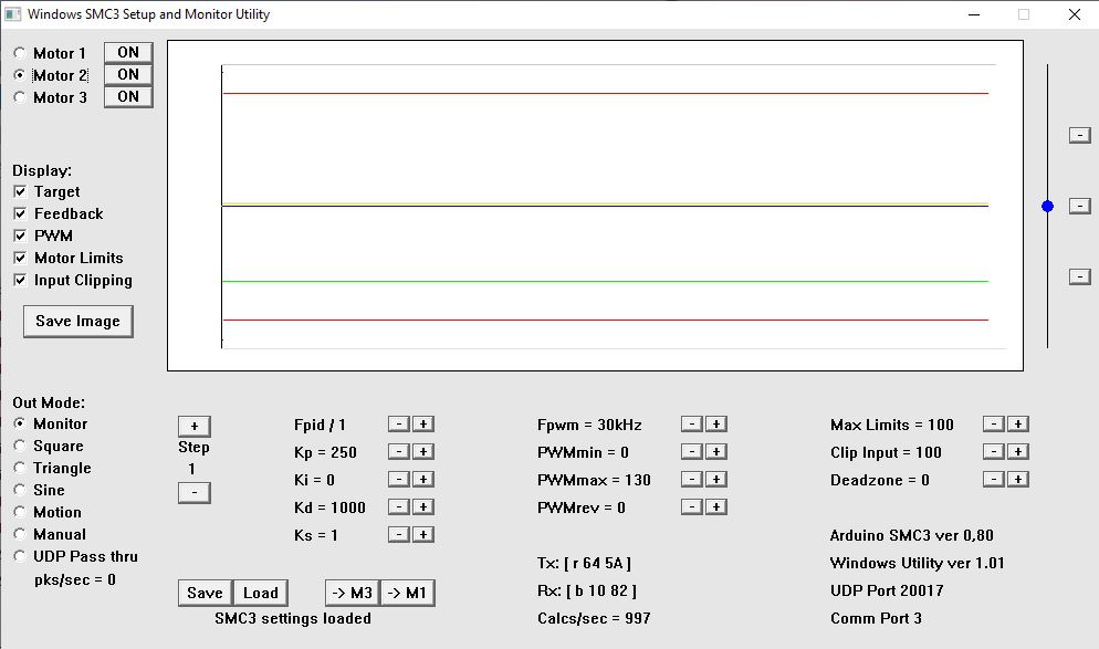

    HELP!
    I got into testing with the Sabertooth 2x32. All parameters are the same as they were with the IBT_2 in testing and it worked fine, even with SimTools and ProjectCars 2. So then it can't be the pots or the motors, can they?
    What can cause the problem and how do I fix it?
    Would be greatful for quick anwers! I got my Sabertooth just today and the end of the project sadly is tomorrow...

    This looks like an overriding control Circuit. Try other SMC3 Values. Lower KP, slower FPid...KD.... play with that Values.

    I played with everything, it just get any more worse. Don't know what else I can do now

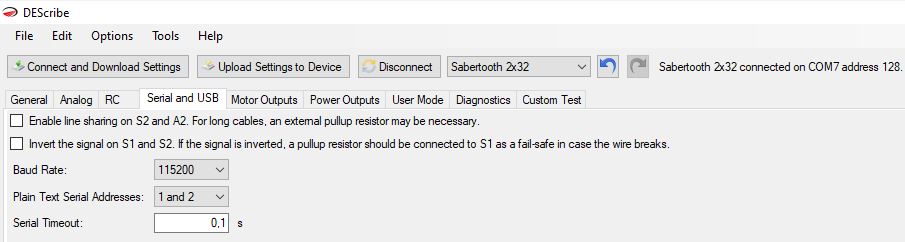

    1.
    Wired Sabertooth 2x32 via USB (com7), set baud rate to 115200 and serial timeout to 100ms.
    2.
    Wired Arduino Uno via USB (com3) and uploaded SMC3 code from @BlazinH.
    3.
    Changed to com port 3 in SMC3 settings.
    4.
    Started SMC3 with this settings.
    (In this picture the motors are not connected to electricity.)
    Found out when I set Kd higher, it get smoother, as well as when I set Kp lower. When I start increasing PWMmin or PWMrev the shaking gets even more worse.
