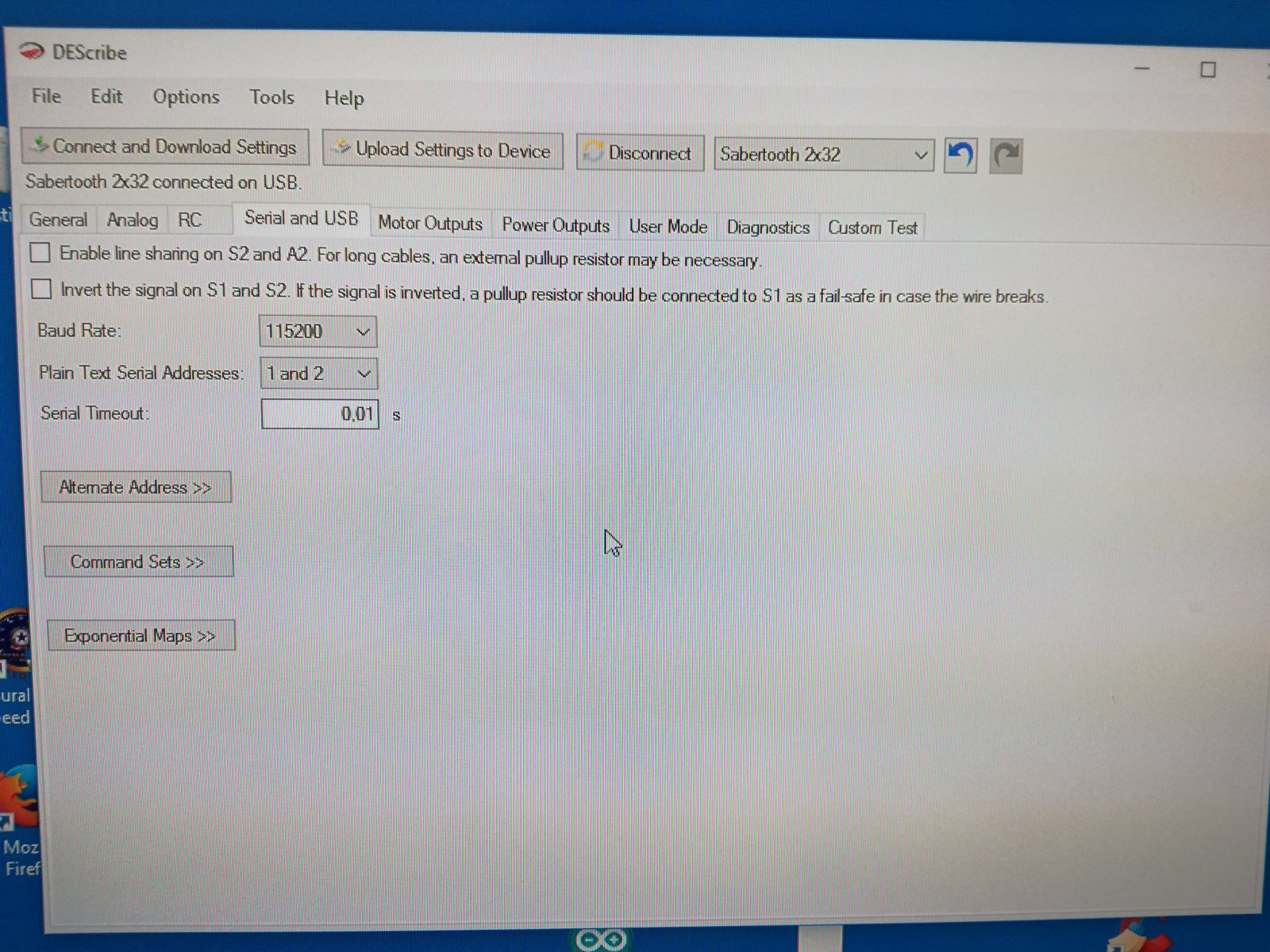

    gday mate im using sabertooth 2x60 have you set the baud rate in the software..

    yes I set 115200 in describe
    I don't know how set serial timeouts at 100 m/s . describe show "s" and not m/s so I try to write 0,010 but not accepted. so I wrote 100 but I don't know if this mean 100 s or 100 m/s

    ok well i use the 2x60 and it auto baud i dont need the software so i cant help you with that sorry. but ill have a look and see if i can help u bro

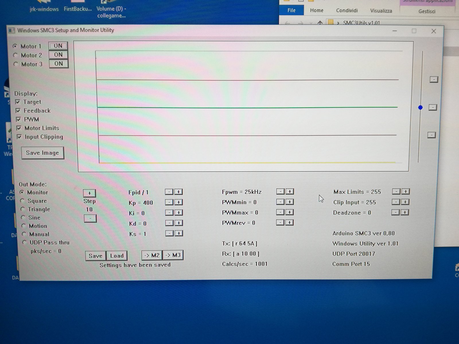

    these are my descibe set and smc3 set

    one thing i just noticed is in smc3 my calcs/sec is 100
    your is 1001 could this be my issue
  11. Evan Rowlands
    Evan Rowlands EMR Industries
    Jan 22, 2017
    190
    business owner/ EMR industries
    Melbourne Australia
    - 72Coins
    +32 / 0 / -0
    i worked out my frid was 10 thats why it was 100 if i put it to 1 like yours my motors had a delay from m1 to m2

    The tutorial specify to set it At 100 m/s . Describe string show "s" and not m/s so if you write 100 it should mean 100 s and not 100 m/s. For these reason i wrote 0,01 s that mean 100 m/s. But if in correct i write 100.
