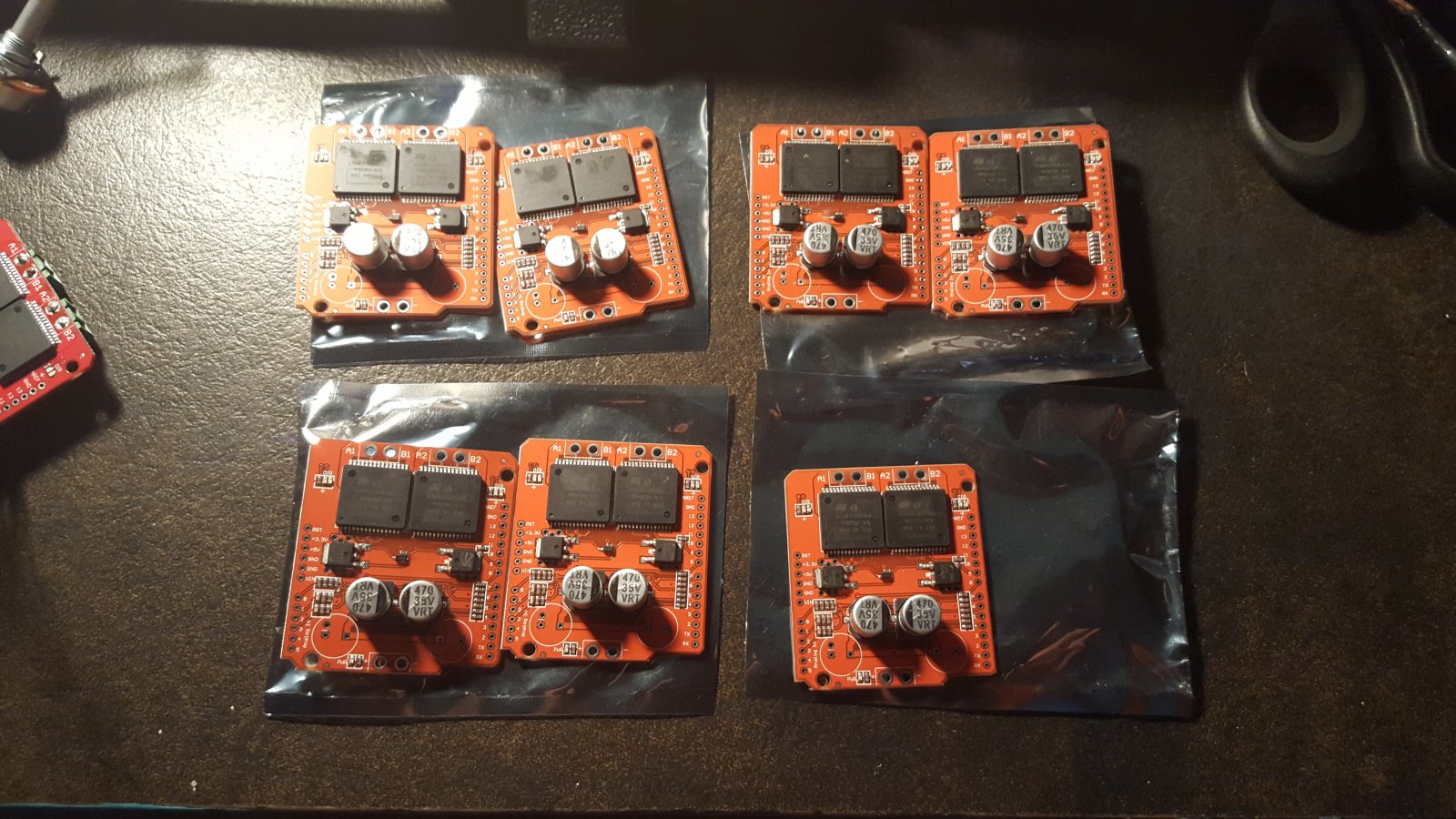

  11. bruce stephen
    Jun 7, 2015
    1,286
    general contractor
    michigan
    9,115Coins
    +1,243 / 9 / -0
    20150728_135151.jpg new motos from same seller are now just copies. the sparkfun ones i got looked better made. so i got 7 copies and only 1 doa. got refund in less than 24 hrs. the funny thing is even though these show up working they are cheaply made. a lot of the components are crooked and sloppy on the boards. 5 of the six working boards have a red power led and one has a green led. all the same tho. green led must have slipped into the pile. proof that QC is not a priority. In the end I'm just glad they work. we will see for how long tho.
  12. SilentChill
    2,645
    20,599Coins
    +3,570 / 34 / -0
    Yeah these MM's are total hit and miss, Im glad I finally got 12 that worked. I still have 8 I just cant be arsed making video proof that they are all not working.
