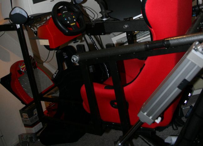

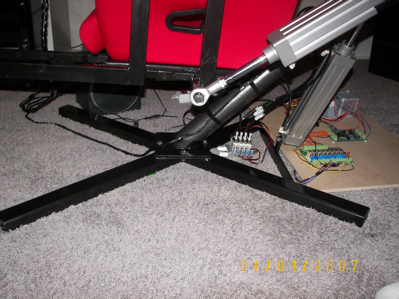

    I have a highly modded RnR. The base has been widened. The roll arms have been lengthened and reinforced. I'm now trying to upgrade the old pneumatic pistons with DC motors and Jerks.
    The motor is a Model ZY7712, 12 volt, 200 watts running off a 40 amp power supply.
    The motor arm is 25cm long. The push rod is 36cm long.
    The chair is well balanced and rolls left or right with little effort when pushed.
    However, when the motor is controlled by mouse under the Pololu utility, it can't seem to roll the chair any where near its full range. When a passenger is seated in the simulator, the motor just twitches a few degrees port and starboard. The motors need to move a 100kg.
    As soon as I disconnect the levers from any load, they move fast and crisply.

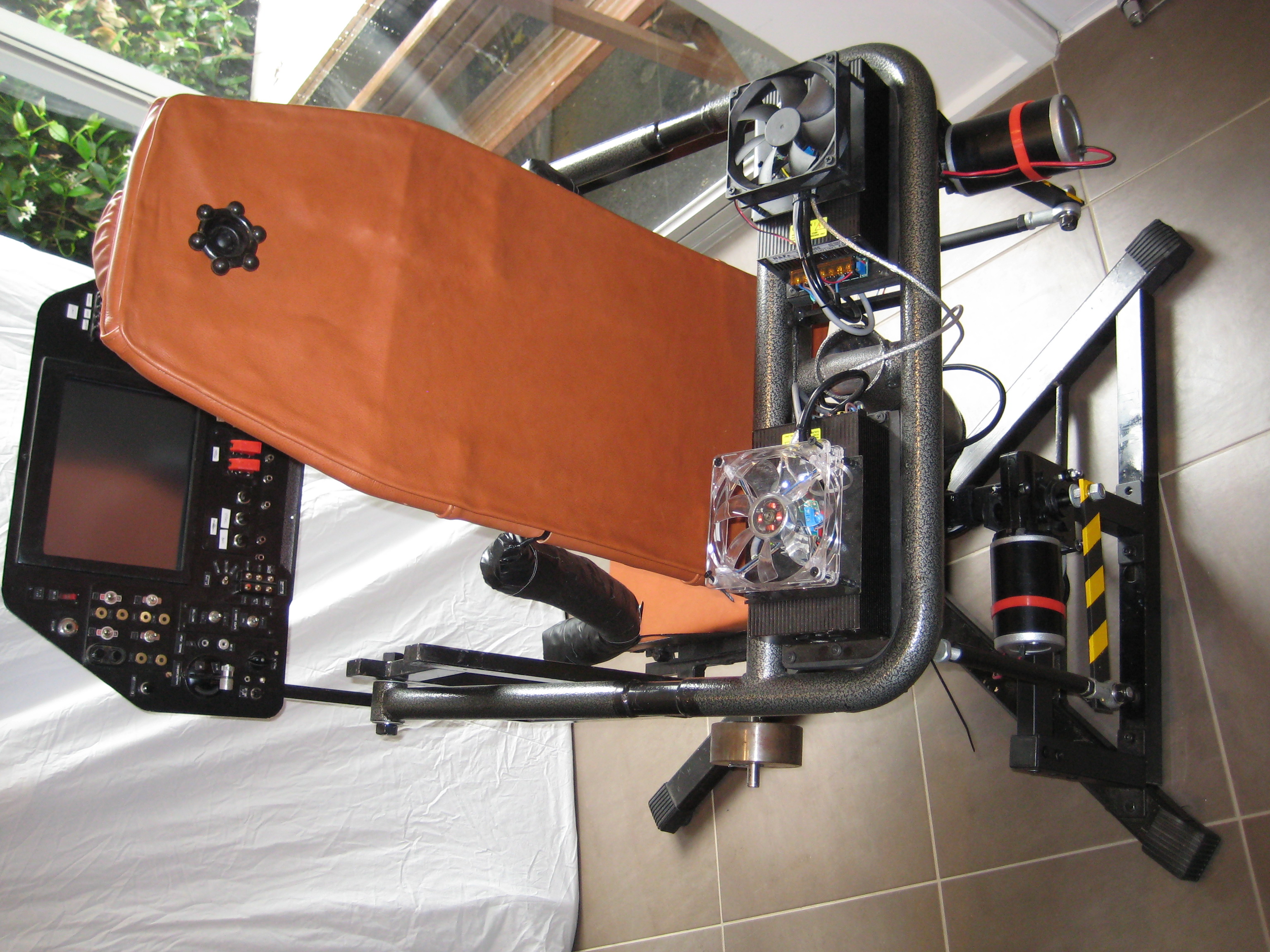

    The pitch motor looks like this:
    This motor is mounted underneath the roll arm of the frame. I suspect this one in particular is underpowered as the pitch mechanics of the chair are tougher than the roll.
    Are these motors, or design, inappropriate for a RnR type simulator? Suggestions?

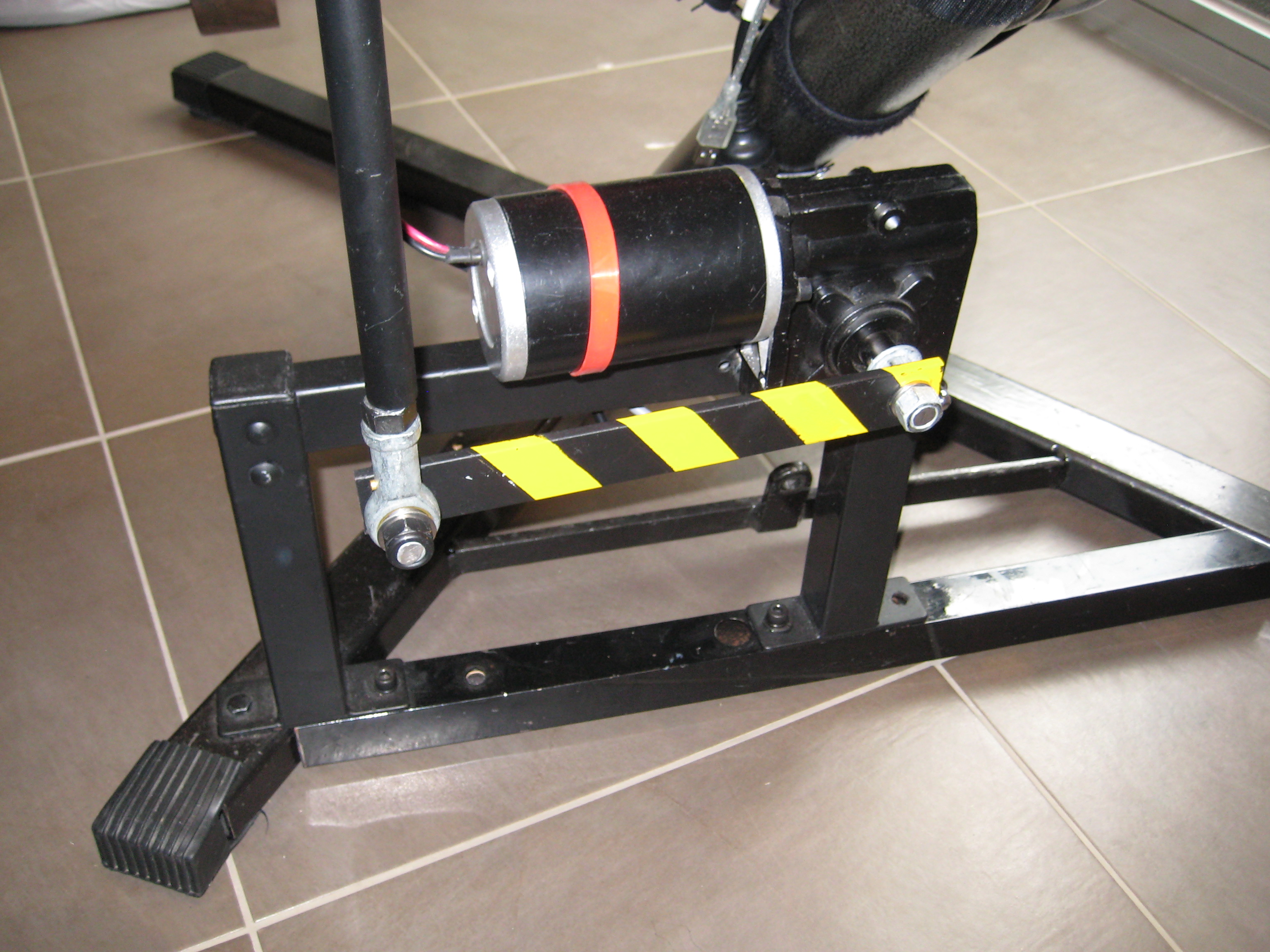

    Hi, I would suggest your lever arm (the one wrapped in yellow/black tape) is way too long. The longer this arm the greater the torque needed from the motor. Typical designs use lever arms around 50mm to 75mm. The torque on the motor is: T = radius x Force
    So in your case the radius is 5 times longer than say a 50mm lever design which is requiring 5x torque from the motor.
    The shorter the lever arm the easier the motor has to work (and the cooler your H-Bridge will be) however the downside is the smaller the lever arm the less movement you will get. You can get around this if you really want to but the designs generally start to get a bit different - I use a rope/pulley setup that has an "effective" lever arm of about 20mm, the motors have no problem moving the seat and I have 200mm overall movement.
    Personally I have only ever built the one sim so maybe some members that have experience with more than one can confirm this for us.

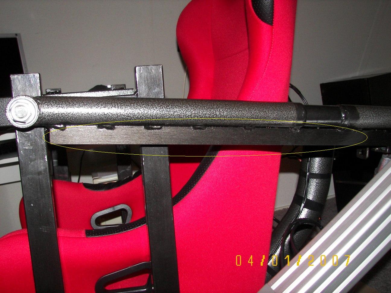

    I cut the lever arm down on the roll axis to 8 cm. In the Pololu utility I can roll -- with a passenger seated -- to any degree and hold that position for however long . Problem solved.
    Pitch is killing me. The nose up / nose down axis is proving much harder to solve. The previous owner used two pneumatic pistons on either side to power the pitch.

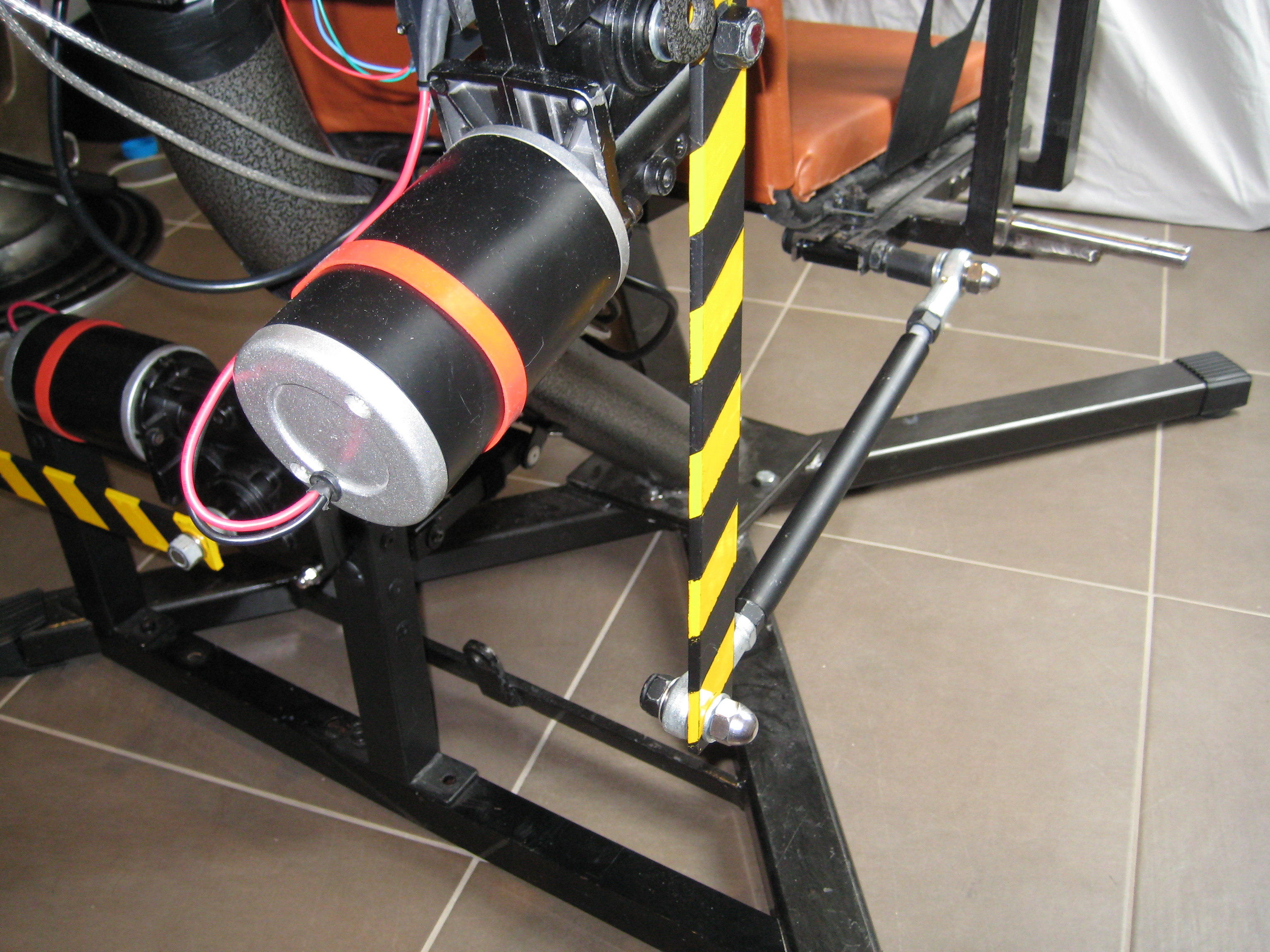

    I tried cutting down the lever arm on the pitch motor but no luck. Even using the eaorobbie's and bsft's PID & Motor settings the movement was weak and position couldn't be held. This being a flight rig holding a angle trumps the quick up and down bumps and vibrations one needs to simulate while driving. Imagine a steep bank in an airplane. Basically the rig needs to lean and hold steady which challenges the motor differently.
    My next experiment is using two motors to push and pull the pitch. One motor mounted on each side of the roll arm gimbal but acting as one.
    My questions are these:
    1) What sort of geometry should I be aware of as I mount the motors? This is the old set up.
    Motor lever and push rod must be at 90 degrees to one another. Check.
    What about the hard point? Should it be behind the seat? More towards the passenger's knees?
    Just not sure of the mechanics and best leverage for the setup.
    2) How do I wire two motors and two Jrks to operate in tandem?
    Do I go through the LEARN procedure in the Pololu utility for one motor and then type in the same values for the 2nd motor? Will this work? Ideas?

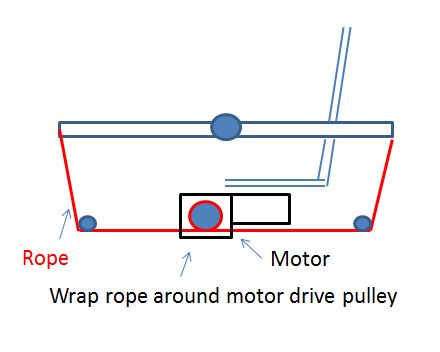

    Keep thinking, more than one way to solve the problem... If you like the chain and gear approach but not interested in welding, what about using rope and pulleys. You may be surprised how strong a pulley made by gluing three discs of MDF wood sheets (or plywood, etc) together can be - one smaller disc in between two larger discs - and there are plenty of ropes available that will hold up to the job.
    I am sure there are plenty of other ways to move you sim as well - get creative, do some experiments :grin

    Rufus thanks for the pulley diagram. A picture truly is worth a thousand words. This'll be my fall back solution.
