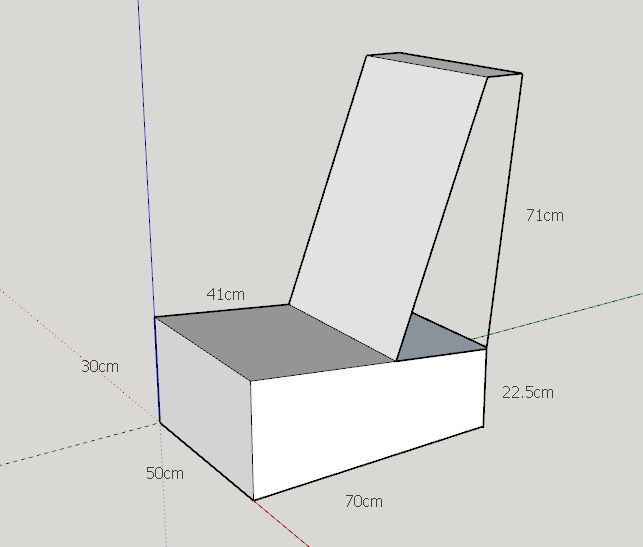

    @MarkusB here is a quick sketch to show the measurements. It is just the right size for the motor and belt tensioner arrangement that I went with.
    The seat base is angled at approximately 10 degrees off horizontal with the backrest angled a further 10 degrees (20 degrees off vertical). The measurements are not exact but are fairly close. My amateur welding and cutting skills meant I was more concerned with keeping it square rather than exact!
    I will provide details of the flap sizes and spacing once they are finalized. I have already changed the backrest flaps once and I'm not certain where the numbers will end up for the seat base until I get them trial fitted and do more testing.

    @RiftFlyer: Thanks a lot for the measurements, this is very helpful!

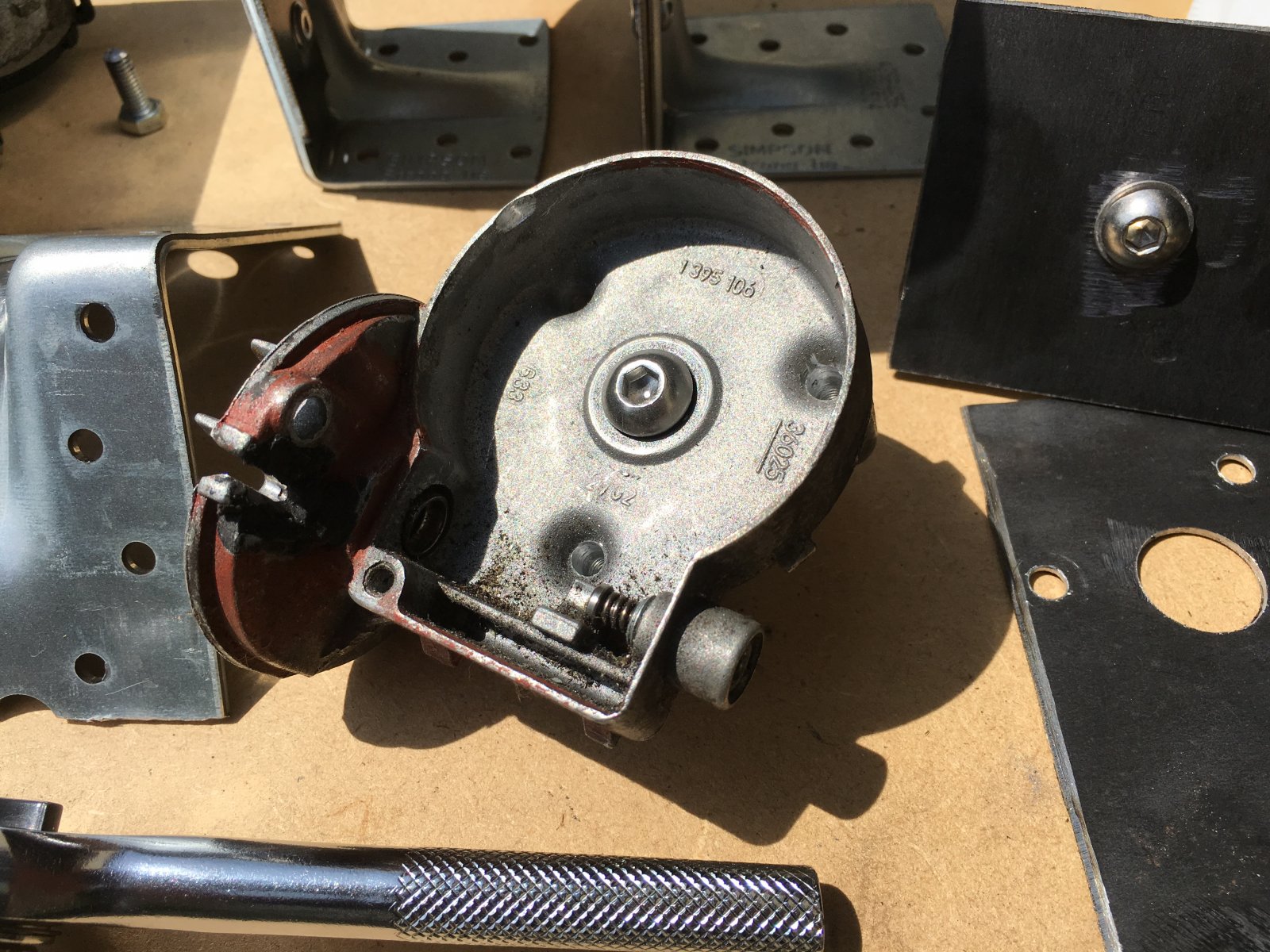

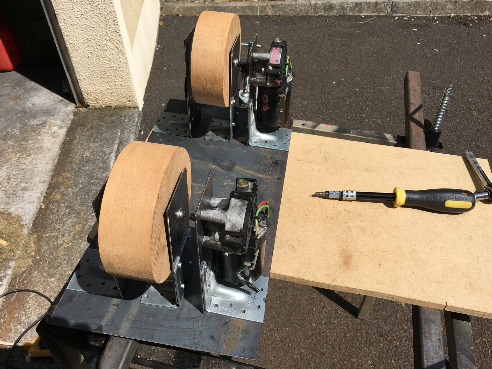

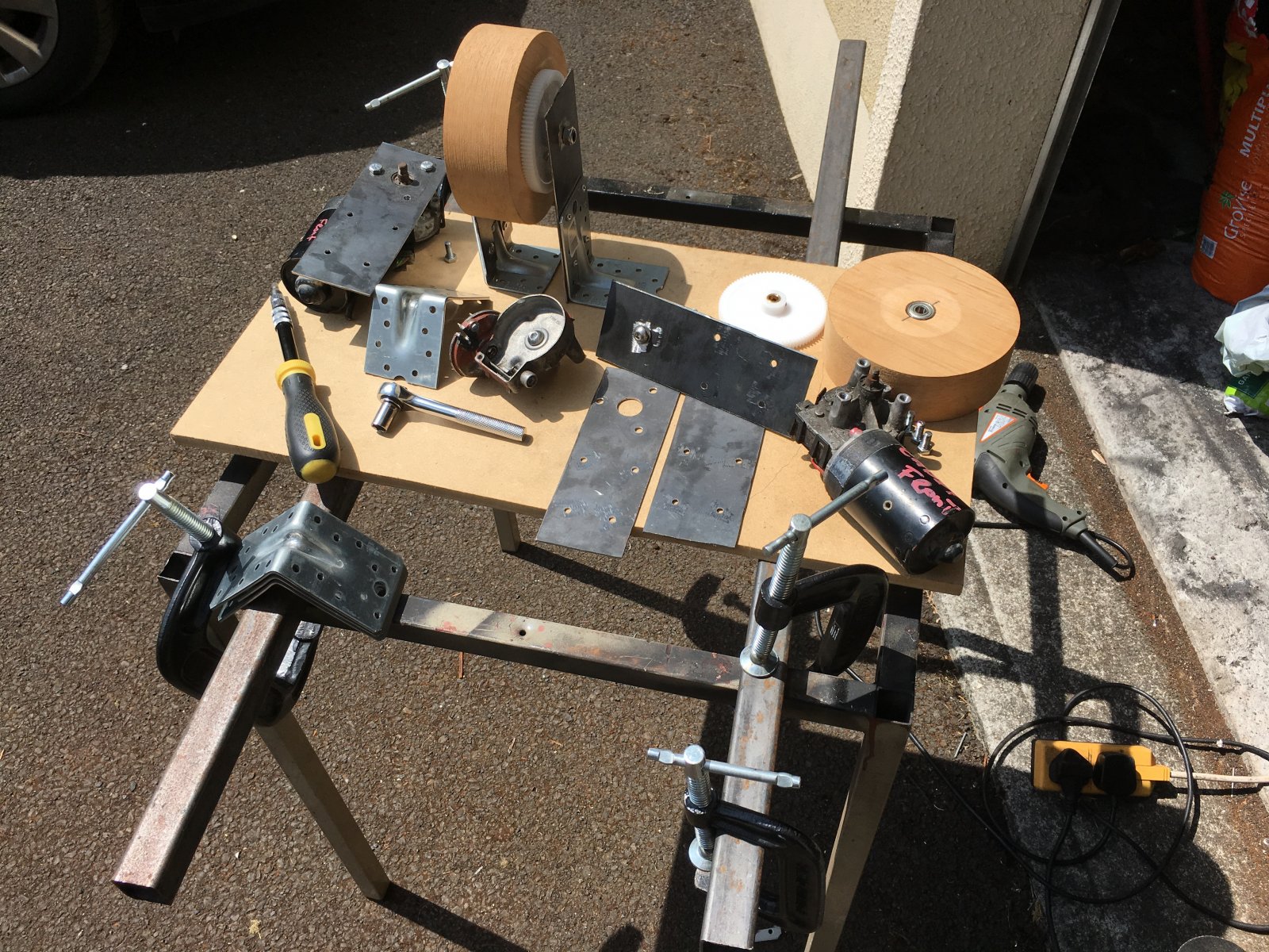

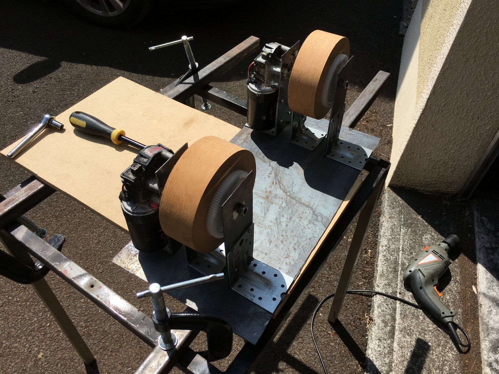

    I got some time today to make some progress on the base of the seat. I cut some steel plates to make up brackets for the pulleys and motors.
    I also drilled out the bolt holes on an old wiper motor gearbox housing to make a drill template for the three mounting bolt holes on the bracket. I added painters tape to an 8 mm bolt until it fit snug in the hole and then fixed the plate on the bolt and secured with a nut on the other side. I then used my drill to make the three bolt holes in the plate. Once the jig was removed I could then open up the centre hole to make room for the full width of the motor output shaft.
    This made life so much easier. The last time out with the backrest I had a lot of issues with alignment (the pulley axis and motor axis must be perfectly aligned to avoid torsion and flex being introduced when the motor arm moves). With this method my alignment is spot on. Next I need to add a few brackets to secure the pots to the pulley bracket and also shape the top of the brackets so the motor arm wont touch. I'll be mounting the motor and pulley arrangements on a steel plate which I can then slide into place in the base of the seat. Here I am marking up the positions before drilling the bracket mounting holes.

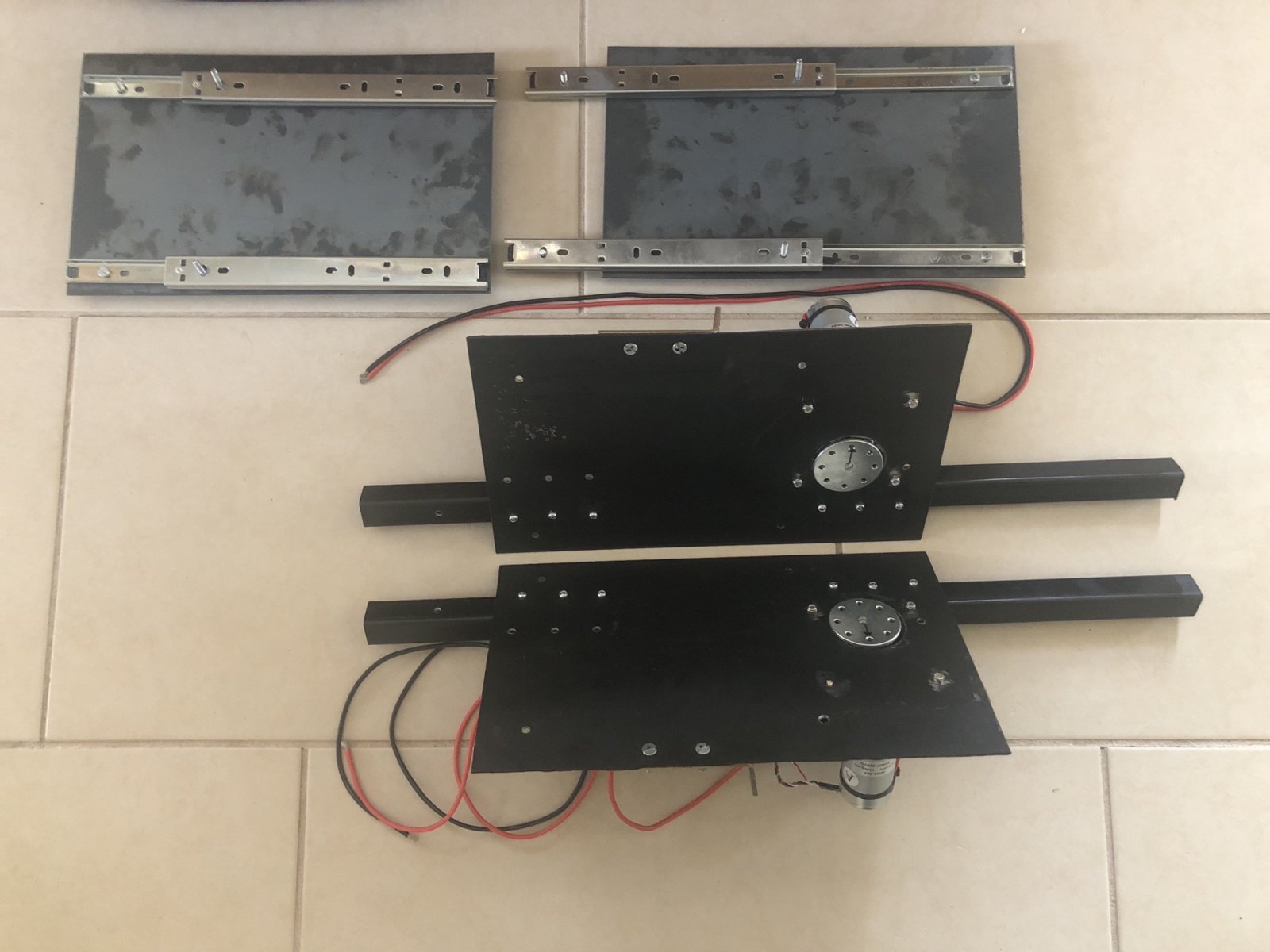

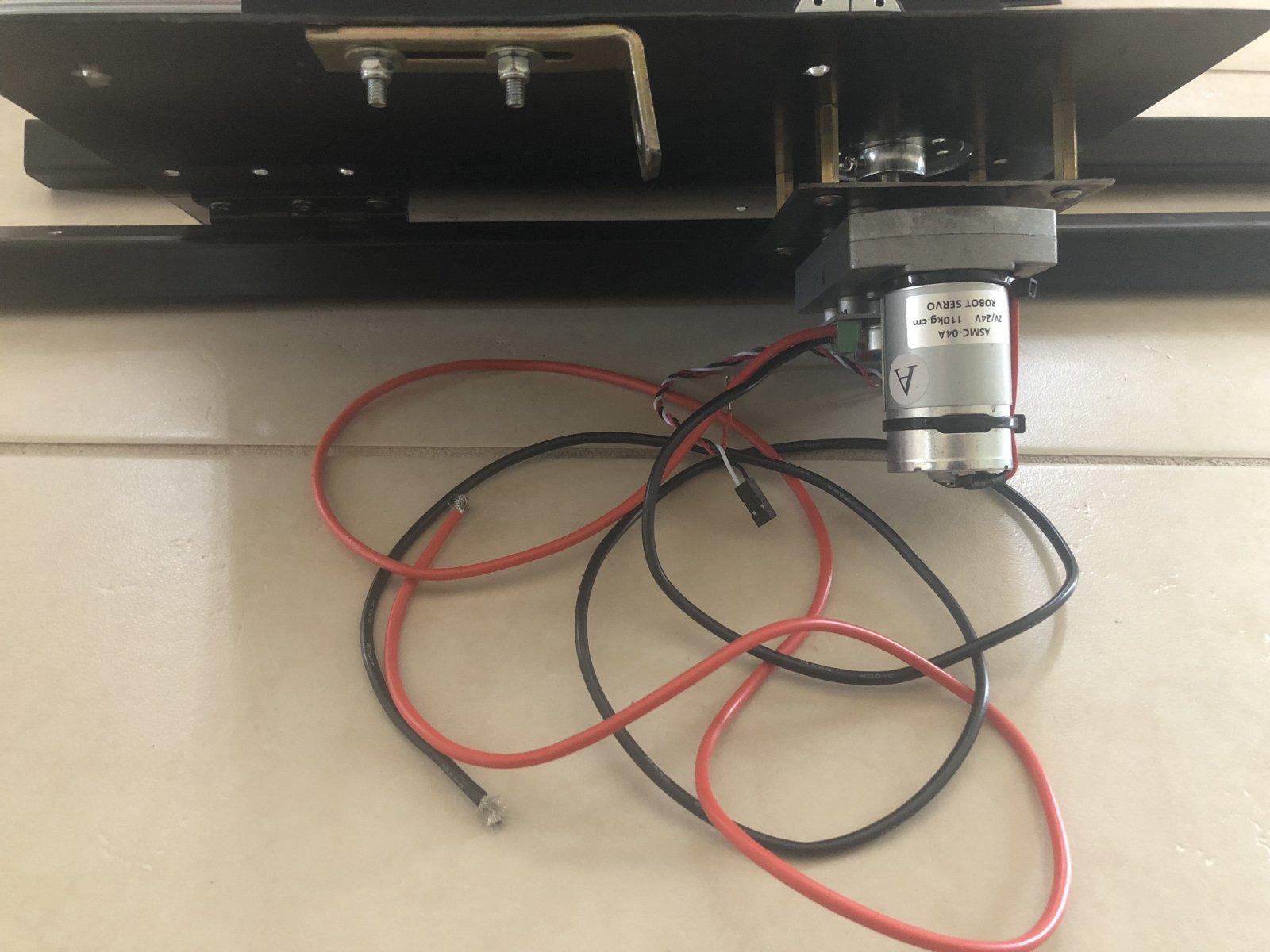

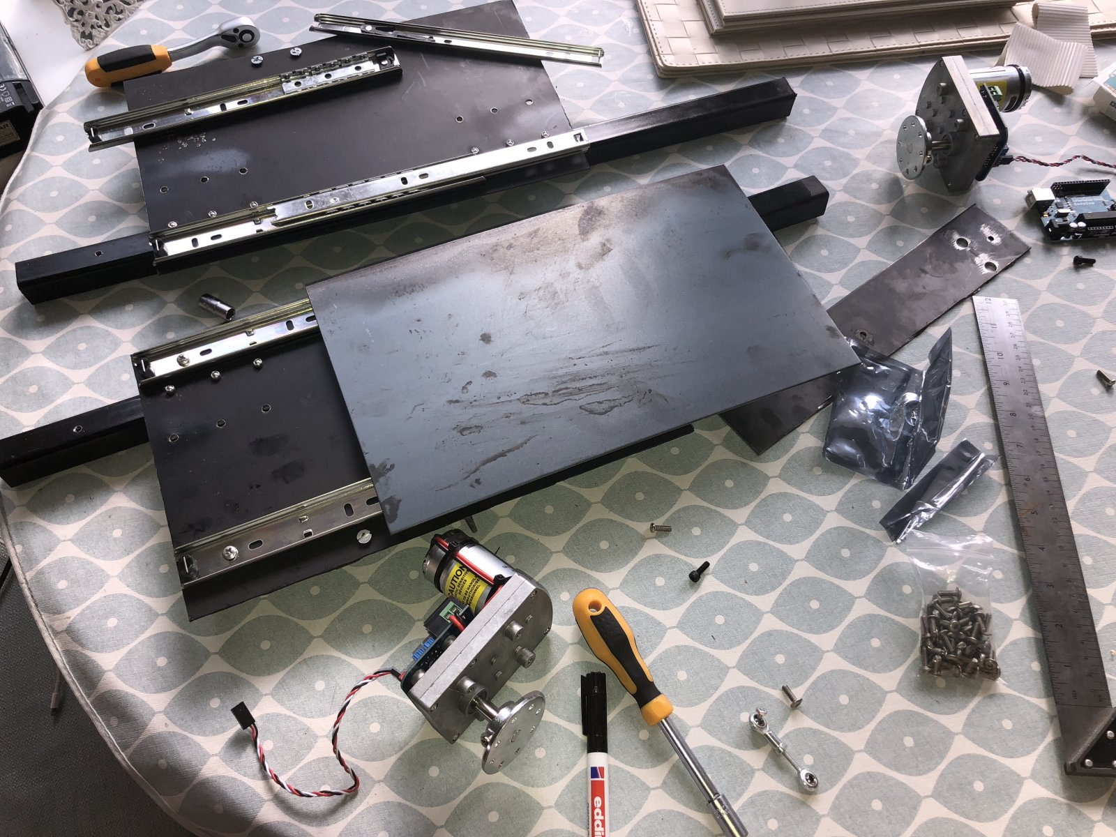

    Well guys the never ending G-Seat is getting some attention again. The base is being completely reworked (third times a charm). While it was taken apart I started exploring other additions I could make.
    I decided to add an addition to the backrest. A very slight vertical (heave) component to the flaps to compliment the heave sensation from the seat base. I’m using drawer runners to allow the backrest flaps to slide up and down in addition to the existing wiper motor driven surge in and out component.
    I took inspiration from @Spit40 and picked up a few Chinese 24volt servos. The servo wheels are massive though so it’s going to take some work to fit them behind the drawer runners. I didn’t fully appreciate the size of these things until they arrived. I am waiting on some standoffs so the servos can be mounted on the back of the existing flaps and hopefully the wheels will then fit between the existing flap and the new flap which is attached to the runners. I’ll join the wheel to the flap with some M4 rod and ball joints which will hopefully allow the flaps to slide up and down while driven by the servo.
    Now that X-Plane has VR support I’m more enthusiastic than ever about getting this seat finished and working as well as it can.

    The standoffs I required finally arrived. They are really soft brass. I already broke the threaded portion off one tightening a locknut! I may have to do a rethink on how I support the servos. The standoffs were originally going to connect directly to the servos (hence the m4 thread) but I soon discovered the servo wheel obstructs two of the servo mounting holes. This called for an extra plate to be added so the supports could clear the servo wheel. I made up the plates and left enough room to move up to M5 size threaded spacers .
    Anyway, I got the servos test fitted on the rear of the backrest flaps and have the front plates with drawer runners ready to fit. They slide well on the internal bearing runner which means they are nice and quiet.
    I need to open up the holes on the backrest flaps for the servo wheels a little more but I think I’ll be left with a very compact solution. The servos only just clear the belt tensioning rollers behind the flaps which can be seen in an earlier post.

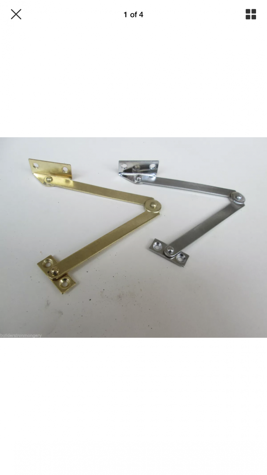

    The drawer runners present a small issue. The gap between both plates is very small. I did this to avoid changing the geometry of the seat too much. I need to find a way to extend the servo arm and attach a push rod inside the small gap. I’m waiting on a few desk hinges which I think may do the trick.
    The plan is to shorten one arm and drill a couple of holes then rivet it to the servo wheel. The pivoting bracket on the other end will then be attached to the front sliding plate. I’ll open up a few holes in the back of the flaps to provide access to the bracket fixings.
    Arduino servo code is loaded and the servos are working. Once the hinges arrive I should be able to do some tests.
    Along side this part of the project I’m still working on the base. I’m waiting on some more parts to arrive before I can show any progress.
