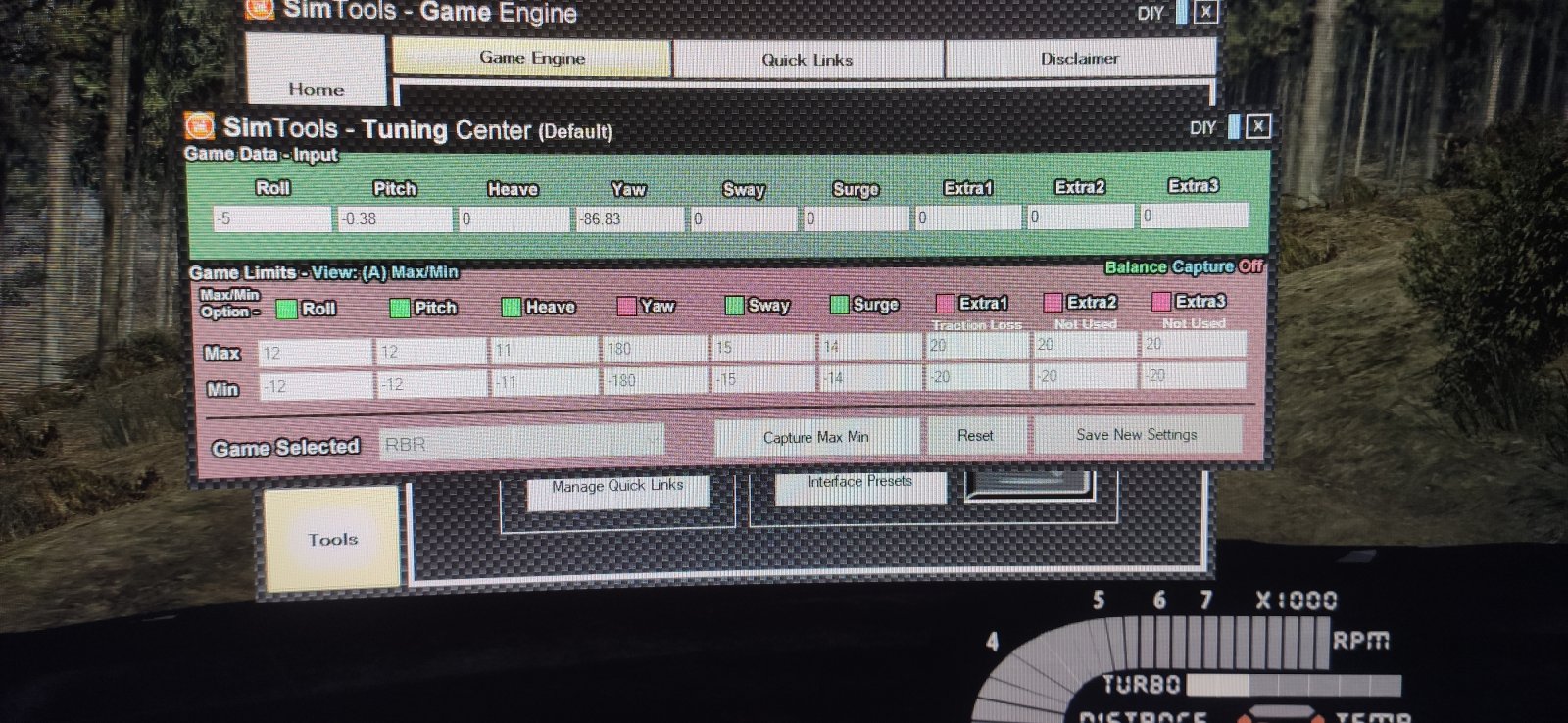

    Hi, i have a problem with RSRBR, when i run the game for the firts time just move the simulator nothing, i have to do the tunning center I imagine to recognize the effects of movement well, but when i do alt + tab, then it does not let me return to the game and I have to manually close it, there is some other option to start the tunning center without doing alt + tab?
    Or could I enter the values manually? this pluggin supports the traction loss?
    Regards
  4. yobuddy
    51,704Coins
    +5,204 / 19 / -0
    Maybe play the game in window mode for tuning?

    Hello everybody!!
    The plugin is working in my sim but the movement is too erratic and aggressive. I dont know how to fix it.
    Maybe someone know how to do it.
    22,185
    154,750Coins
    +11,196 / 57 / -2
    Here are some tips for refining your motion profile, in particular initially doing one axis at a time and capturing the Max/Min values in the Tuning Center: https://www.xsimulator.net/community/faq/steps-to-create-a-motion-profile.228/

    I have problem with motion profile. Can someone help me what to do (any filters ) with sway force is going left and not to center but lillte right and left and center. Like a spring.
    Only in rbr
  18. Bulletpup
    Bulletpup New Member Gold Contributor
    Jan 3, 2021
    29
    117Coins
    +10 / 0 / -0
    Sounds like you have not tuned the motion with max values. What I do is find a huge hill and drive up it, down it, drive on the side of it both ways. Then your telemetry data will have a ton more to work with.
