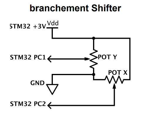

  15. 1Wheel
    1Wheel New Member
    Oct 21, 2017
    8
    austraila
    272Coins
    +7 / 0 / -0
    @RacingMat in that Image it shows 2 pots is that referring to, Potentiometers and if that's the case why would it have pots for an H shifter.Don't they normally use Limit Switches? is there some other item that's called a pot. Just Trying to understand and Learn. Thanks.

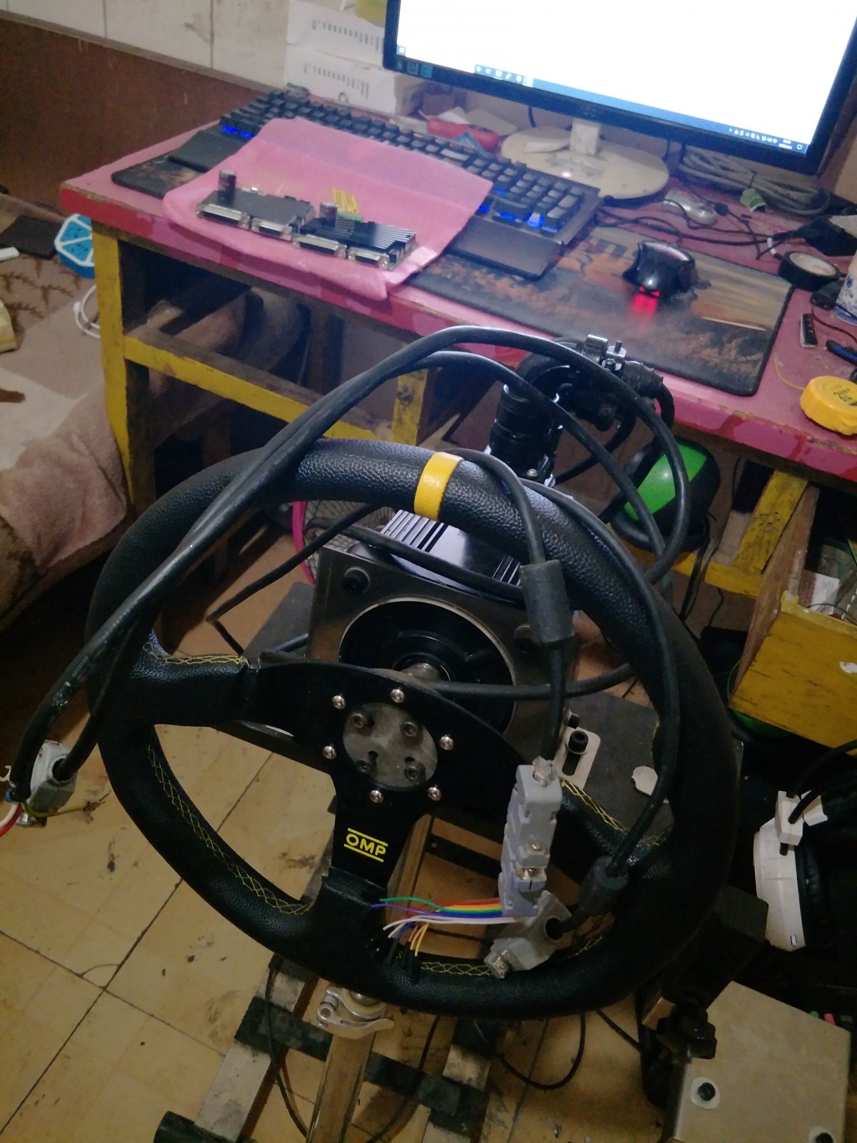

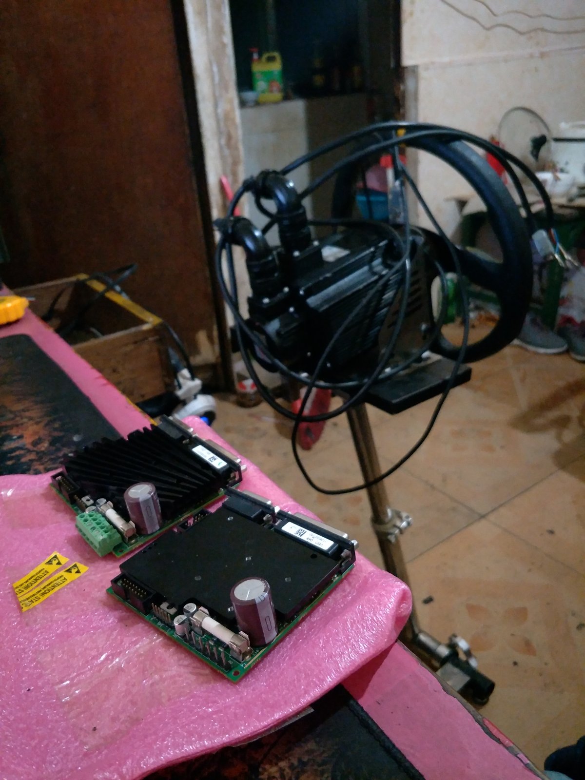

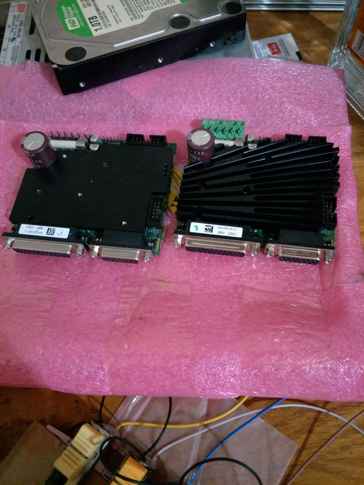

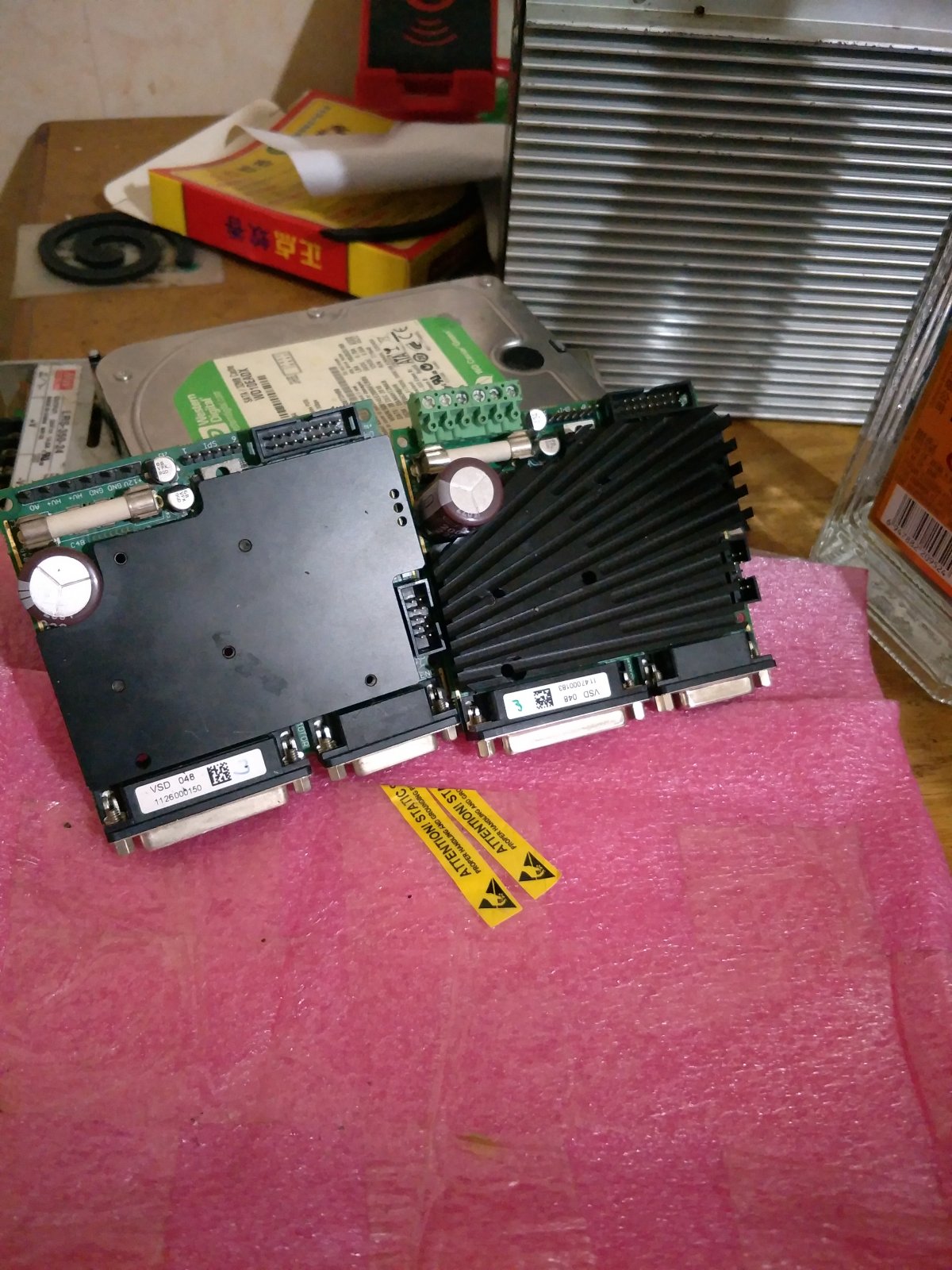

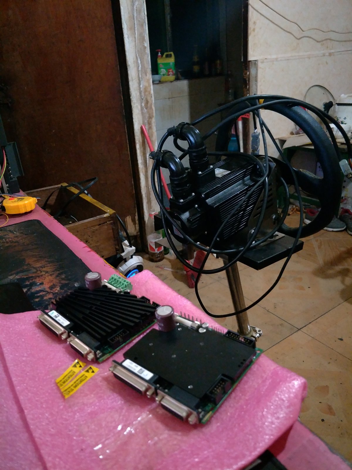

  17. HUANGJIN
    HUANGJIN New Member
    Feb 9, 2019
    26
    machinery manufacturing company
    China
    205Coins
    +13 / 0 / -0
    DC motor, Arduino, SimforceGT, Motion platform, 4DOF, 6DOF
    About VSD-E and VSD-XE
    https://granitedevices.com/wiki/VSD-E_and_VSD-XE
    I want to use OSW to directly simulate the steering wheel of a racing car
    Unfortunately I do n’t know how to wire and set up
    0: I have two VSDs here and I do n’t know how to wire them
    1: About I do n’t have STM32 hope master now
    Please guide
    2: I just want to test whether the servo motor is easy to use
    Thank you!
  18. RacingMat
    2,234
    21,094Coins
    Without STM32, it's problematic. Do you intend to write your own firmware on a different chip?
  19. HUANGJIN
    HUANGJIN New Member
    Feb 9, 2019
    26
    China
    205Coins
    +13 / 0 / -0
    I have purchased STM32
    Express shipping
    There is a forum link in your tutorial with some pictures I can't open
    It is this forum link that I cannot open the picture
    http://www.racingfr.com/forum/index.php?showtopic=46898
    Is there any other wiring picture
    If there is a more detailed wiring tutorial, please send me one
    Thank you!
