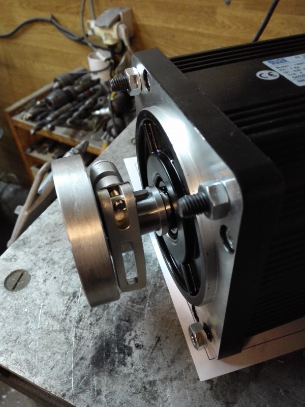

    Once I completed my DIY Mige steering wheel, I felt like to swap easily between wheels (F1, rally, GT...)
    but quick-release are expensive
    and for each new wheel, you have to buy the 2 parts QR and use only one
    and many QR loose precision with time
    So I intended to design a low cost, no gap, very fast quick-release!

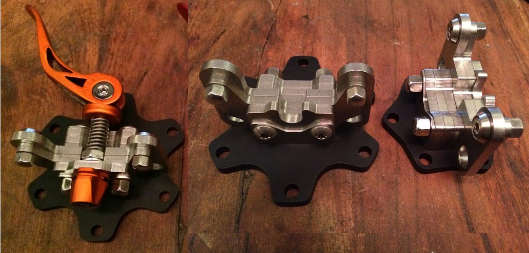

    Here some commercial Quick-release :
    Q1R 150€ [​IMG]
    expensive but works very well (tested by podobert)
    simracing dedicated
    http://beyondmonkey.com/pub/q1r/q1r.html and the Sim racing garage review with 2 videos

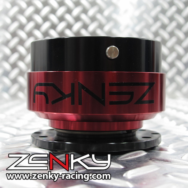

    ZENKY 65€ [​IMG]
    (tested by TortueG and StefBord)
    http://www.zenky-racing.net/collections/frontpage/quick-release

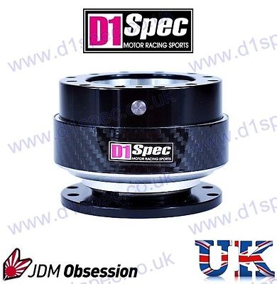

    D1Spec 60€/67€ (Taïwan) [​IMG]
    new mark II
    http://stores.ebay.co.uk/nitroxukimport?_dmd=2&_nkw=d1 spec quick release
    chinese "english" QR "5 years warranty" @60€ on ebay [​IMG]
    there are not good and wear down with gap
    SNAP OFF QUICK RELEASE BOSS KIT HUB ADAPTER FIT MOMO OMP SPARCO STEERING WHEEL

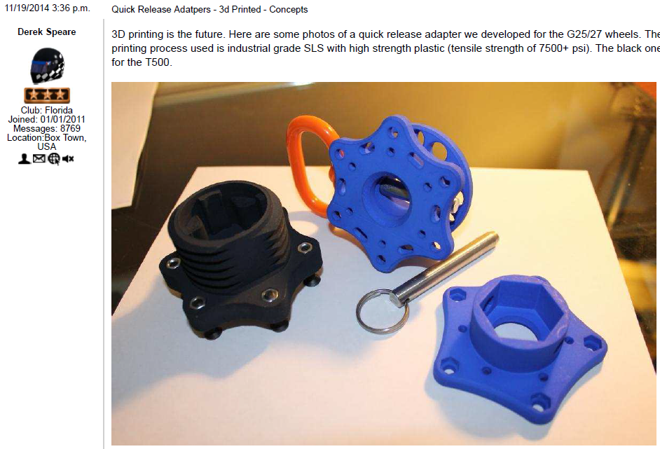

    Here a 3D printed design from DSD
    interesting but expensive, and not so quick to fix and release IMHO
    maybe more design to come?

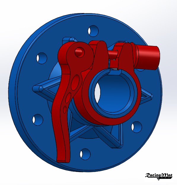

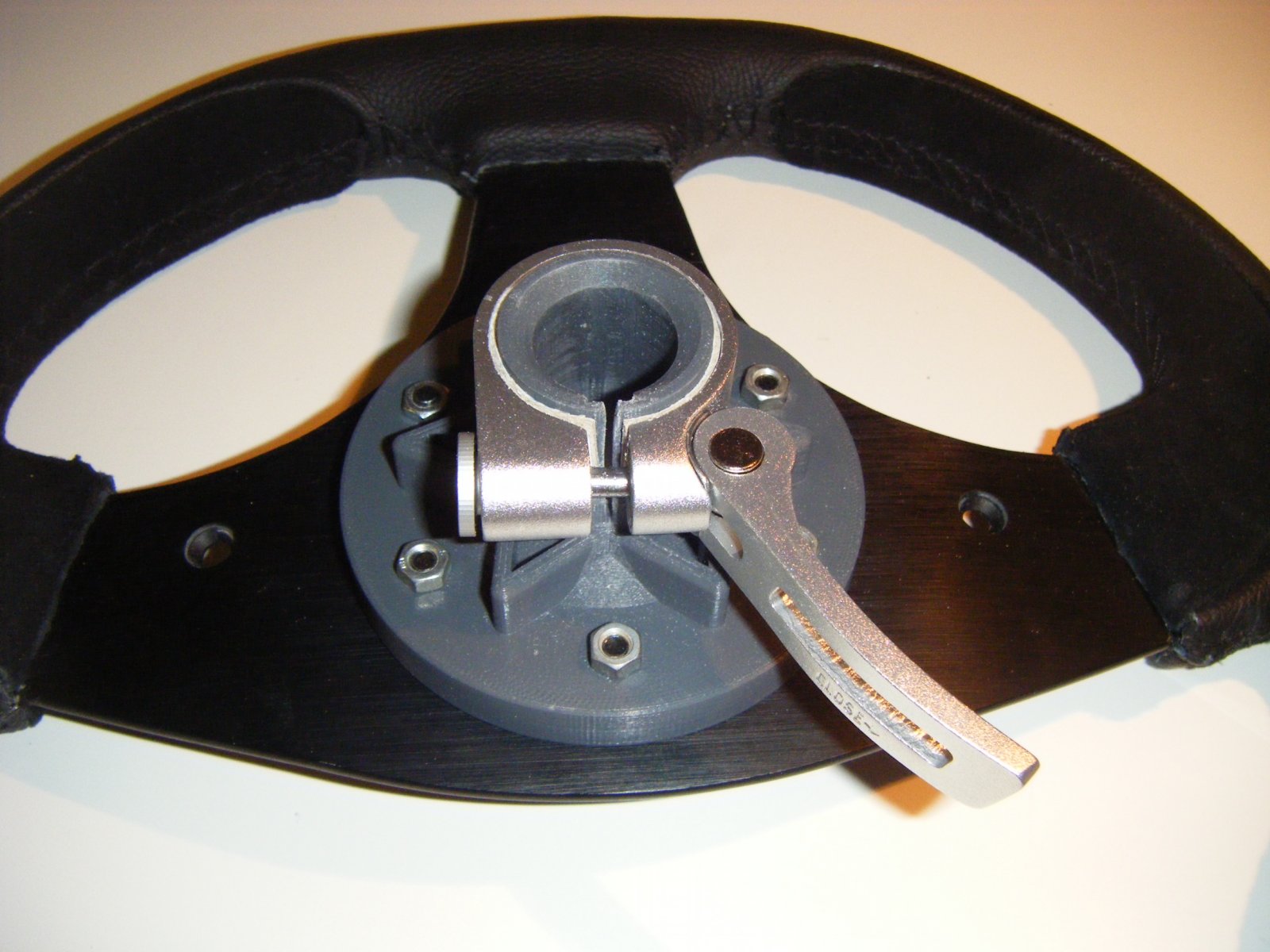

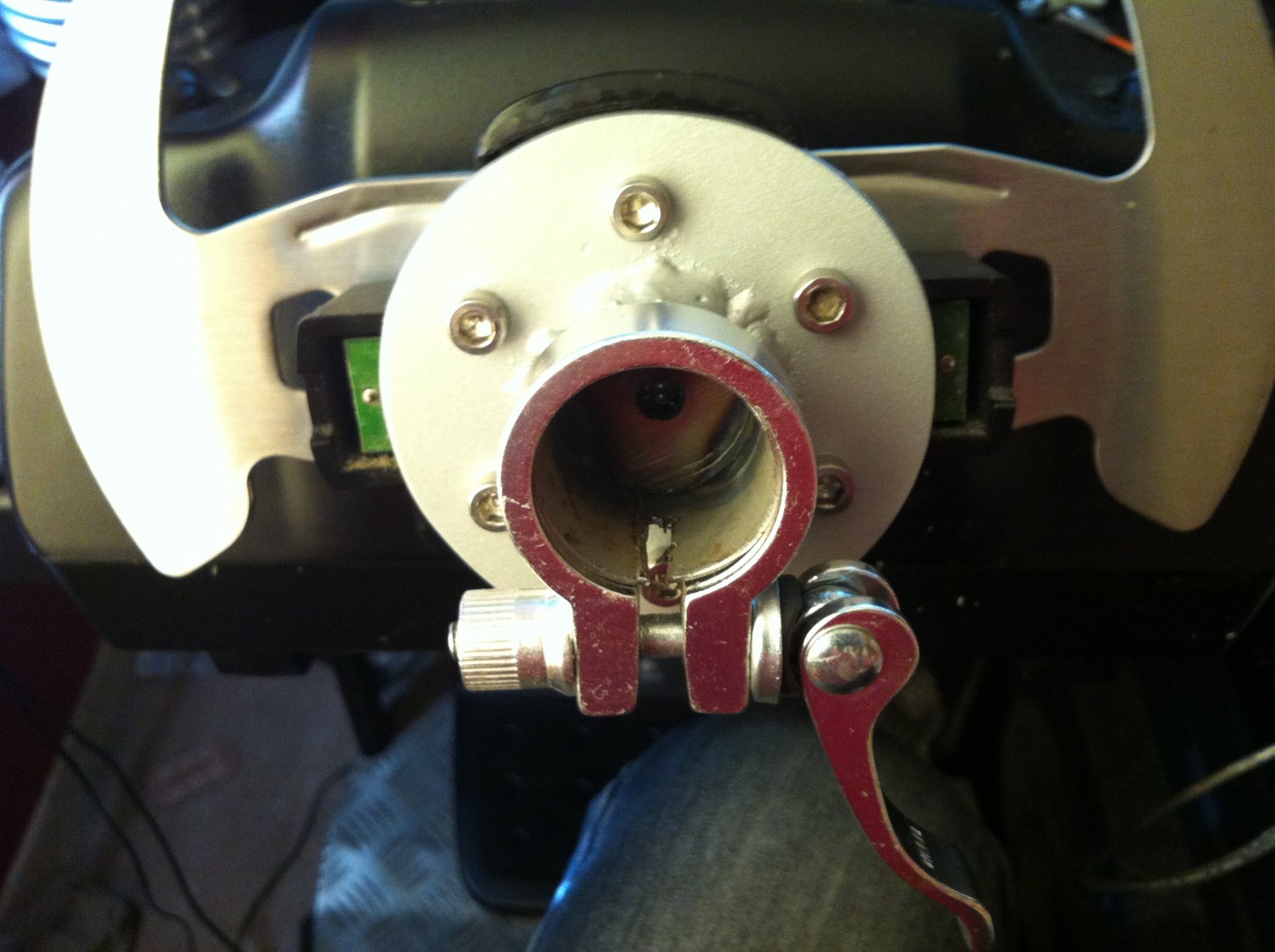

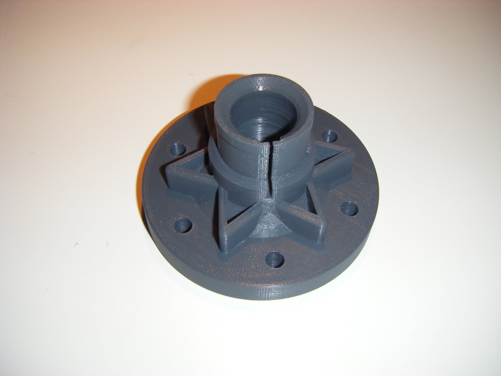

    Here is what I draw:
    it should go on the MIGE shaft and use the wedge to stop rotation
    It's a printed part in blue and a collar of mountain bike in red
    it's a 100gr ABS piece
    Collar is Ø34.9mm internal: it's mountain bike size
    5€95
    http://www.decathlon.fr/collier-selle-rapide-349mm-id_3640502.html
    pay attention to:
    - the material (ABS is okay, PLA has been fine for Shannonb1)
    - ask for "full infill" (100% fill without honeycombing)
    - STL file describes only the surface geometry of a three-dimensional object (hence the volume but not the inside!) so ask for 100% fill
    because the 3D printer uses a software to read the stl file and by default they do honeycomb.

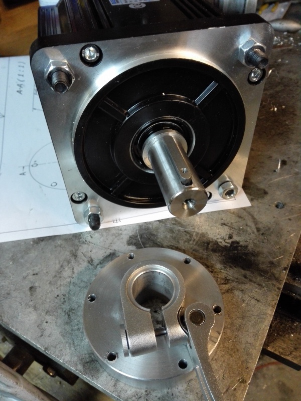

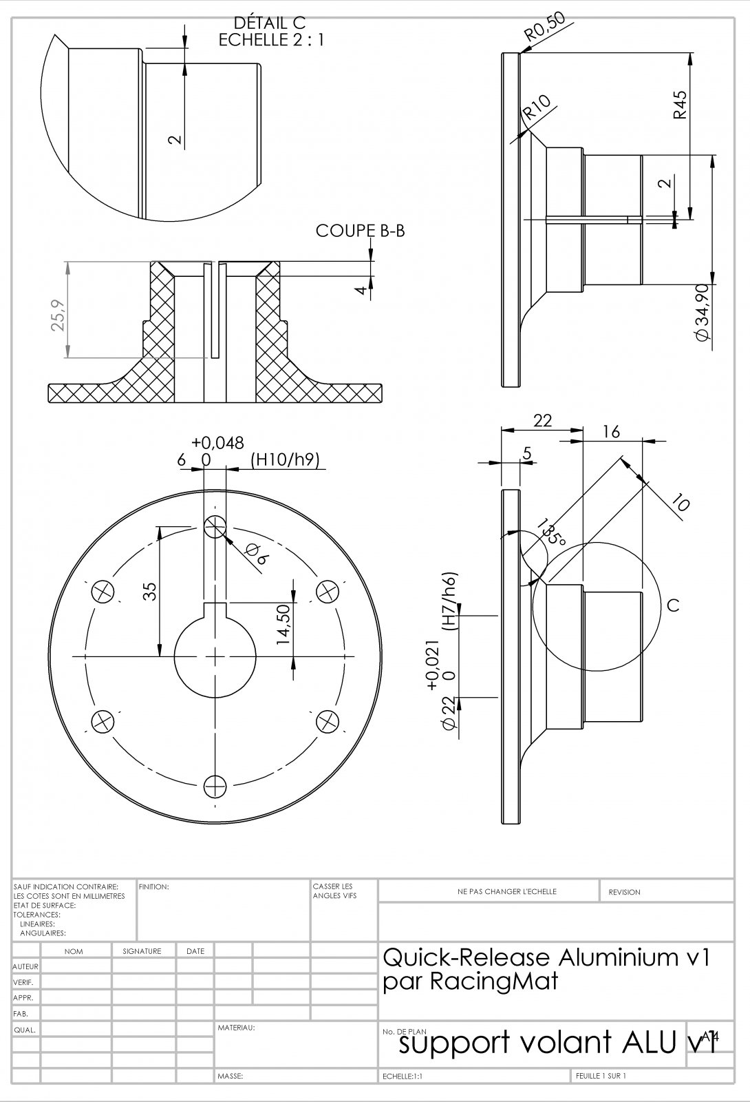

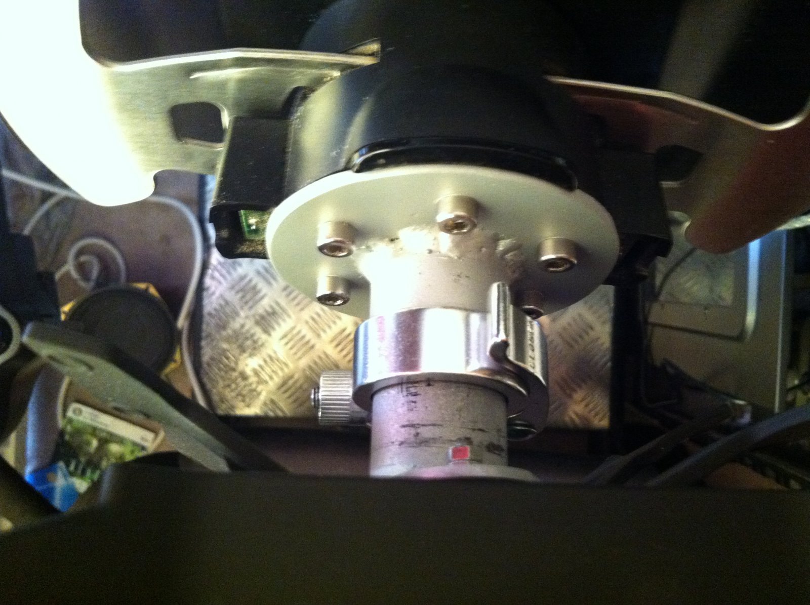

    Same design can be applied to aluminium machining:
    A friend Rider63, machined the piece I drew in aluminium
    • Like Like x 7
    • Winner Winner x 4

    Do you mind sharing your 3d print file?
  8. RacingMat
    2,237
    21,031Coins
    I have added the stl file in the message ;-)

    Just for insight....I checked with shapeways and they wanted 65$ to print this.....I have a buddy I work with that has a makerbot2 and is gonna hook me up instead but I figured I would look. I need to get into the 3d printing business!
  10. RacingMat
    2,237
    21,031Coins
    you can have some quotation on 3DHubs.com
    it's expensive but less than what you got
    it's around 30€
    it's a good solution if you got a printer, yes !

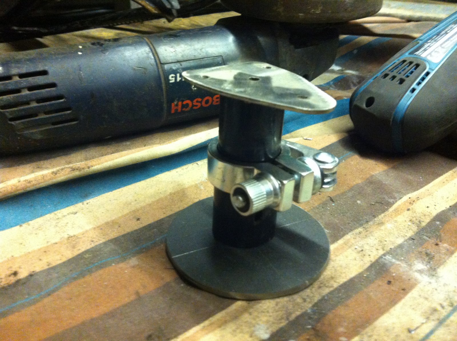

    Thank you for sharing this idea @RacingMat

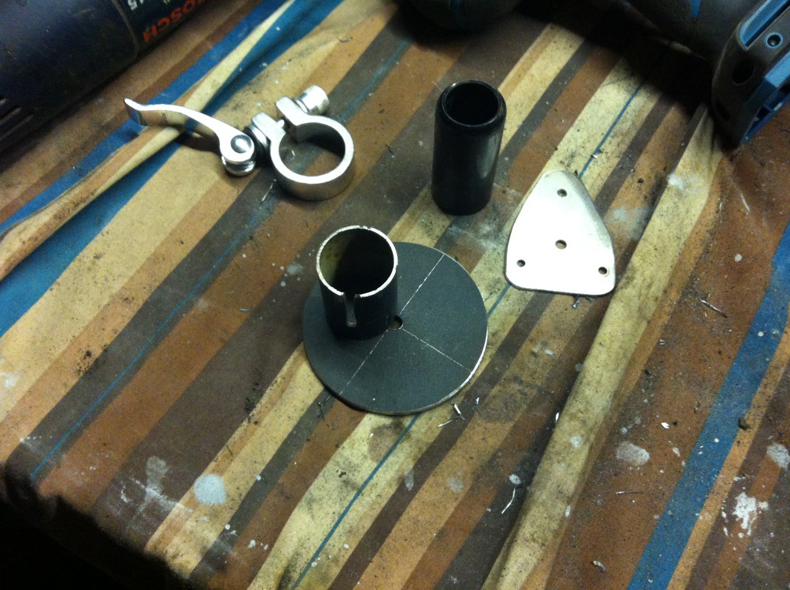

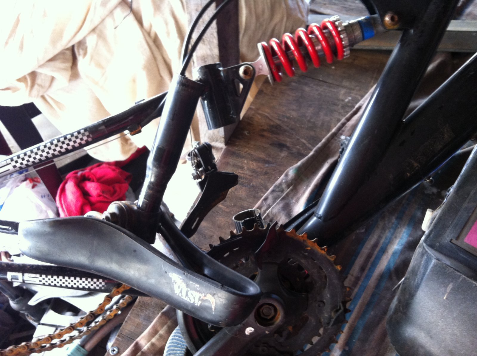

    I don't have a 3D printer so I thought why not run with a mild steel one so
    got a free bike frame off a friend and cut a section of the seat pole off the frame and the seat
    I used a bimetal hole cutter to make a 80 mm disc and then cut rough to size both seat pole and frame pole
    then drill G27 wheel PCD test fit and cut to size and paint
    works great and very fast to swap wheels total cost £5 for seat quick release
    thanks again ;)

    This is the turn to Vicpopo to follow the aluminium Quick-Release model :)
    • Like Like x 7

    @RacingMat thanks for sharing your 3d printfile. May I ask what software you used to create it and would it be hard to change the diameter of the shaft?
  18. RacingMat
    2,237
    21,031Coins
    I'm using Solidworks :thumbs
    write on the picture the new dimension you like: so i can produce a 3D file for you ;)

    about to go with this design but will be mounting my quick release to this hub. Anyone used this? any failures with the print?
