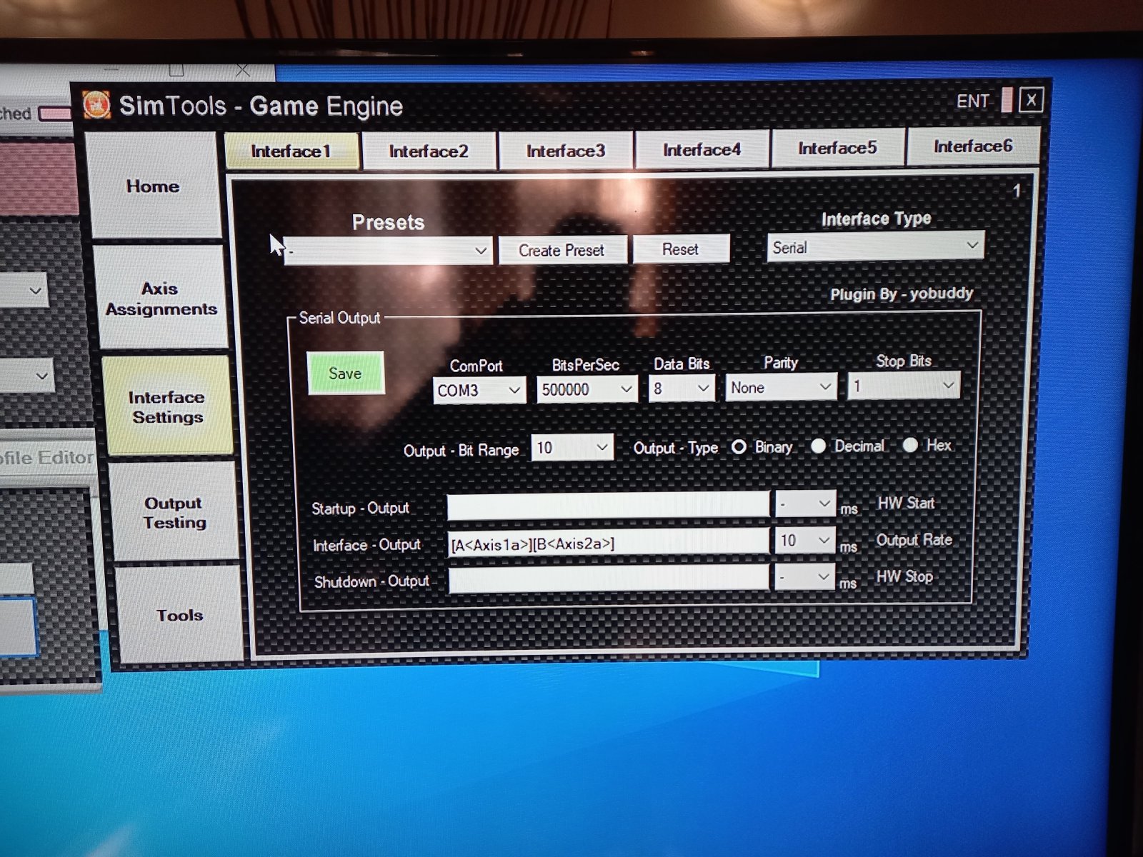

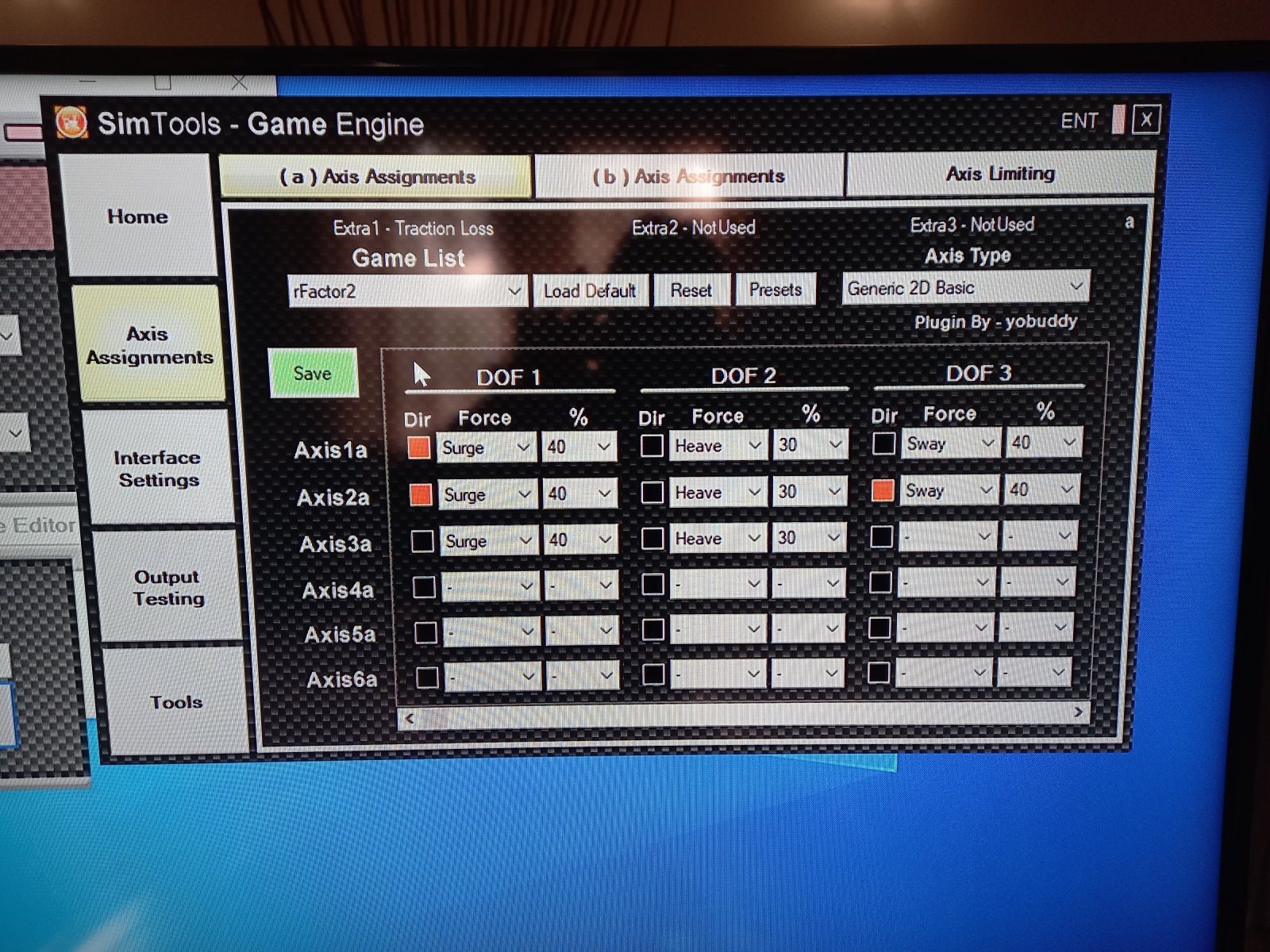

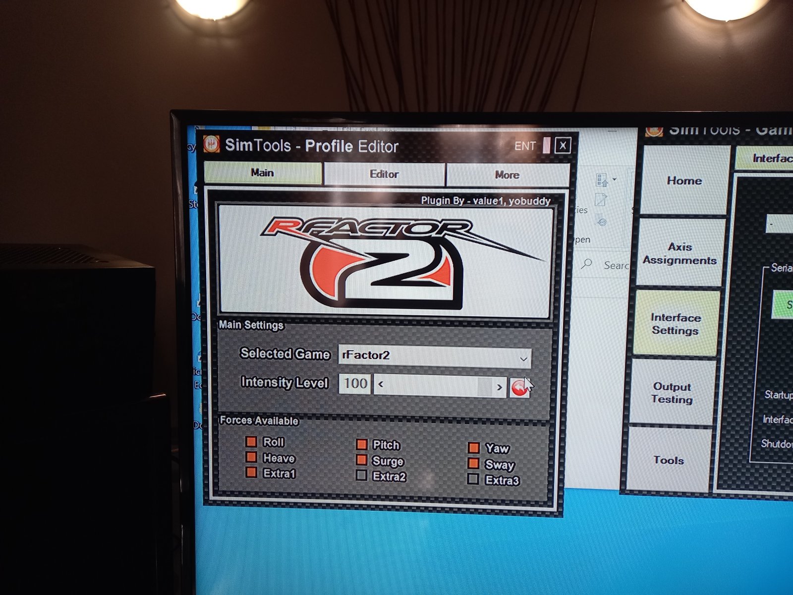

    Thank you please take a look screen shots ... is any of this correct appreciated 20211017_072257.jpg 20211017_072228.jpg 20211017_072138.jpg
    22,199
    154,657Coins
    +11,207 / 57 / -2
    I can't tell much from those settings, as in the Interface Settings only 2 axis are configured, yet in Axis Assignments 3 axis are configured.
    Is your rig configured and behave as expected in Output Testing?

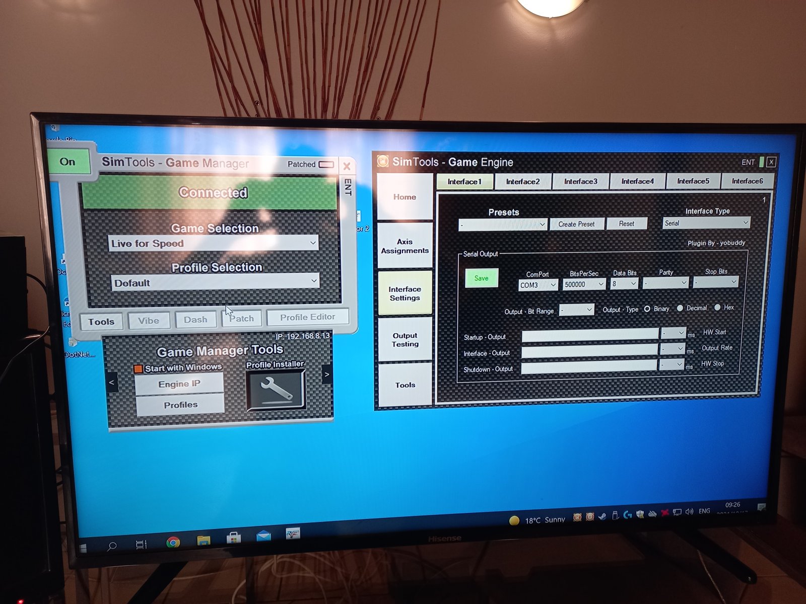

    Noorbeast ... when u say smc3 Is that my com to my adruino interface ... if so yes that com is for my microcontroller.. the values buts per sec parity I copied from a setup I saw on YouTube.. thanks again Mate ... I've gone back to the beginning finally got game Manger and game Engine connected... should I have rf2 in the game section
