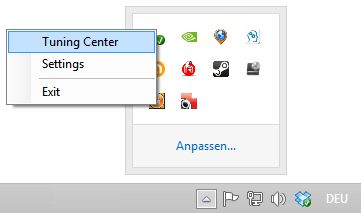

    Right-click on the GameEngine Tray Icon GameEnginTrayIcon.jpg and select Tuning Centre Open TuningCentre.jpg

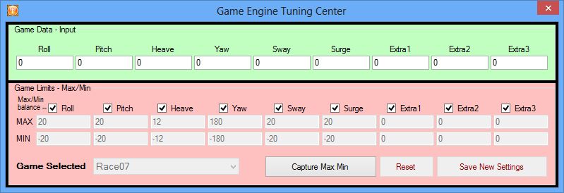

    A window opens with lots of data:
    Click on Capture Max Min and then on Reset
    Run your game and drive an average round without crashing.
    Save New Settings and Stop Capture
    Now you should have greater movements of your sim.
    NB: The lower the MaxMin values in Tuning Centre Game Limits, the stronger the movements.
    Have a try.

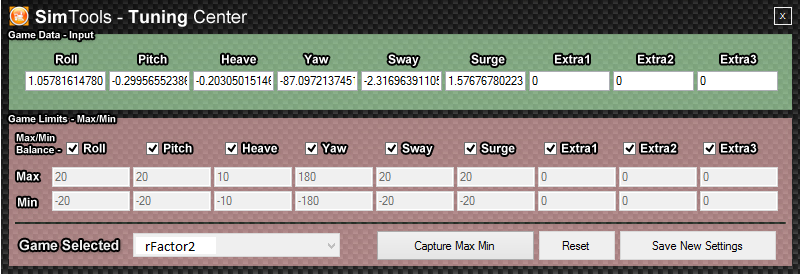

    rFactor2 still uses the v5 interface structure dating back to May 20, 2013. No change since.
    Do you see any data changing in the Tuning Centre under Game Data - Input?

    no data changing in Game data - input. only zeros.
