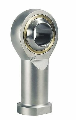

    I avoid Google products and services, so what type of rod ends are you using, rose joints or traditional tie rod ends, and in either case can they be lubricated?

    Using rod ends like this
    Dropbox link to the video
    https://www.dropbox.com/s/nclhun4xyjn1z1j/20210404_113707.mp4?dl=0
    I can lubricate them but I'm not sure if that would solve anything? They rotate fine, I guess using some thick grease might pack in any play they have?

    Rotation doesn't seem to be an issue. I think it's the actual joint rattling inside the socket, I don't have a grease gun but I could try and lube them with some thick grease to at least dampen some of the play.

    Some rose joints come with grease nipples, but obviously yours don't.
    If the joint itself is worn to the point of rattling then likely it needs replacing.

    Turn the rose so it sits sideways in the joint
    Tap the end of the joint with a hammer !
    The slack has now gone !

    So I bought some wheel bearing grease and packed it into the joints, seems to have worked perfectly! Everything is much more quiet now.
