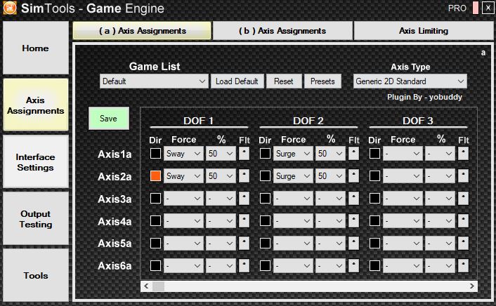

    Output testing does not require Game Manger at all buddy.
    There is quite literately 100's of projects built around SimTools.
    So there is no way for me to document each and every one, I do hope you understand.
    BTW, when you get LFS up and running, press 'V' on the keyboard to get inside the car.
    Telemetry only works from inside the vehicle. If you still get no action from running the game with your RC sim, Please make sure you have Axis Assignment for the game Live for Speed.
    (Please select LFS in the drop down list under axis assignments, click copy default, then click save.)
    (All new games added to SimTools with get a copy of the default profile found here.)
    (But since SimTools comes with the LFS plugin, you need to set it up.)
    Take care!
