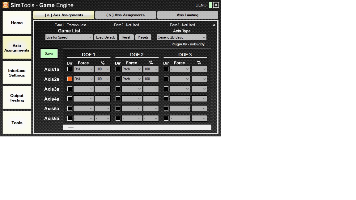

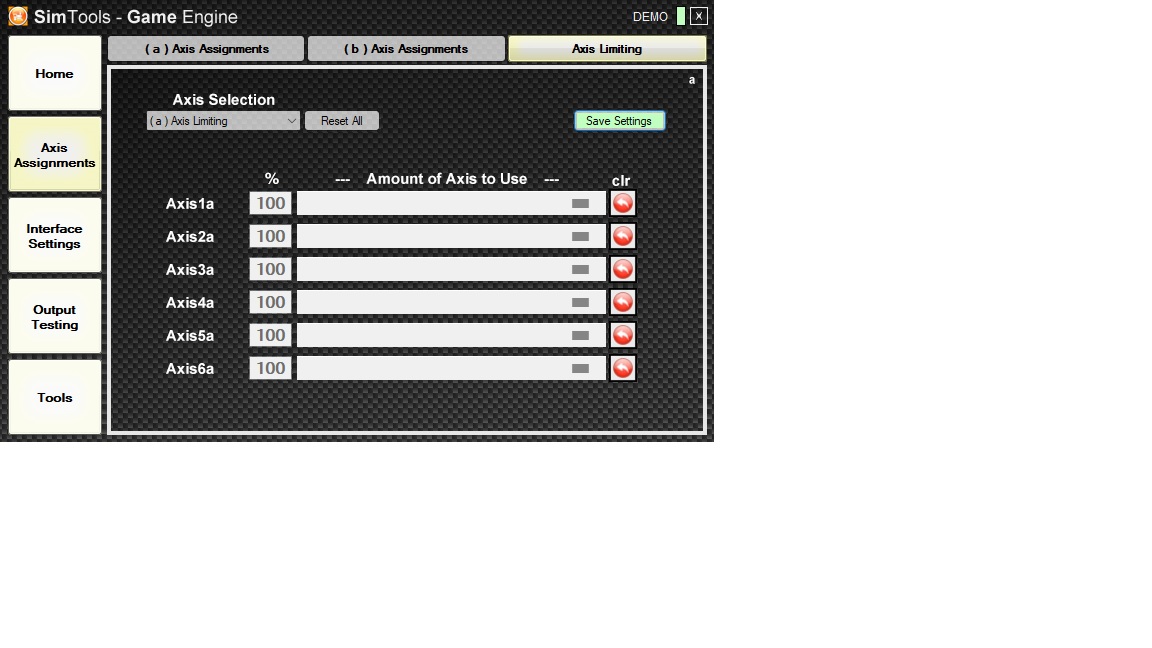

    Hello everyone, I just started following you because I would like to create a 2dof and I started with this in miniature, following all the suggestions I found I was able to move the servos that in Output Testing do all the travel but with lfs the movement is little , as if I had to increase the strength but I did not understand where Axis Assignments.jpg Axis Limiting.jpg

    Grab a copy of the SimTools manual and keep it handy for reference: https://www.xsimulator.net/community/faq/rtfm-start-with-the-official-simtools-documentation.117/
    Most likely you need to adjust the Tuning Center settings, after capturing the Max/Min values. The smaller the value the sharper the response, but over a shorter range, while the larger the value the smoother the response but over a larger range.
    See the tips here as to how to refine a motion profile: https://www.xsimulator.net/community/faq/steps-to-create-a-motion-profile.228/

    Thanks noorbeast, in fact I found the information on driving and trying to adjust the percentage of forces for each axis. now I have tried assigning the values to the forces of each axis whose sum does not exceed 100% and is going much better, the movement is also much more realistic.

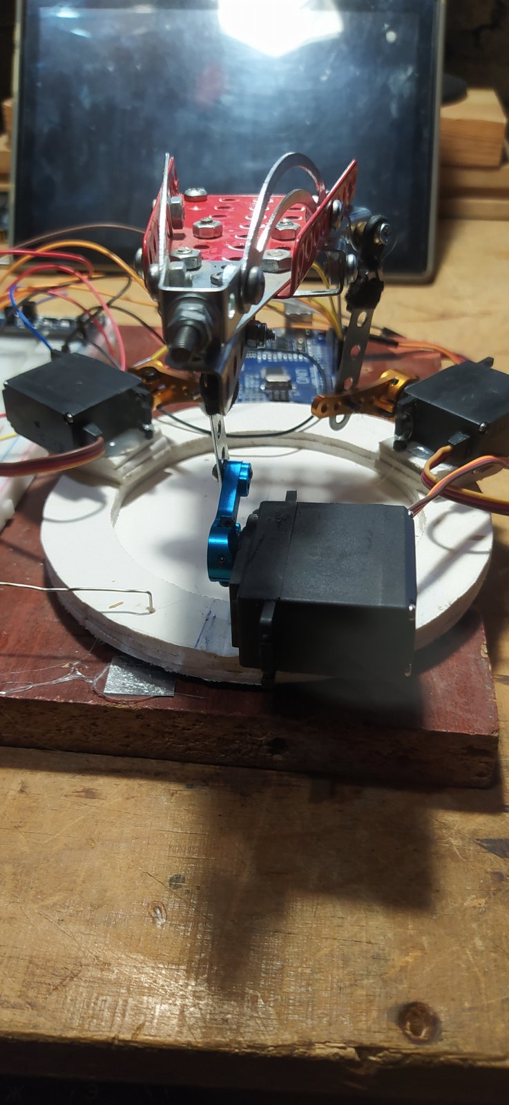

    Hello, I downloaded the code to check the future platform on the model, loaded it into the Arduino Uno, connected the servo and did not get what I expected. The servos worked jerkily, sometimes they started spinning without a break. I spent the evening trying to configure the servos. I re-read the entire code, checked the servos with a tester, nothing helped. The next evening I reinstalled Sim Tools, downloaded the firmware again, and lo and behold, everything works smoothly as it should.

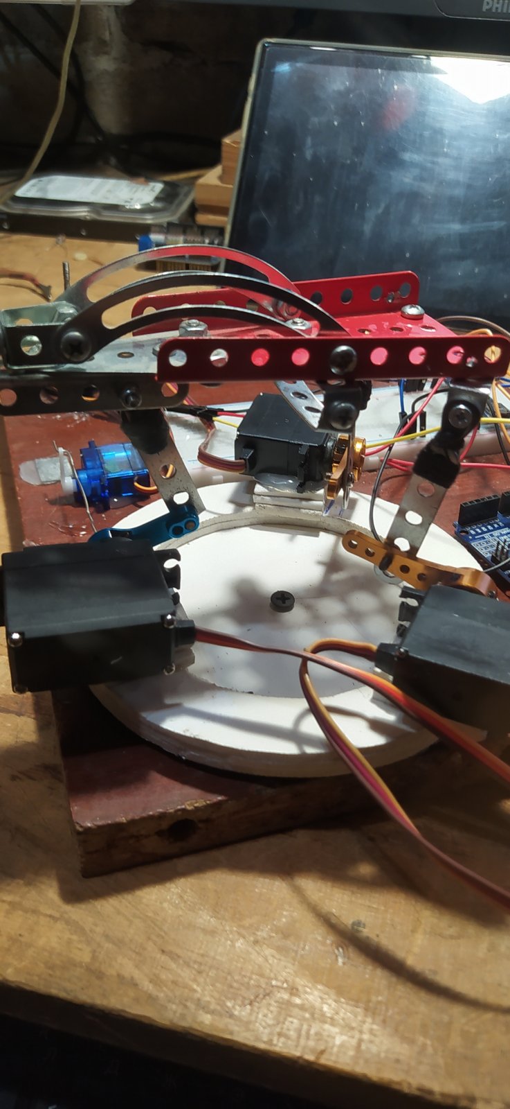

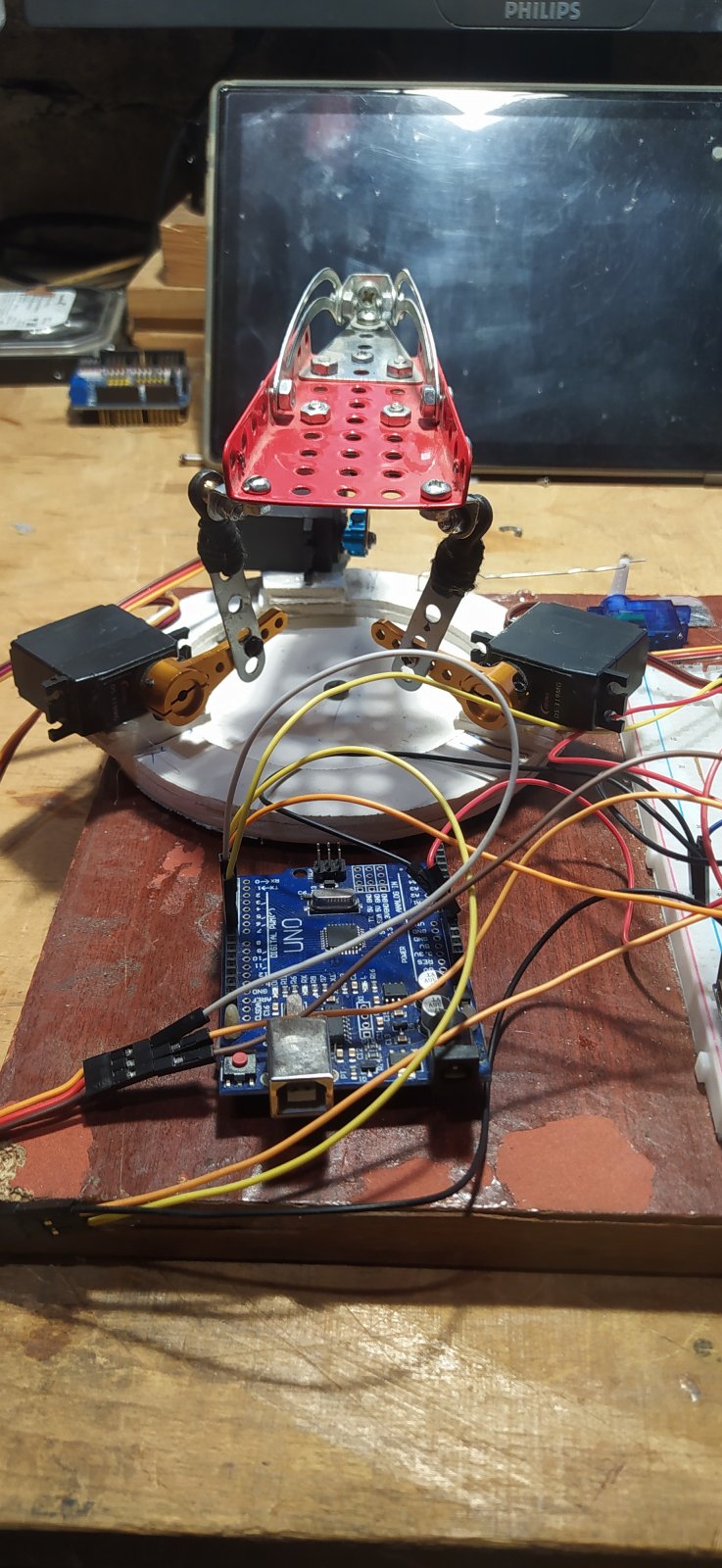

    I spent another evening and managed to simulate a platform with 3 servos, just like a full-size one would look like.
  16. Airbas72
    Airbas72 Member
    Oct 20, 2019
    37
    - 7Coins
    3DOF, Arduino
    Another evening was devoted to modeling. Today I mastered 4DOF, I’ll post a photo tomorrow, it’s already night for me
