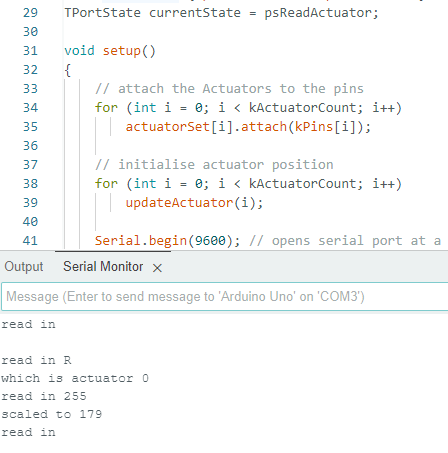

    HI, i am building RC model just like you did as my first steps,
    it seems like i can control the servos from the arduino serial plotter but i am not recieving any data from simtools in output test
    what am i missing?

    Use @eaorobbie's code: http://www.xsimulator.net/community/marketplace/rc-model-code-for-arduino-uno-2dof-expandable.89/
    Connection diagram http://www.xsimulator.net/community/threads/rc-model-for-motion-simulation.4600/
    arduino code

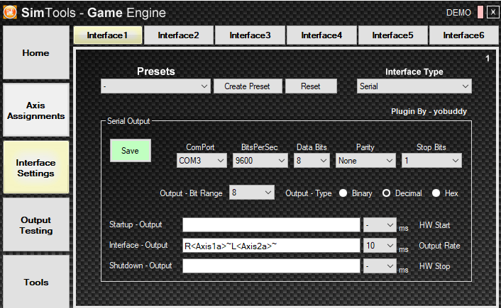

    Interface setup - IMPORTANT - Assuming a 2DOF for SimTools 2 the Interface Output should be set like this R<Axis1a>~L<Axis2a>~

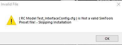

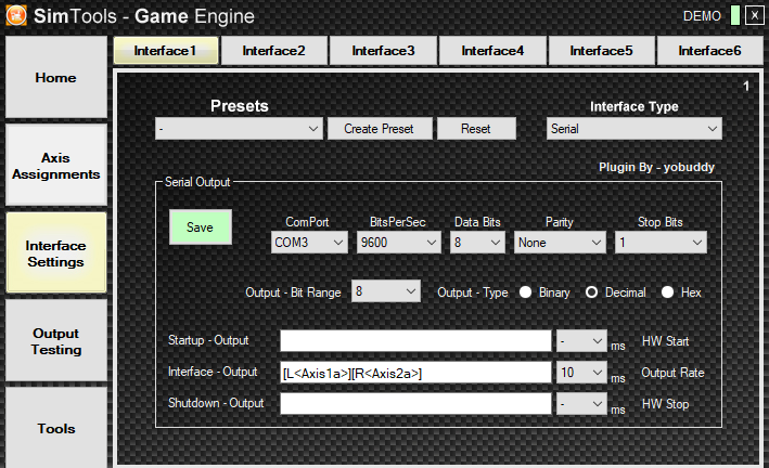

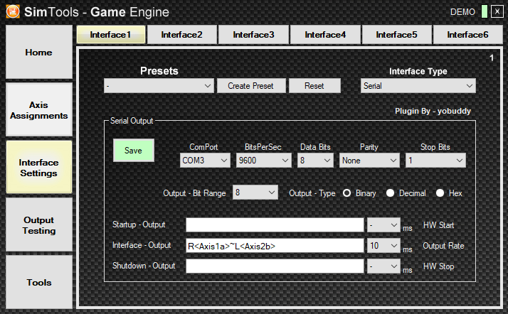

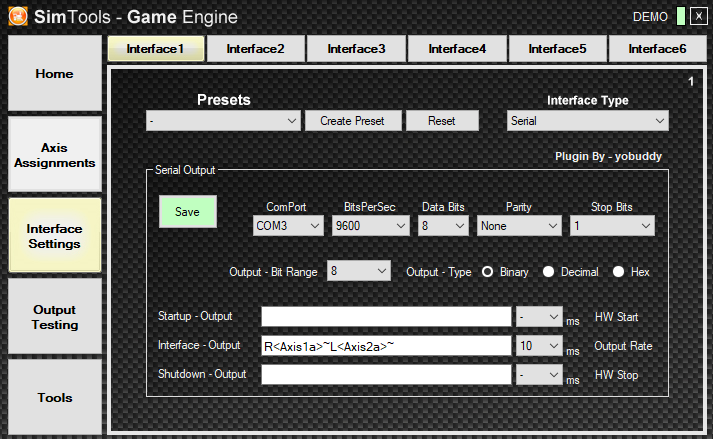

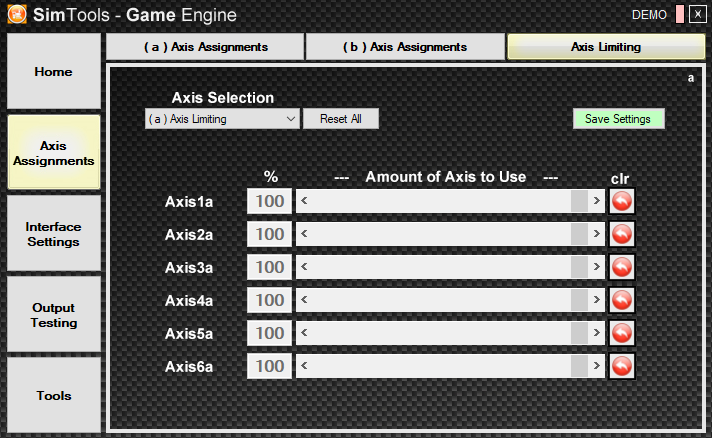

    Hello, help with the simulator, I connected everything according to the sketch diagram, loaded it into Simtools, entered everything. The servos don't respond at all; when loading the RC Model Test_InterfaceConfig.cfg file it gives an error сим1.png сим1.png сим2.png сим3.png сим2.png сим3.png

    22,202
    154,675Coins
    +11,209 / 57 / -2
    As per my previous comment:
    There can't be any spaces and it looks like you are missing ~ on the end.
  9. Vlad1225@45
    Vlad1225@45 New Member
    Oct 27, 2023
    18
    110Coins

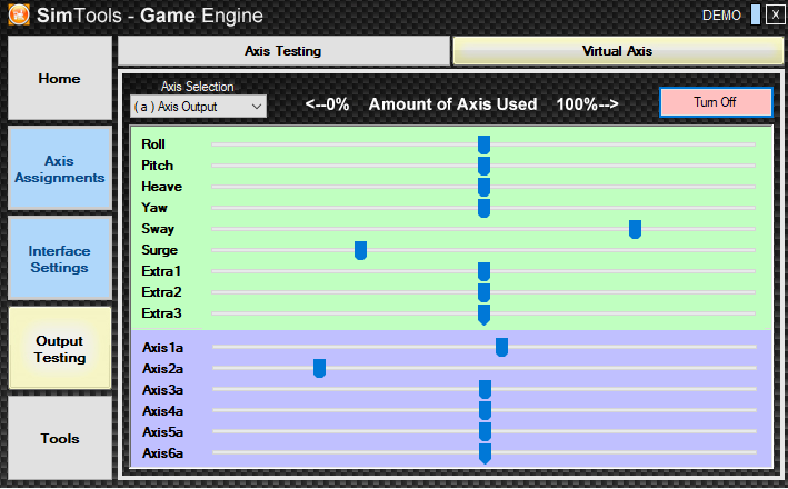

    hi, I fixed the servos errors when pressing the on button in the test section but still nothing moves when moving the sliders

    I turned off the antivirus and reinstalled SimTools, but when I turn on the test, the drives go to the middle position and nothing happens when I drag the sliders

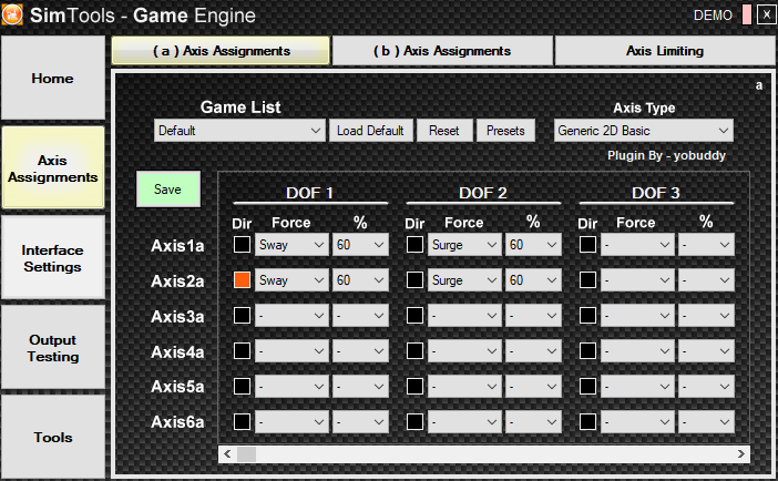

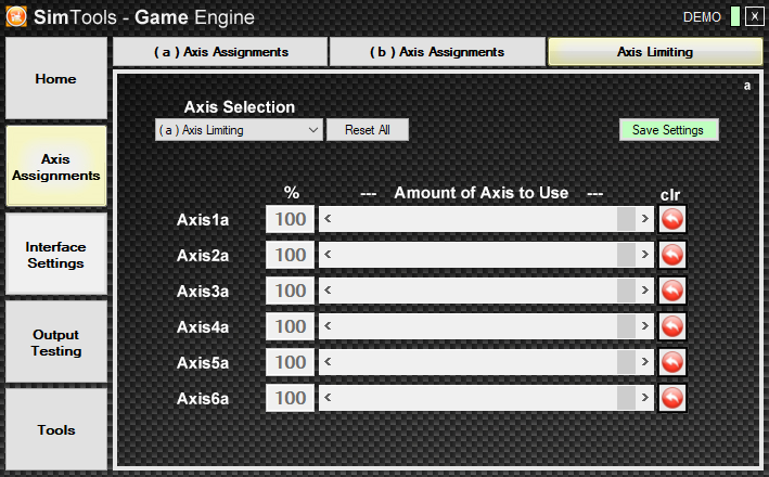

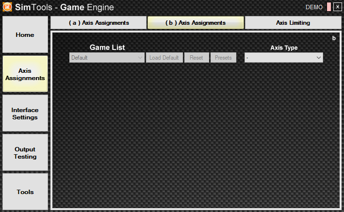

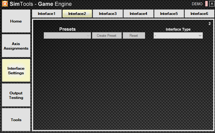

    Can you please post pictures of all of your current settings.
  20. Vlad1225@45
    Oct 27, 2023
    18
    110Coins
