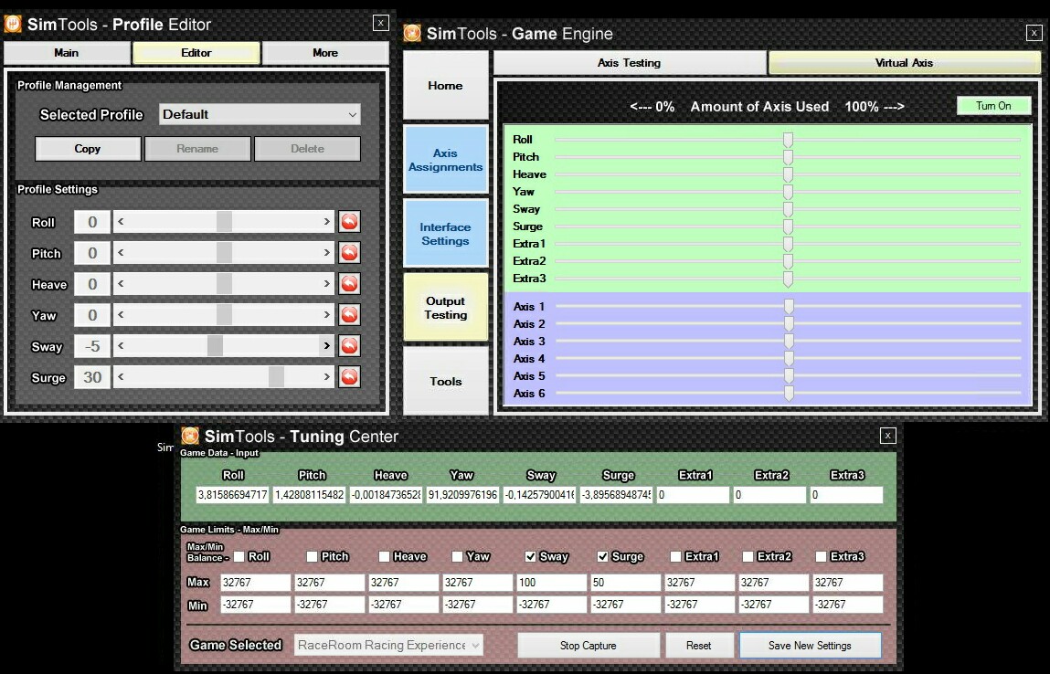

  10. Simon Husum
    Simon Husum Member
    Oct 25, 2014
    84
    Electrician
    Viborg, Denmark
    217Coins
    +59 / 0 / -0
    2DOF, DC motor, JRK, SimforceGT
    I have a very strange problem..
    When I play raceroom my motion does funny things..
    It simulates acceleration but no decaccelleration.
    It simulates going to the left but not to the right.
    My other games as Assetto Corsa, Project Cars, Iracing etc. Works fine!
    I have tried to uninstall the plugins and installeret them again and fint tune in tuning center.
    But I'm still having the problem.
    Hope anyone can help :)
    It is both in DTM 2015 and ADAC GT that the probelm occours..
    Happy new year and thanks in advance :)
    Regards Simon
    21,595
    151,233Coins
    @Simon Husum please post pictures of all your Axis Assignment and Tuning Center settings, plus a video that shows the movement of your rig and Race Room playing on the screen at the same time. That will help members to assist you with troubleshooting.

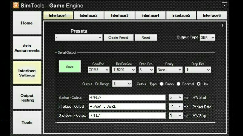

  12. Simon Husum
    Simon Husum Member
    Oct 25, 2014
    84
    Electrician
    Viborg, Denmark
    217Coins
    +59 / 0 / -0
    Thanks @noorbeast.. :):thumbs
    I have uploaded some pictures of my settings in case someone could see the fault through that?
    I'm going for a vaccation now and didn't have time to make a video.
    Will do it when I'm home again..
    Thanks in advance..
    And happy new year to everybody :cheers:thumbs;)
    / Simon
  13. Simon Husum
    Simon Husum Member
    Oct 25, 2014
    84
    Electrician
    Viborg, Denmark
    217Coins
    +59 / 0 / -0
    Never mind guys. I have found the fault myself..
    Looked further up this thread at Values settings.
    In tuning center I have only entered settings at max, not at minimum.
    Haven't noticed that before now even though I looked before writing in here..
    Emberrasng, but now it works :thumbs
    21,595
    151,233Coins
    Nothing to be embarrassed about when you learned something.
    You also have too much % allocated in the axis assignments, as it should total around 100% adding up the dof numbers: http://www.xsimulator.net/community/faq/axis-assignment-percentage-totals.120/
    I am guessing from your dir settings that one motor is reversed. Normally surge would have either both or none of the dir boxes checked, and sway would have one dir checked. It is no bish deal but worth knowing as your settings will seem odd compared to most of the information you will find on the forum.
