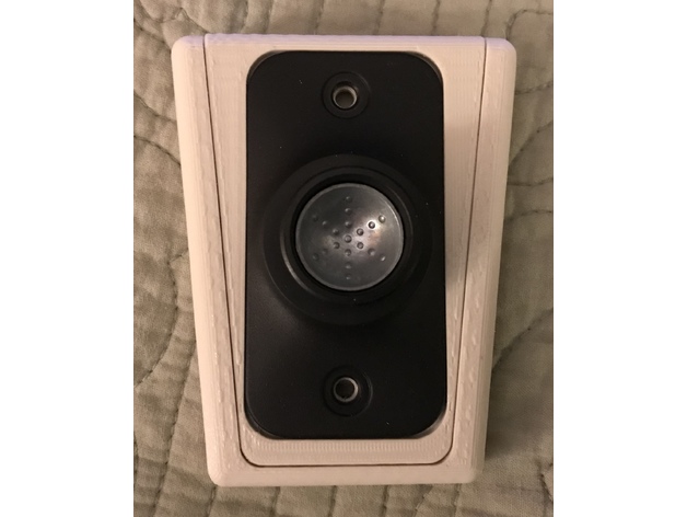

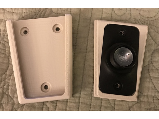

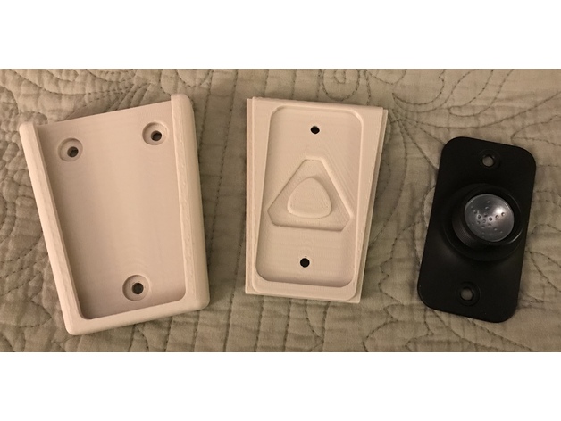

    These are just a way to quickly set up and take down the Lighthouses in case you have a setup where a significant other doesn't want them hanging off the wall all the time. (Guess why I made these... :grin)
    There are also two blank plates in the .zip - one with a Vive logo and one without - to dress the bracket when the Lighthouse mount isn't in place. 8-32x3/8" machine screws to an 8-32 nut in the pocket on the back mount the ball mount base to the slide.
    Edited to change the Lighthouse base mounting screw to 8-32x3/8" and to upload a slightly modified wall mount with another hole centered between the top two to provide a two screw mounting option. The photos don't show the added screw hole but it's there in this new V2 version.

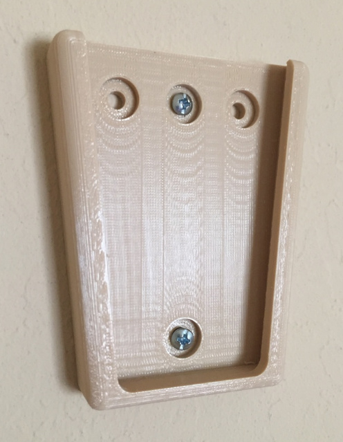

    Action shots? These show the mounts actually on the wall now and the modified base plate with the extra hole between the top two to allow two-screw mounting. These are very sturdy. I pulled hard on the mount and no flex or other issues and the screws aren't even that big. They go into wood, though.
    My wife got back from a trip and didn't even notice the mounts until I pointed them out to her. She likes these much better than a permanent mounting. These would also allow easy setup in multiple rooms if anyone wants to do that. I like my light stands but these eliminate those, bumping them, and give me a bit more room.
    I had a color that pretty closely matches the wall so am reprinting. That's why no photo of the blank plate yet, but I'll add later. I actually think it looks best when the mounts are not in use with the blank plate with no logo. They are just the wrong color unless I want to paint them and I don't. :)
