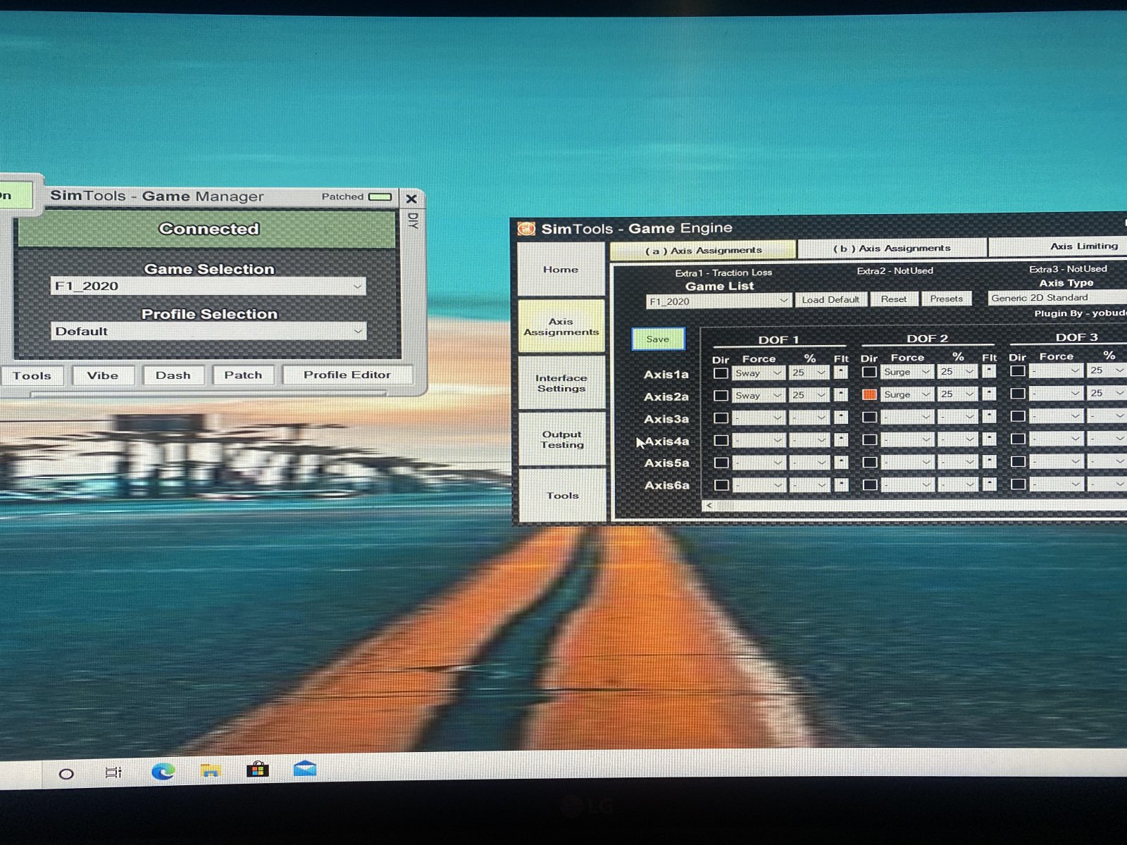

    Hi can you help me I just finished 2dof motion in simtool software I used rolls and pitch when testing it worked normally but in LFS game it didn't work as tested so what should I do hope you help me thank

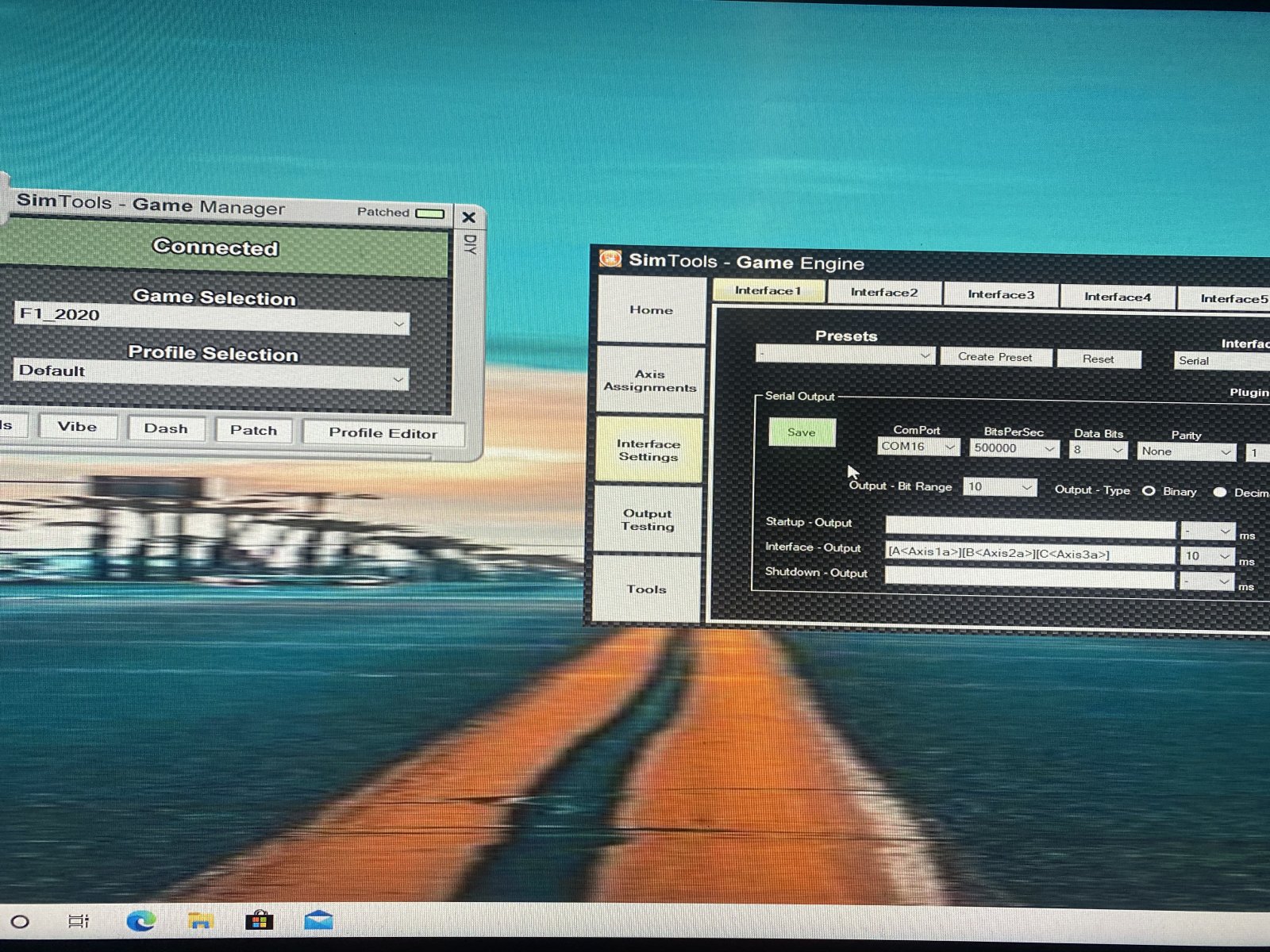

    ok my friend will try, but let me ask more before i used monster motor shield circuit now i switch to bts7960 circuit but the software as well as plugin i still leave unchanged, is there any problem, or have to change

    Please post pictures of ALL of your settings, including the Tuning Center with the game running.

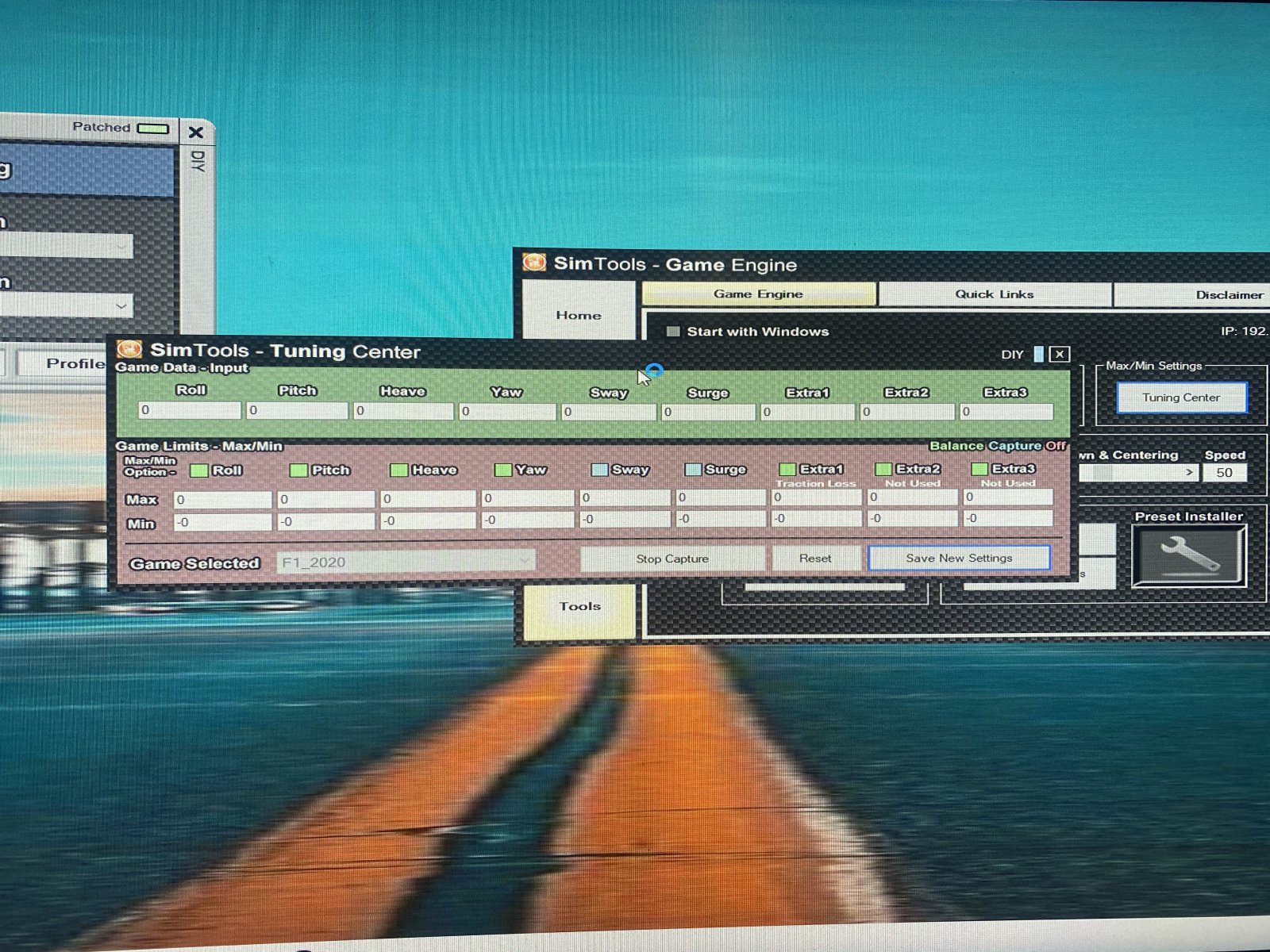

    Here it is, sir

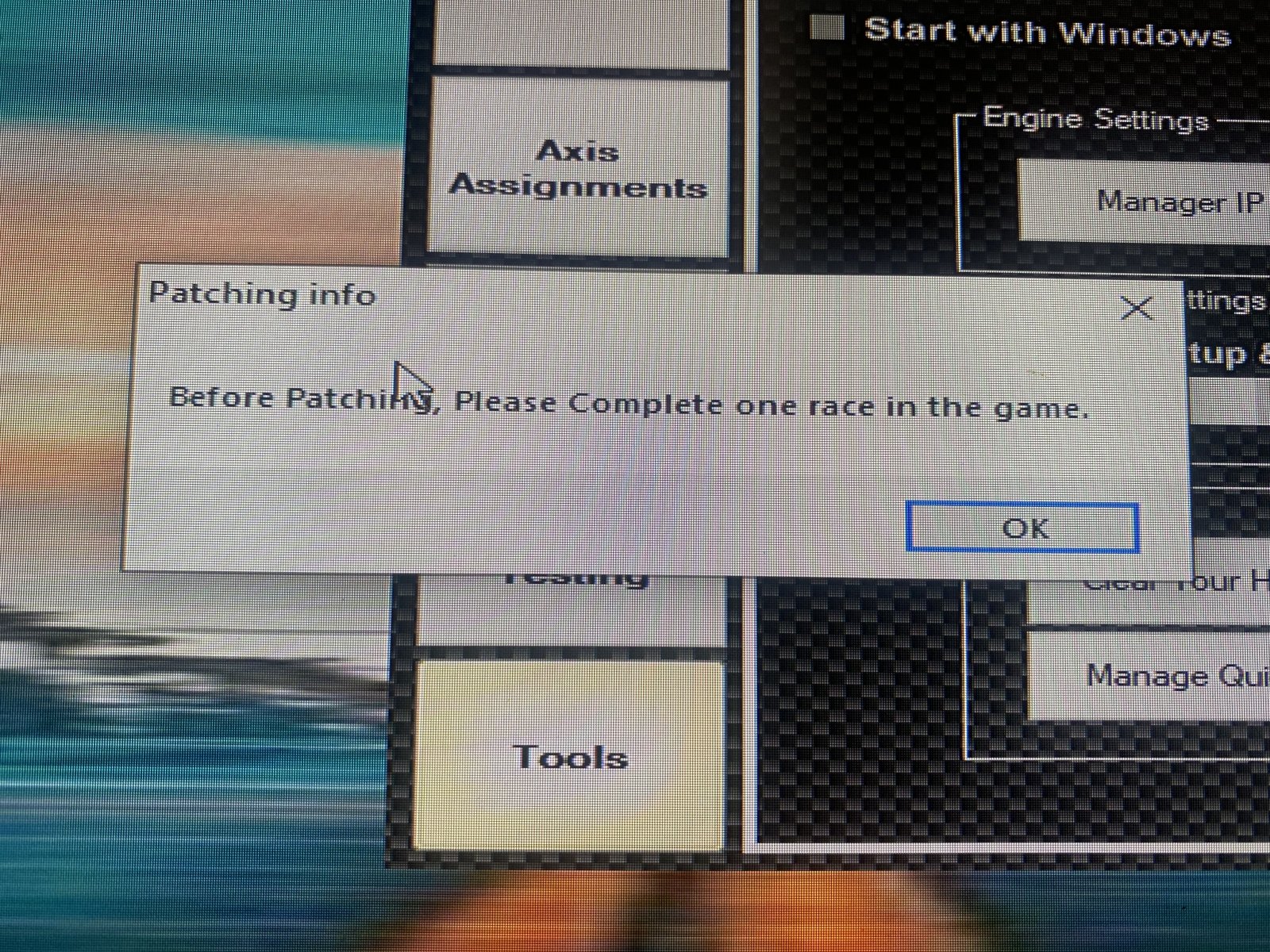

    Has the game patched correctly, as there is a message to first complete a race?
    The Tuning Center has zero set for all settings. That could be because the game is not patched, but if the game is patched higher vales will be needed, you can capture Max/Min values, see the tuning tips here: https://www.xsimulator.net/community/faq/steps-to-create-a-motion-profile.228/
    I presume Output Testing works correctly, is that correct?

    I don't know what racing mode I tried to finish 2-3 rounds but I patched it, it still says so

    Does Output Testing works correctly?

    I tried it works very well with the surge and sway that I have installed but in game it doesn't work
